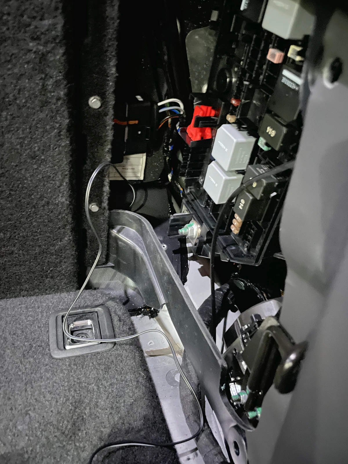

Here's that same area in the picture with the white fuse box cover, but the cover is removed. You can see how much more room you have to get your hand behind the curved plastic piece, which is hiding that rubber plug.
Just an aside. That fuse box cover is not white. It has just not had the white protective film removed. I removed mine when I had it apart to install sound deadening. I also removed some other films that were left on during the assembly process on other areas.
