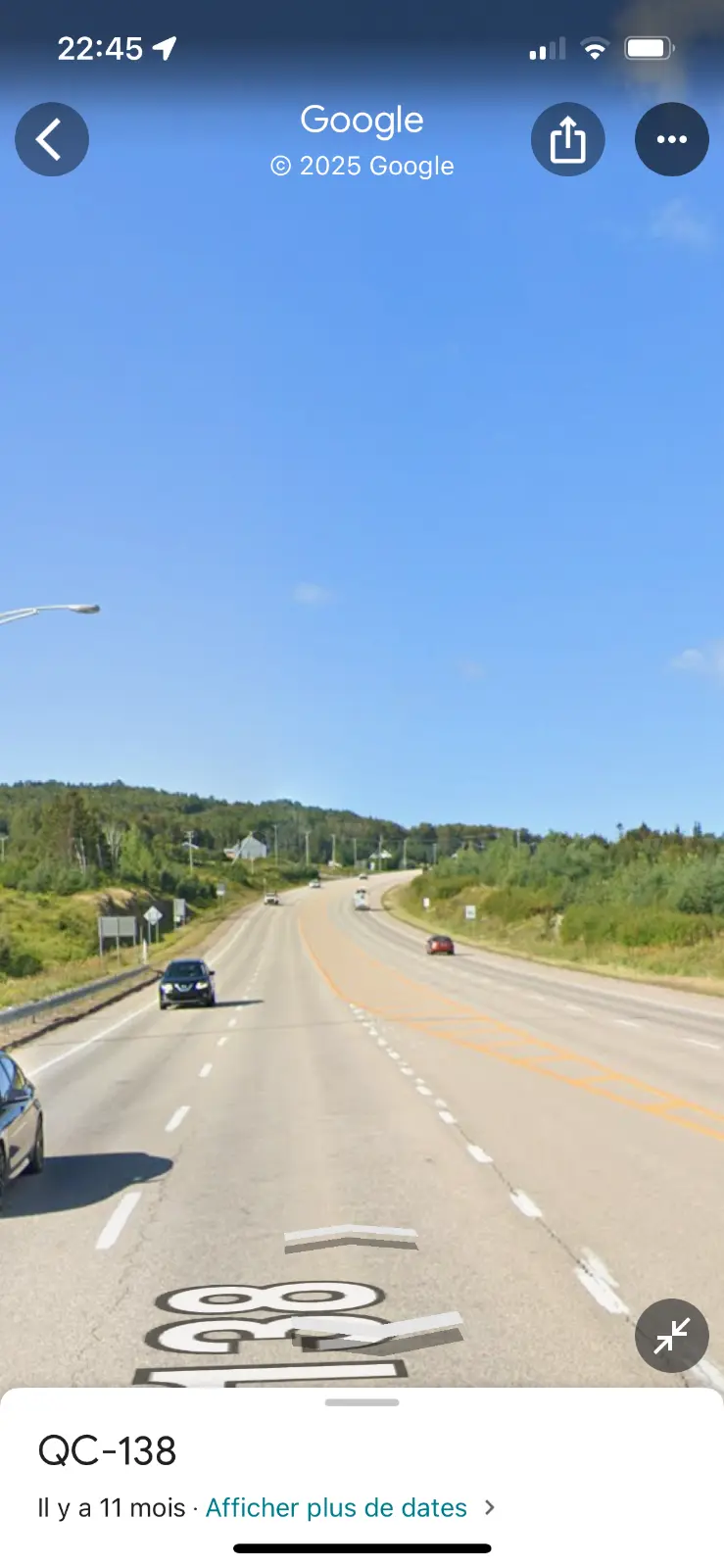

Here is a short video of my car’s acceleration. I was not on a flat road. I was going up hill, see the picture joined. The car is pushing strong for sure !

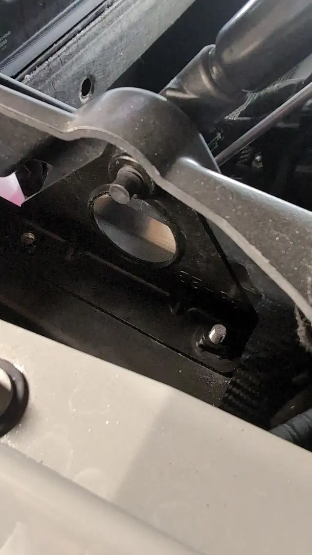

So the bracket arrives, I go to install it, and it's a real PITA to try and get the bolts threaded in to hold the bracket. It's hot, I'm sweating, so naturally the first bolt and the socket on my ratchet slip out of my hand and fall down somewhere into the hell of the engine bay. So now I'm going to have to pull out the Quickjacks, jack up the car and remove the undertray to try and find the bolt and socket. Loverly... just loverly. It's now too hot to work in the garage, so I'm going to have to wait until the early morning when it's cool enough.

Here's a pro tip for the bracket bolts that mount to the car:
- Have both bolts in and torqued up normally.
- Undo the front most one (closest to front of car)
- Angle the bracket and hook up the front hole with a bolt, keeping the rear bolt in place will allow the bolts to line up.
- Tighten the front bolt down with the bracket angled.
- Loosen the rear bolt.
- Push to rotate the bracket into place.
- Reinstall rear bolt and tighten.

Follow KitKats method. Believe me it can be easy depending on how that part is loaded. It took me lots of time when prototyping the part to realize what was happening and many back injuries later haha.
I also just lay on the sc cover on my side.
I made mistakes and thought I was lined up on the front bolt while threading it in, and got frustrated with the bracket flopping around, so removed the rear bolt. Only to hear a thunk as the bracket settled and moved. I struggled, tried to manipulate the trunk-lid to re-align.
Ended up popping the Vent panel off so I could see the bolt holes better and know where the screw was coming in from. Highly recommend that if you are struggling.
