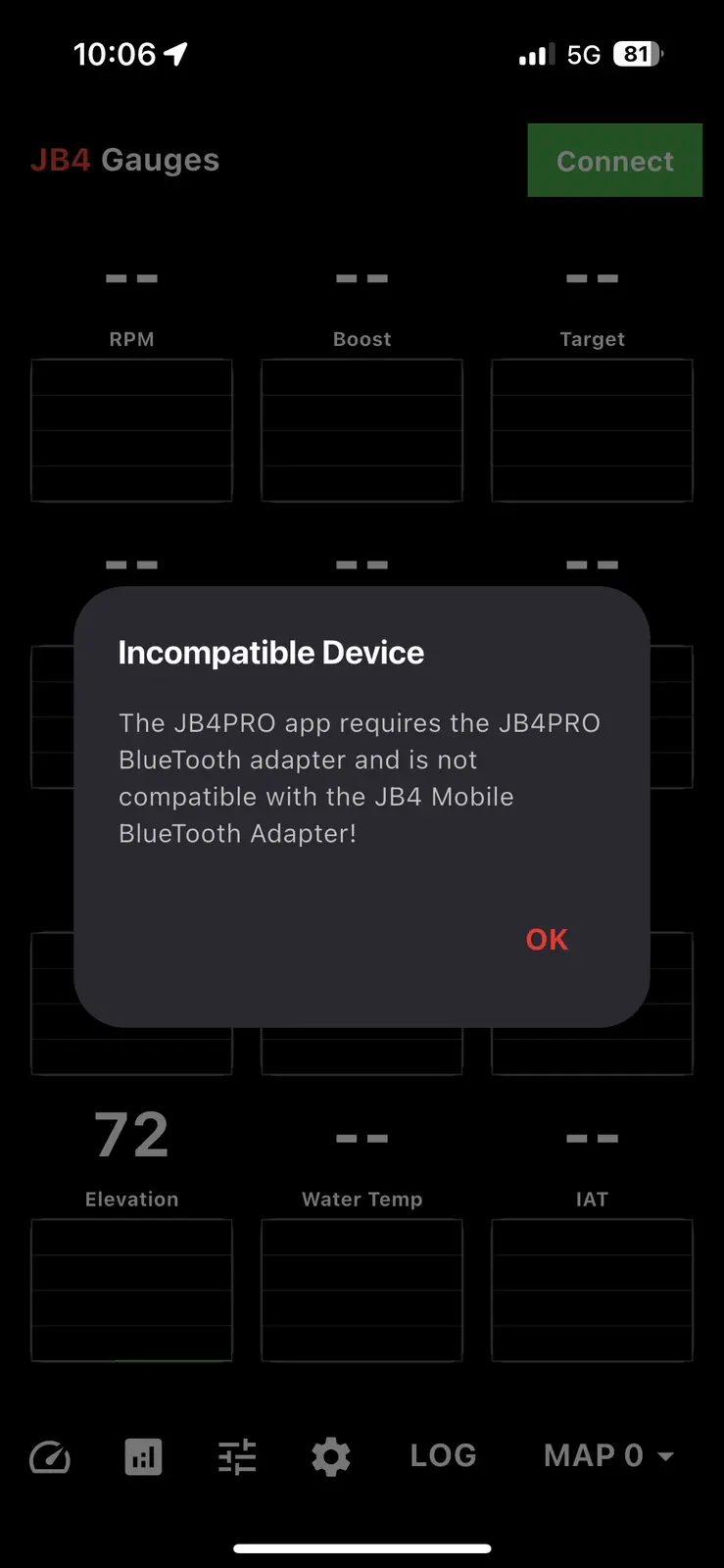

Good morning. Can anyone please help? Just installed the JB4 Pro IOS app (my jb4 came with the Bluetooth pre-installed). However my JB4 app does not connect and cant control the maps.
Help is much appreciated.

You’re using the wrong app you need to use a regular JB4 app. It’s confusing but go get the other one downloaded and it should work fine.
