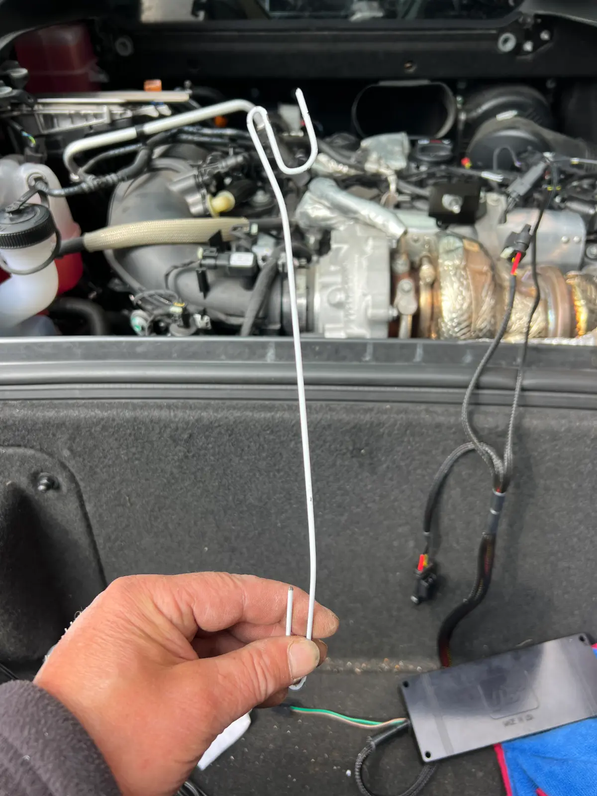

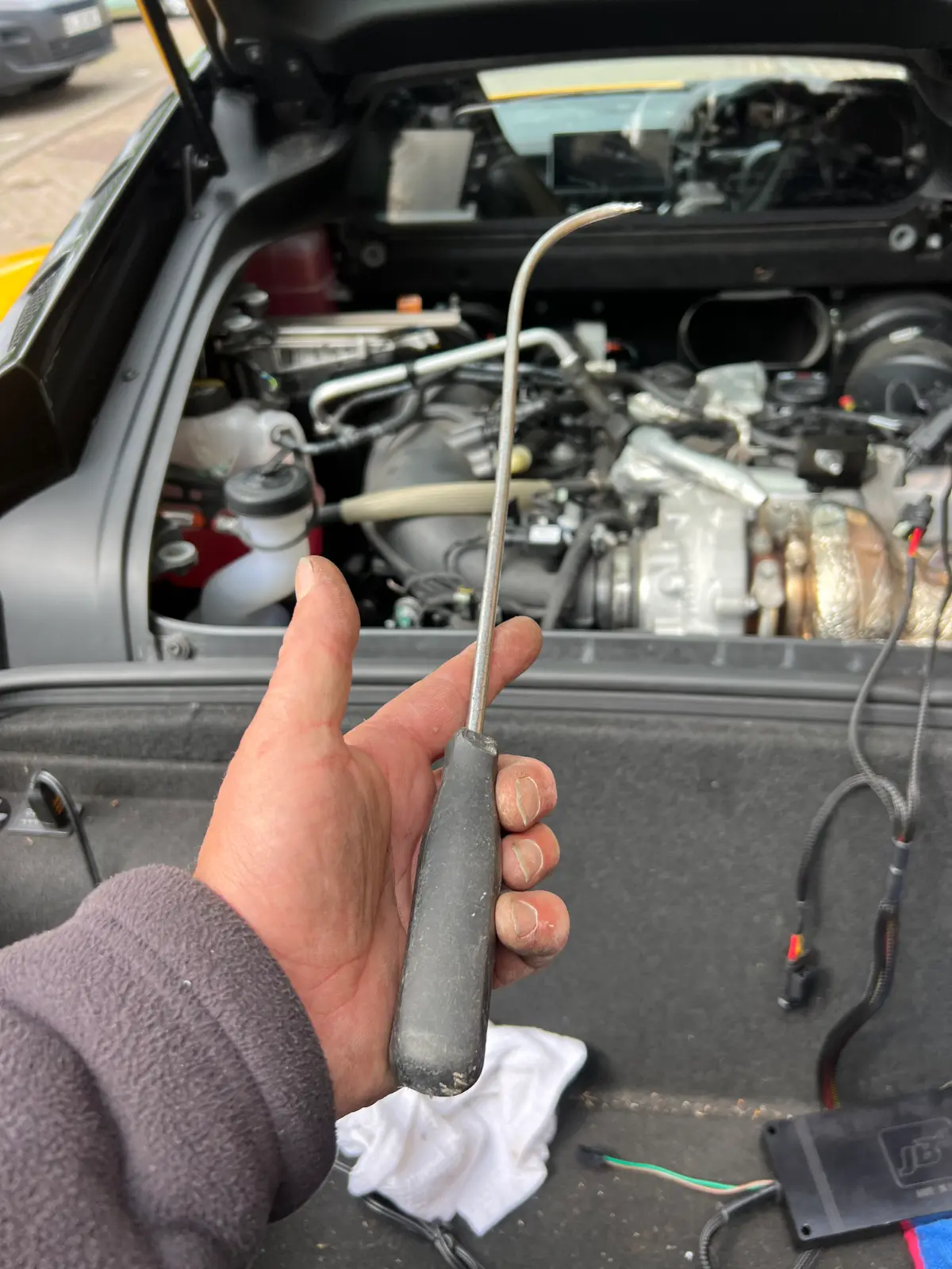

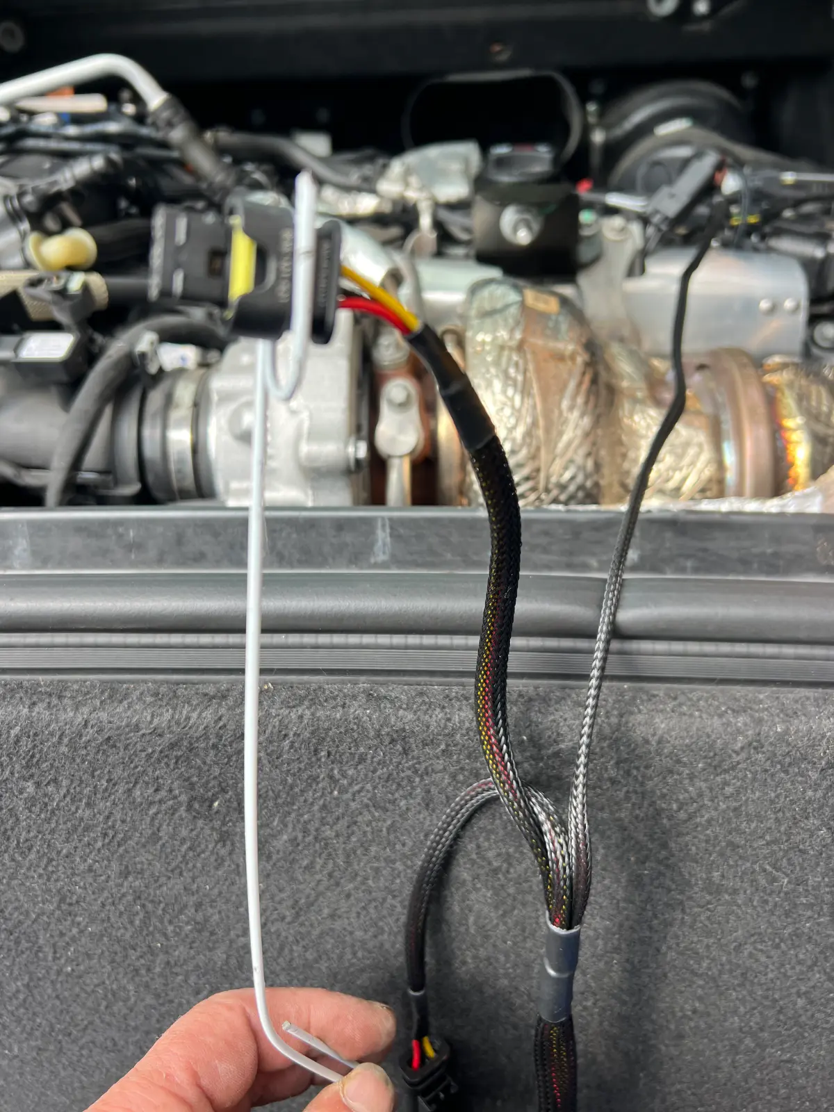

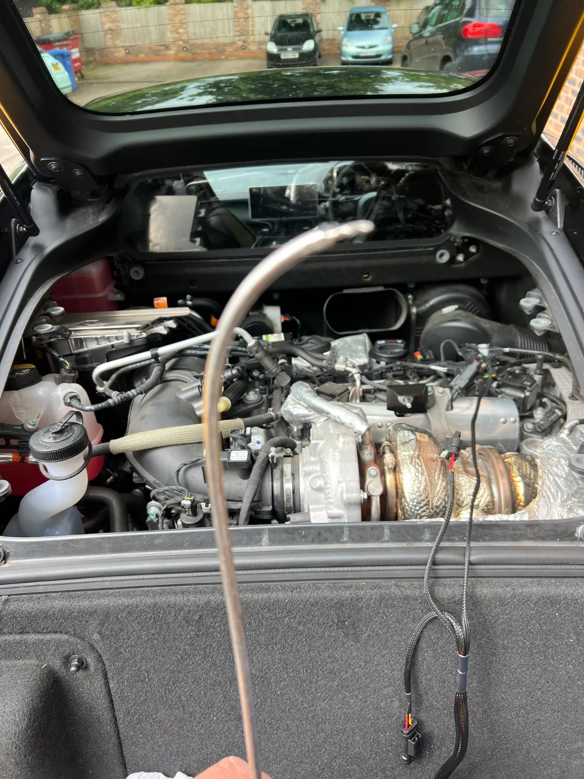

Hi guy’s,
I fitted the jB4 to the I4 2.0 turbo this afternoon,
The fitting instructions are very vague and wrong!
Burger say that there are 4 screws to remove from the charge cooler to get to the sensor there’s actually 6.
BUT you do not need to remove any screws to get to the sensor harness, you will need a very bright light to see the location of the sensor plug and you will need to make some tools to enable the removal re fitting of the plug.
I bent a long screwdriver to a right angle and angle ground the tip to a point to enable the removal of the original sensor plug (see photos 1 & 2 ).
This tool enables easy disconnection of the plug.
Once disconnected its is impossible to re -plug in the JB4 sensor without fabricating another tool to enable the re connection of this plug (see photos 3 & 4 ).
I used a coat hanger bent to form a helping hand shape so i could offer it up to the socket and soft insert it, i then used my fabricated long pick to push the connector home with a satisfying click once fully home.
The job took 3 hours to complete from start to finish, i used ramps and worked off the floor.
Now i have completed the job and know the location of the sensor plug and which tools are needed i can safely say that i will be able to reciprocate and complete the job within 45 minuets.
I ran the car only around the block to see if everything was in order no CEL etc, i could tell immediately that’s there was a significant power gain, i was in tour running map 3.
Once i get the OBD 11 cable fitted (tomorrow) i will come back and write up my findings but i know i am in for some fun future driving !!!.
Cheers MR69.

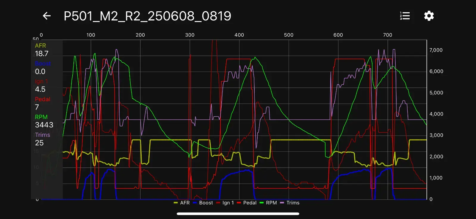

Posted in the install thread but here is the 93 map with ACN91 + Boostane Shot, Terry @ BMS gave it the OK based on logs.
It’s very pretty. Looks a bit like the Rockies. What’s its suppose to mean for us dummies? You def got my attention. 😊
It means Terry at BMS thought I was safe to use the Map 2 meant for 93 octane fuel with the shitty gas we got in California + an octane booster. AFRs richen up as load and RPMs climb and then lean out as you let off the gas.

Hi, everything is tight down there, but doable with 1/4 inch drive sockets and extension, however you do not need to touch the intercooler if you manufacture those 2 tools i pictured, you can get to the grey release tab on the connector with the pick and re fit it with the helping hand shaped wire tool..

That’s ridiculous, as i said in my post if i ever need to remove it I’m looking at 20 minutes to remove the undertray and 25 minutes to faff with the torch, pick and wire tool.
