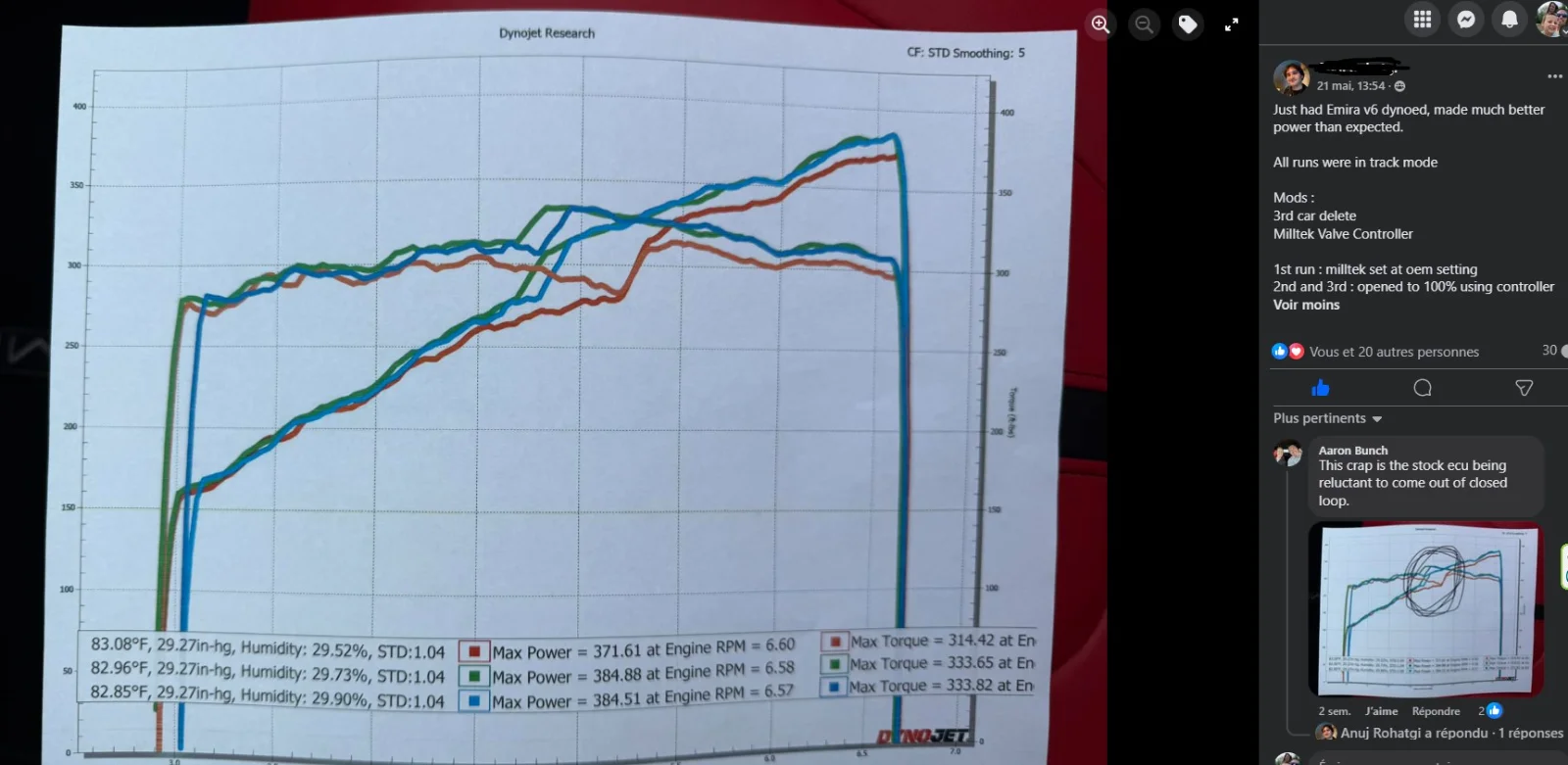

In that particular case, the 3rd cat delete with a milltek valve I think was the only mods done to his car and the dynojet sheet showed a +13 WHP.View attachment 65383
Actually the difference seems to be the Milltek controller in that particular case. All 3 runs are with the mods, that's not a baseline (factory) run in red. The blue and green runs are simply with the valve open.

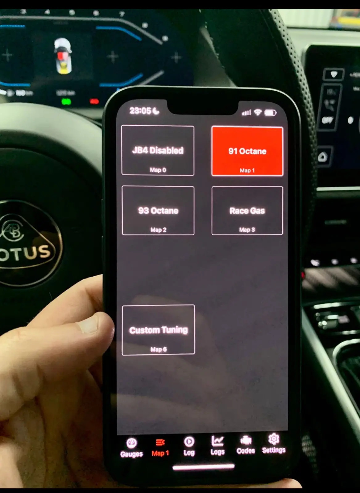

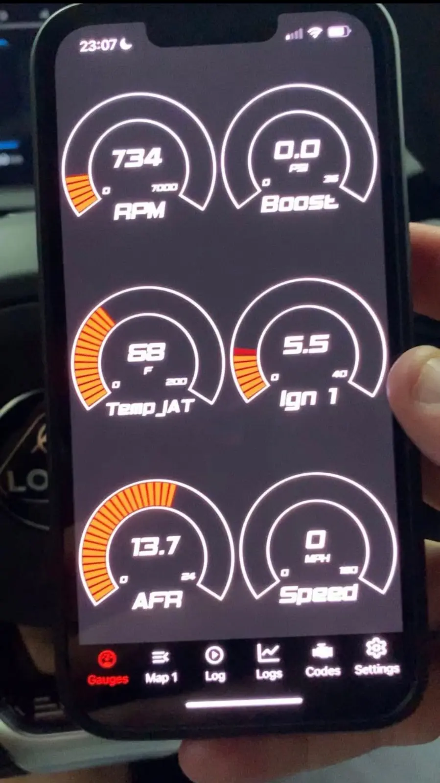

Just curious, how easy/hard is it to switch from the different maps?

That’s my dyno, and the shop is also surprised that there was such a big gain just with opening the valve.
My JB4 comes tomorrow and I’ll be installing it and running it on map1 for a week or so before switching to map2 even though i have 93 and thats what’s in the car right now.
Once I feel comfortable and it seems like it’s running well I’ll get it to do a dyno at the same place under similar conditions hopefully, and see the comparison.

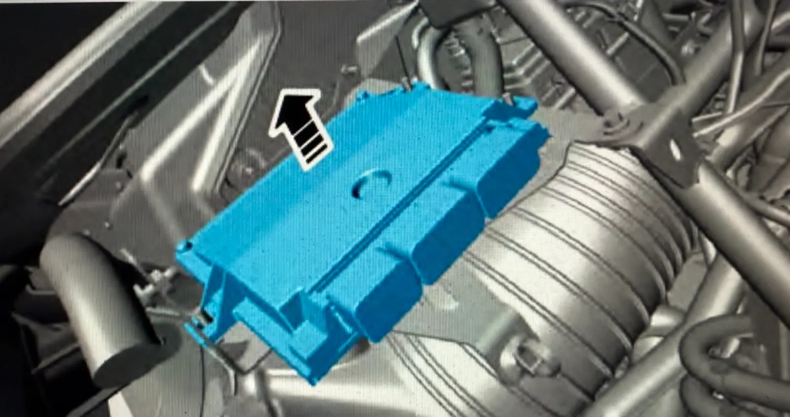

Maybe a not-so-wild-guess, but wouldn't a source be found in one of the ECU (ECM in Lotus vocabulary) module's harness connectors ?
Yes, I'm working on removing the side guards and intake to reach that as we speak. ECU will have the CANbus wires but hard to locate which two exactly out of the hundred wires going to it without a dealer schematic lol. Sometimes it's easier to find it on an ABS unit, etc as those are usually a twisted pair bundle.
Will keep you guys in the loop!
