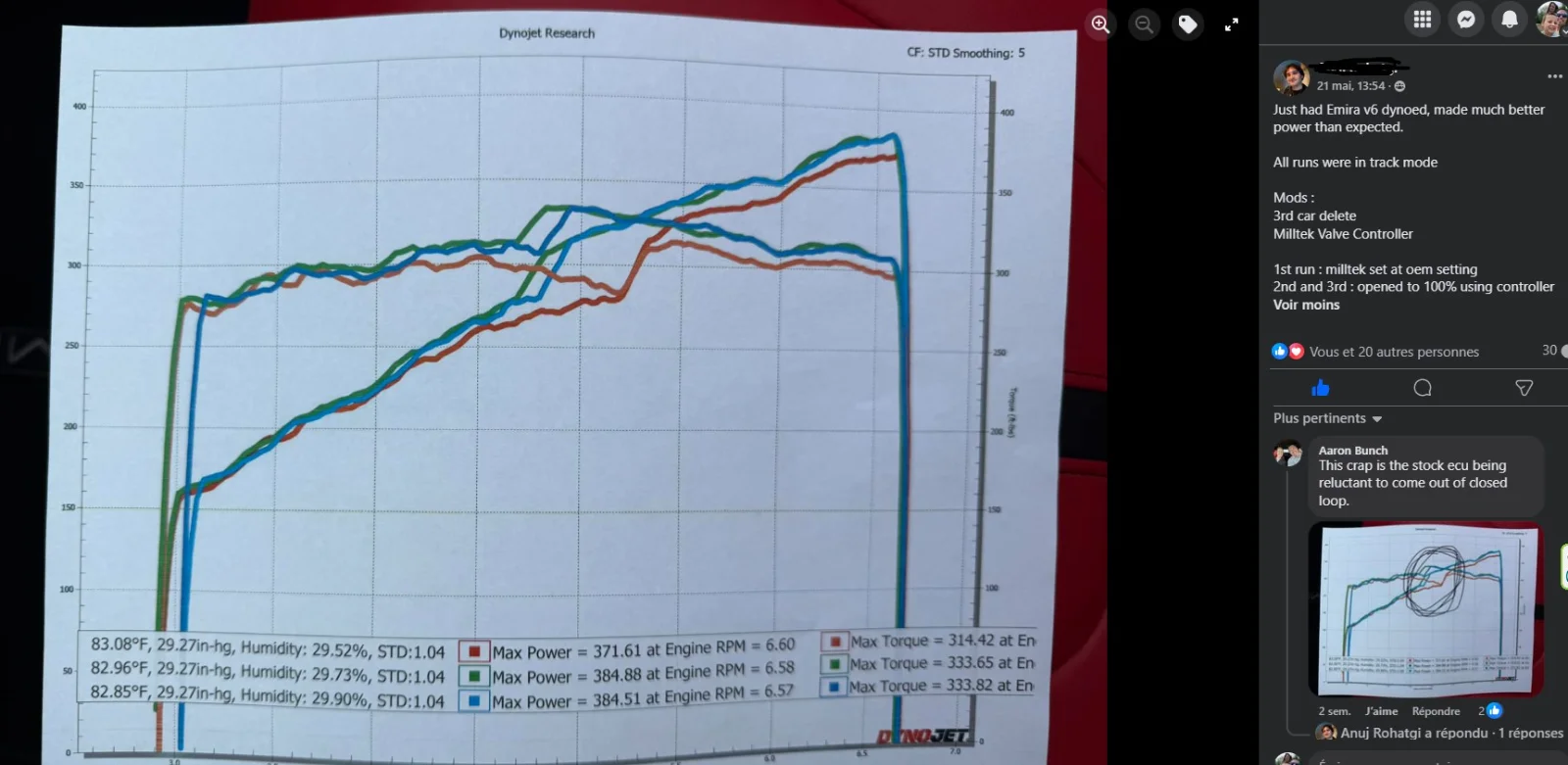

Myself I saw a before & after dyno onto Lotus Emira Owner USA facebook page.

In that particular case, the 3rd cat delete with a milltek valve I think was the only mods done to his car and the dynojet sheet showed a +13 WHP.

What I would expect it to do is what I saw with the Aerie Titanium exhaust, which was an increase in torque at the lower rpms. There's obviously a fair amount of back pressure from the 3rd cat and factory muffler that restricts power. Removing that should improve things, especially torque.
In that particular case, the 3rd cat delete with a milltek valve I think was the only mods done to his car and the dynojet sheet showed a +13 WHP.View attachment 65383
That’s my dyno, and the shop is also surprised that there was such a big gain just with opening the valve.
My JB4 comes tomorrow and I’ll be installing it and running it on map1 for a week or so before switching to map2 even though i have 93 and thats what’s in the car right now.
Once I feel comfortable and it seems like it’s running well I’ll get it to do a dyno at the same place under similar conditions hopefully, and see the comparison.

Actually the difference seems to be the Milltek controller in that particular case. All 3 runs are with the mods, that's not a baseline (factory) run in red. The blue and green runs are simply with the valve open.
