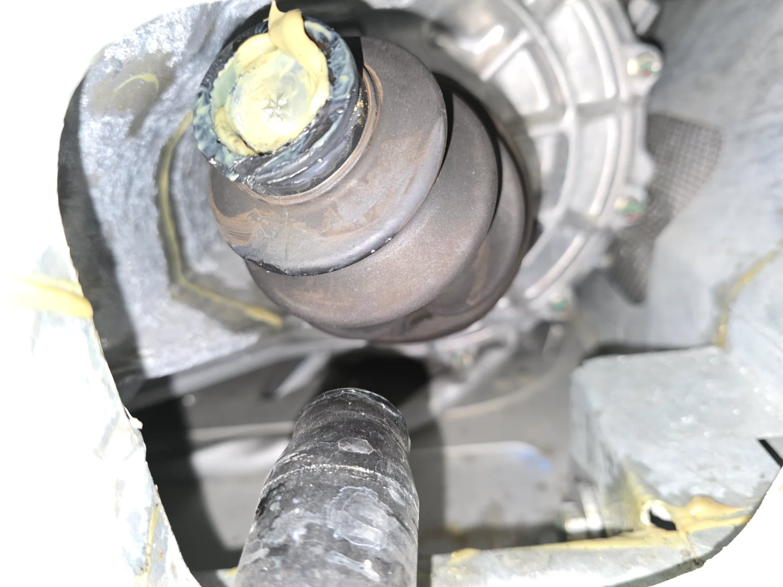

Welllllll! I broke an axle or something went to test quarter mile on the 93 octane tune (feels awesome BTW much more punch) but launched at right around 4000 and immediately the car just felt like it was in neutral and now I can fully let out the clutch in gear and you can hear something rotating and car doesn't stall.
So I know most of us know this but DO NOT clutch dump or even soft launch these cars. Waiting on the tow truck now. Really hope it's not internal to the trans but I'll get it sorted regardless.

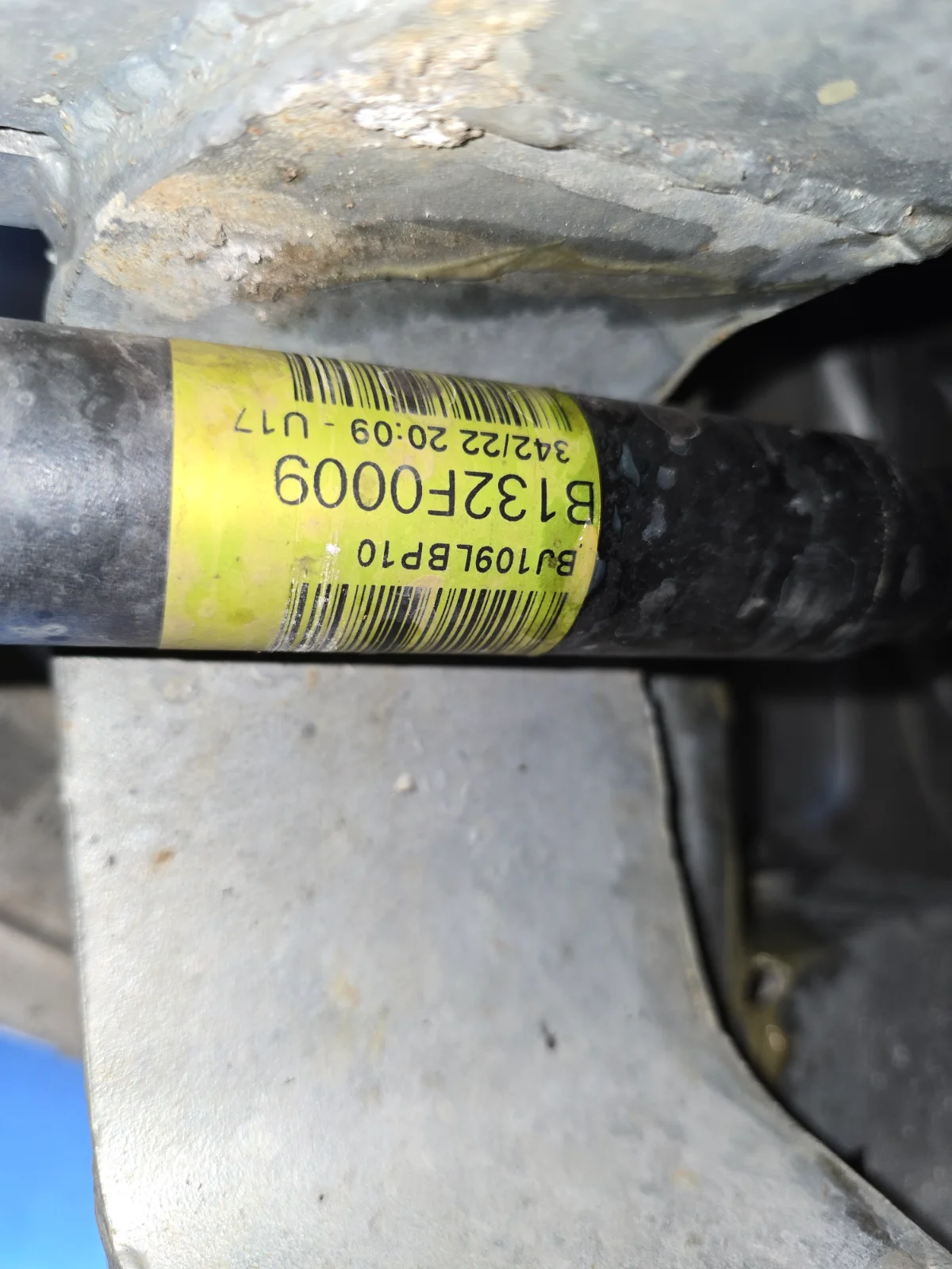

I'm not sure why this seems to be an Emira problem, but the axle is the same part number as the Evora
It's the axle!
@Six Speed Stephen That's my point, it should be identical and physically it likely is. It's the manufacturing source that's in question. I have noticed silly stuff on my Emira (washers, bolts, clips, etc.) where clearly "price" was the key driver in selecting a source. I don't remember these miscellaneous items being that cheap in quality in my Evora.

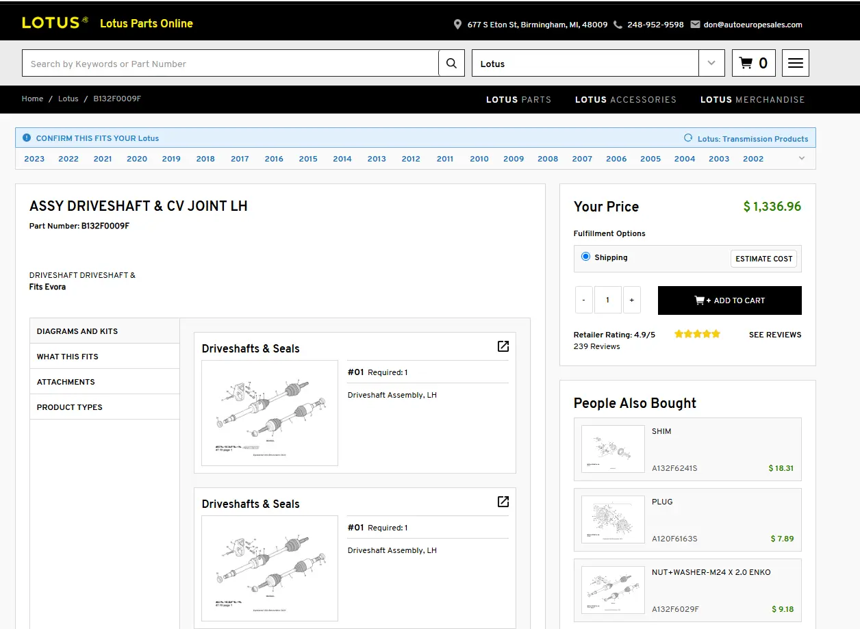

In my case I think just swapping the axle makes sense. Warranty work could get held up and if I had an axle on hand I could be back at testing this thing today easy. Let me go to Autozone and see if they have them 🤓
Yeah that's Auto Europe's store I've dealt with Don a bit in the past but now I have a local Lotus Dealer need to check with them and see if they have one in stock I'll do that now. Bell and Colvill has been a good resource overseas and in the past could save a lot of money getting parts that way without paying the US markups
Maybe a dumb question but is there a map "0" if I want to run the stock tune?
Bell and Colvill ask 899 british pound = 1 215$US.

wow, that's clean break. If everyone starts bring cars in for axel snaps, Lotus will ask dealers to start dumping the data logs, and start flagging cars.
[ but the axle is the same part number as the Evora]
Evora is lighter than the Emira, right? Have people been running 50 extra HP in the Evora's without issues?
Maybe the part just can’t handle the additional weight of the car
