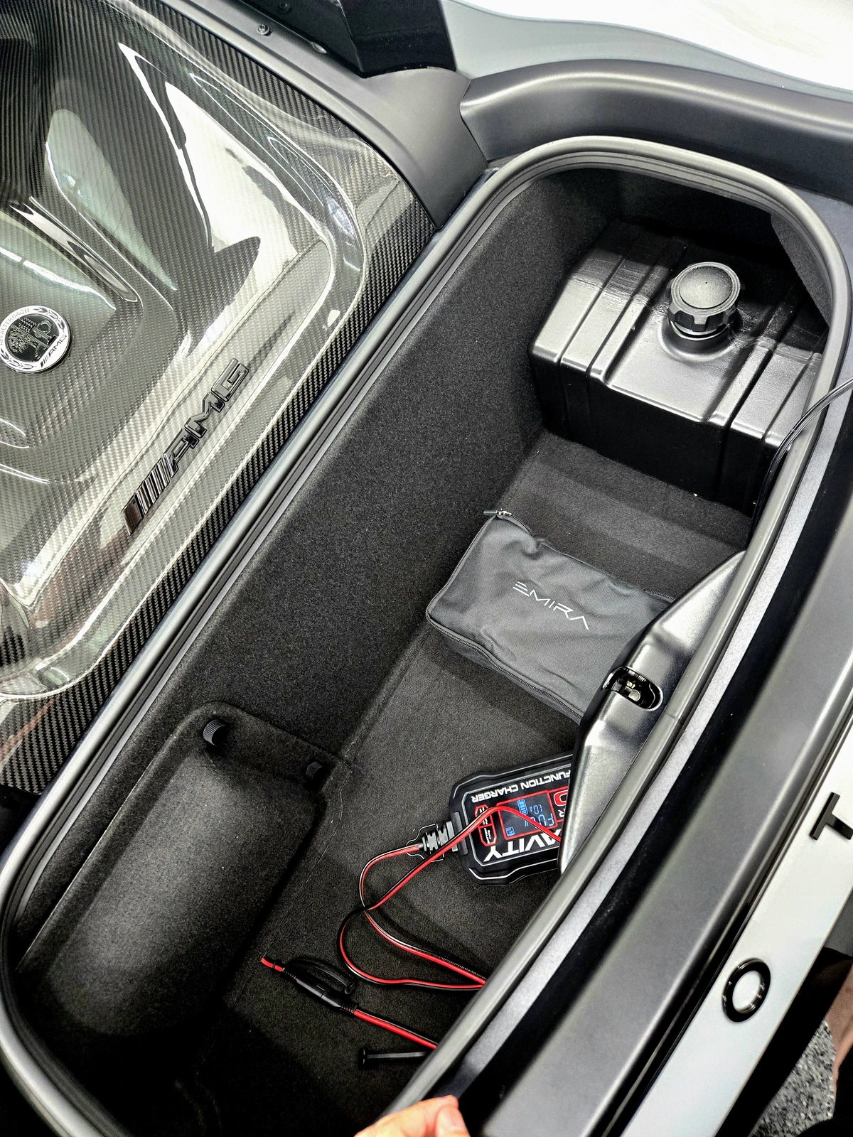

Just test fitting the Snow Performance tank, fits perfectly on the right side, this is 2.5 gallons
