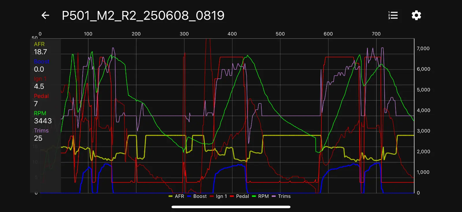

I have been able to capture a log with map1 but I dont understand well how the app work and for whatever reason my logs on map2 seem lost / not recorded… Disapointed. I will try to find watch online video to better understand how to record and save the log properly.
Talking about map2, I did a pull in second gear at wide open throttle from around 4K rpm in second gear until fourth gear. The car is pushing and stepping forward really hard, the supercharger noise is higher pitched. You can feel that the mecanic is pushed to the maximum. You will need good reflex to avoid hitting the cutoff into 2nd and 3rd gear because it climb fast and 6800RPM feel even shorter too low then before. With a 7200rpm limit we could shift at 6800-7000 without always being affraid to hit the cutoff.
I would not push my car with the map2 on a track for long period of time or drag the car in 1st gear because I feel like it is really pushing the envelopp into dangerous territory no joke.

You can export it in an excel format, with numbers that are easier to read.

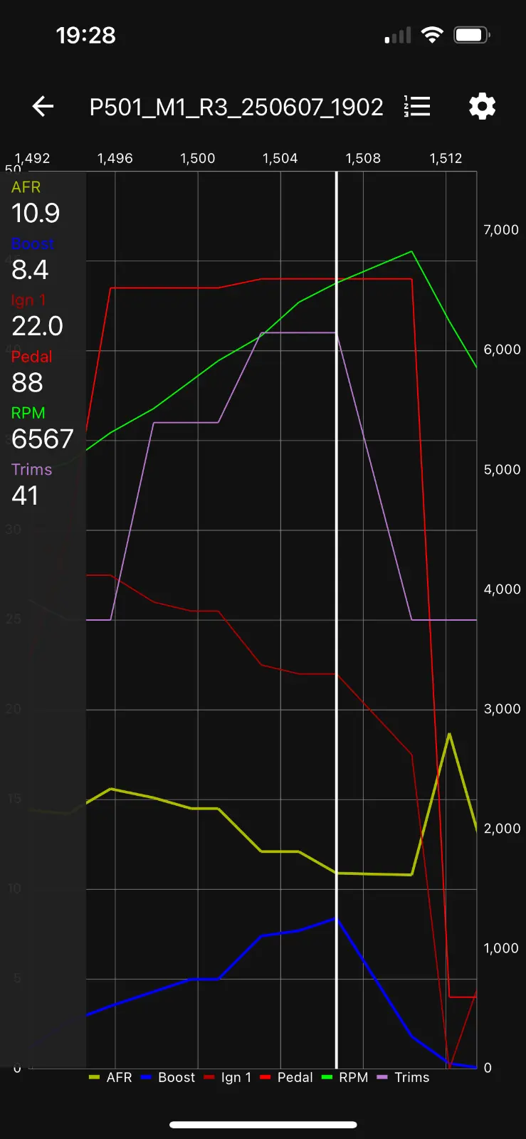

Do you have any mods on your car, like intake and/or exhaust? The AFR is running on the rich side, which I was wondering if that's by design, or just that your ECU hasn't adjusted to it yet.
93 Octane map on ACN91 with a bottle of boostane shot, Terry at Burger tuning just OKed it.
11-12 AFR at WOT & high RPM seem ok to me. Better to be on the rich side then lean.
Into the Rotary world Steeve Kan was tuning our RX-7 at 9-10 even richer.
At lower RPM during normal driving 14-15 is the target.
I may be wrong so Payam could correct me.
My mods are GRP cat delete - K&N air filter and Milltek exhaust valve.
