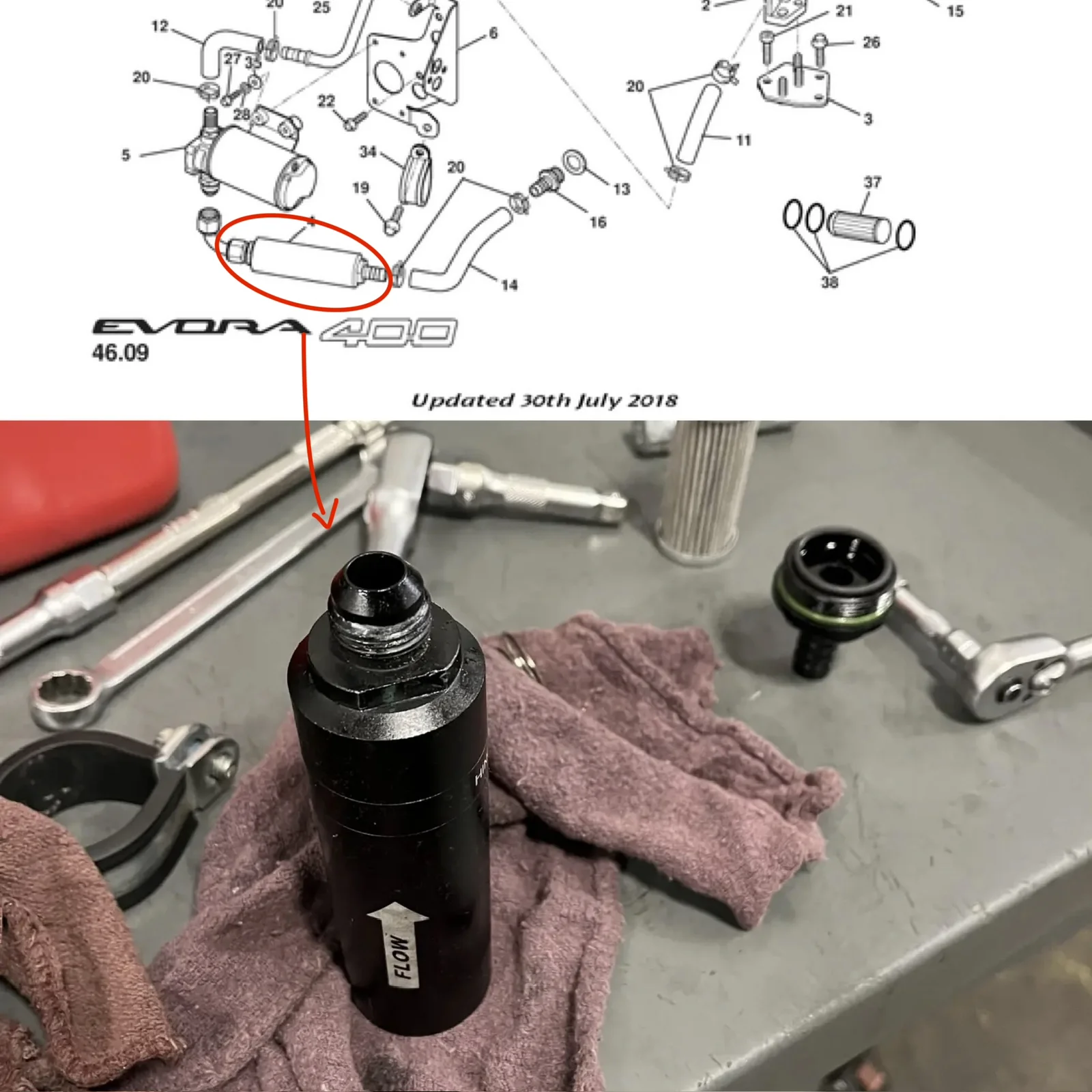

One thing, I forgot to look for the filter -- where do they hide it?
I did this gear oil change today, thanks for the tutorial -- it went perfectly! (I just turned 6,600 miles) Quick ride to heat it up afterward and assure the oil / filter change also went well --- shifted nice, minor but notably smoother. I used Red Line oil --- one thing I will mention, when you pull the sensor plug out to drain the oil, holy hell does it gush out, be ready!!
The filter is in-line and most don't bother changing it. It's kind of a PITA and the OEM metal filter can just be cleaned instead of replacing as needed.

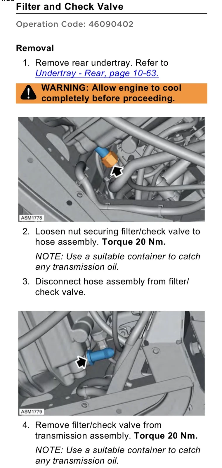

*edit: This is my experience with the Evora GT. @silent cilantro is correct noting that the Emira has a different setup.

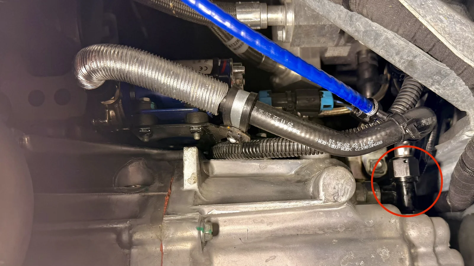

The Emira uses a slightly different filter setup than the Evora.
In the Emira the filter is also a check valve that attaches directly to the transmission casing. It connects via a hose to the inlet of the pump. The pump outlet then goes to a heat exchanger that is also shared with the charge cooler and from there back to transmission via the top/fill port.
Honestly I’m not even sure there is a filter in there, might just be a check valve. I didn’t remove it when I changed my fluid.
Evora’s filter is much larger and inline right before the pump.

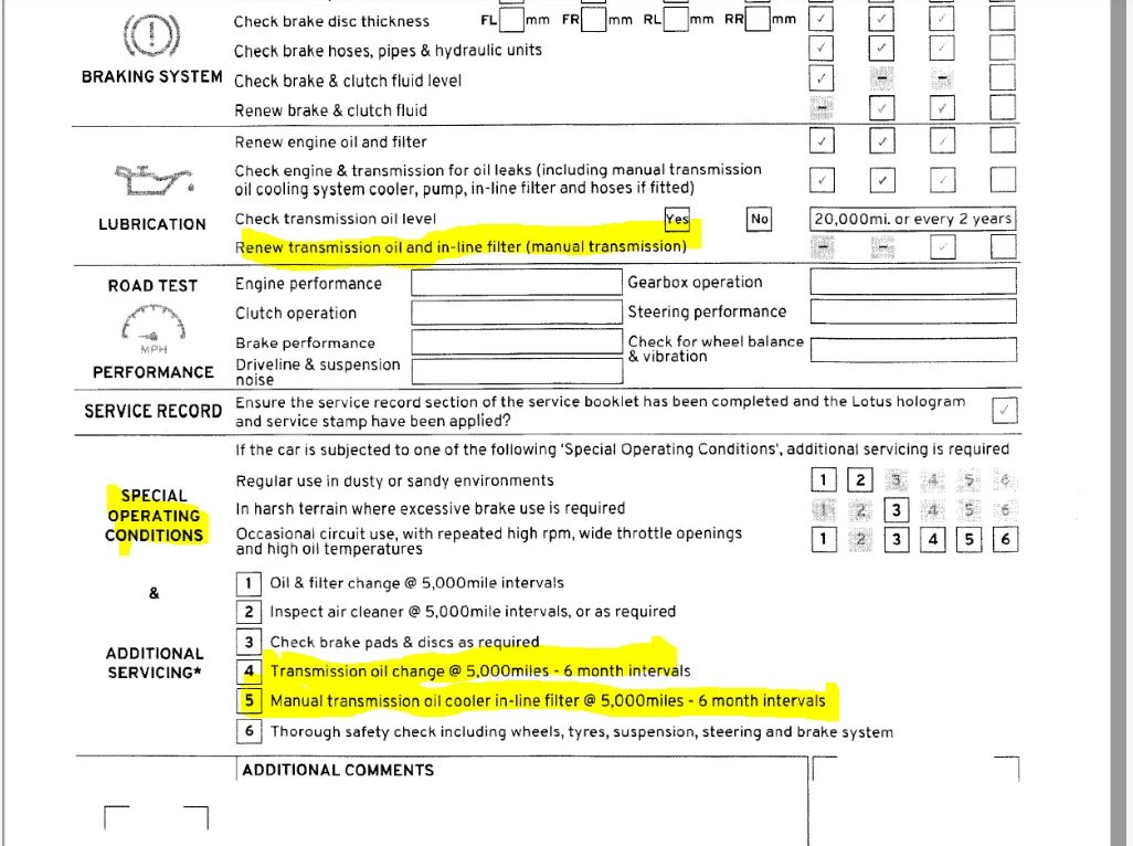

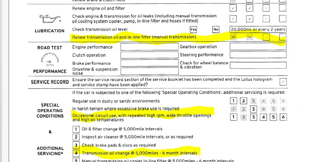

What page of the service manual is this from?
It looks to me like a generic servicing recommendation, possibly not specific to the Emira. Changing the trans fluid every 5k miles or 6 months is extreme. That's what I do for engine oil, and that's still pretty often for high end full synthetics.
It mentions that it is 5,000 mile change just for cars that are tracked otherwise it's 20,000 miles.
If the car is tracked then it's going to have a lot more wear and tear than an normal road car. I can see it would make sense to change the transmission fluid this frequently if the car is often on track and especially if an automatic.
Tracked or driven hard (high rpm) -- this is an easy job and less than $100 --- and it made my shifts much smoother! (I've driven it for good bit now since the change). It's gear oil -- and it takes a beating. Change it and feel good about it. :) FWIW, I used Redline: https://www.amazon.com/dp/B0041EDM6U?ref=ppx_yo2ov_dt_b_fed_asin_title&th=1
