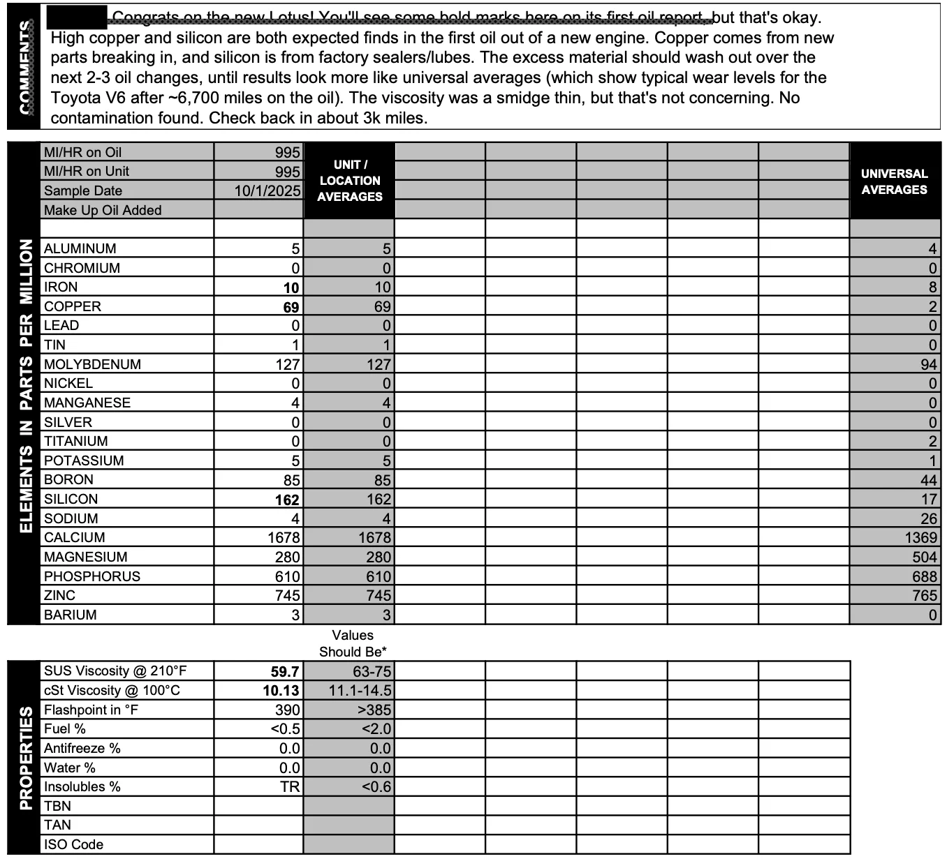

Oil analysis results for the 1st service after the break-in service. Running Liqui-Moly 0w40, magnetic drain plug and oem filter. Not sure how to make sense of the results.
For comparison purposes, here is mine:
Here is some information on what to make of oil analyses:

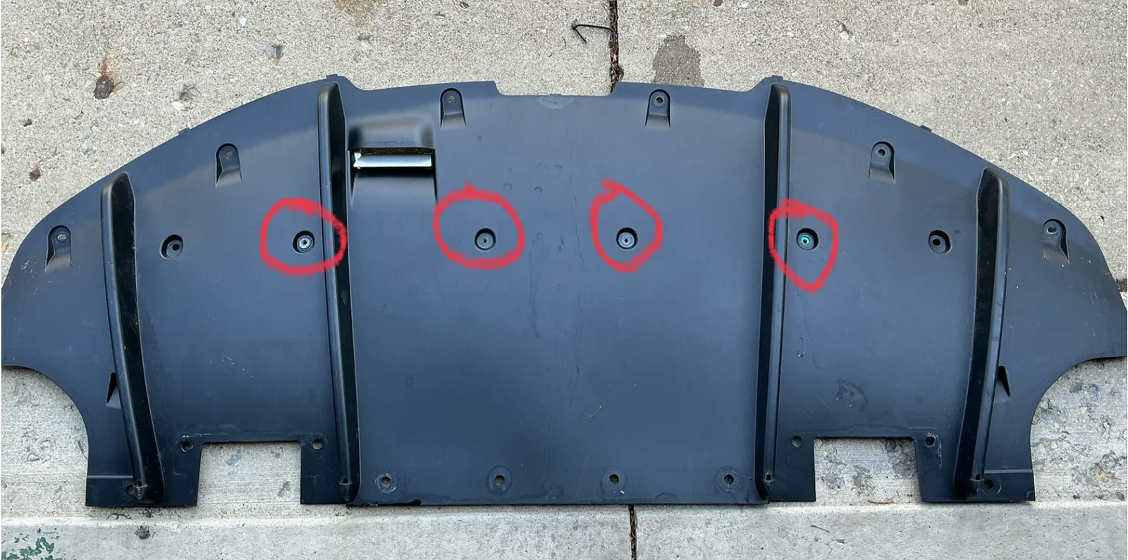

Hi all. I'm going to do my first oil change next weekend. I've watched a couple of helpful 'how to' videos that were shared on the forum but both of them involved taking the diffuser off in addition to the aluminum tray that covers the oil pan. Can anyone confirm if the diffuser (or some of the bolts that are supporting it) needs to come off to do an oil change? Thanks in advance for any advice.
You kinda have to remove the diffuser to remove the metal undertray.
Just realize you DO NOT have to remove the 4 interior bolts (circled in red) on the diffuser as they hold the support bar of the diffuser.
No, you do not need to remove the diffuser. Remove the circled red bolts only, not the green. You can pull down a little on the diffuser to loosen things, then slide the panel back towards the diffuser and the front will drop down.

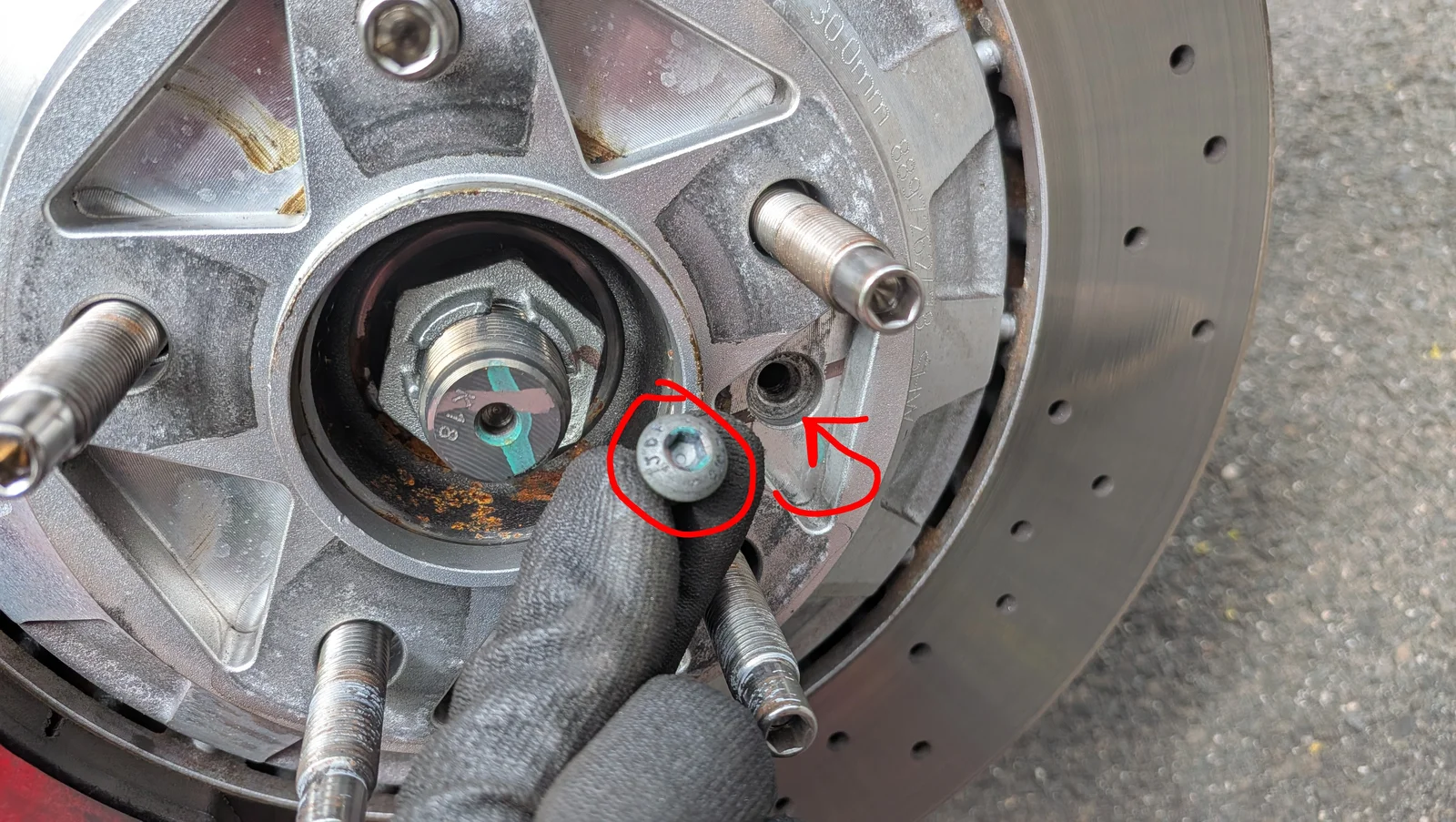

When taking one of the rear wheels off this bolt popped out of the hub. Does anyone know what it's for and if there is a torque requirement for putting it back on? Thanks!
