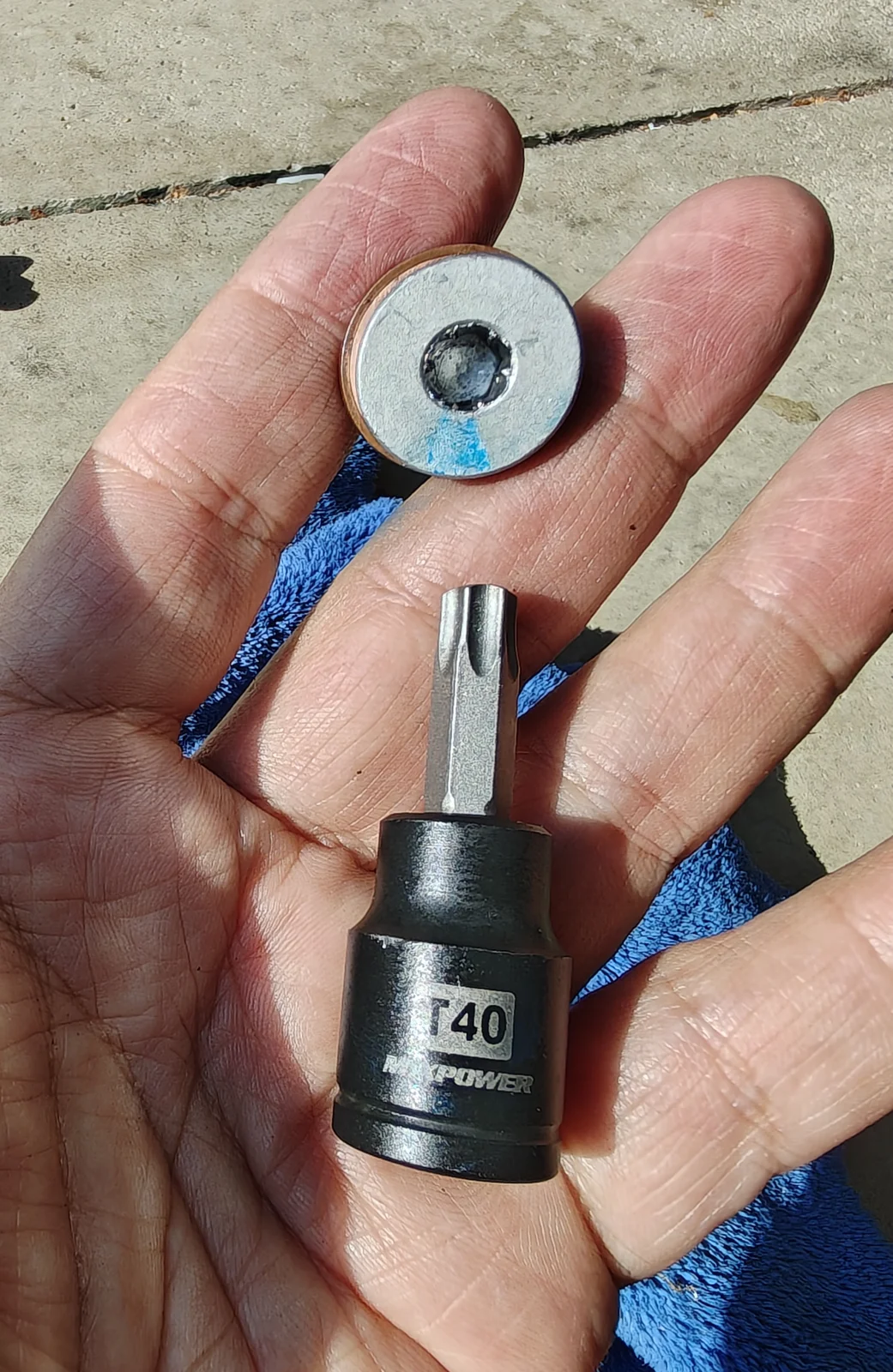

This drain plug option solves the stripping concern and adds a magnetic tip, which I love adding to my engines to keep circulating oil and the oil filter cleaner, which in turn is better for the longevity of your engine!

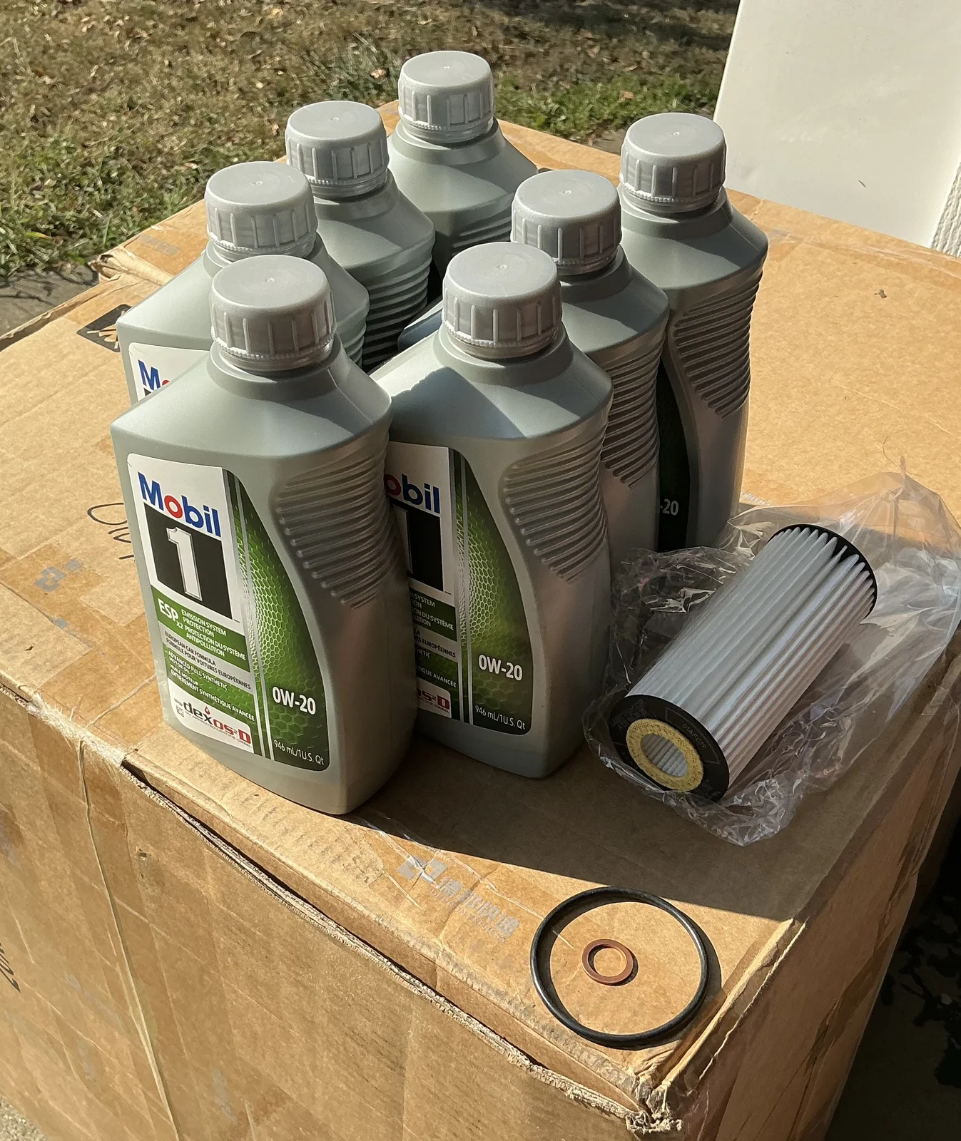

1. Obtain replacement filter, crush washer and filter O-ring. I got mine from my local Parts Manager for as a kit for $104.27 (#8896381034). The crush washer was separate at $4.17 (#8896272188).

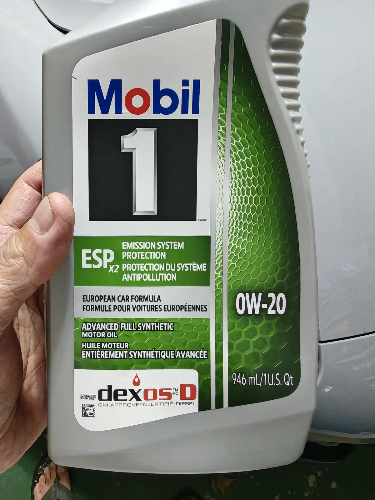

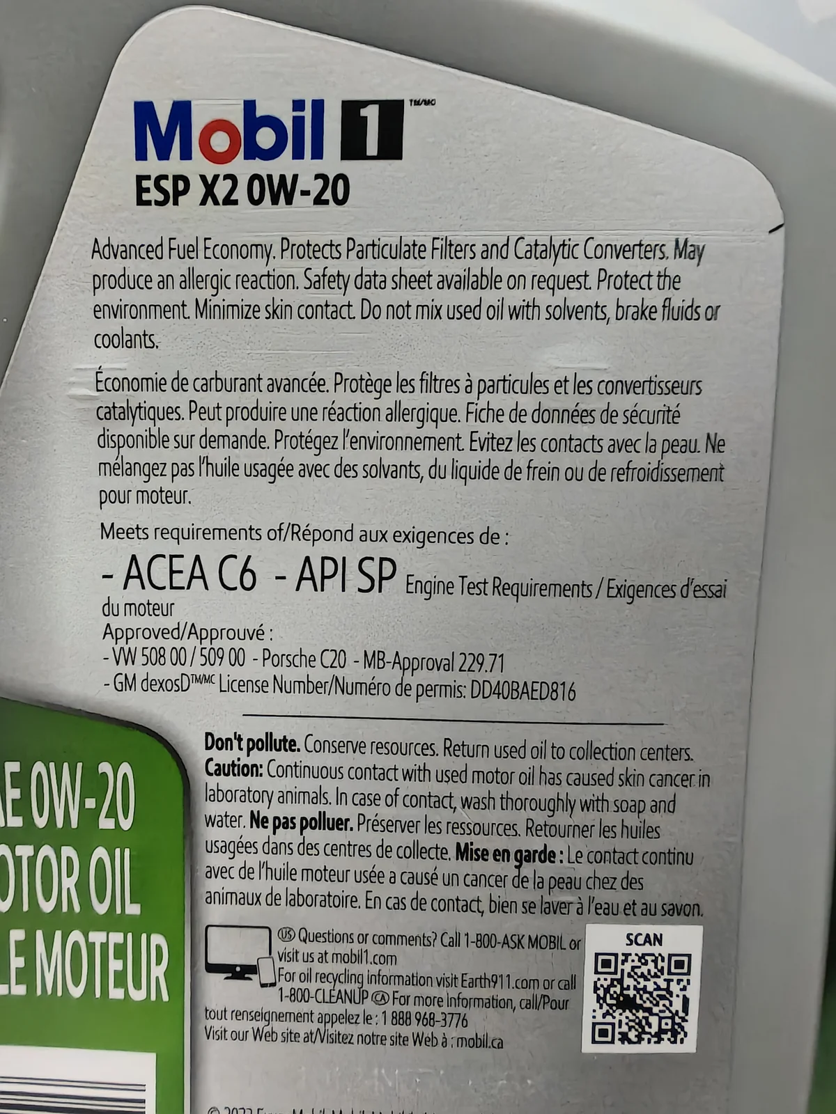

2. Obtain 7 qts of oil. My local dealer does all the exotics so Parts Manager said this oil was what they used for their oil changes. 7 bottles was $91.

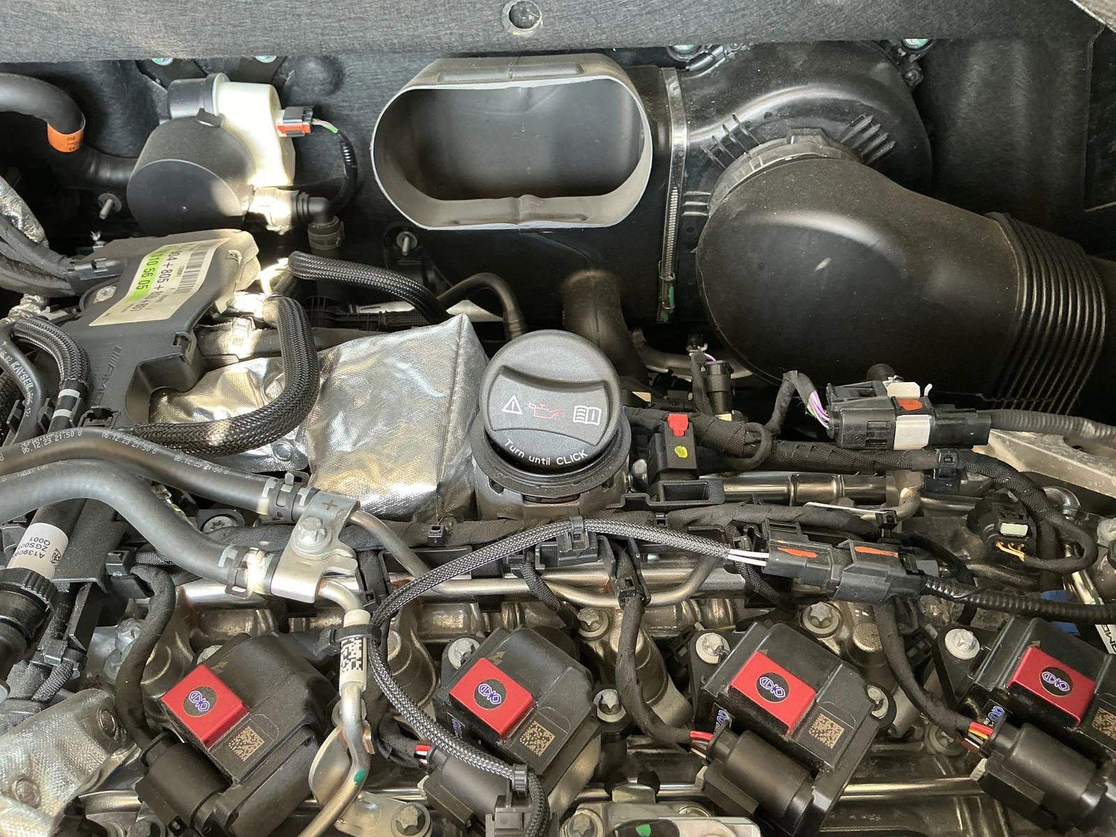

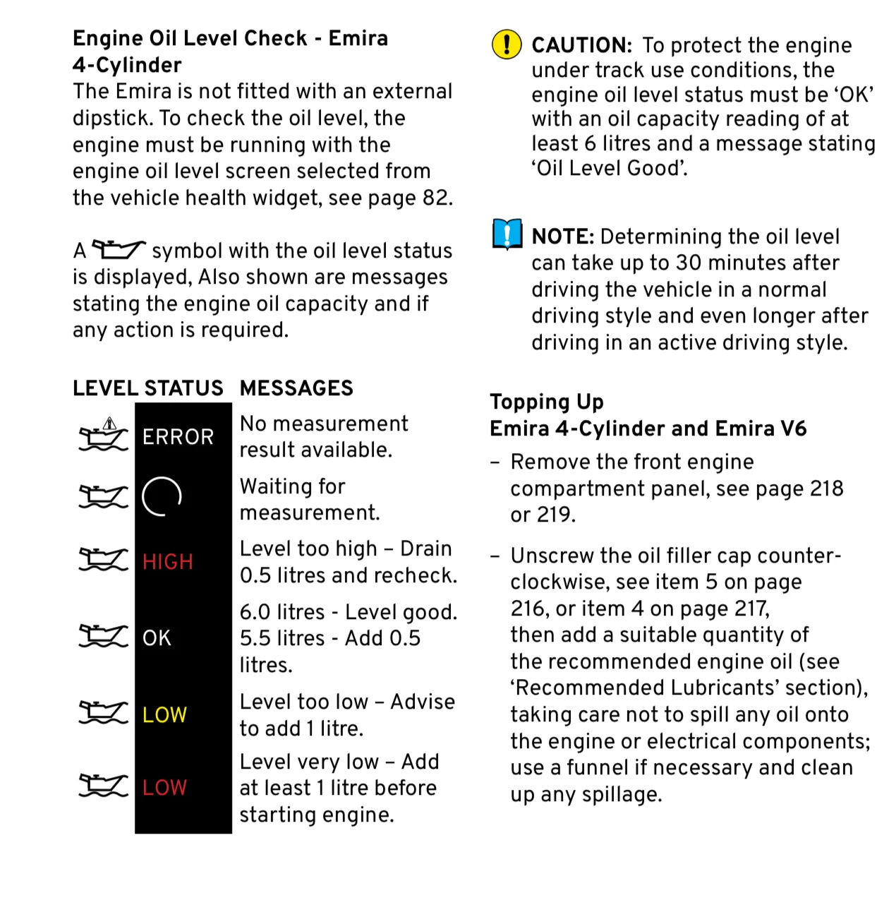

3. Remove oil cap in engine bay and insert a funnel. The i4 does not have a dipstick so you will have to use the onboard screen widget to assess oil levels.

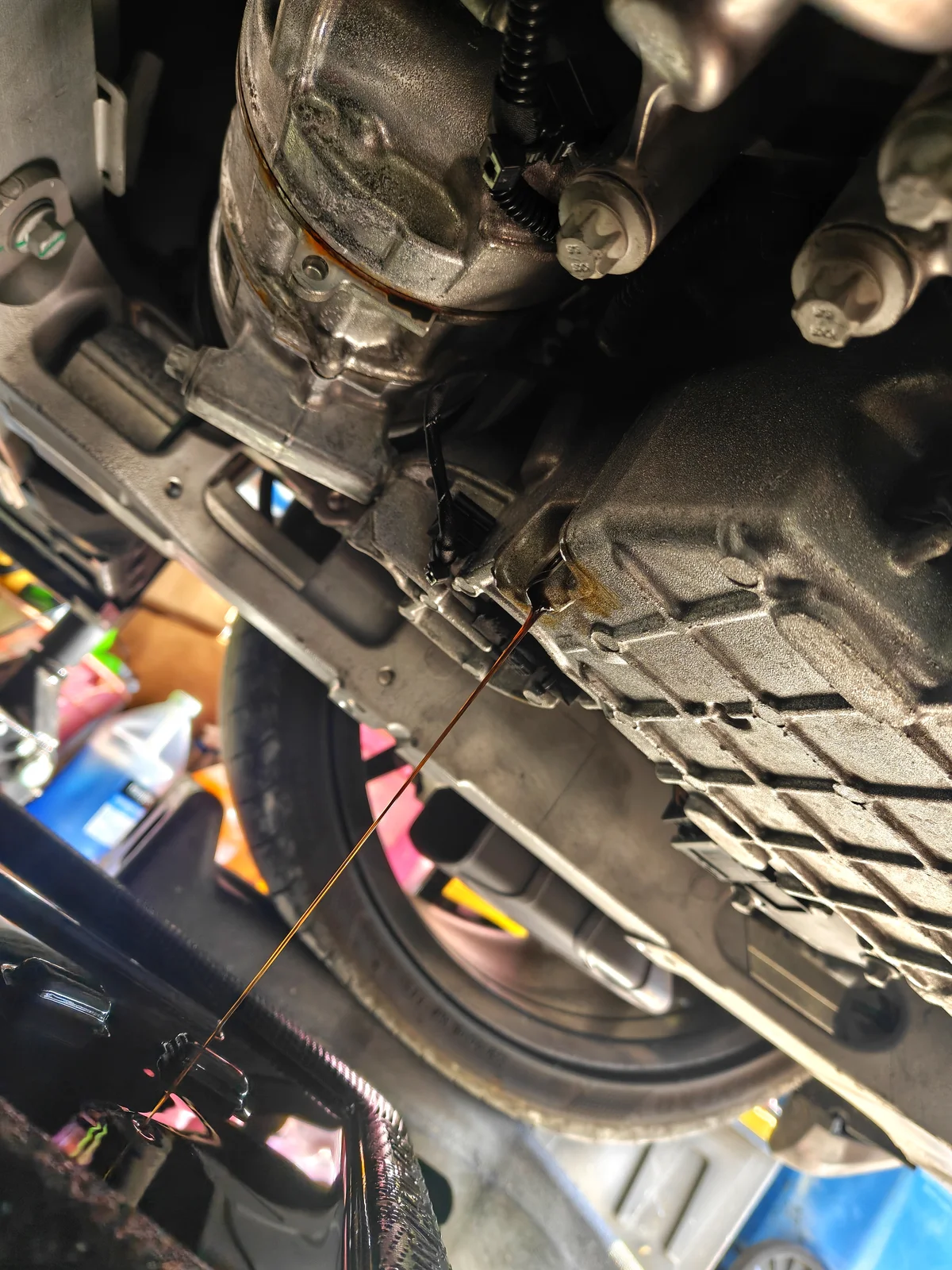

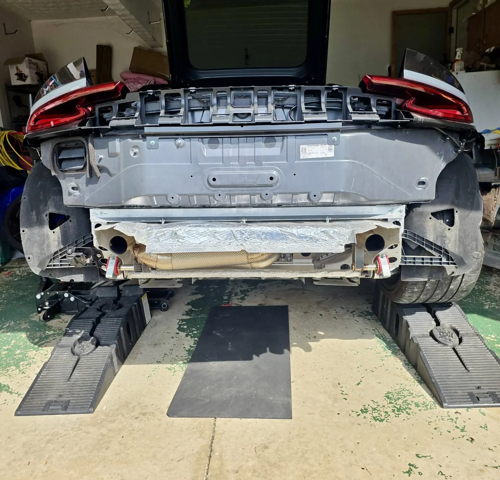

4. Remove rear diffuser and rear underbody tray.
5. Locate oil drain plug. Be super careful as it is a T40 Torx bit but you have to seat bit in drain plug as far as it can go and go slow! Drain plug seems to be slightly larger than T40 as it wiggles if not completely seated and will slip with torque.
6. Let oil drain. Replace (or reuse) crush washer on drain plug.
7. Reinstall oil drain plug. Torque to 40nM or 32 ft-lbs.
How hard is the removal of the rear diffuser and rear underbody tray? Thanks!
That was my plan, I have a slight decline on my driveway, which allows me to pull on or, in this case, back on to the ramps and keep the car perfectly level while providing a little more room with the declining drive. It appears, especially as it is my 1st time, that I will spend more time removing bolts and trays than changing the oil lolDepends if it will be your first time or your 30th time. LOL
But relatively easy, just a ton of bolts.
And I just jack the rear up high enough to put race ramps under the rear tires. Thats enough clearance for this.

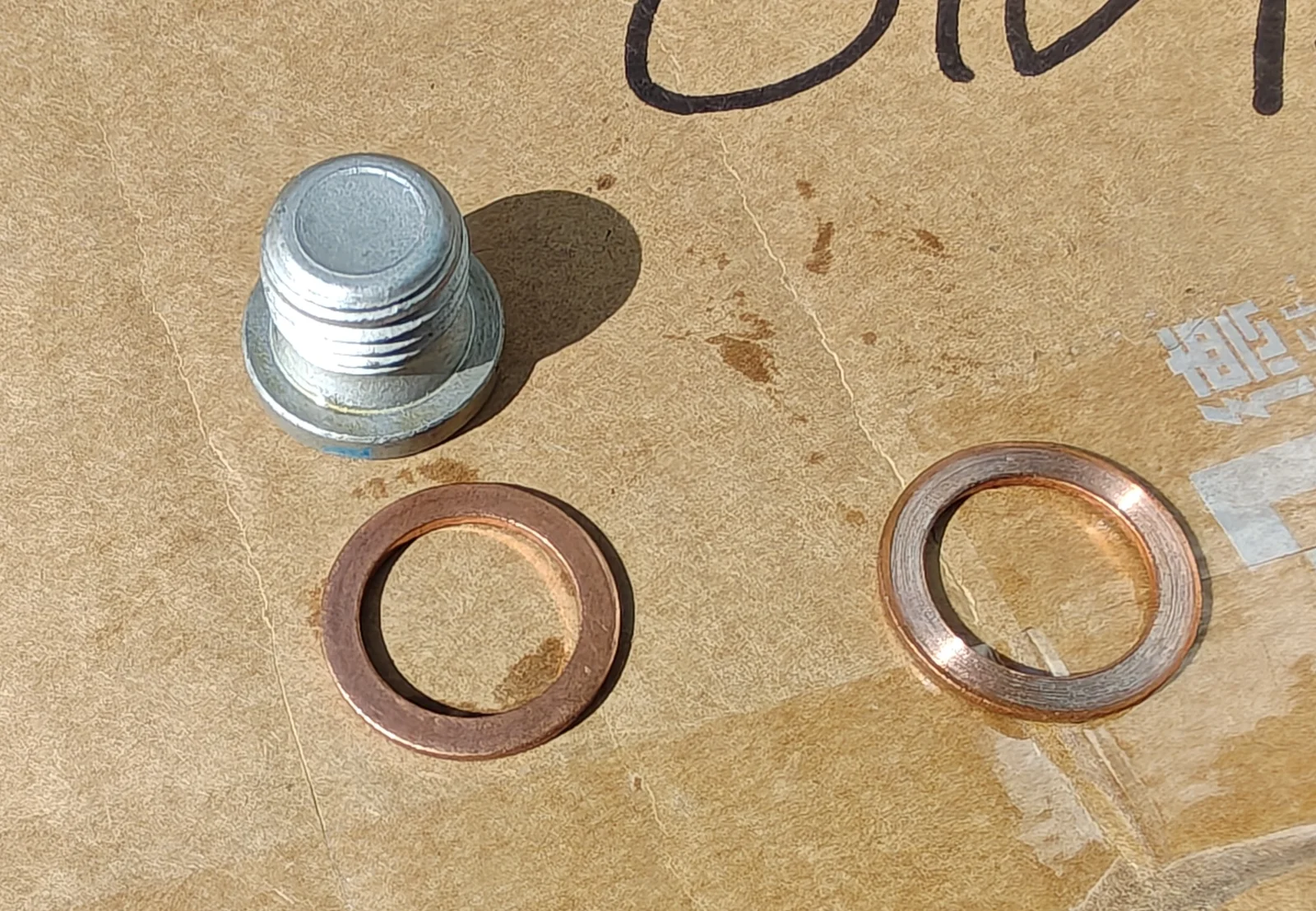

You want a 20mm outer / 14mm Inner - like these here - https://www.amazon.com/dp/B0FG7RHMH5?tag=emiraforum-20Does anyone have a link to a correct crush washer or Oil Drain Plug Gaskets?
Would these work? https://www.amazon.com/gp/product/B007OW6MD6/?tag=emiraforum-20
This is a nice upgrade as well. I plan to install it soon, as many have issues with the stock plug! Furthermore, this one is magnetic, which I love using, so you can see if anything major is happening, and it keeps the filter cleaner.Does anyone have a link to a correct crush washer or Oil Drain Plug Gaskets?
Thank you. I do plan on using the magnetic plug as well.This is a nice upgrade as well. I plan to install it soon, as many have issues with the stock plug! Furthermore, this one is magnetic, which I love using, so you can see if anything major is happening, and it keeps the filter cleaner.
I actually jack the rear up using the jack points and then slip the ramps under the rear wheels for clearance to remove the rear diffuser and the metal undertray.Can't quite tell (I haven't taken delivery of my I4 yet), but looks like you backed the car onto ramps? Would this then put the oil pan at an angle where not all the oil would drain out?
Ah got it. Presumably using a floor jack and doing one side at a time? Any concern with excessive torsional twisting of the frame to jack a corner that high? Asking because I'll be doing all my own oil changes, etc., after I get mine. Thanks!I actually jack the rear up using the jack points and then slip the ramps under the rear wheels for clearance to remove the rear diffuser and the metal undertray.
The drain plug is on the front side of the oil pan so it drains fine.
I have a sloped driveway, so I backed onto the ramps, but the car with the Dual Clutch makes it pretty easy to pull onto the ramps!I actually jack the rear up using the jack points and then slip the ramps under the rear wheels for clearance to remove the rear diffuser and the metal undertray.
