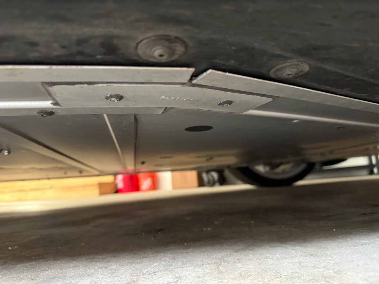

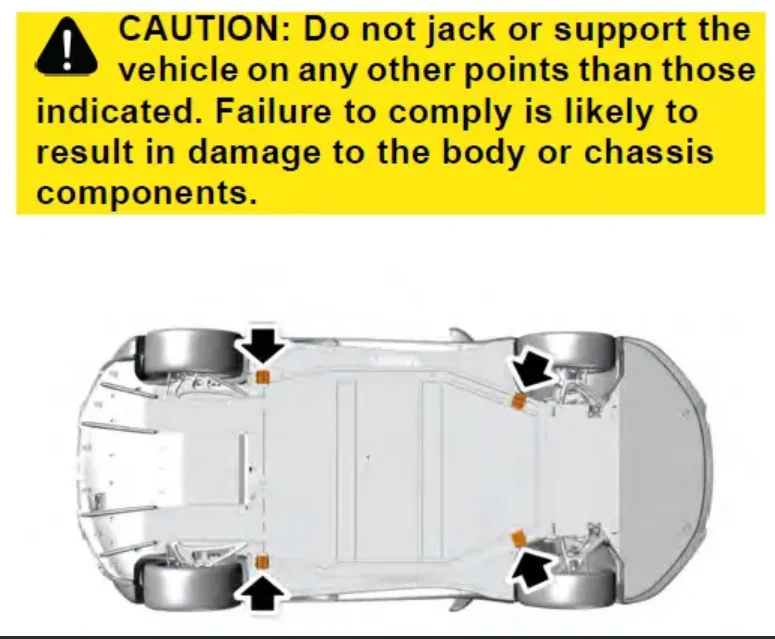

Hey everyone. The latest news from my dealer is that my Emira is going to show up in mid-October. I live in New York state and am going to buy a separate set of winter wheels / tires when (if?) the car materializes. I like to do my own basic maintenance and have been looking into how I can get the car up on jack stands to swap the stock wheels for the winter set. I have a low profile floor jack and four jack stands. I'm coming from a Subaru BRZ, which which you can jack both front wheels and both back wheels using central jack points on the front and back of the car.
I'd like to avoid buying a QuickJack or anything else expensive if possible. I've found a few different options after looking through forum posts and on YouTube and wanted to get input from the community.
  • Can I lift one side of the car high using any point along the side rail? Service manual images like the one below make me nervous that I would damage the car. Does anyone have enough experience doing this that they are fully confident this isn't dangerous?

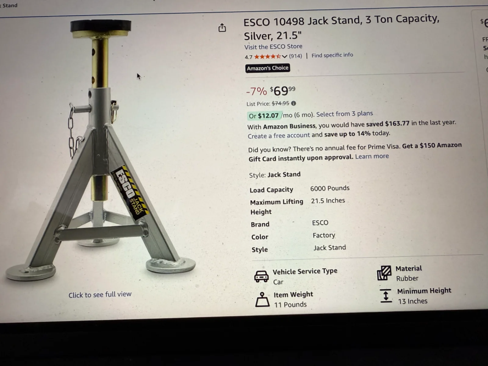

The Jackpoint jack stands look great but I'm not sure they get high enough. I was planning to do the third cat delete myself which is going to require a decent amount of work under the car.

Those warnings are all about making sure you don’t drop a car off a hoist when doing work. The car requires some extra thought when doing something like say removing an engine. The Evora guys and experienced Lotus people have been lifting via frame rails for a long time.

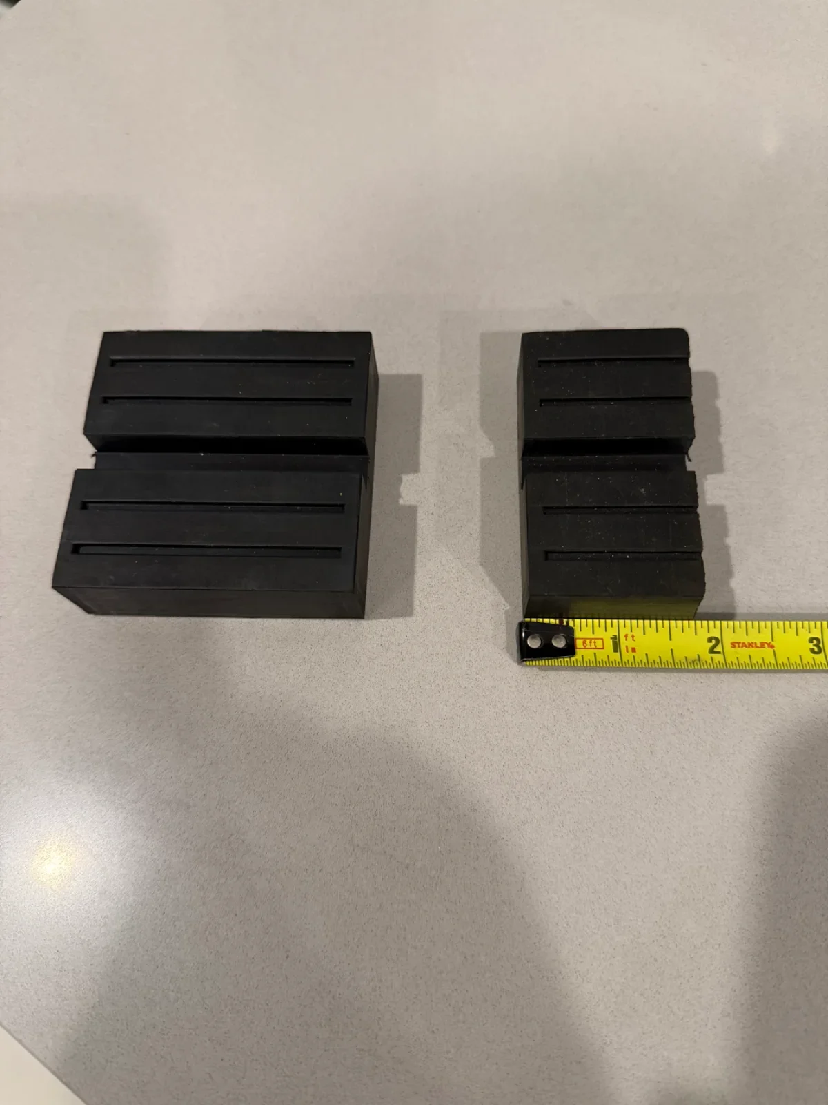

I installed the GRP 3rd cat delete (and many other mods and servicing)using these pictured jack stands and they provided more than adequate ground clearance to work. I also used an adapted rubber puck for my low profile floor jack by cutting it to 1 3/4" so it fits perfectly in to the indented groove of the frame rail. This way, you avoid catching and damaging any part of the under tray edges when lifting with the floor jack. As Kitkat stated, that frame rail is rigid enough to jack up the car at almost any section, and I generally place my floor jack in the middle section between the 2 wheels to lift the Emira enough and allow placing stands on the 2 designated points on each side of the car. Hope this is somewhat helpful.
View attachment 70923 View attachment 70924
Where were able to buy those pucks?
Amazon. Here you go... Btw, I cut it with a hack saw.

I'll start by saying I only use the designated manufacturer jack points, to be 100% certain I'll not damage anything. That's just me, so you choose otherwise as others have done. I had 2 low profile floor jacks which I used on my other sport cars. Unfortunately, I can use them only on the rear wheels of the Emira. When you look at the handbook photo posted above by jbug187, you'll see the front tire jack points are located further underneath the Emira. My low profile jacks wouldn't reach that far in. I bought a cheap scissor/screw jack which isn't ideal, but it works. I talked to a old mechanic who said "back in the day" they used to make low profile jacks that would extend further underneath, but you can't find them anymore. If someone proves that wrong, please post the info. I'd prefer to not to use the screw jack, with its extra time/hassle.
If you jack the back up far enough it will start to lift the front wheel off the ground. Just another indication of how strong the chassis is. Then you can slide a low profile jack under the front jack point if you want to. But as others have stated you can jack from the frame, just use something that won’t mar the frame. I use a rubber jack puck and place it where the front part of the frame rail is attached to the main frame rail.

Ive used the Arcan Extra Long Reach Low Profile floor jack off Amazon with a rubber hockey puck for the Emira and the 4C for years which works well.
