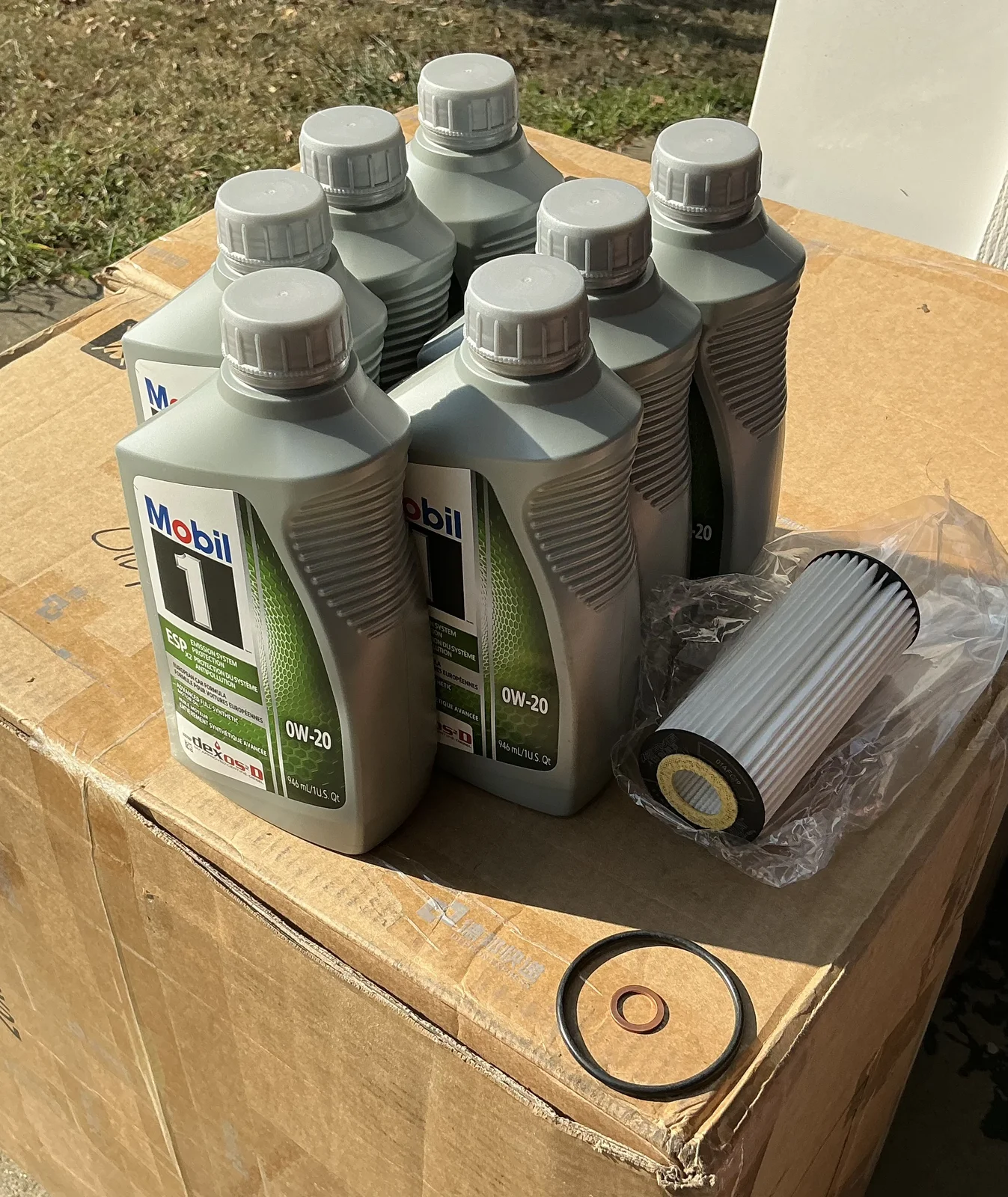

1. Obtain replacement filter, crush washer and filter O-ring. I got mine from my local Parts Manager for as a kit for $104.27 (#8896381034). The crush washer was separate at $4.17 (#8896272188).
2. Obtain 7 qts of oil. My local dealer does all the exotics so Parts Manager said this oil was what they used for their oil changes. 7 bottles was $91.

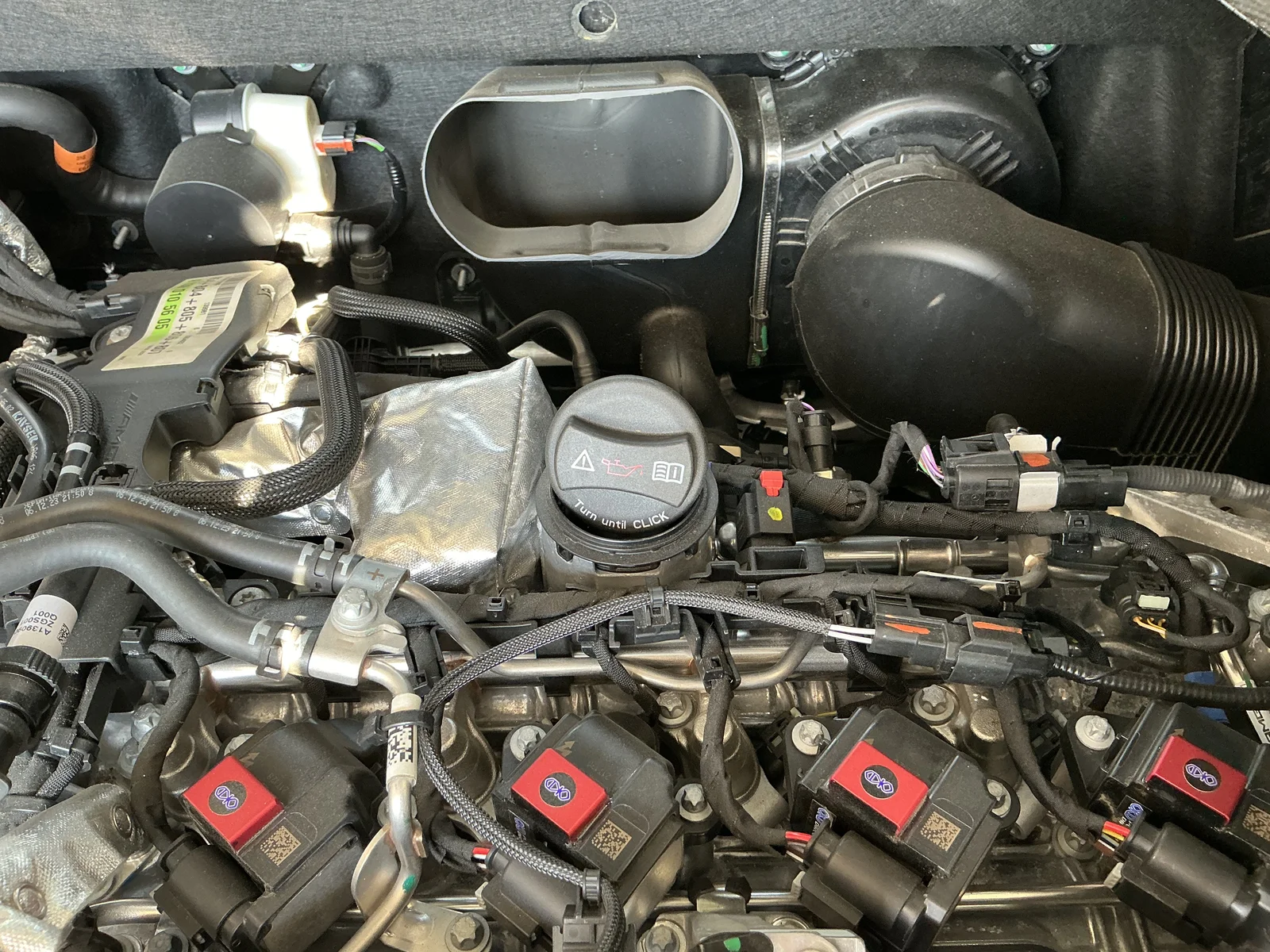

3. Remove oil cap in engine bay and insert a funnel. The i4 does not have a dipstick so you will have to use the onboard screen widget to assess oil levels.

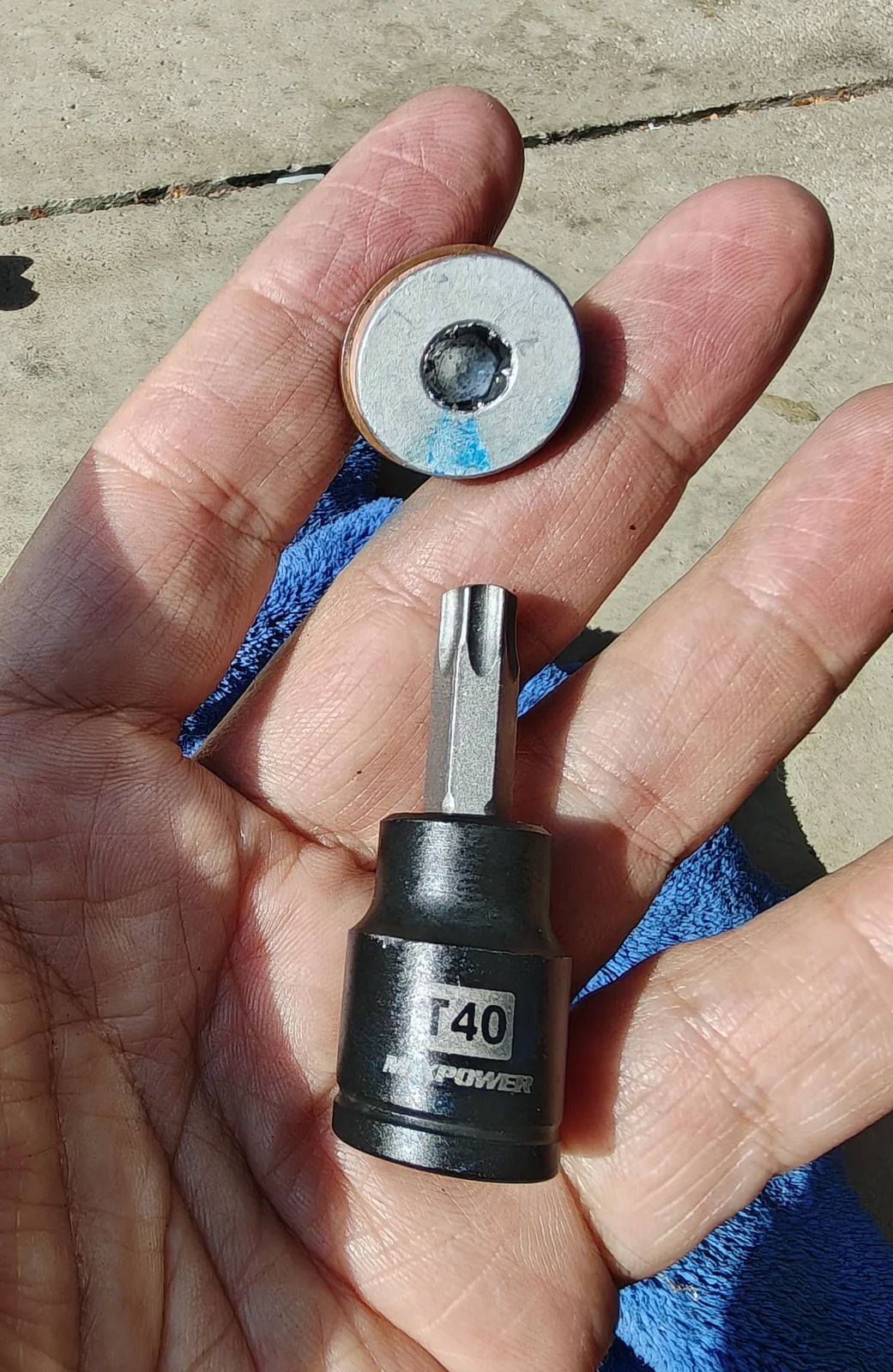

5. Locate oil drain plug. Be super careful as it is a T40 Torx bit but you have to seat bit in drain plug as far as it can go and go slow! Drain plug seems to be slightly larger than T40 as it wiggles if not completely seated and will slip with torque.

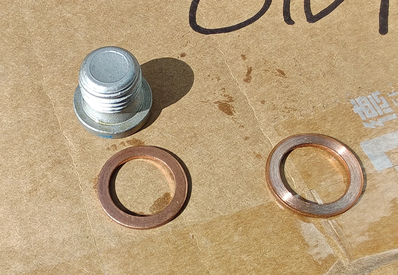

6. Let oil drain. Replace (or reuse) crush washer on drain plug.
7. Reinstall oil drain plug. Torque to 40nM or 32 ft-lbs.

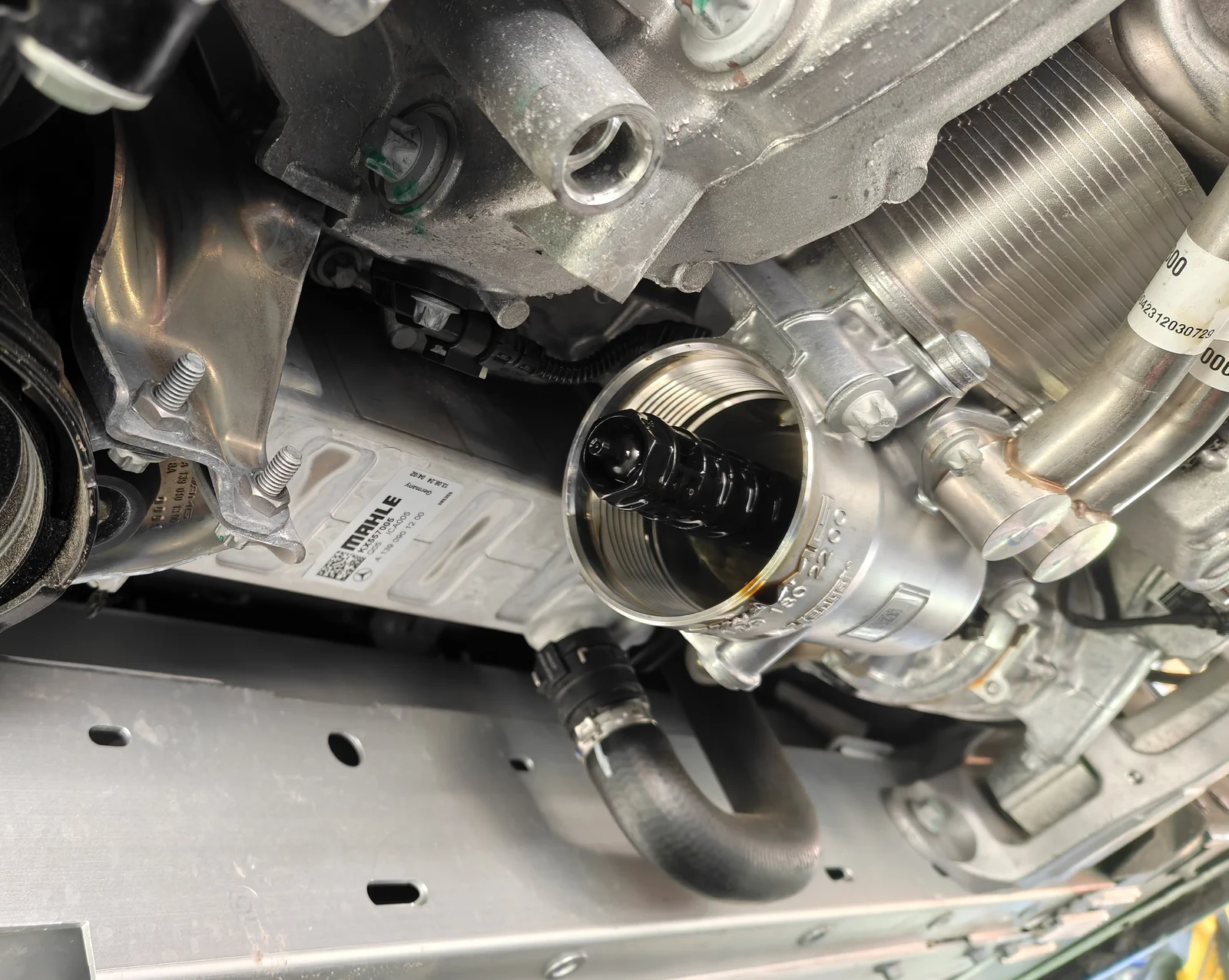

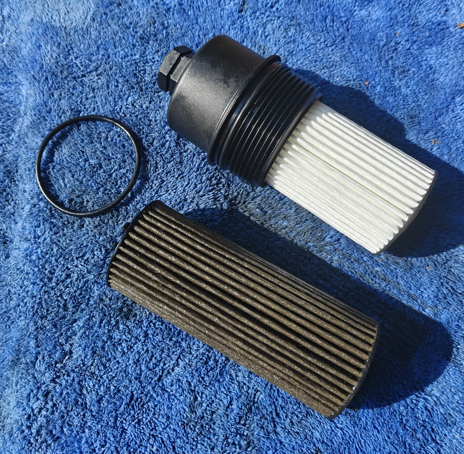

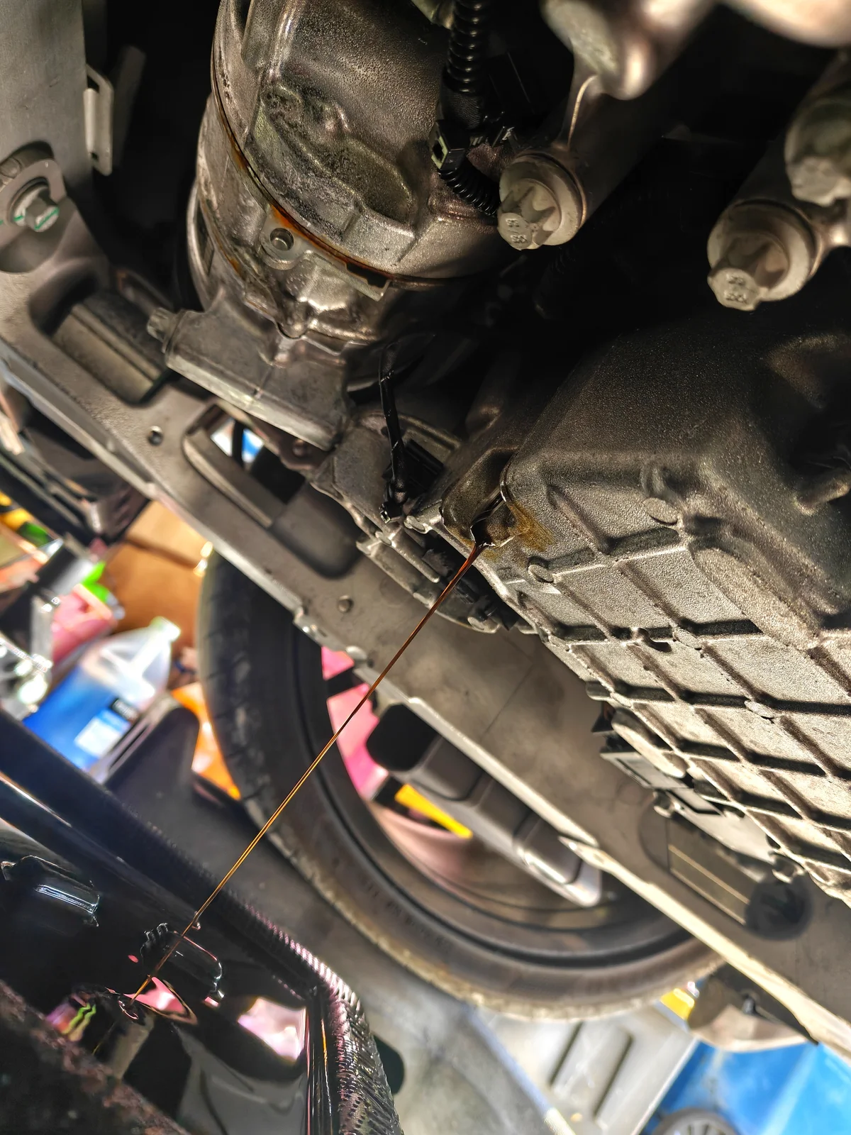

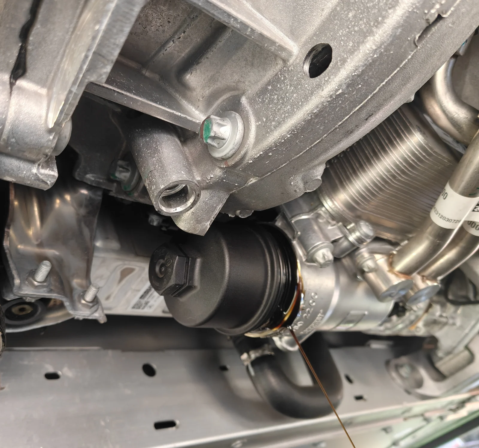

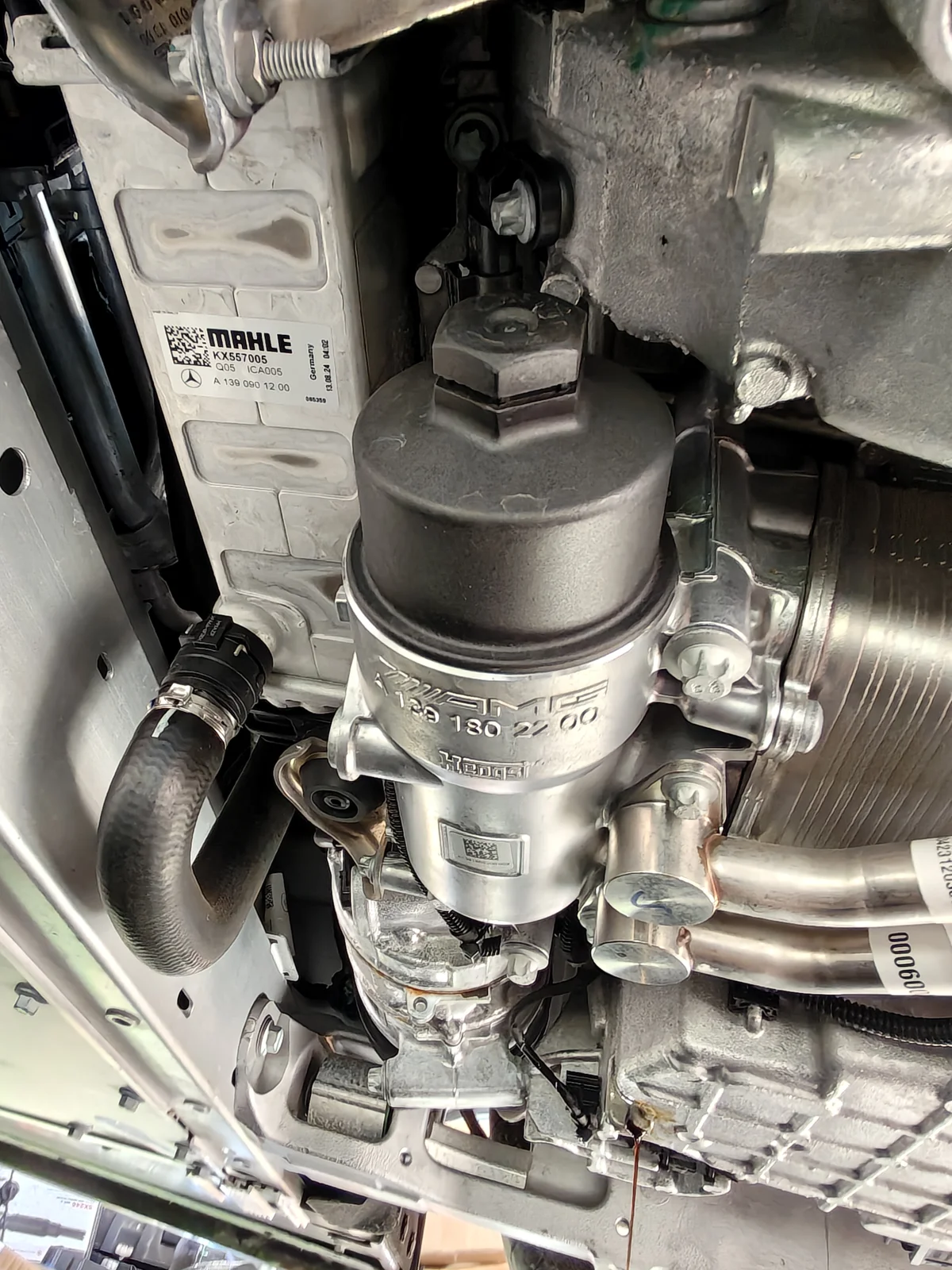

8. Locate oil filter. Socket is 1- 1/16". Unscrew filter and let drain, less messy when removing filter assembly. You can see where oil is draining in bottom right of picture for reference.

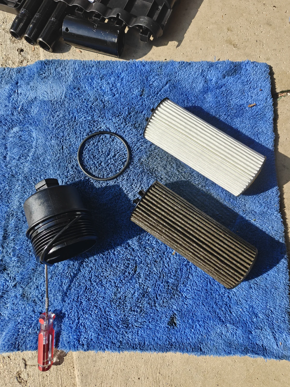

9. Remove oil filter assembly. Replace oil filter and O-ring. Lube O-ring with some old oil on your finger. Reinstall oil filter assembly.
There is no torque spec in the manual for the oil filter assembly but screw in until fully seated.
10. Pour in 6.5 bottles of oil. Start car and let run for a few minutes. Go to dash menu widget for tire pressures and scroll right to the oil level indicator.

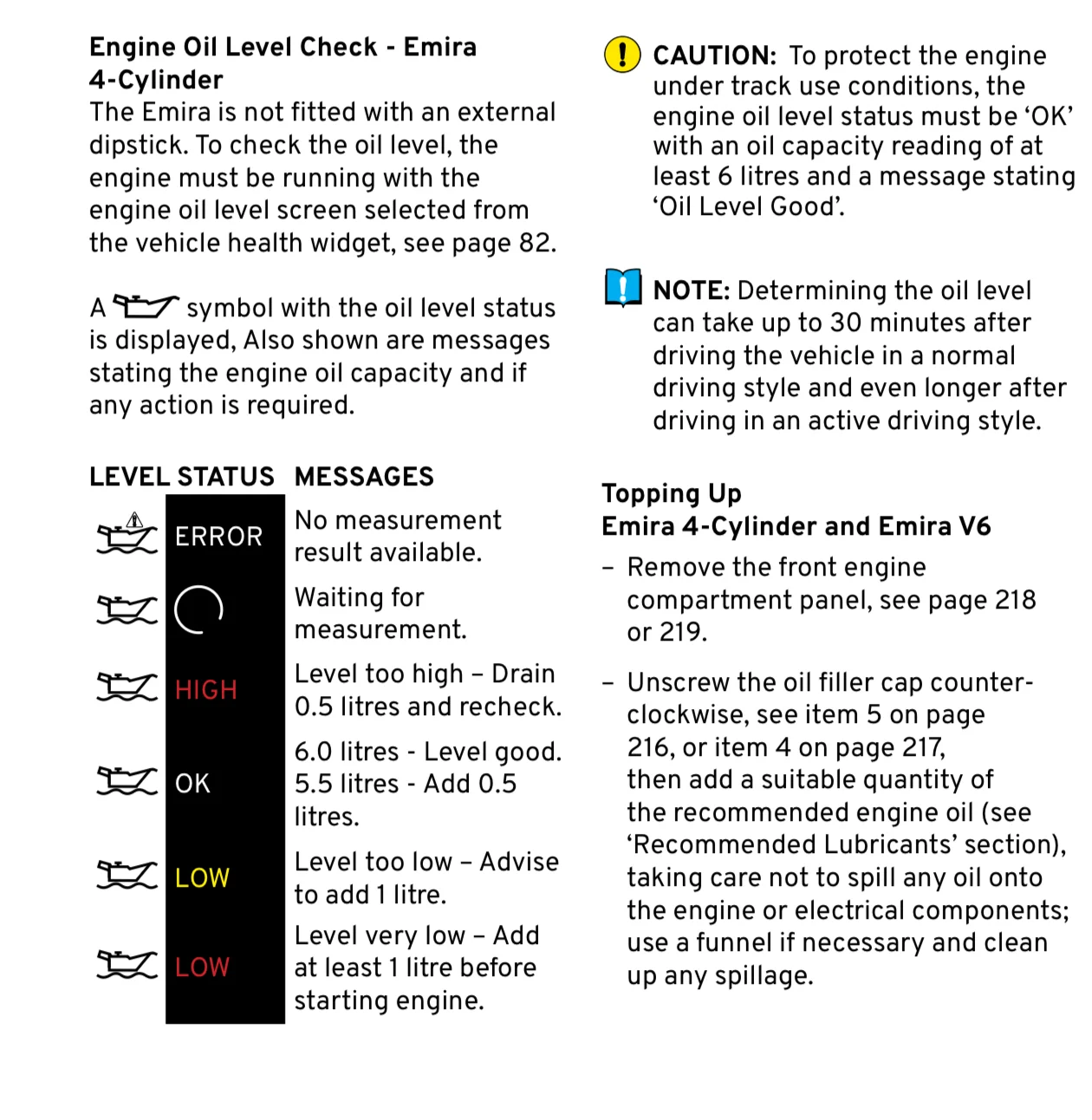

Was there not a comment from someone else recently about the inaccuracy of the dashboard oil level indicator?
Thought the owner discussed this with a dealer and the dealers comment was to use something else to indicate accurate oil level. Unfortunately I cannot remember what that alternate method was

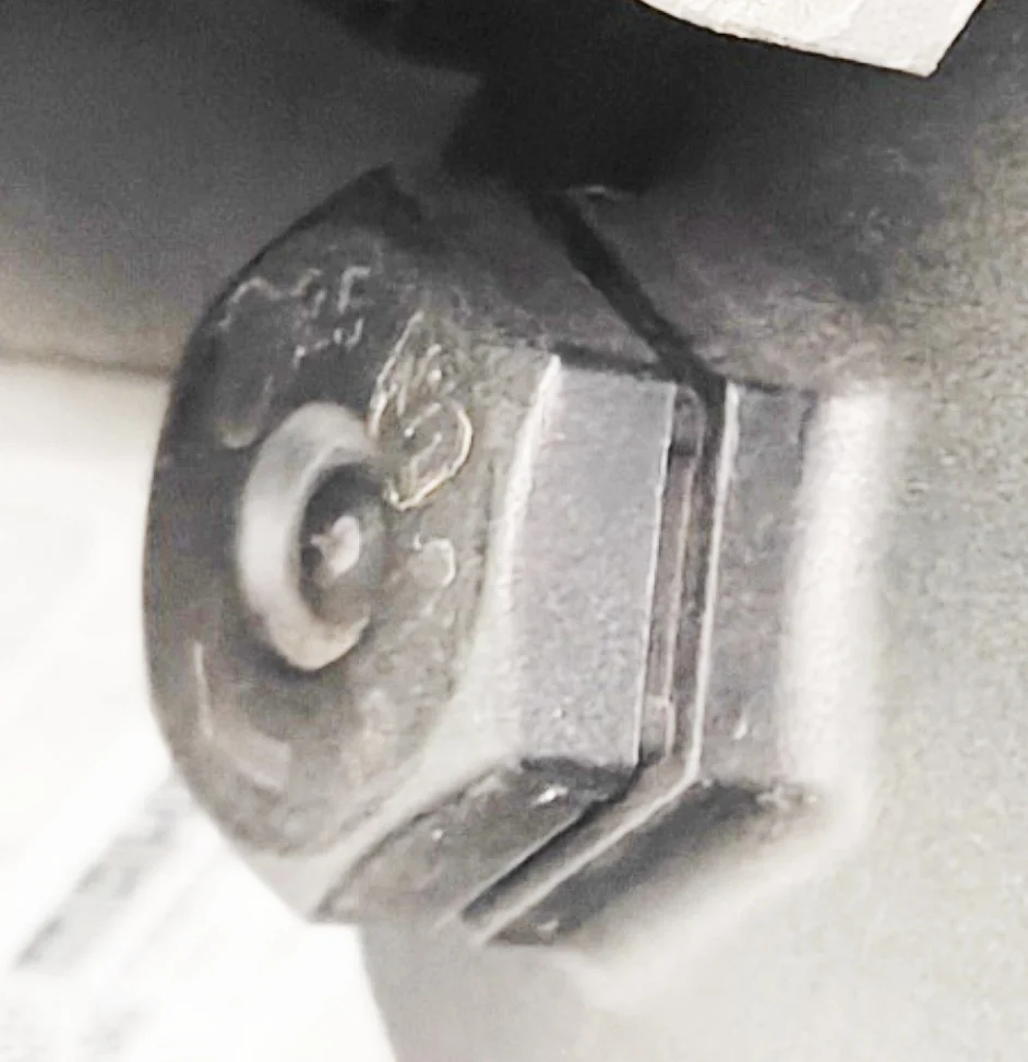

It does say "25" on the end of the cap but I wasn't certain that injected print next to it actually clearly said "Nm" being in a different font when I looked at entire cap.
Either way, I definitely torqued down at least 18 ft lbs (25Nm) with socket wrench.
Oil filter is Mercedes part A176 180 08 00, which is about $30 from a dealership or ebay.

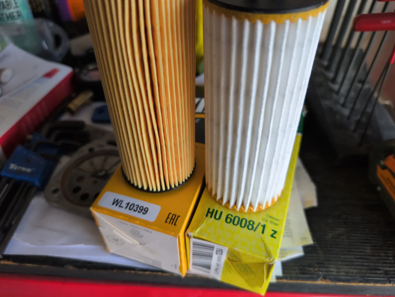

You can use a Mann or a wix as well and they're a bit cheaper. I will say: the mann looks like a much nicer filter than stock
Edit: they both also include the O ring
