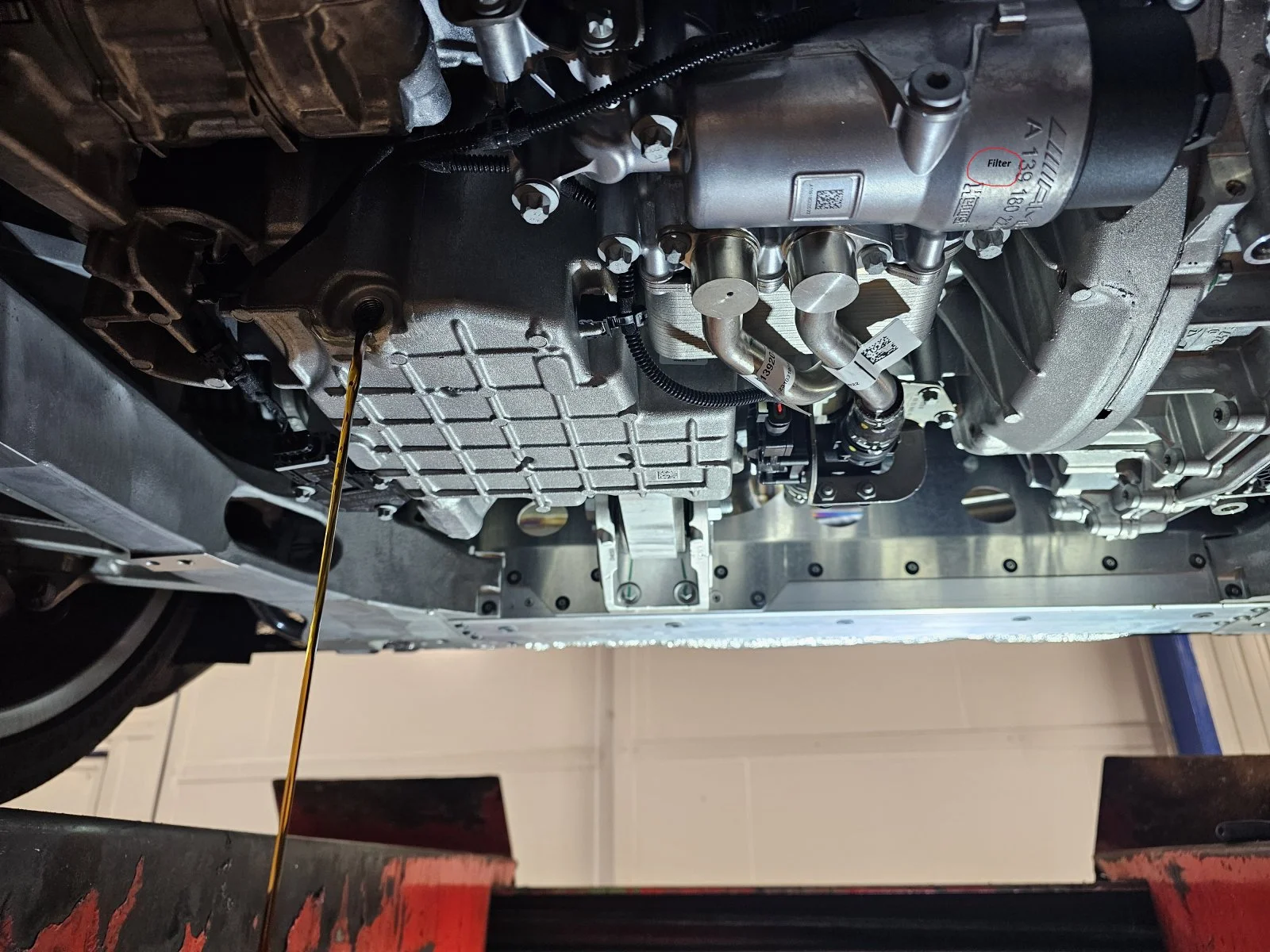

I've seen some pictures of the i4 underside during a service - everything looks very accessible, but I'm with you I would like to see some information too.

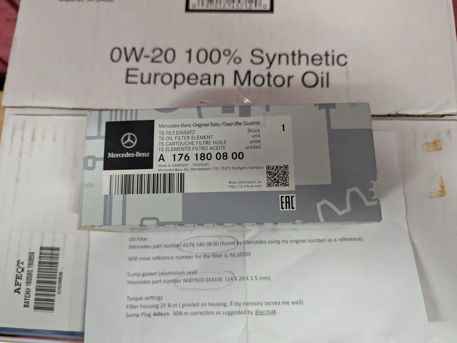

Here is some information:
Engine oil, Mercedes 229.71
Mercedes part number A000 989 34 09/11ABAW, in 1 litre bottles. Price does not decrease if you purchase 5 litres in a single container.
Oil Filter :
Mercedes part number A176 180 08 00 (found by Mercedes using my engine number as a reference)
Sump gasket (aluminium seal)
Mercedes part number N007603 014106
Torque settings
Filter housing 25 N.m ( printed on housing, if my memory serves me well)
Sump Plug 4̶0̶N̶.̶m̶ 30N.m correction as suggested by @gcmak .
Should be possible without removing the rear black diffuser. Note all screwwsare not the same lenght, and the Workshop manual does not give the correct information on screw to be removed.

For the Emira i4 - straight forward but some panels will need to be removed.

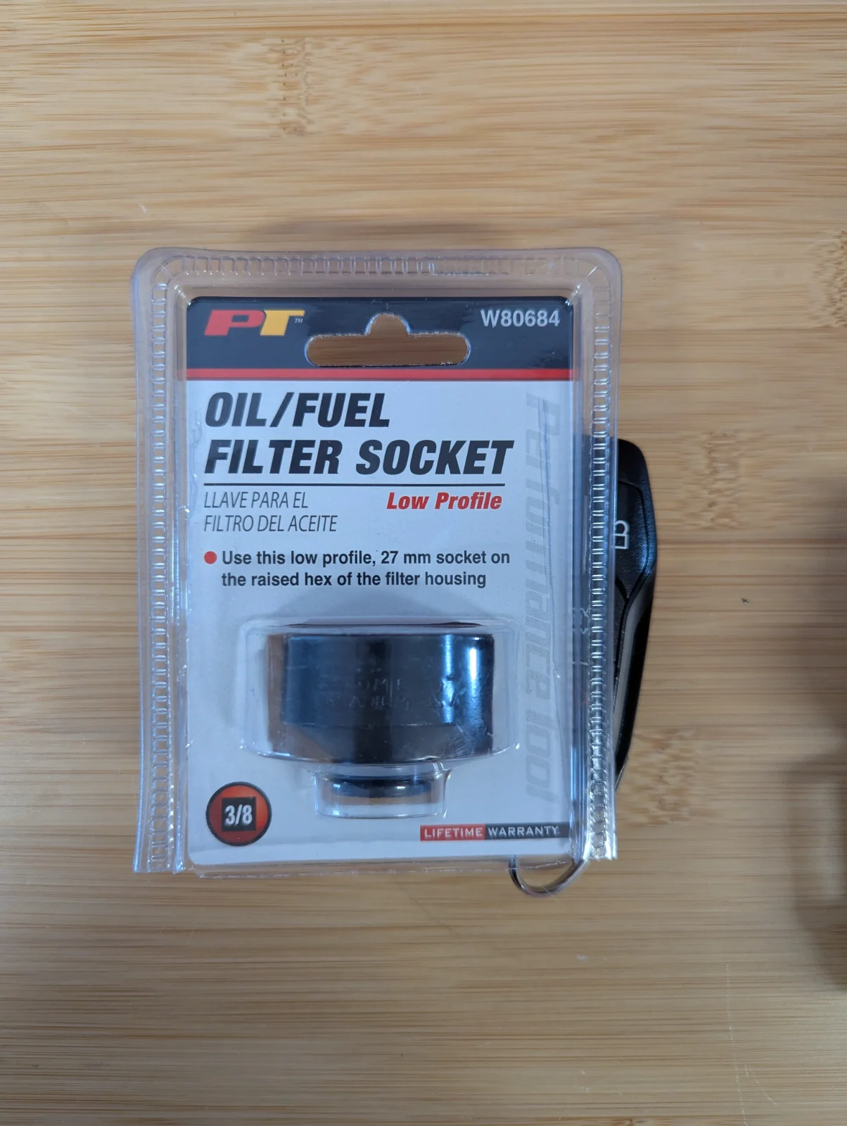

I would also recommend that you buy a 27mm oil filter socket (see picture) before you start. It is important to torque the filter housing back onto the engine correctly.

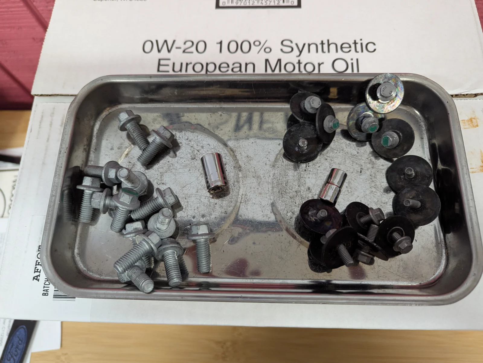

Finally, here is a picture of all but 3 bolts you must remove to take the diffuser off to get to the engine. There are 3 more bolts under the rubber plugs that I found after taking this picture. A lift is very helpful to use with this process, too.
