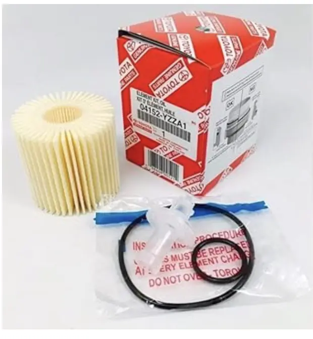

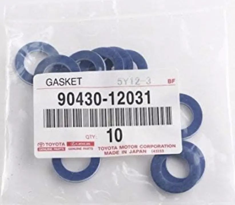

2. I used genuine toyota filter and drain bolt gasket.

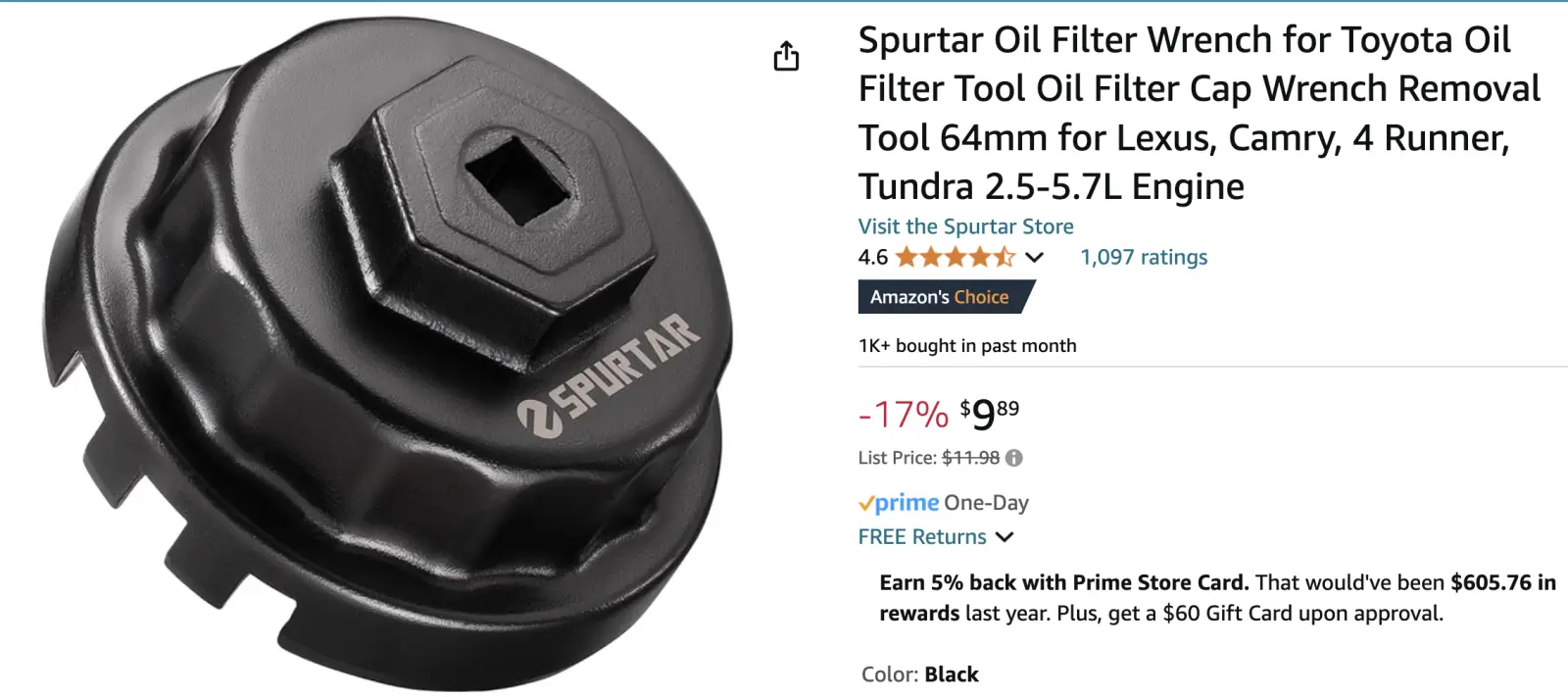

3. I used a Spurtar oil filter housing removal tool. Made removing the filter housing a snap.

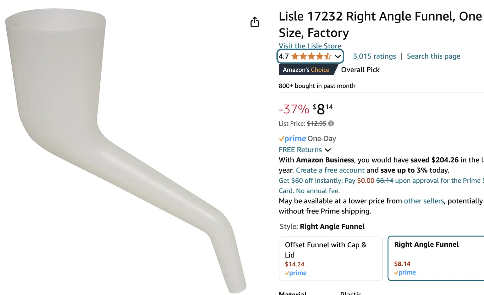

4. Having an offset funnel is a necessity!Screenshot 2024-09-09 at 16.44.55.png

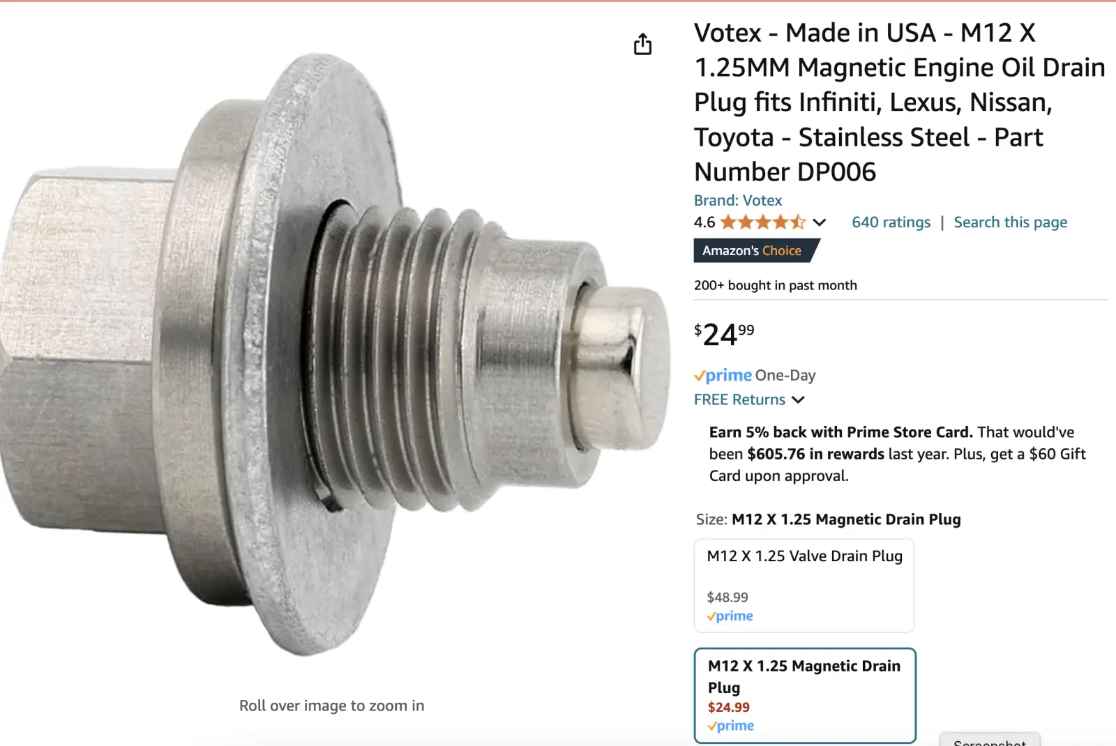

5. Lastly installing a magnetic drain plug is cheap insurance.

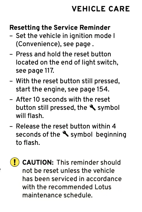

6. Finally reseting the service interval was a bit anticlimactic. It doesn't show or indicate the reset as being confirmed. It just resets to 360 days if you follow these instructions on page 187 of the owners manual.
