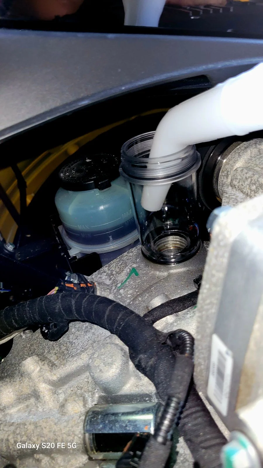

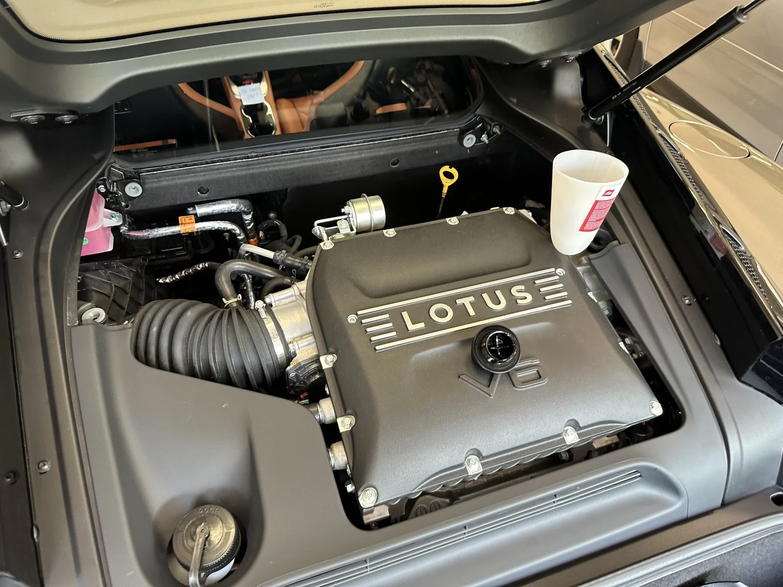

I'm about to do my 1st break in oil change at 1k mile.... I looked at the filler port on to n I'm wandering if I can access the filler hole just thru the removal of that one small cover.... I plan on using the same set up as above.... putting the angled funnel into the clear plexiglass screw in into the oil filler hole... but to do this, can I do this just thru the small opening OR do I need to remove the whole cover ?? Please advise. ...

I can't answer your question, since I automatically removed both engine covers (front then back). That said, I don't think it worth it, to leave the cover on. The covers are easily removed and put back into place. I'd also worry about oil drips and not seeing them, with your view blocked by a cover. Let us know how you make out and good luck!

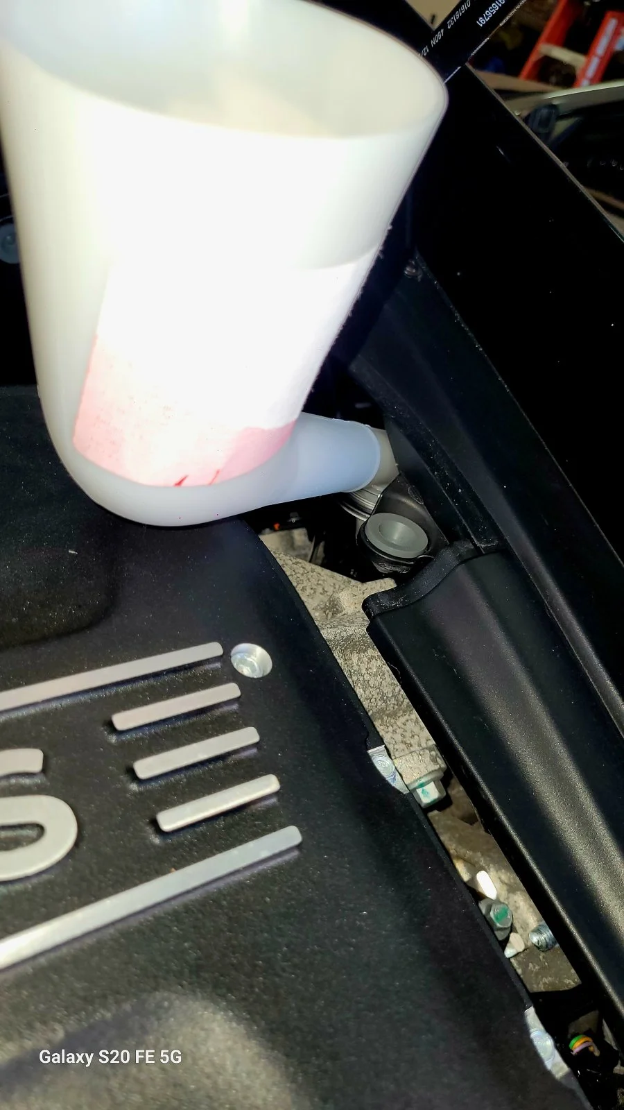

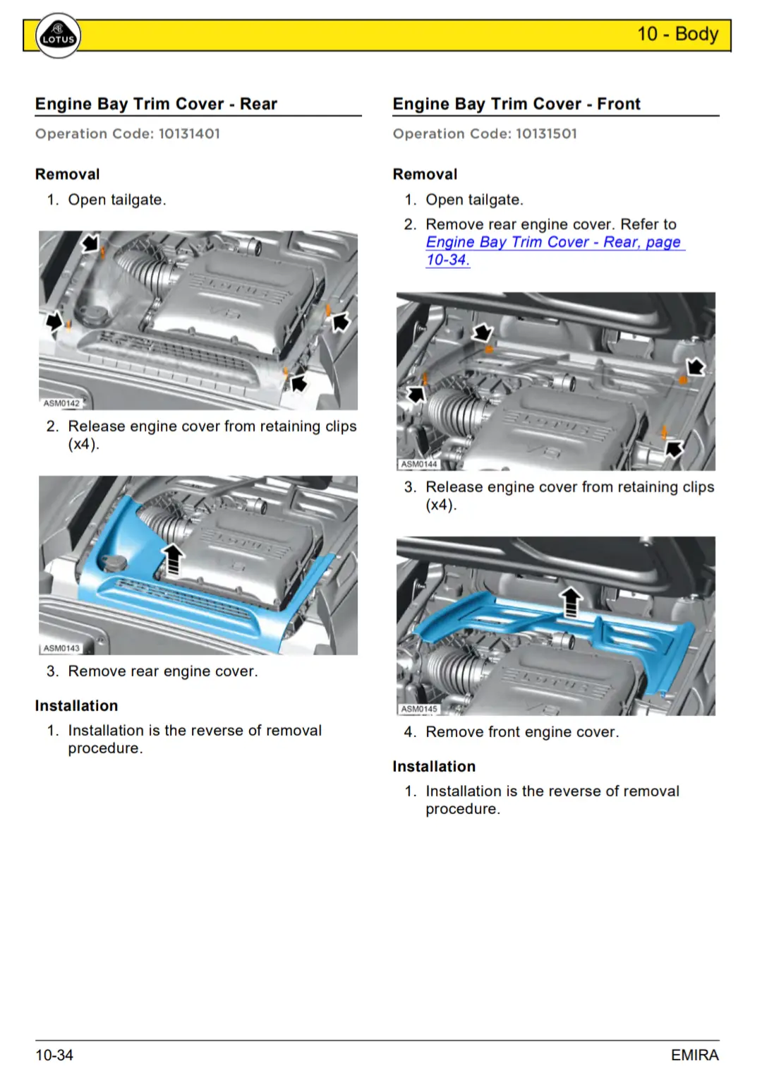

You need to remove the whole cover. I used the lisle angle funnel and removed the rubber grommet closest to where the funnel sits and then used the hole to secure a plastic zip tie to. (I wrapped the zip tie around the funnel so it wouldn’t move when I was adding the oil.) I attached a pic. You can’t see the wire tie but you can see the hole from where I removed the grommet. Also you can get away with just removing the one panel but you need to pop both sides of the back one first as it overlaps the front one.

Ok... uh....these panels...I didn't see any screws or plastic grommets... how do you remove the front panel ? What motion to remove them ? The side narrow inserts can stay in ?
Yah, I looked there and was like.... how TF am I gonna get in there....😆

The panels are held in with pressure fittings. Lift straight up.

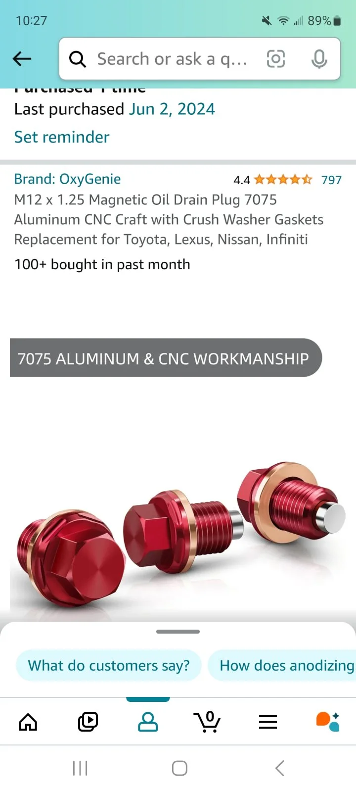

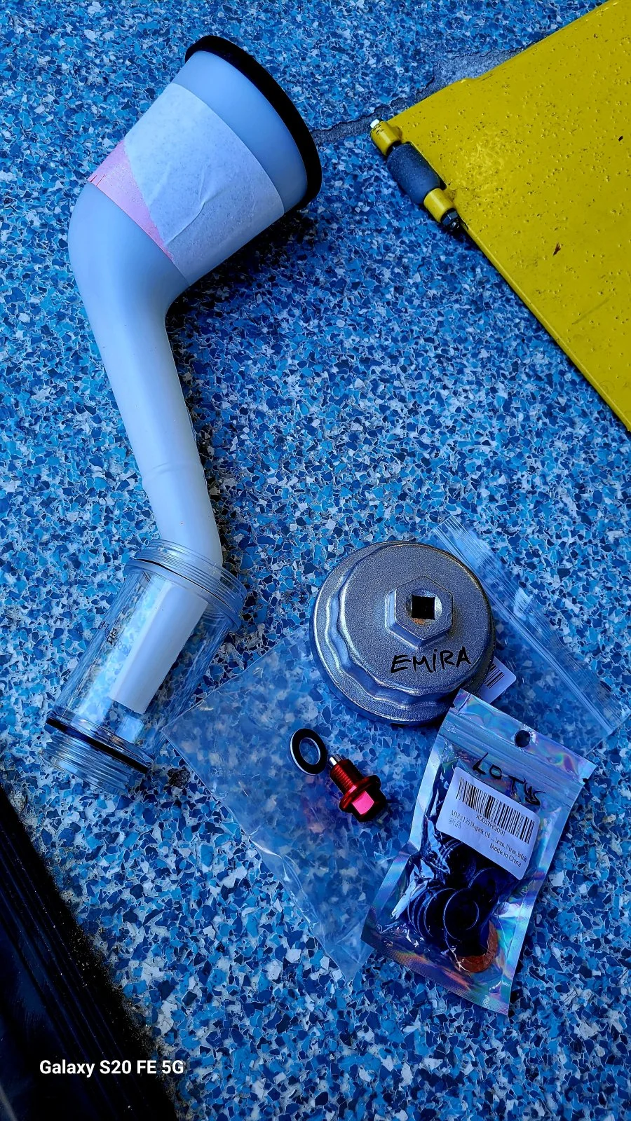

Ok... did my 1st oil at 950 miles.... the oil was almost new.... not dark even at all.... I decided not to put in the ceramic moly...cause I don't think the engine is quite broken in even...lol...
I did put a magnet drain plug tho....

What magnetic drain plug are you using?
it was off amazon.....
M12x1.25 magnetic oil drain plug 7075
they come in different colors
i think the 1.25 size is ideal for the emira
sorry i couldn't just put a direct link...not too savvy on that stuff....
