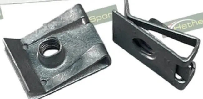

As you guys know, the 7mm hex bolts pictured below have to be removed. These bolts attach to zinc coated bolt clips and these are not the same bolt clips used on earlier Lotus...They are kinda flimsy.
These clips are the attachment point for all the 7mm bolts with the black washers. Anyone doing their own oil change needs to be extra careful when reinstalling the diffuser tray to line up the bolt clip so as to not bend or deform the bolt clip. I bent one and had to remove the entire under-tray in order to straighten it out and reattach. PITA b/c of crappy hardware.
After getting it down for the second time, I put a light coating of WD40 on all the bolt clips and that seemed to do the trick. All the 7mm bolts went into place without any drama. Torqued to spec and all good.
I'm ordering a few extra bolt clips from my dealer b/c its clear to me the hardware isn't up to the repeated abuse that it'll see over the life of the car and eventually spares will be needed.

Do you know the part number for those clips?
Nope...Just asked my dealer to order me a few spares. they didn't have any in stock and said Lotus has them on back order. so it might be some time b/f they come it.
It should be a standard M5 bolt clip / U-nut. there are stainless ones you can get on amazon if needed while we wait
It should be a standard M6 bolt clip. there are stainless ones you can get on amazon if needed while we wait
I've made various hardware purchases with McMaster-Carr (including clips similar to what you are looking for) with good results. They many times will show a CAD drawing of their items. Maybe they have an alternative readily available for your needs.

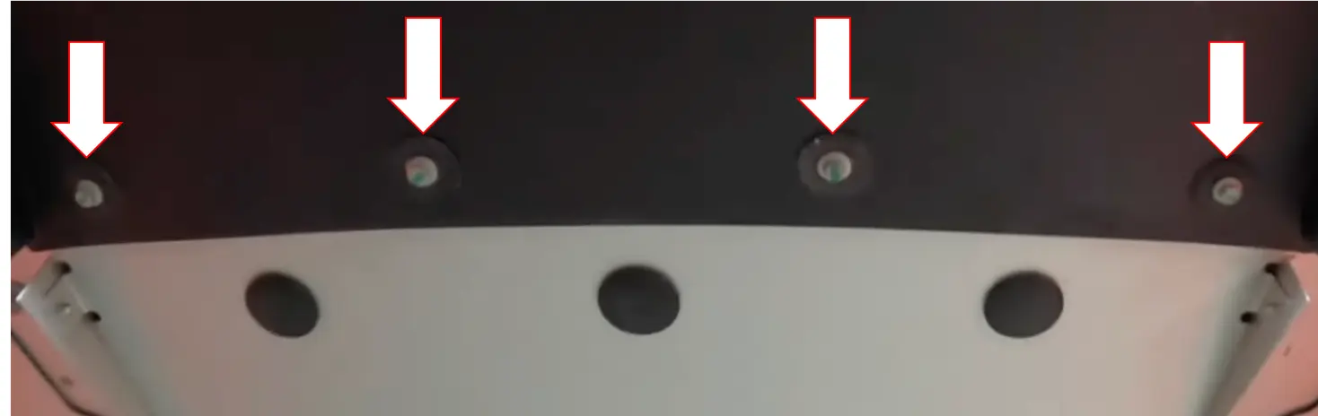

I was thinking of just cutting a hole and then cutting a piece of aluminum that’s bigger by about an inch — drill holes and place clips just like the stock one attaches to up near the rear of the massive shield.
Hi KitKat.
I was seriously planning on creating a 4 bolt trap panel to facilitate future oil changes, following your idea. However, after watching an Emira oil change video on YouTube, I came to realize that the oil pan and filter are located on the right side (observing from rear-to-front of the car) and seem to be directly in the vertical line of the under tray's extruded aluminum slats that follow through to the rear plastic diffuser.
There's a large middle section of the under tray which would be an ideal spot to adapt such a trap panel, but I believe that there's no spot in that mid-section that would allow for a proper angle to access the oil pan and remove/replace the filter. My assumption is just based on what i observed in the YouTube video and by checking the external side of the under tray. I'll verify if this is indeed the case, when I remove the under tray for the next oil change, unless someone else here can confirm or contradict my suspicion beforehand, and I definitely wouldn't mind being wrong in this case.
Hi KitKat.

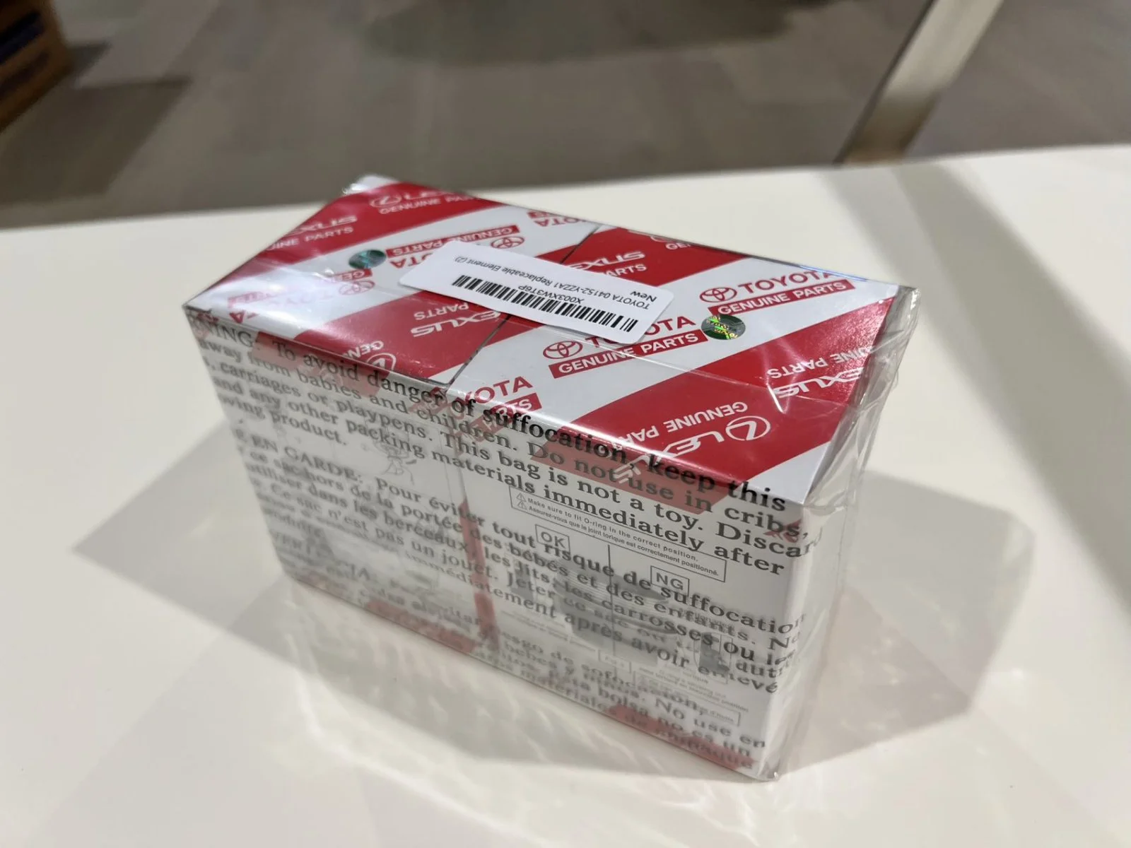

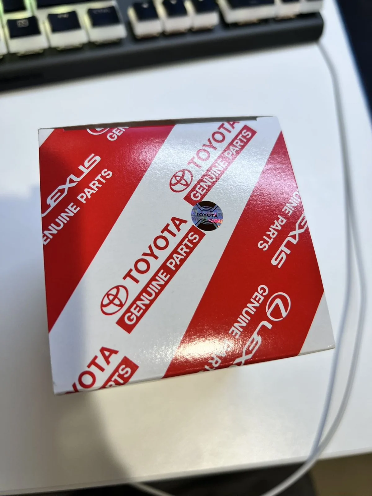

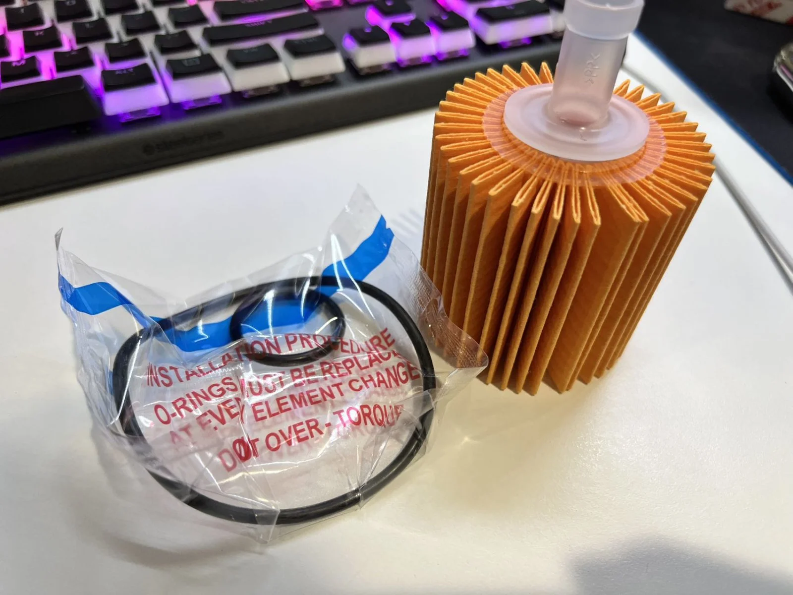

I bought the oil filters from Amazon (too lazy to go to the Toyota dealer). It was mentioned that they could be counterfeit. Does anyone know how to identify if they are counterfeit or authentic? They look pretty good to me. :unsure:
I bought the oil filters from Amazon (too lazy to go to the Toyota dealer). It was mentioned that they could be counterfeit. Does anyone know how to identify if they are counterfeit or authentic? They look pretty good to me. :unsure:View attachment 55627View attachment 55628View attachment 55629
There’s a video online that tells you. I still wanted to be sure so I went and bought oem ones from the Toyota dealer to compare, they were the exact same as the ones I got from amazon. Based on your photo those look legit
For a few dollars and maybe a hour running around I would just go buy from Dealership or
a Lotus online Company ...For the value of your car alone not worth taking a chance..
For once you install and start asking yourself before starting..Hope its the right one..
Looks legit, I buy mine at my local Walmart, I have for the Highlander for last 10 years.
Thanks! I did some research into real vs fake oil filter. The ones I got should be good. The counterfeit ones are really poorly made. People should be able to tell the difference very easily.

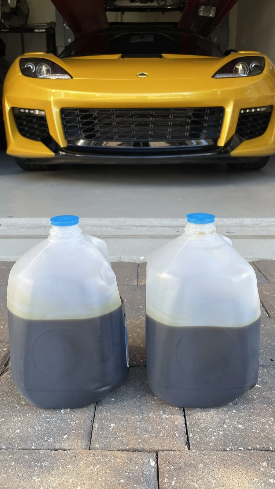

I did the first oil change in the Emira this weekend with about 800 miles on the odometer.
For reference, this is what the oil looked like…kinda dirty. Oh and ignore the yellow car in the background 😁

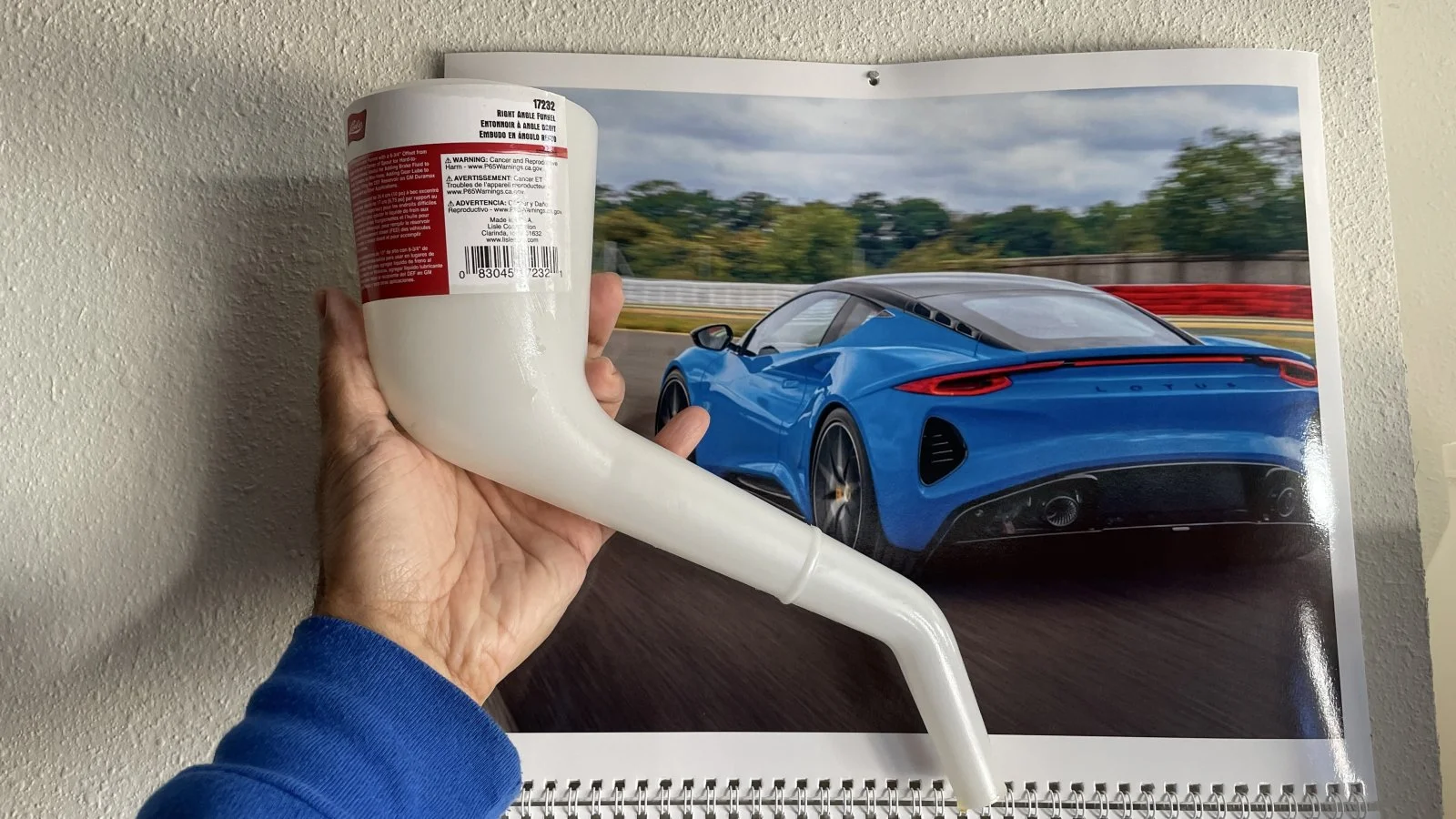

The offset funnel suggested in this thread earlier worked well.
I had purchased a large 5qt bottle of Mobile 1 and a 1qt bottle, but there wasn’t enough clearance to tilt and pour from the large 5qt bottle without the risk of spilling oil on the engine bay. I ended up transferring the oil to the smaller bottle, and will just purchase the 1qt bottles in the future.

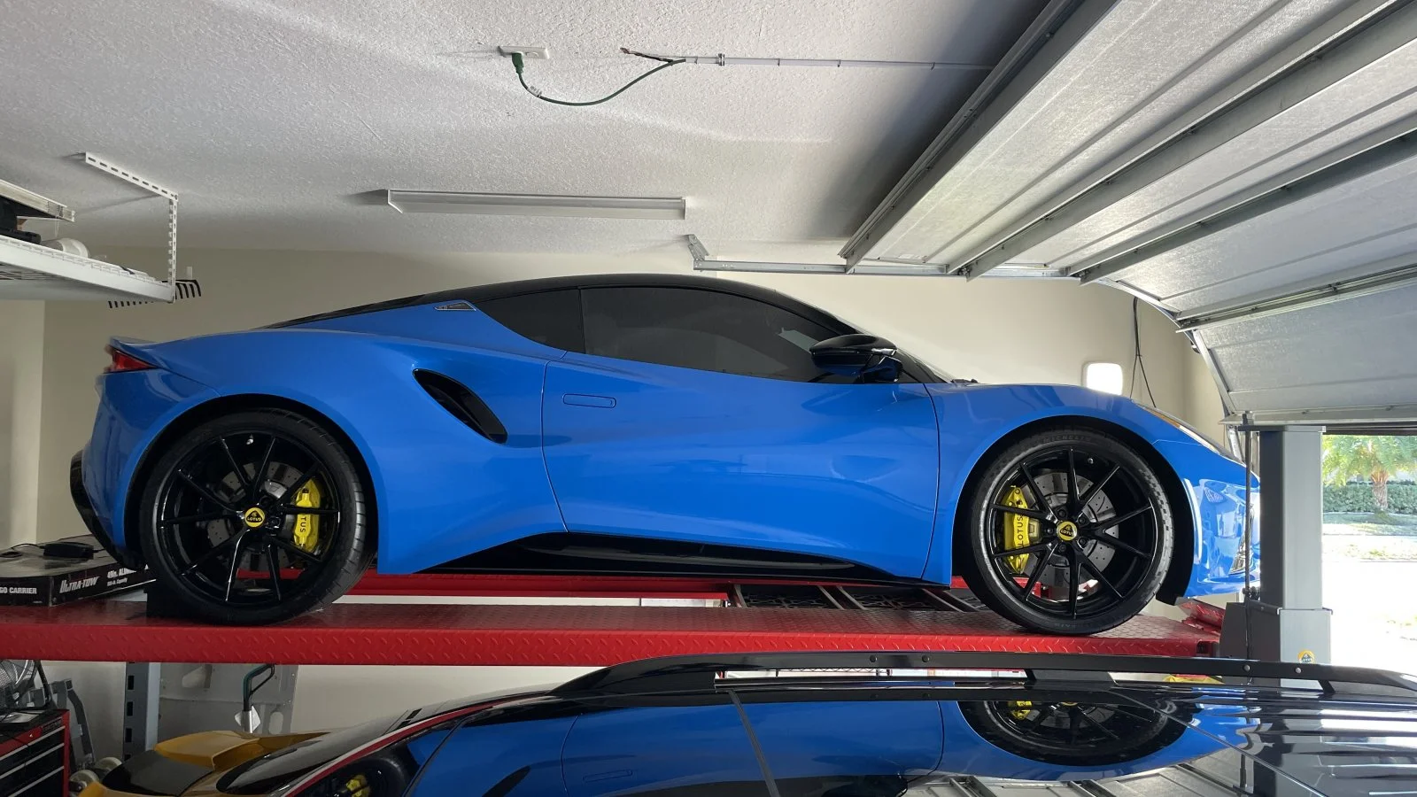

And here’s the Emira chilling on the lift.
