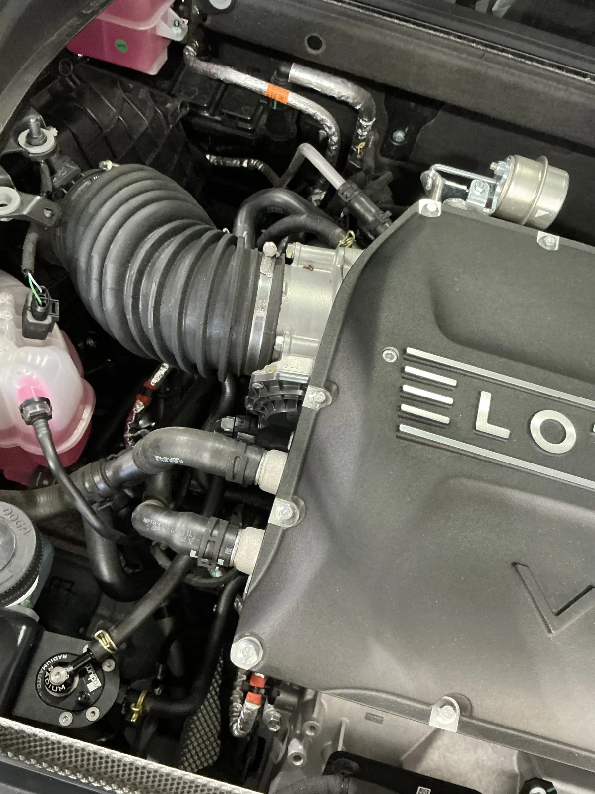

My install went smoothly today. Decided to route the OEM hose a little differently keeping the clip/bracket and reusing some natural bends in the hose. Greg's kit comes with the drain installed, but he also includes the plug for the bottom if you would prefer to drain manually instead.
. View attachment 71947
👌This is exactly how I installed it on my Emira.
