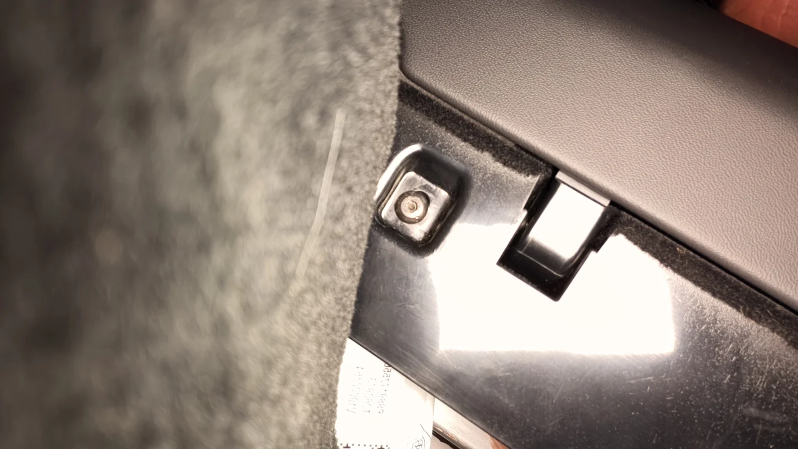

Am I looking in the wrong place or did the 3mm Allen screws get replaced by a hex head at some point (MY 2025)?1776624529211.webp1776624760429.webp1776624768530.webp
Ha. Lotus doing Lotus things. They must have changed them. Mine are Allen.
For future reference, it was a 7mm hex. I guess inflation hit the screws too, at this rate it could be 11mm for this year’s models.
I will add a note to the instructions, thank you for the info!
