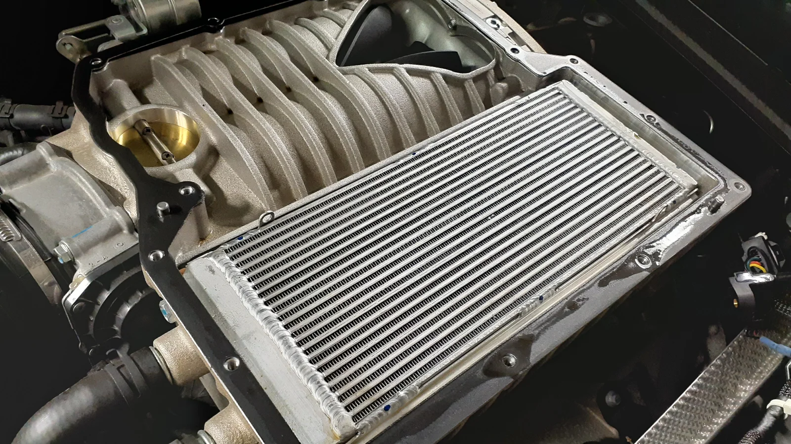

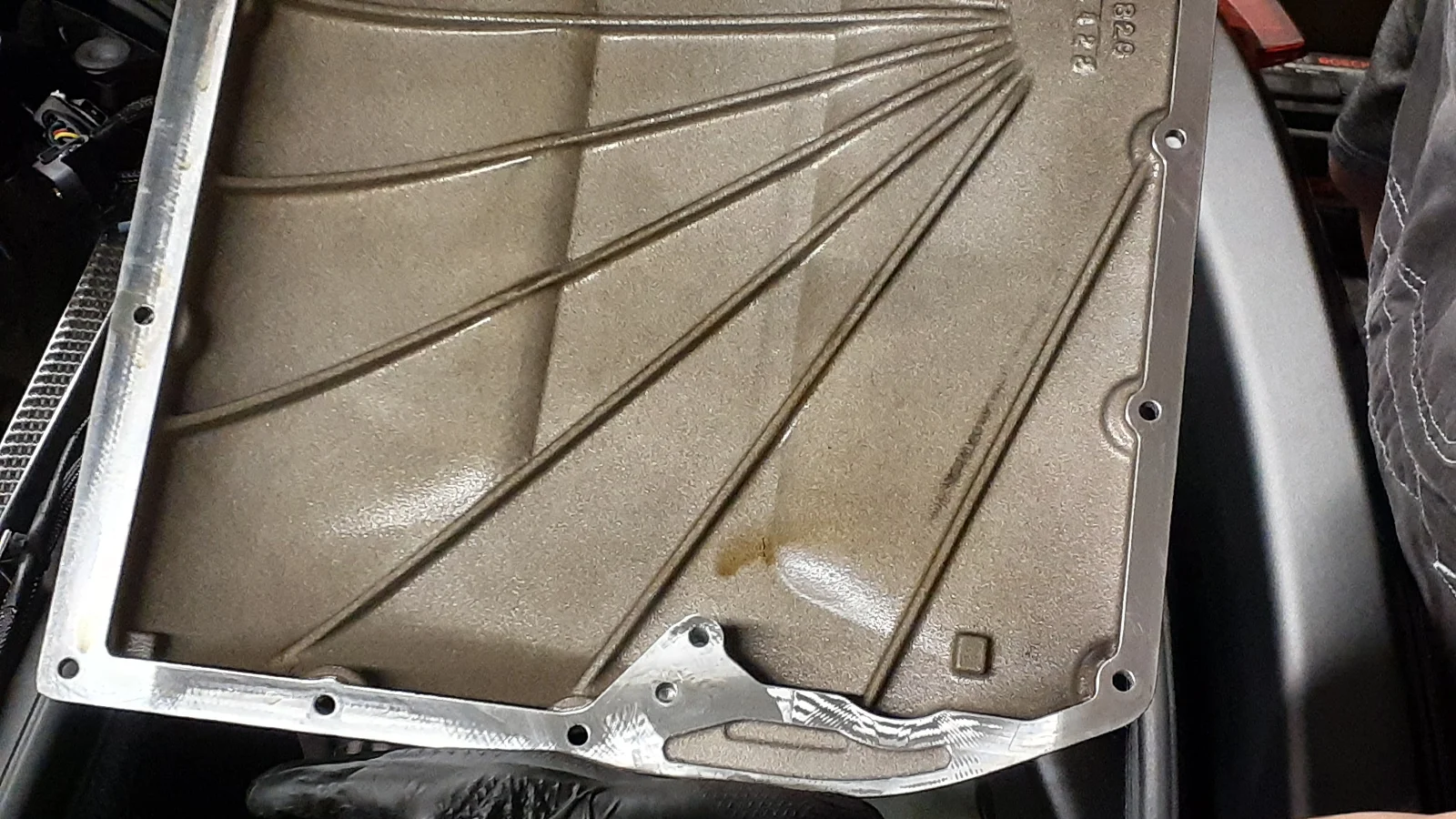

Resurrecting this thread to post pictures of the inside of the supercharger for those who want to see. There is a thin layer of oil in a 2.5 year old car that sees Wide Open Throttle (WOT) only when tracked 2-3 times a year, with other daily driving done in a somewhat responsible-adult-manner. I have been told this level of oil is normal for this car, and would not cause major issues as long as the oil is clean.
3 WOT pulls on a dyno with a "clean" supercharger lid resulted in a thin film of oil, so there is definitely some oil spray.
Obviously, a catch can system should reduce this oil film and buildup in the intercooler core, improving air flow and cooling.
wow your oil is pristine!
