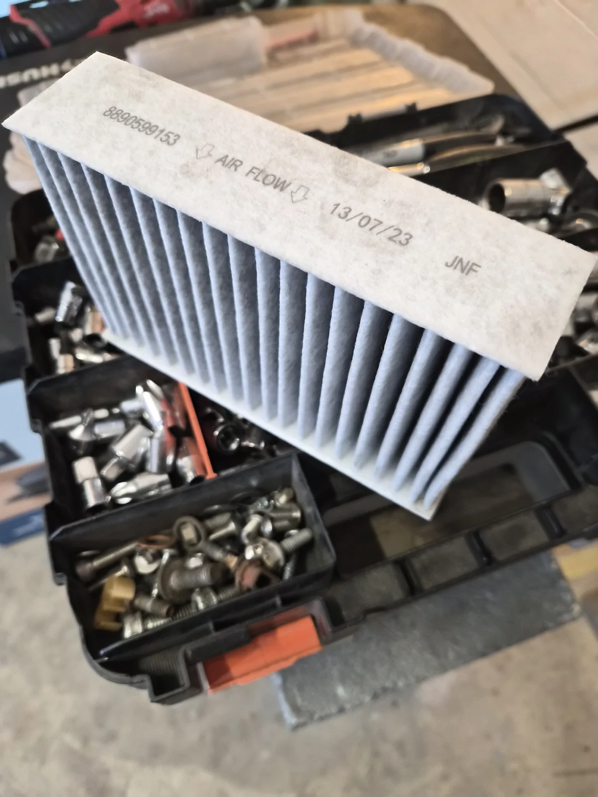

Well, I might actually be wrong on my theory. After looking a bit more with no success, I went lazy (i.e., ChatGPT). and it claims the following may be true: "A private-label cabin air filter produced by a Chinese OEM supplier (JNF-marked), likely for a low-volume automotive or specialty HVAC application..."
It basically said it's highly likely Geely just ran a small batch from a Chinese manufacturer that makes these for many others. I'll keep looking. BTW, this also might explain why even dealers and GRP struggle to stock them. Again, gotta love Lotus...

- Cabin Air filter 8890599153

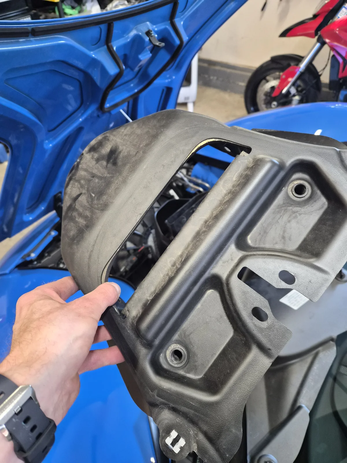

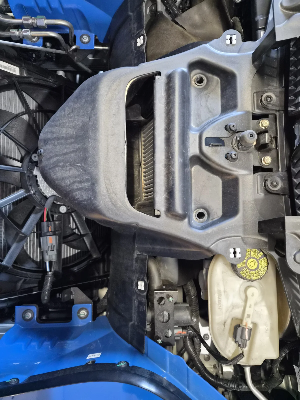

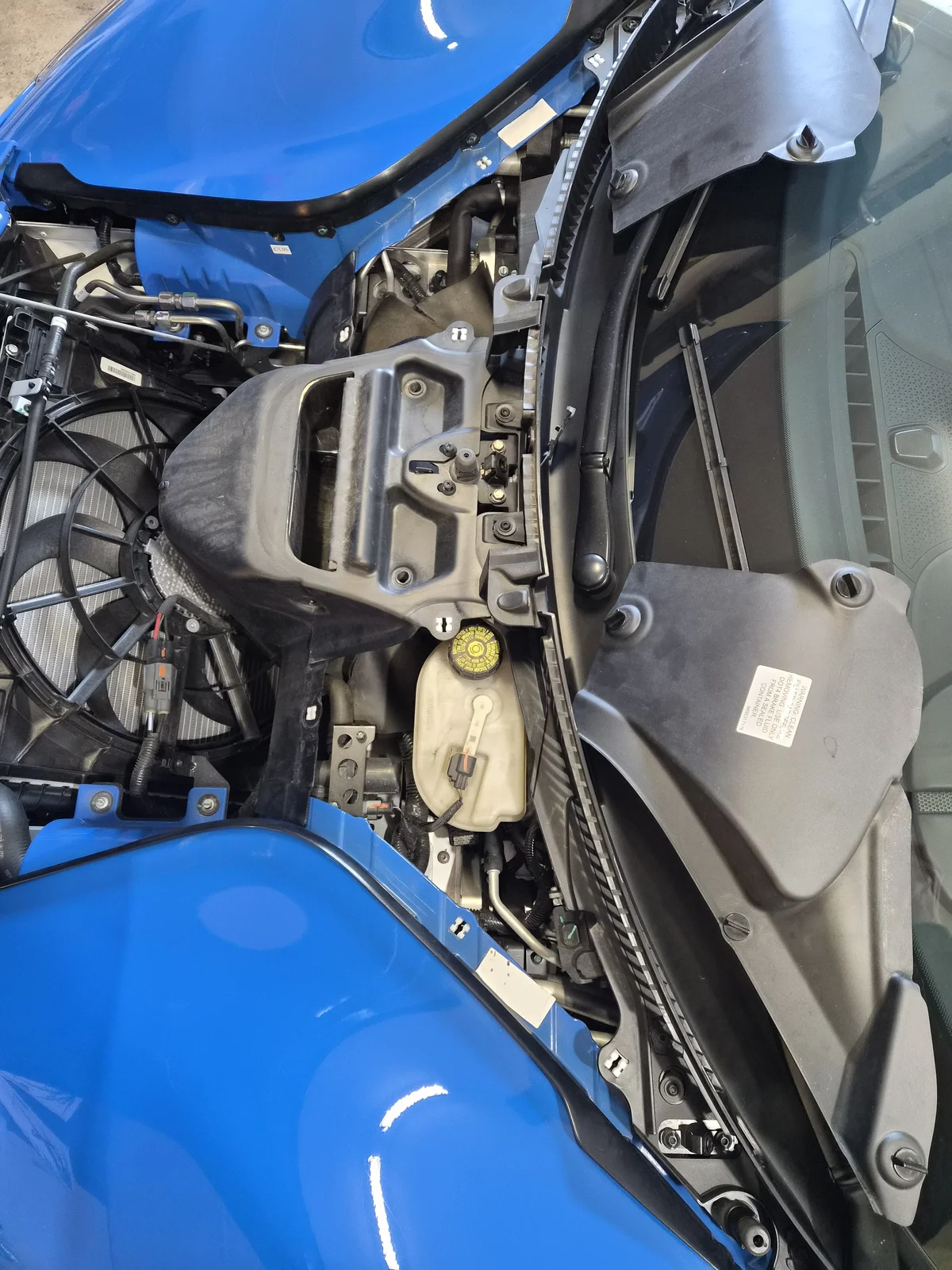

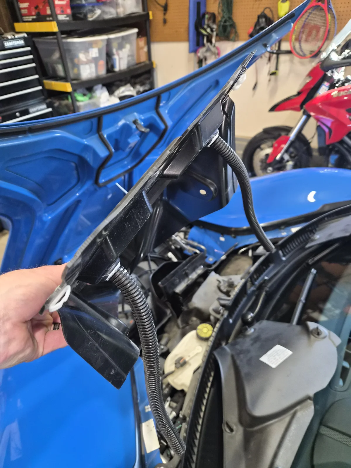

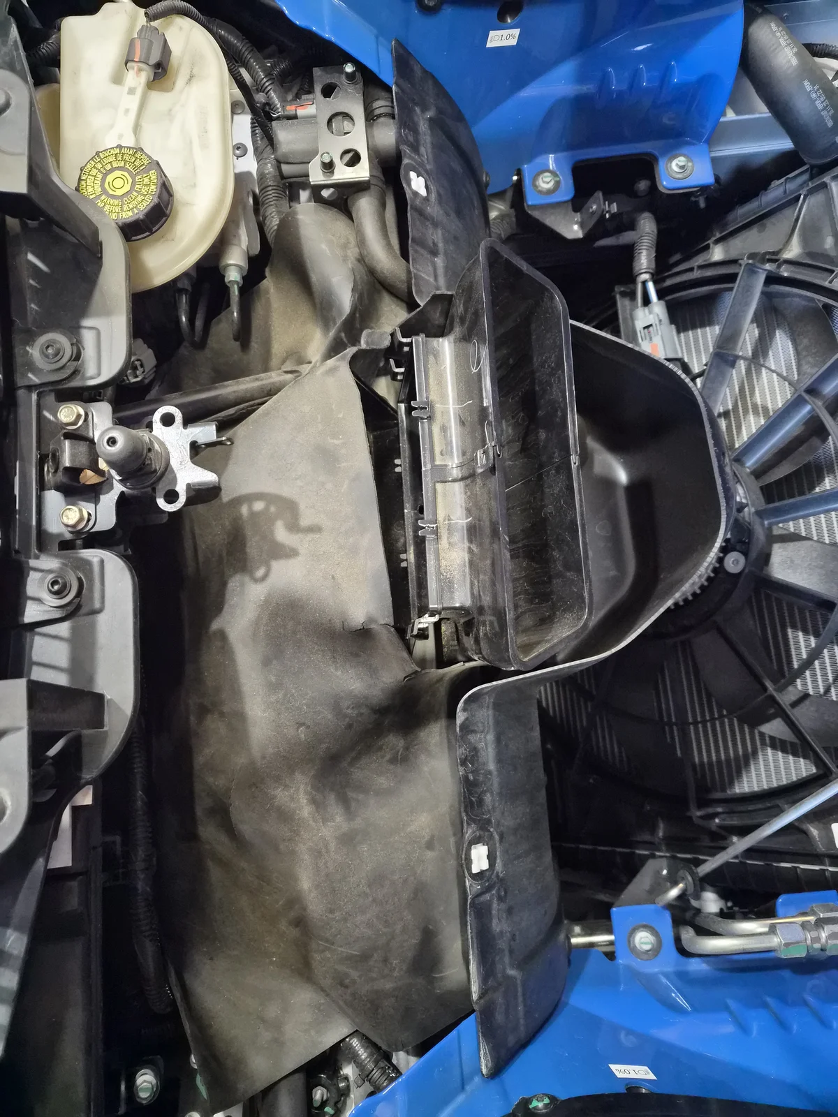

1- open front hatch by removing small covers and 3x T30 bolts
2- remove two side panels adjacent to filter housing
3- remove 3x plastic panel retainers with Phillips firsts and trim tool second
4- remove 2 x T20 screws on the side of housing cover (careful not to drop washers!)
5- carefully pull filter housing cover forward and away with two drain tubes attached
6- very carefully move rubber surround from sides of filter to reveal 4 plastic retaining clips. (rubber is not great quality, mine has 10k and splitting)
7- gently pull clips to release the front filter cover
8- remove and replace filter (it's the smallest filter for a car you've ever seen!)
That should do it!
Here are a few pics to help.
View attachment 79631View attachment 79632View attachment 79633View attachment 79634View attachment 79635View attachment 79636
