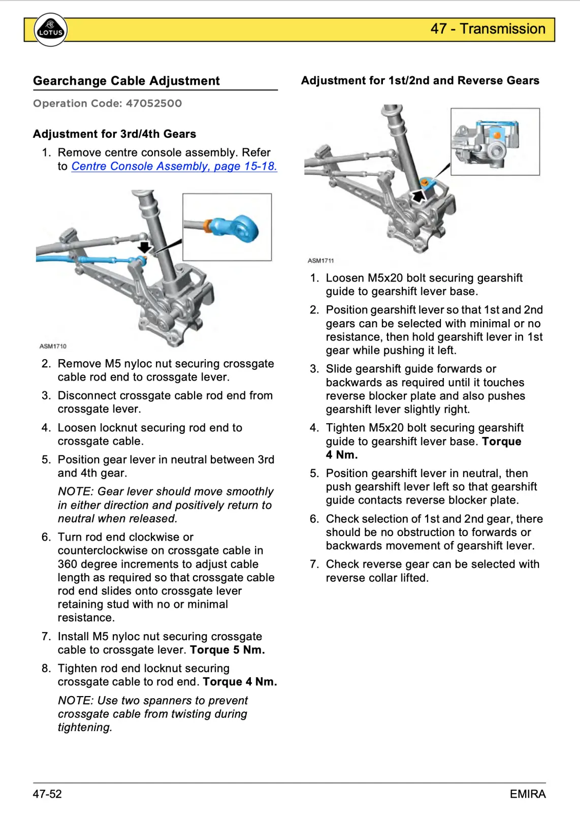

Is the position of the set bolt you show in the picture, the location where you set yours that worked well?
Just FYI that bolt is supposed to be torqued to 4 Nm.
Yup that position works out well for me, it’s about 4mm higher than the stock position was.

It's unique per-car. There isn't a single adjustment that works for every vehicle, that's why this is designed the way that it is, for tuning the particular car to be "right".
Something like this exists on almost every cable-driven shift linkage, depending on how the reverse lockout works for the particular gearbox. If the R is on the right side of the H pattern you'll see this type of adjustment to establish the limit of throw for 5th/6th rather than 1st/2nd.
