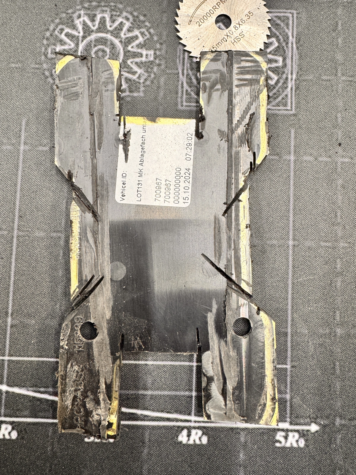

This is the section I cut from the back of the long tray.
So a correction is needed. I did cut into the bottom of the tray slightly on the back.
This is roughly what the cut out looks like in the bottom of the laundry to fit the spacer into

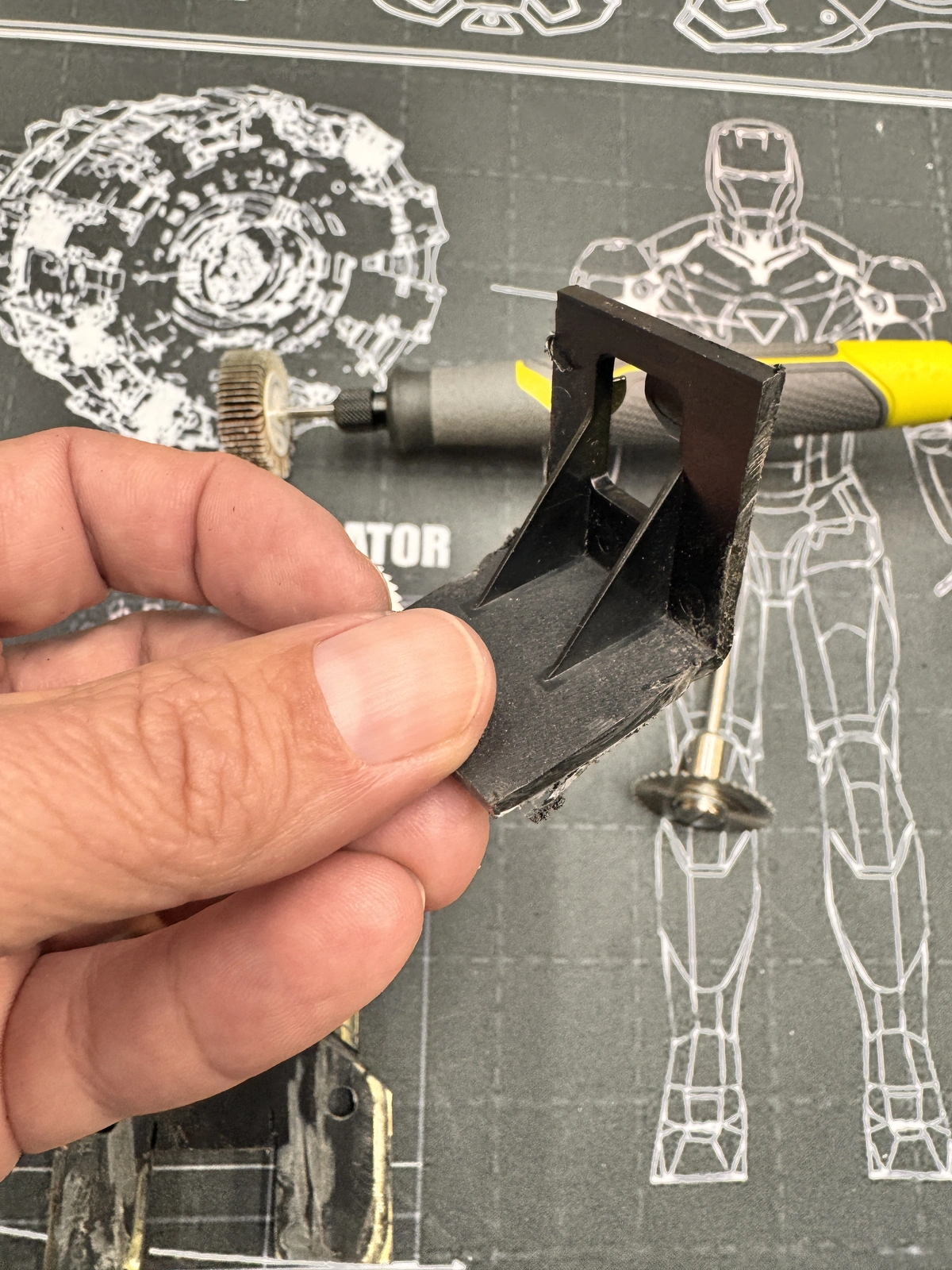

This is the cutting disk I use and the sanding disc I used to clean up my cuts

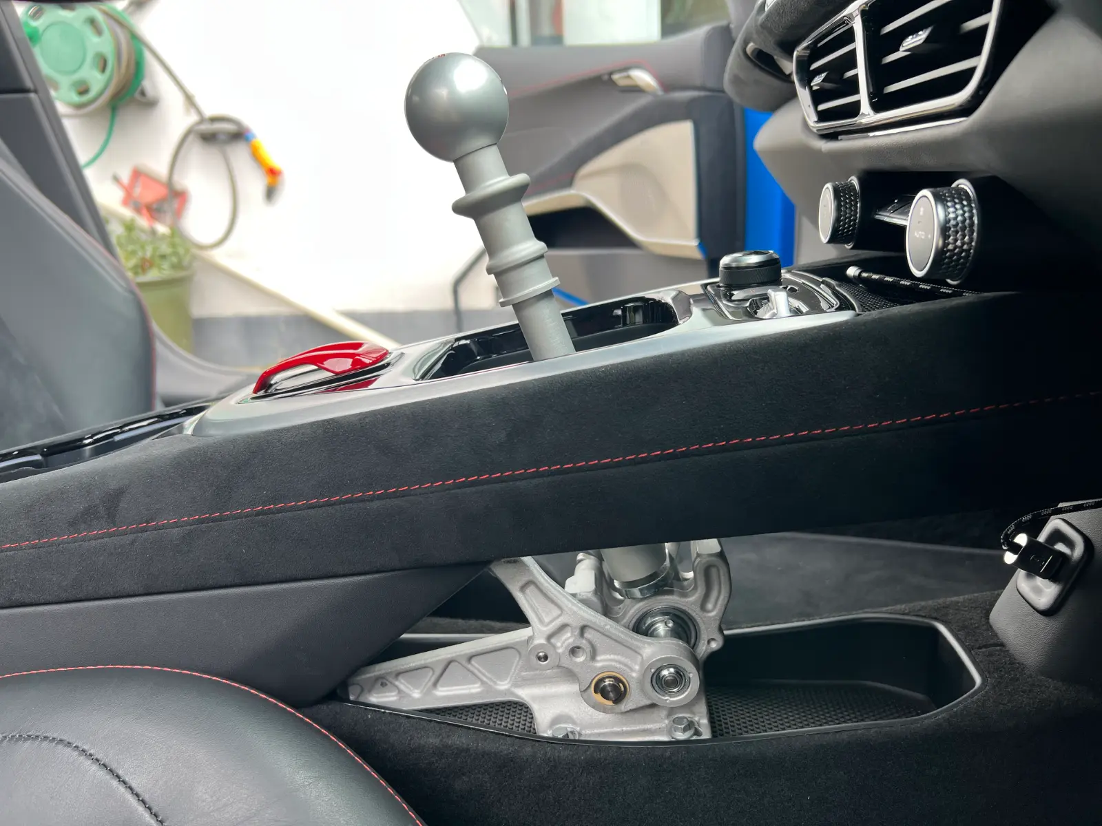

much like having a skeleton watch. Neat to see the mechanical workings and engineering involved. The engine is under glass for the same reason. The beauty of the car is more than skin deep. Heavan is in the details.
The engine is under glass, then covered up by an engine cover. I4 is terrible for this, V6 is only a tad better

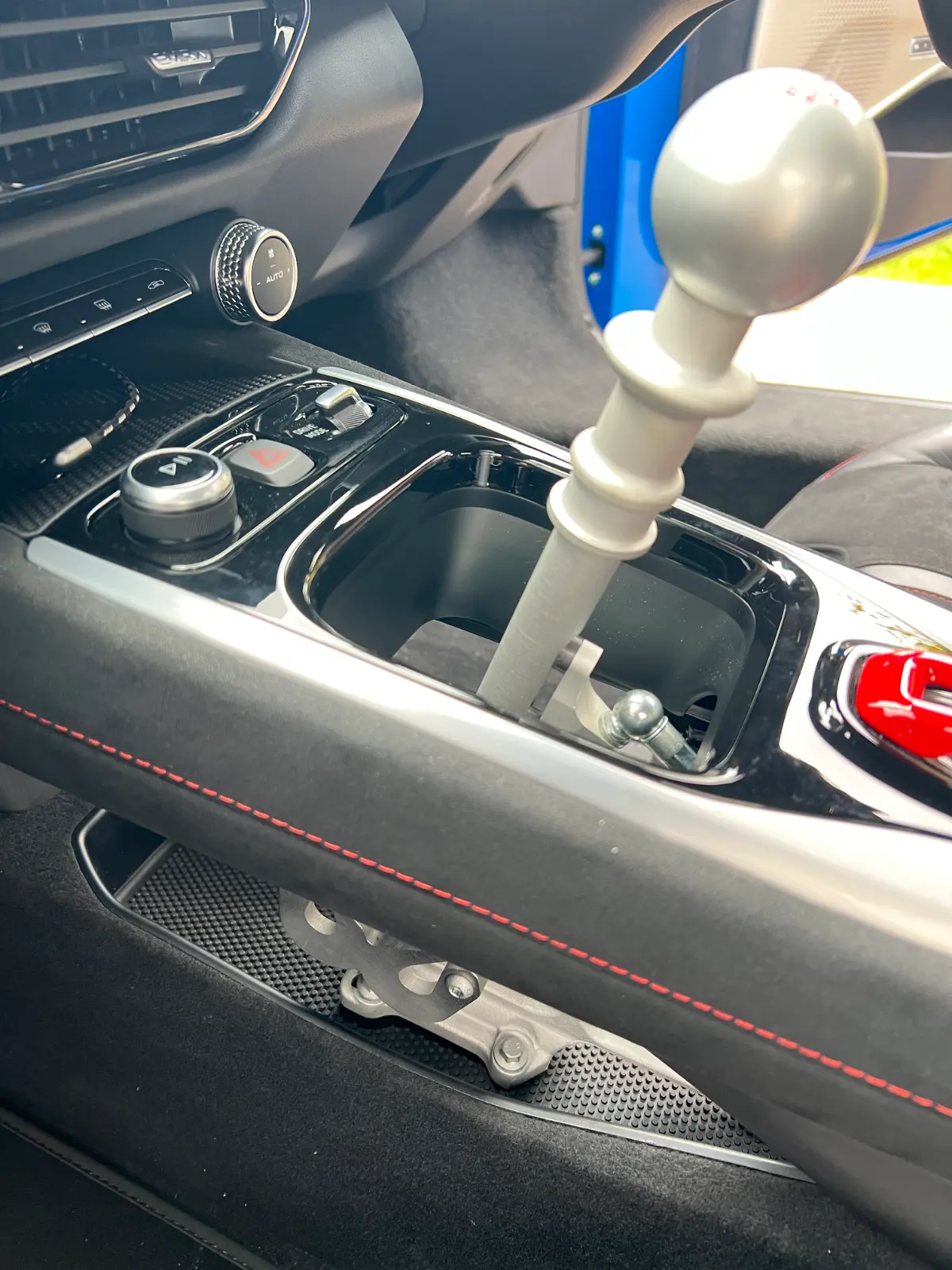

With the advent of computer control and drive by wire I like that Lotus has decided to celebrate some of the analog components. KitKat and Silent Cilantro just enhanced the celebration by making the mechanical linkage a bit more evident.

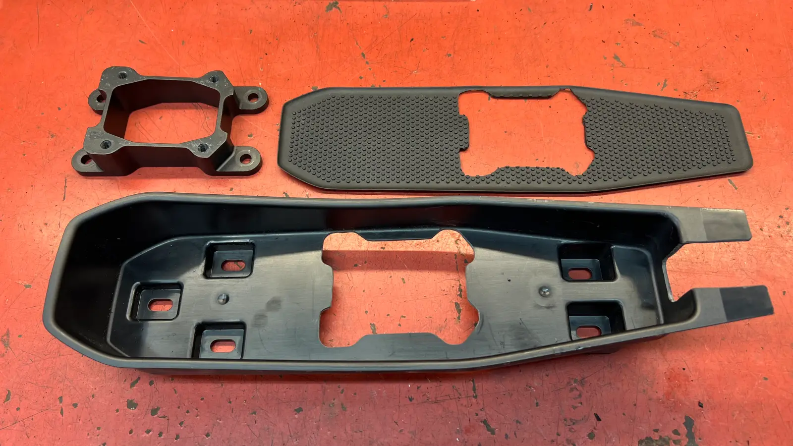

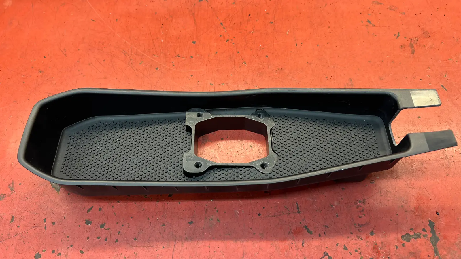

Installed the auto tray today. Some learnings if it helps anyone.
I wanted to try to make the cutout as neat as possible. I know it’s hidden by the rubber liner but why not…
Used a Dremel freehand with a plastic cutting bit.
There’s no need to cut out for the lower bolts. They sit under the raised bit of the tray.
There are two stiffening ribs underneath to remove to make it fit.
Install the black spacer first, then slide the tray in between it and the shifter.
Front of the cutout is 130mm back from the very front edge of the tray and it’s offset 5mm to the right.
Slot at the back is 22mm wide and central.
I also have a slight gap at the rear right between the tray and the carpet, just installation tolerances of the console I think. There are clips to hold the front bit together but none at the rear annoyingly.
As said above, could make the bolt holes a bit bigger to fettle it but it’s a bit of a tight squeeze to get the tray in so I’ll probably live with it.
