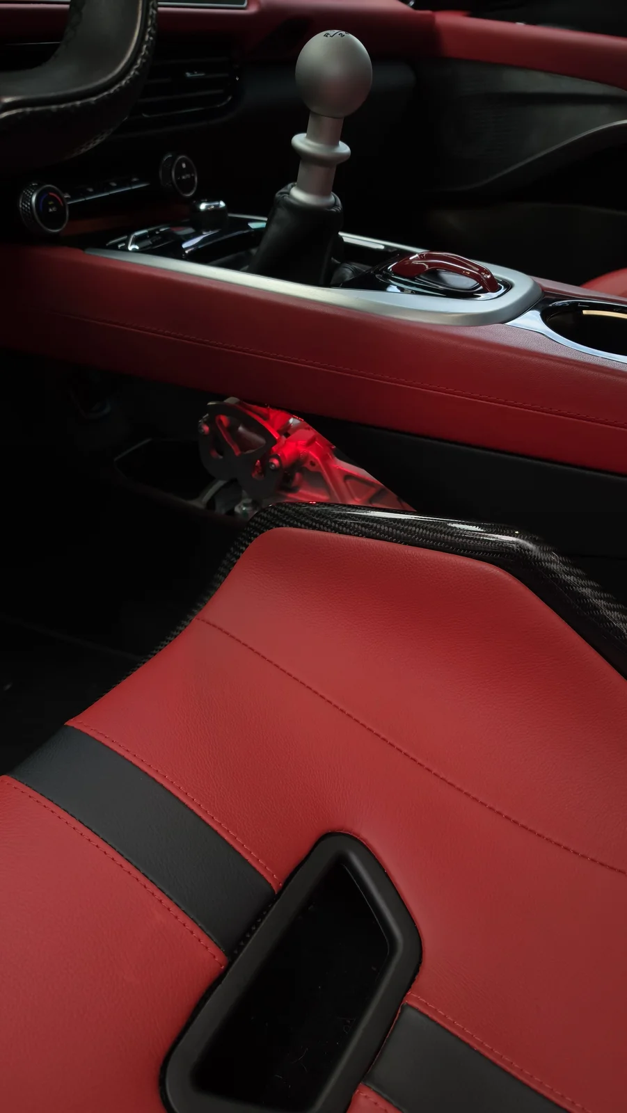

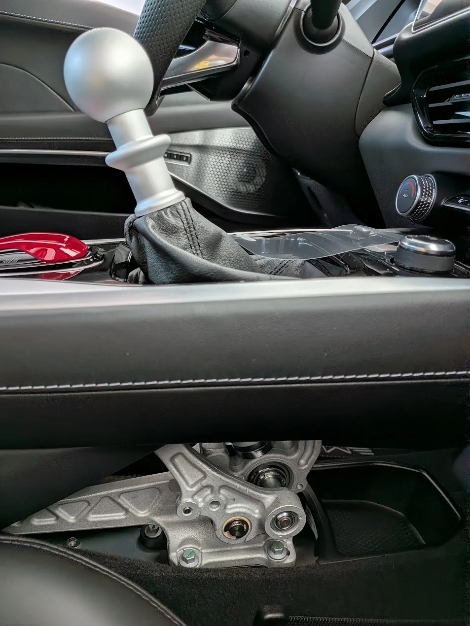

Just did the floating console mod, the interior just looks so much better.
Going to do the shift boot delete another time.

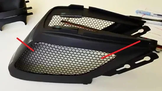

I didn't remove any trim, just broke the cage, a few things I learned:
1. Like everyone said, there is no screws or clips, the cage is just slotted in. Although there are screw holes, I guess at one point Lotus wanted to make it more secure.
2. You have to do the same amount of work for each side. Unless some else figured out a better way.
3. The mesh is metal, but pretty easy to cut.
4. I did one cut of the plastic cage, and twisted it to get it out. Making two cuts would probably make taking them out much easier. (I used someone else's picture to indicate where I think the cuts could be / easier to cut)
Thanks to @kitkat and everyone who shared!

I'm glad you braved this path. I almost did the same. Taking dash apart was scary, and some of the push clips will never be the same. If I could go back and do it all over, I'd do it this way.

Forgive my ignorance as I'm still learning from this thread, if this plastic shroud holding the metal cage is bolted in (shows holes where bolts would go) is just cut and twisted to come out, how do you remove the whole thing if it's bolted in?
The metal mesh with plastic surround on the lower of the console is slotted in at the front, the sides , the top and the rear. It's an annoying piece to get out which normally requires lots of disassembly to effectively lift up the center console and pry it out. The alternative is to just hack away at the mesh and plastic destructively until you can remove it.
Second kitcat.
The plastic cage is not bolted, it's just slotted in. There are holds on the cage but no bolts used, maybe Lotus planned to bolt it but decided no to? To remove the cage with the least effort, you need to cut the metal mesh, then cut the plastic cage, basically destroying the cage to remove it.
If you want to keep the cage intact, then follow kitcat's method.
