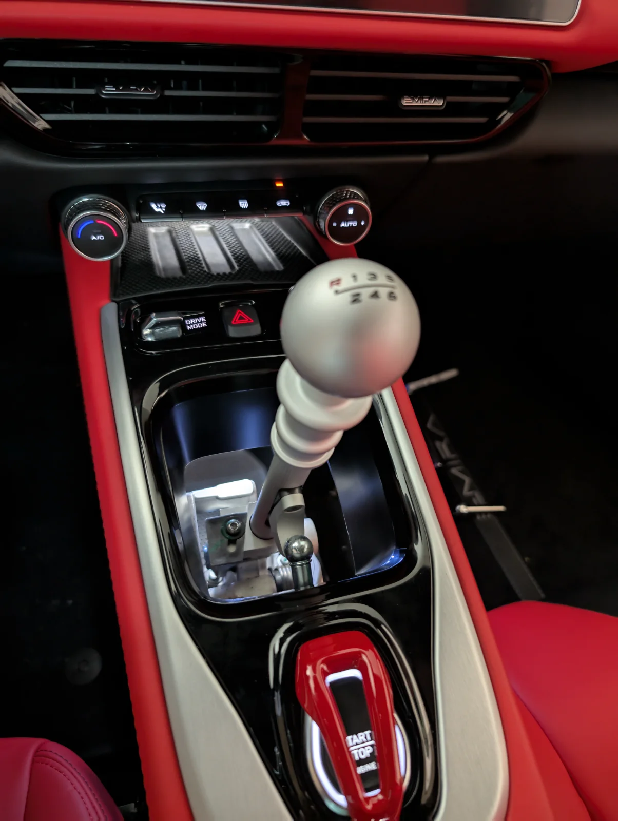

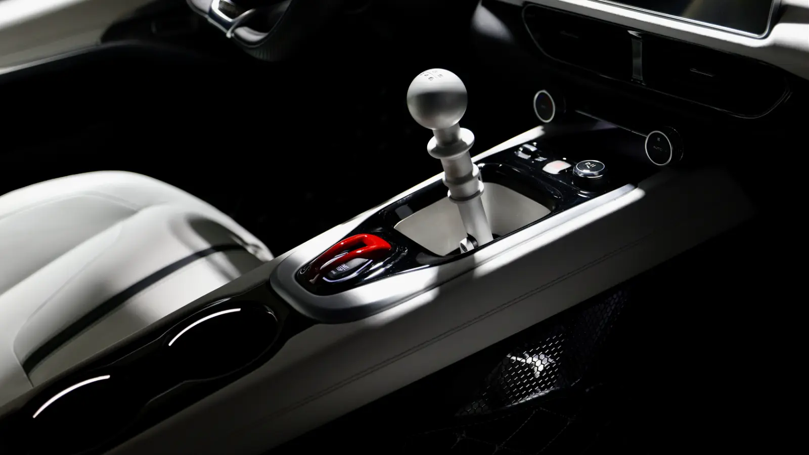

Posted in another thread but also wanted to say I'm pleased with the Darkworks Designs Aluminum shift boot delete. I think the silver matches the white interior better. Agree on the quality.View attachment 64556
Never thought about white interior with this, it looks incredible.
Didn't even know there was a black option which is annoying as I just received the silver version

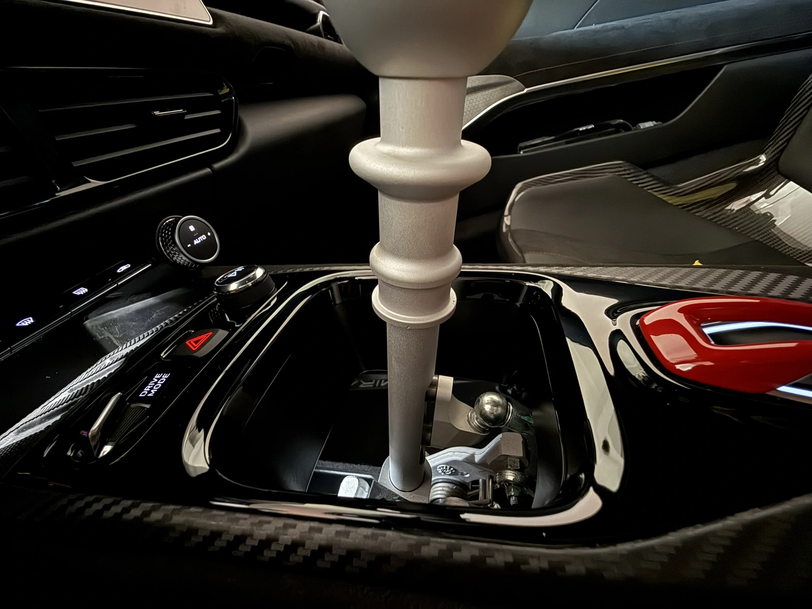

I'm going to have a crack at spraying my shroud gloss black this weekend, and will post some before and after results. So far, I am just super happy with the exposed look, so my hat is off to you @kitkat for the guide and print template. The matte carbon-fibre PETG actually looks pretty tidy paired with an alcantara interior, so I'm conflicted whether it needs glossing up... so I'm taking the coward's route, and using Plastidip to start.

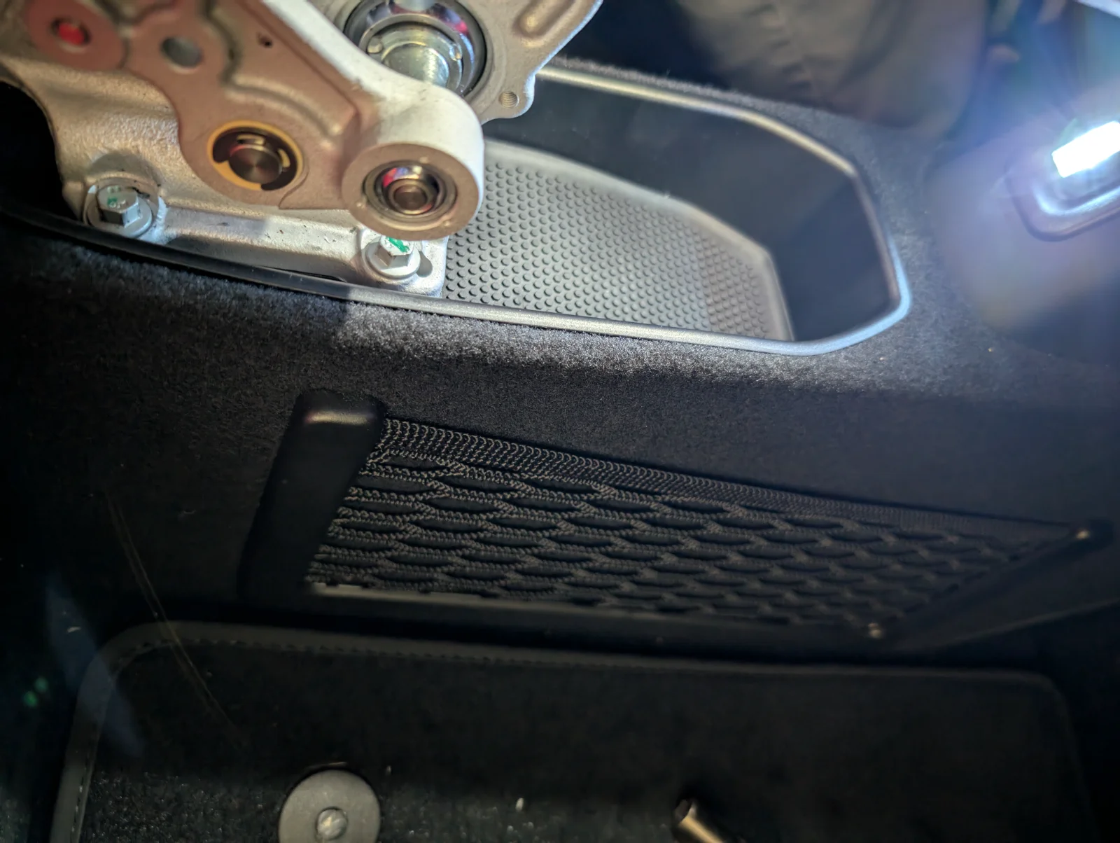

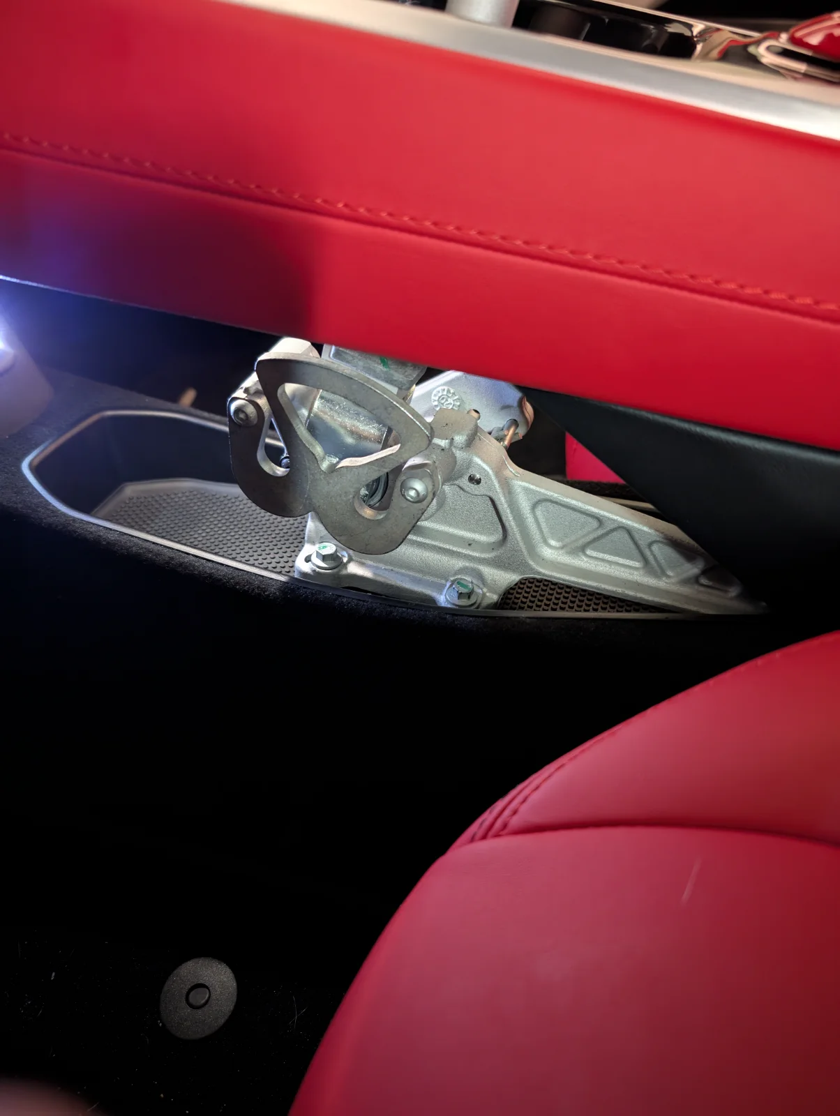

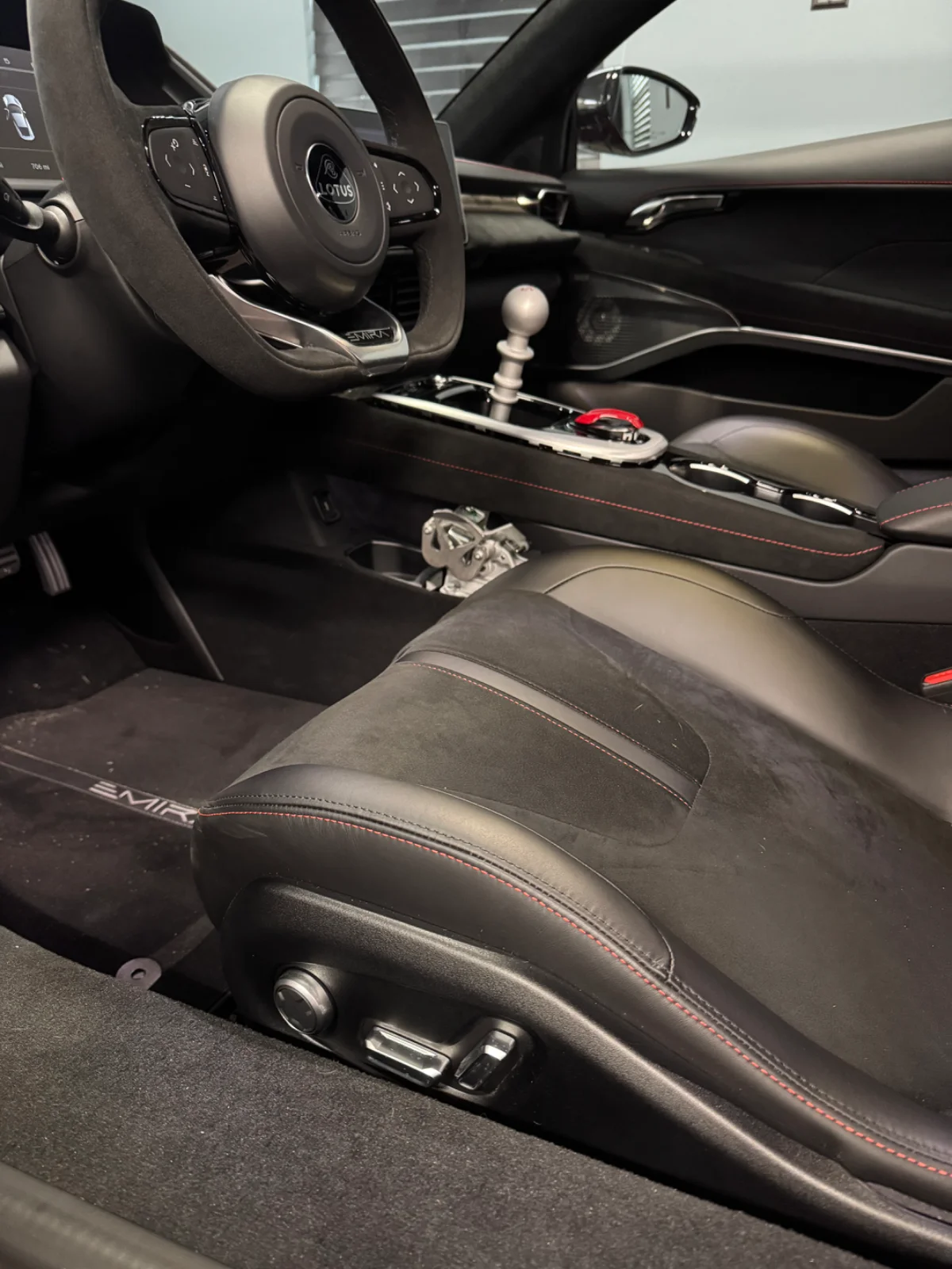

Alright I have finished this mod and while doing so got to thinking. Are we making Colin happy or are we just doing a vanity project? I weighed all the parts on my kitchen scale. Heres what I got:
Removed:
Shift boot (and zip tie) -48 grams
Linkage cage -301 grams
Small storage cup and liner - 85 grams
Added:
Suntory Boot delete +55 grams
Big Tray and liner (after modification) +113 grams
(2) added bolts for Big tray +17 grams
Giving us a net of -249 grams or 8.78 oz in freedom units. Mission successful.
Heres some pictures of my install. I didnt try it but I think it would be even better if you cut the large tray to fit behind the small tray. That way you still get a usable tray and a factory look. I might do it in the future.

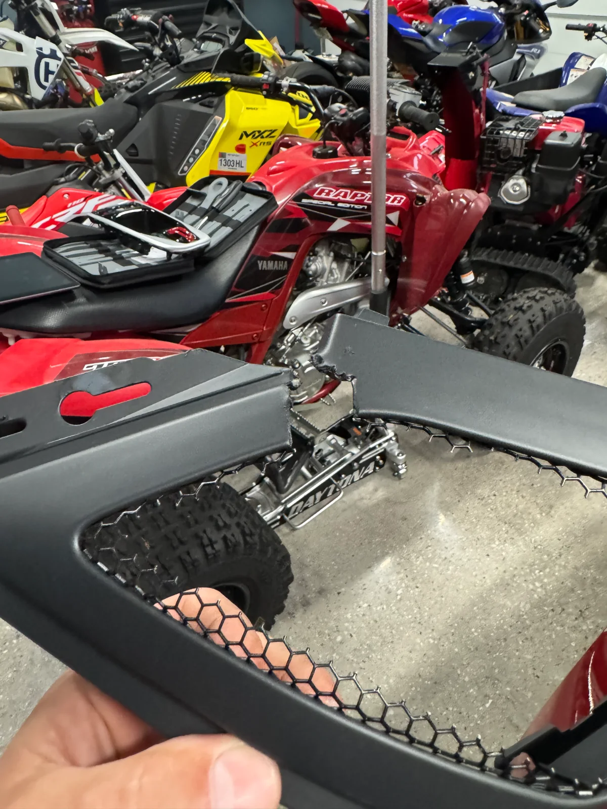

So I did not want to take the dash apart. I snipped the mesh from the cages and made 1 cut through the plastic with dykes and pulled the cages right out. Hope that helps anyone who is committed to not going back to a cage avoid taking apart the dash etc.

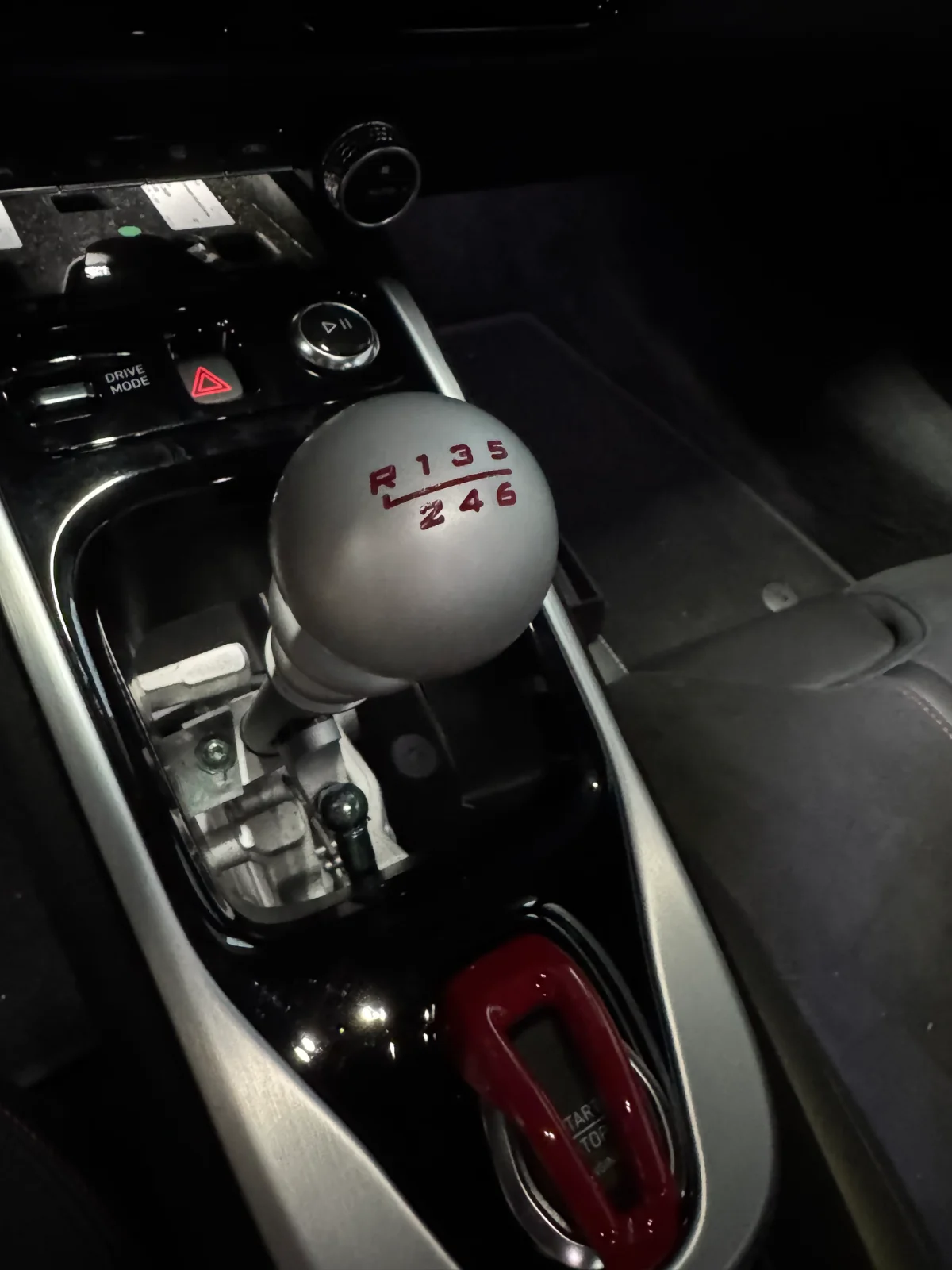

I colored in the shift nob as well. I melted the tip of a crayon into the gear numbers and wiped away the residual. With crayon you can find hundreds of colors. I went with “razzmatazz” which matches the Magma haha

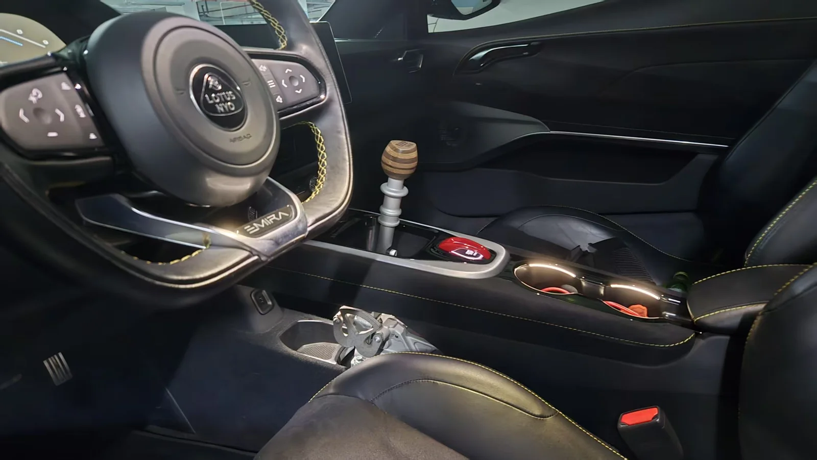

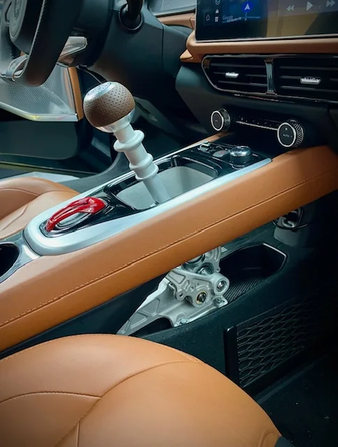

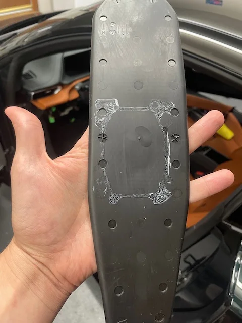

Finished up the floating console mod, including the shift boot delete from GRP and modifying an automatic console tray. Instead of measuring and cutting the rubber mat, I installed the shifter support block and applied white lithium grease to the top, then placed the mat over that to leave a perfect print on the bottom. Then it's as simple as cutting around the print with a scalpel. Came out great.
Also love the new shift knob which is fully customizable with different base colors, leather colors, or alcantara. Once it's officially available I'll make a post about it (not affiliated with the seller, but they used my car to test fit).

I did something similar. It was strange the shifter is slightly off center. Thought it was just mine
