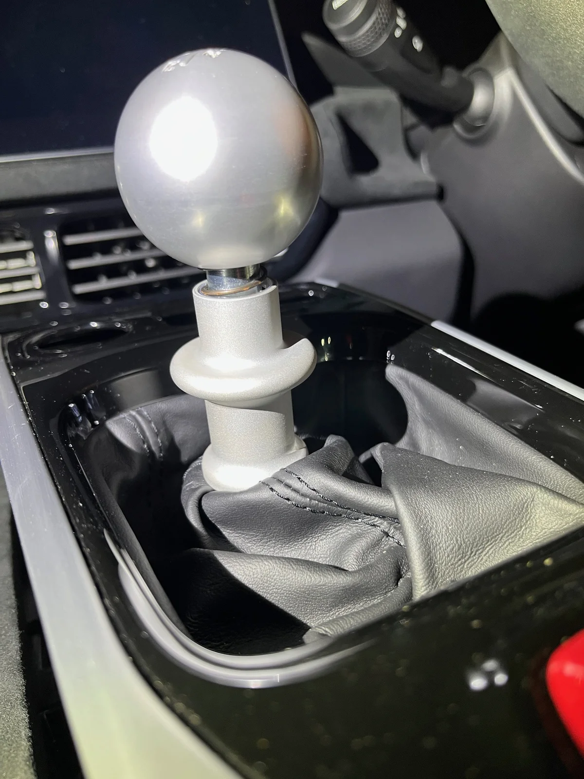

1. Remove gear knob.
Loosen the M5x16 grub screw from the front of the gear shift knob with a 2.5mm hex key.
You can remove the grub screw if you wish. Then unscrew the gear knob (and don’t worry about the spring scratching away as you unscrew). Remove the knob, screw, spring and set aside; do not try to remove the reversing mechanism.

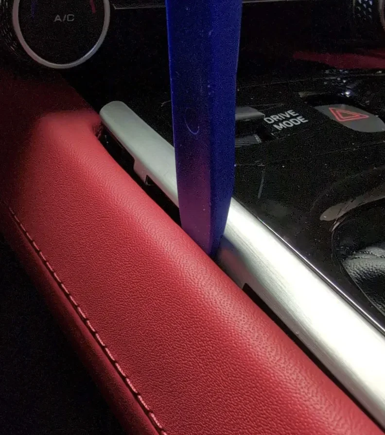

3. The whole piece of trim (piano black and brushed aluminium) is removed as one piece. Pull up near an edge and then slide your tool underneath. In hindsight I’d recommend putting a thin piece of cotton around the tool - both sides (you don’t want to scratch the aluminium and don’t want to flatten the alcantara/scratch the leather). My alcantara didn’t like being flattened with force although brushed up ok with a toothbrush after.

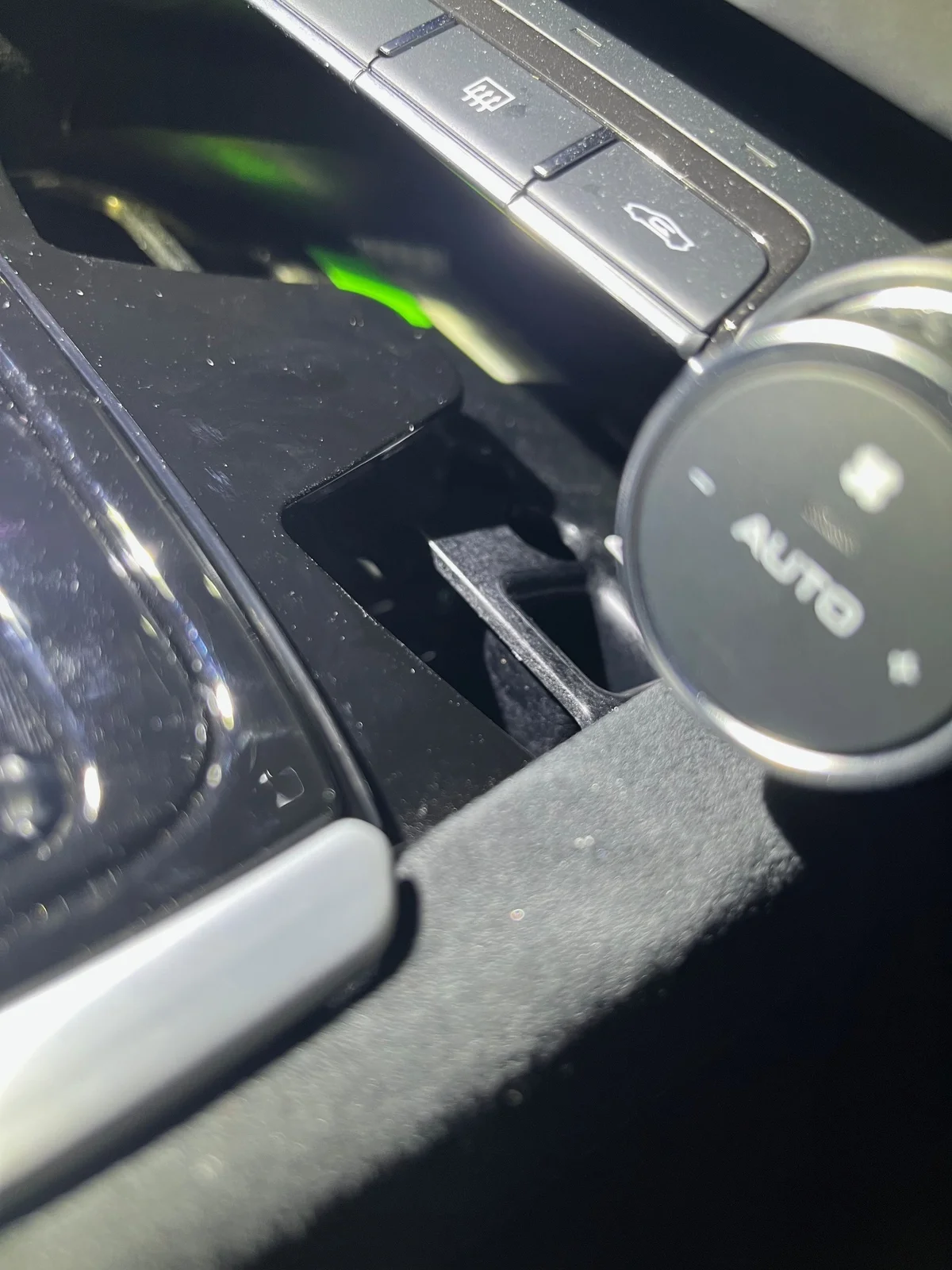

4. Work your way from front to back. It gets a little stuck on the pause/volume button, but does lift over.
5. Once it’s removed, you will need to disconnect the start-stop button by depressing the front edge of the connection. The start-stop button stayed loosely attached to the trim, but drops by about 0.5cm as you lift the trim.

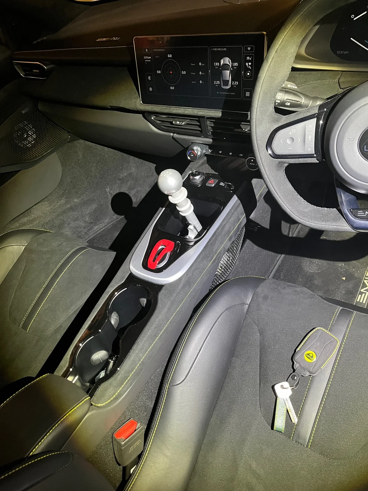

10. Attach the Darkworks shift boot delete; the recessed portion of the part should be next to the start stop button. Ensure the part sits perfectly central; the mounts do overshoot the edge of the trim slightly but this doesn’t prevent fitment.
11. Reattach the start-stop connector. Remember that the start stop isn’t properly attached to the trim.
12. Replace the trim back in the car starting with the area near the start-stop button; do ensure it’s in the correct position and the start-stop button hasn’t slipped under the edge of the trim (mine did each time the trim didn't quite re-engage with the clips); needs a decent thump to re-attach them.
13. Re-insert the rubber tray.
