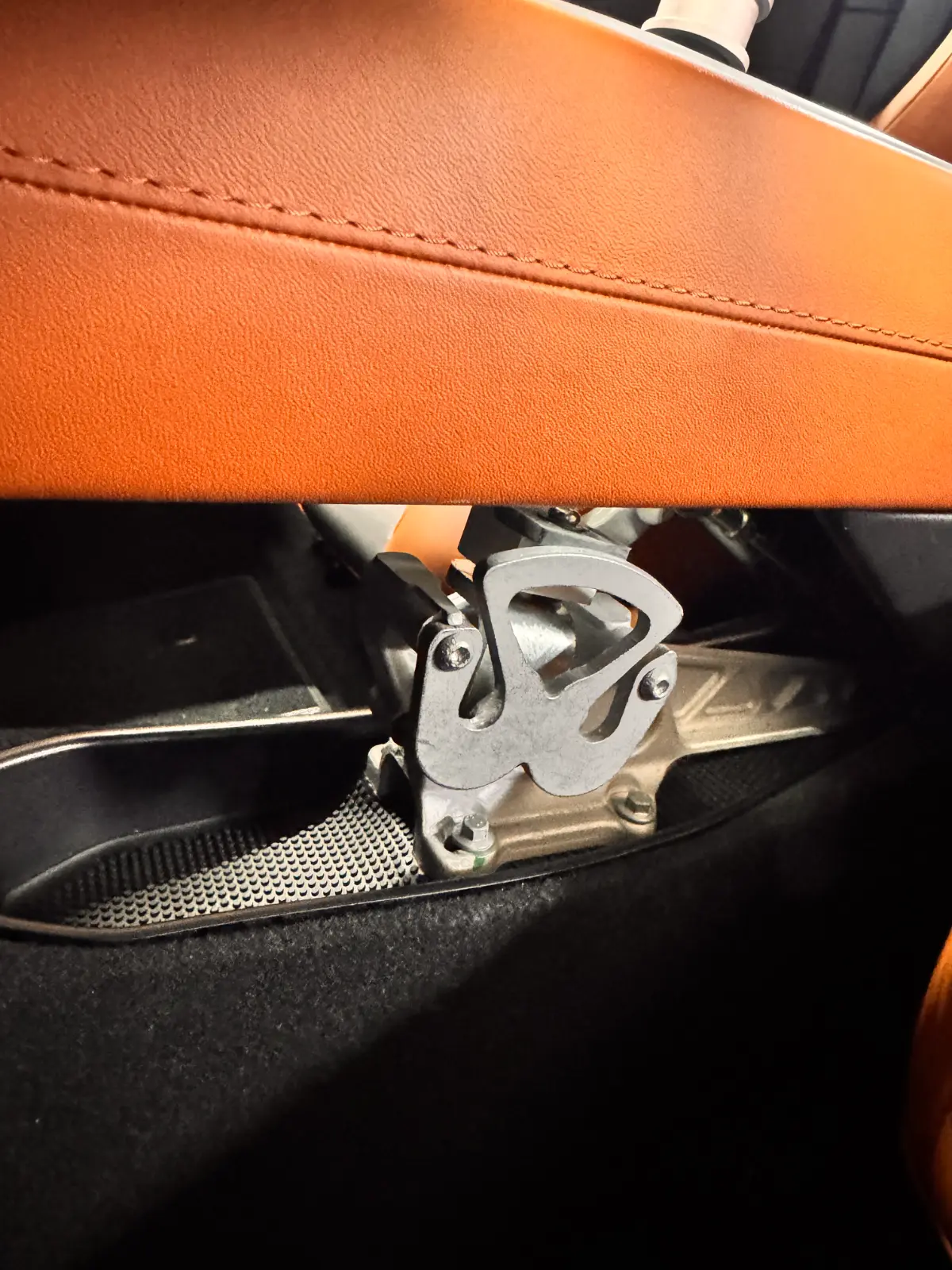

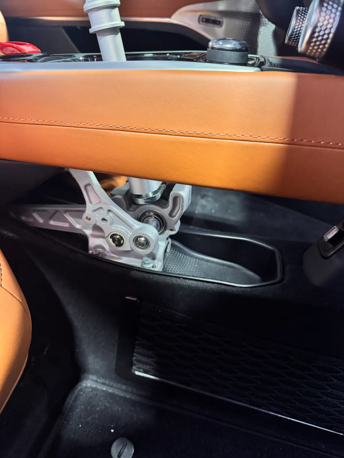

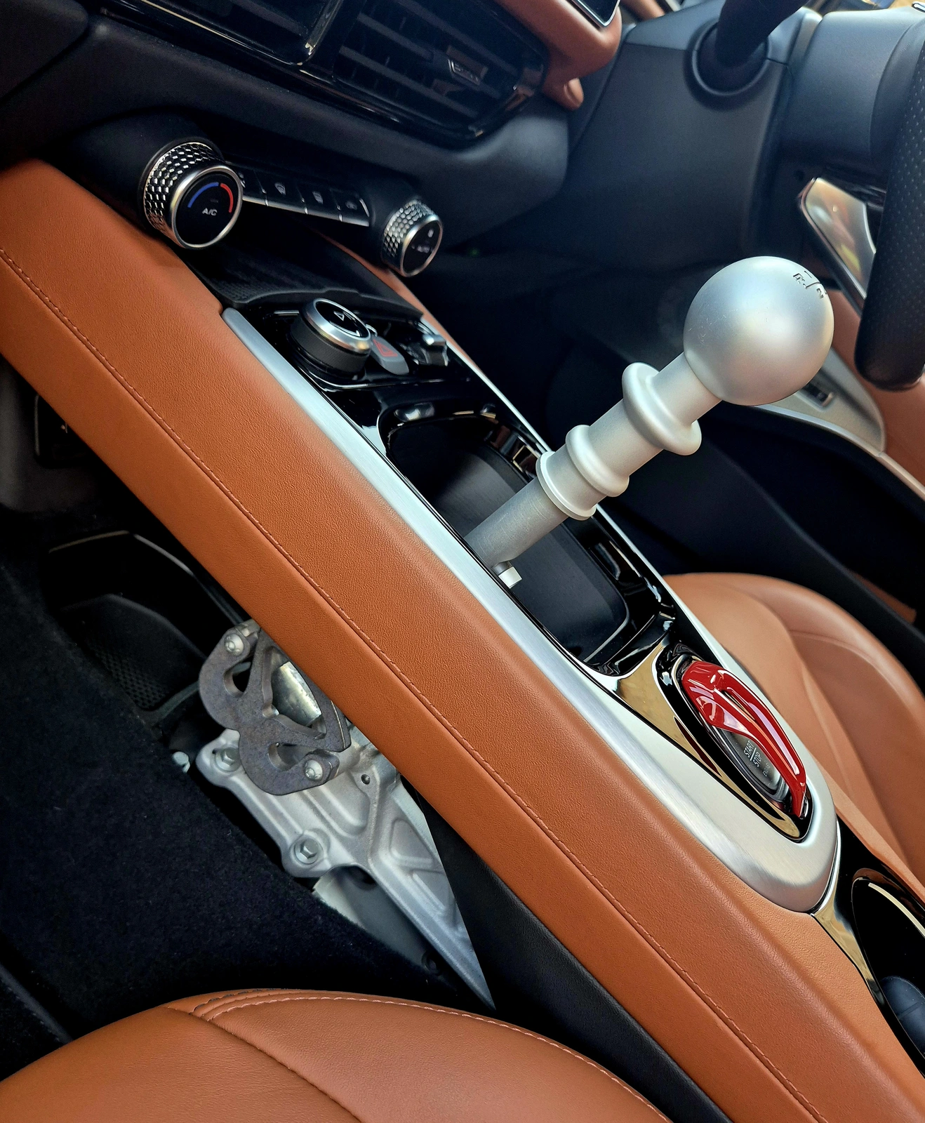

Thanks to @kitkat and the others that helped, got round to doing it today and love it. Need to see it lit up at night now

Does anyone know where to get the clips that hold down the center panel? One of my clips is fill out and no longer gripping the plastic tab, so the bottom left corner is sticking a bit up compared to the right bottom corner.
The tray is raised and doesn't sit flush against the chassis so it's hard to measure that way. It is also difficult to insert the tray if the spacer is attached to the shifter, there isn't enough clearance.
I measured the location of the front left shifter spacer rivnut in relation to the tray's left rivnut in the chassis, then transferred those measurements to the new plastic tray to make the cut. The hole in the plastic tray for the spacer could be any shape really, what you have to get right is the cutout in the rubber liner.
