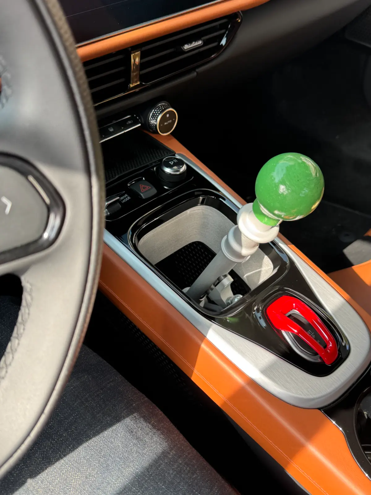

That aluminum shroud is sweet! I think it fits better with people who have a tan interior.

Would also look nice with the white interior. Count me interested in your next run!

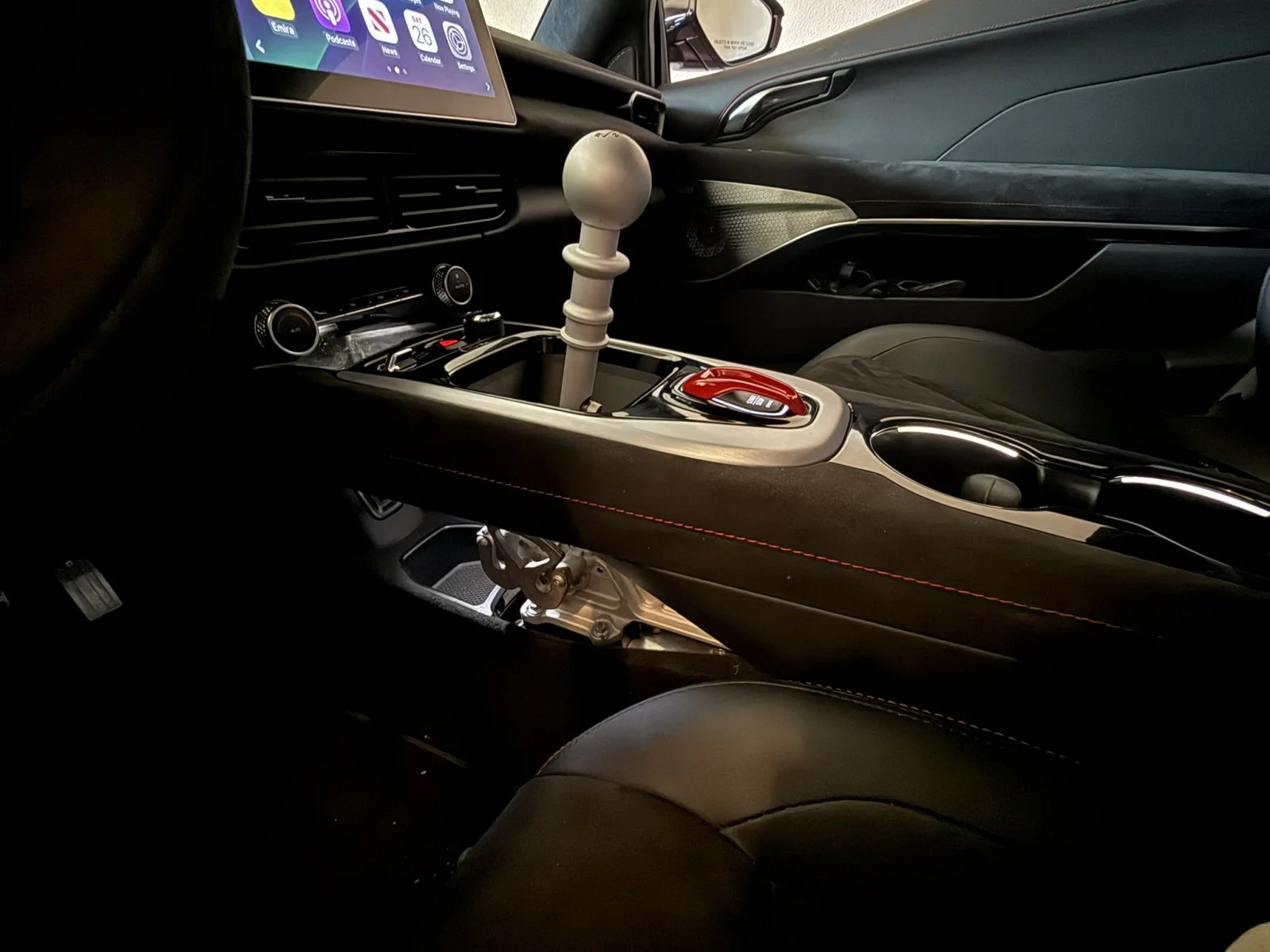

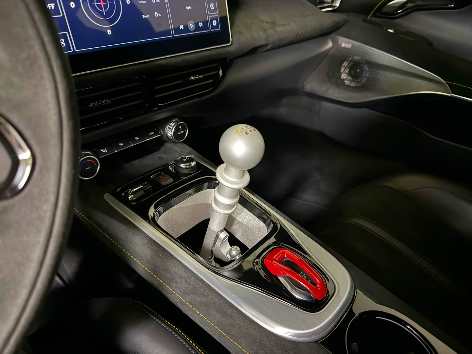

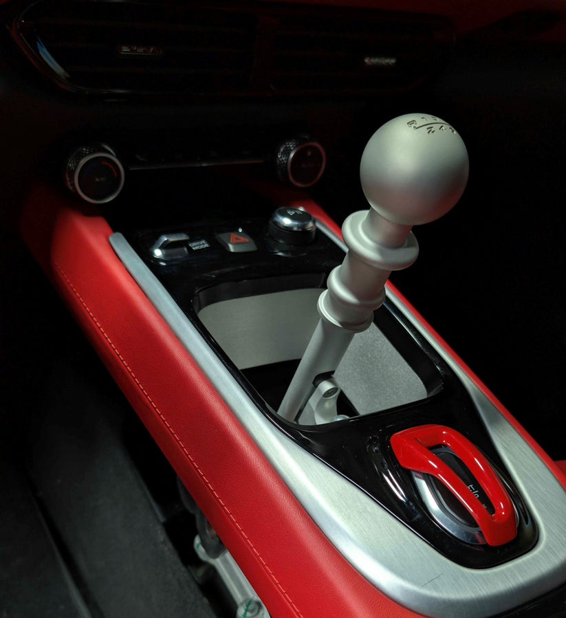

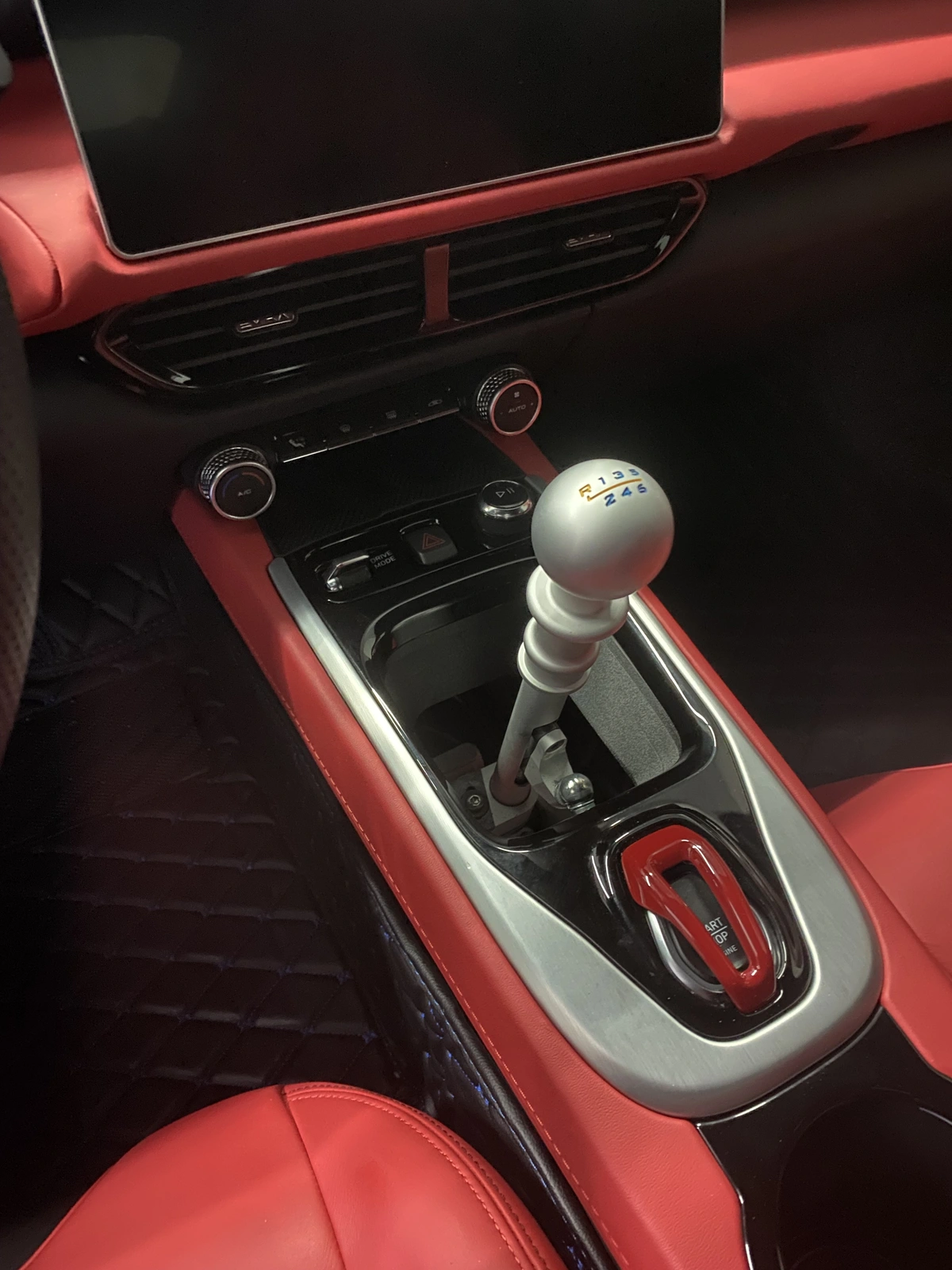

Completed my modification a few weeks ago. Finally got a membership to start posting here haha. Fantastic write up by KitKat and went fairly smoothly. A little bit of contortionist maneuvering to get the lower dash screws out. Had a buddy of mine print the new shroud in carbon fiber filament. Witamats sit a little high on the sides so they overlap the gap by about 1/2 inch.
View attachment 54277​
This modification deletes the shift boot, the lower shifter mesh grills, and cleans up the look down through the shifter area. It's not for everyone, but for those of us who want the original concept Emira shifter, this is basically it. Special thanks to @Tomwa & @silent cilantro for on disassembly instruction help, and thank you to @Porter for the cheerleading. These guys collaborated with me on the Lotus Discord egging me on to finish this modification up.

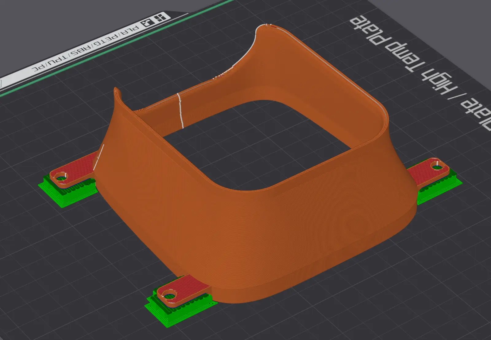

3D Model & Printing Tips
See attachments for the Shifter Shroud - Shroud.stl.zip
  • Use PETG or a higher temp filament as this will be sitting inside your warm car potentially.
  • Use supports from the build plate.
  • Print with 5-7 wall loops.
  • Print with 100% infill.
  • Pay attention to the seam line so it isn't visible, I place it either random or I place it in the back near the cutout.
  • Print time for me is about an hour and 55g of PET-CF filament.

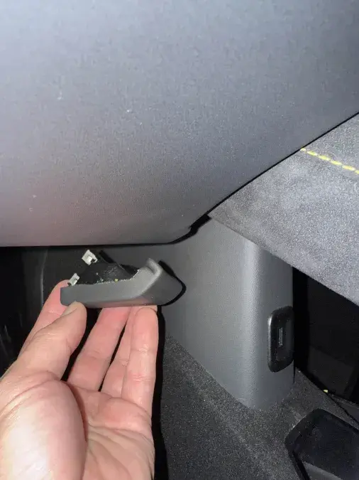

    3. Disconnect the OBD2 port.
    4. Pull the lower kick panel straight out, 11 clips hold it in place, start from the left and work towards the right. You must be careful when reaching the skinny part over the HVAC controls to not break the panel.

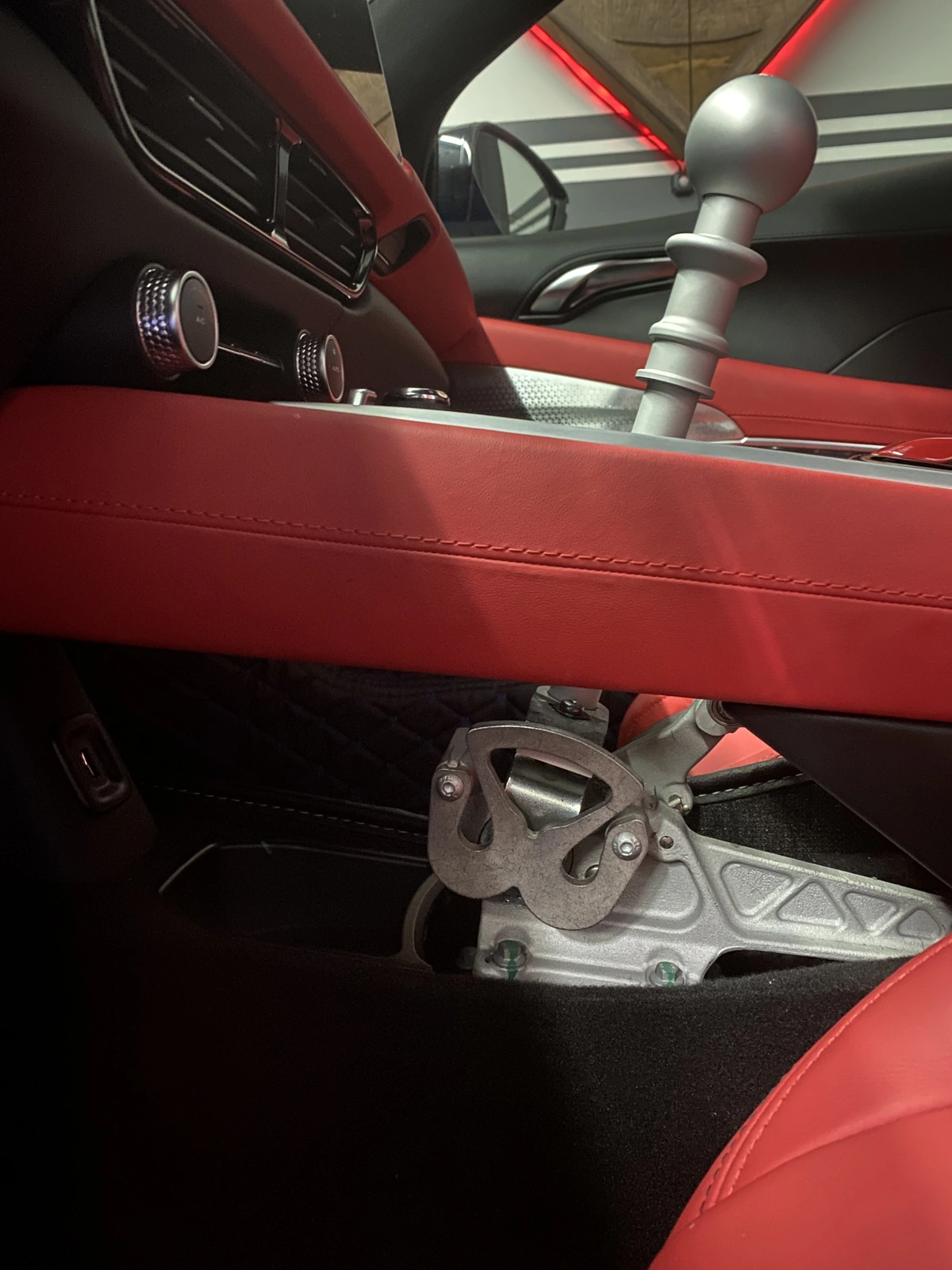

Thank you kitkat

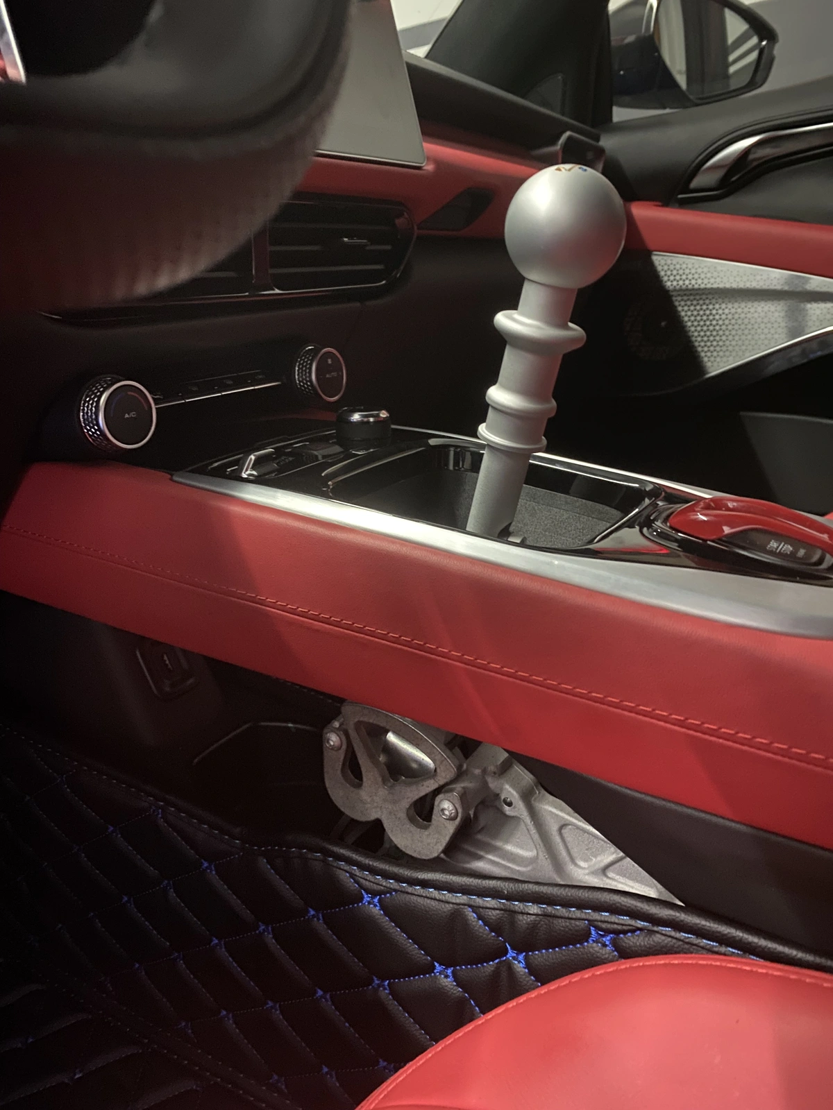

Did the mod today
Instructions were spot on. hardest part was getting the "cage" to disengage from the surrounding area.
The .stl file printed flawlessly.
This mod is kinda like having a skeleton watch. Love to mechanical things do their thing.
