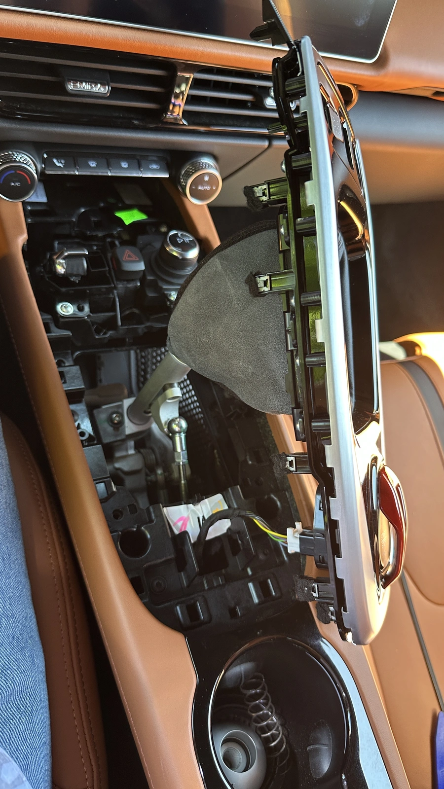

Just a heads up if you did not see it. There is a small clip that is used to attach the wiring from the start button switch to the shift rod. I'm assuming to keep the wire out of the way of the movement of the shift rods. It is not obvious. You may have unclipped it when you pulled the center console hardware out. I did this when I did the floating console mod and did not notice initially.
Thanks for the heads up!! Hopefully I can see in the cage to check for that without pulling the console out again.

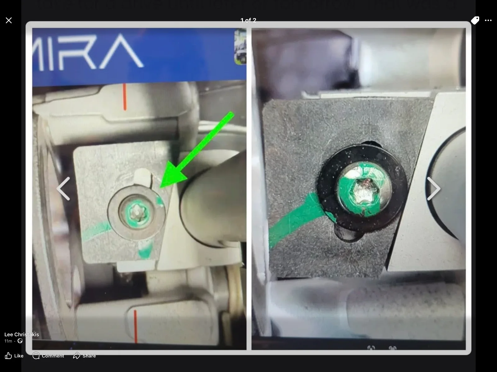

@MAX FPS based on your initial picture I hypothesize like others that your “plate” was more neutral at first but due to the loose bolt shifted downward over time ultimately ending up in the bottom most position. You can see that your green lines do not match up in the pic signifying that the plate shifted from its original setup.
A previous poster showed the same bottom plate position which just based on the design alone feels like an odd choice to set up the car. I think it’s a loose bolt that shifts the plate and leads to suboptimal gear changes.
The plate screw was actually VERY tight from the factory, and you can see the compression outline in the plastic of where it initially was from the factory in my second picture where I moved it. The green line does line up in the first pic but you can see where someone drew it up over the screw hitting both sides of the washer, so it's a bit odd looking. No way it slipped down this low with as tight as it was.

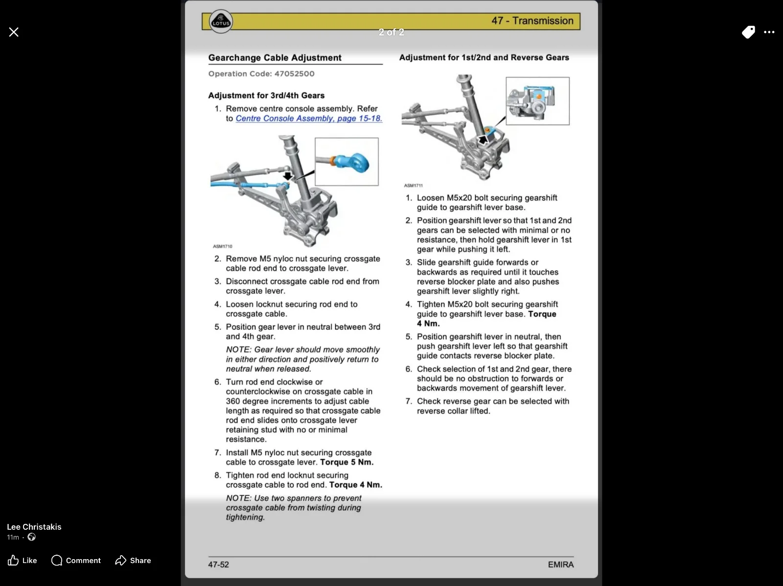

I'd like to thank @kitkat and @Eagle7 for this ridiculously helpful tweak. My shifts are significantly smoother! :giggle:
I'd recommend this to ANYONE whose Reverse/1/2 shifts are more difficult than 3-4-5-6. I think the moderators should make this a sticky thread (not sure how to "at" them?)
I didn't think I "needed" to do this tweak, and I was very reluctant about pulling my console apart. I shouldn't have been. My biggest pet peeve about the car has been 1st-2nd has always felt like stirring a stick in a bucket of stones, and reverse feels like putting a truck in reverse. I've heard the transmission is the same one used in a truck, and every review has said it's a bit clunky and can't be "rushed". As long as I shifted slowly the gears have gone in, so I figured I'd be pulling apart my dash for no reason, or worse doing something that might leave me stranded on the side of the road. Kitkat's instructions and video are excellent and it's not nearly as daunting a task as it seems.

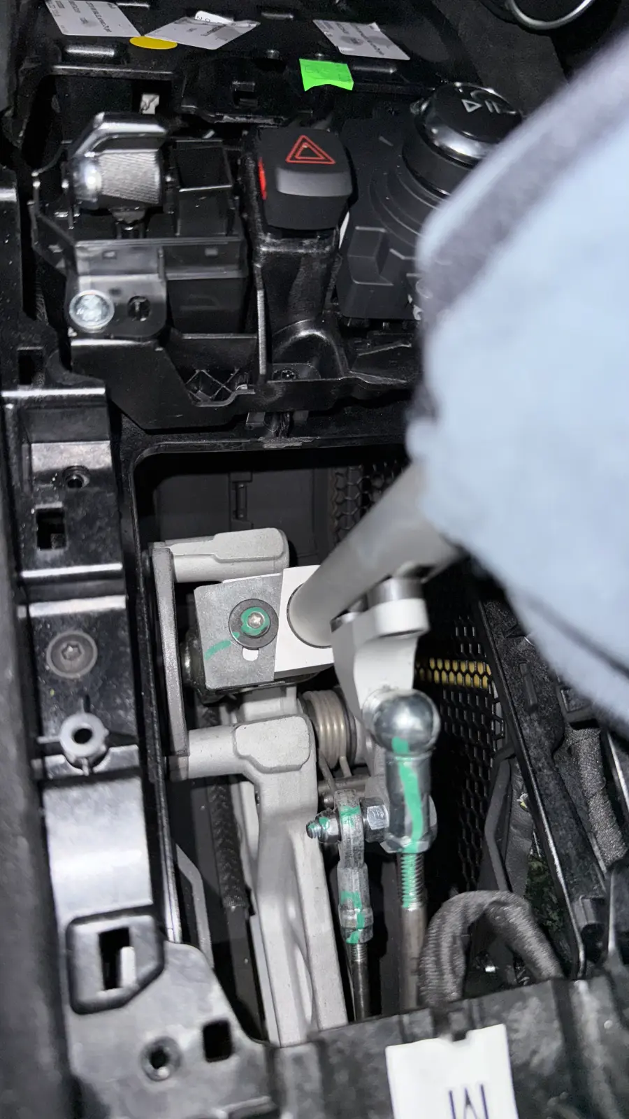

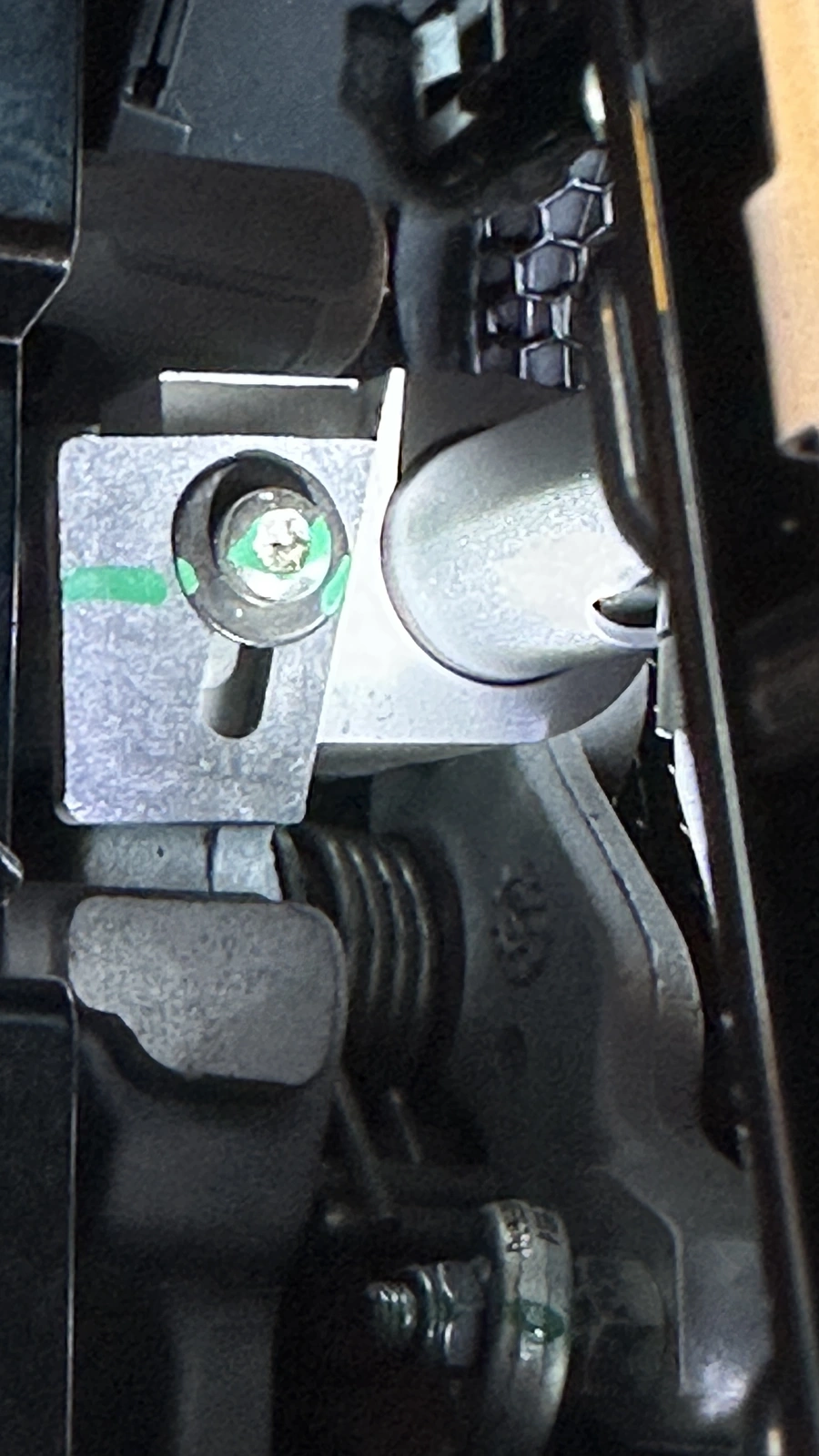

Obviously this factory-set plate position varies by car, and Lotus factory tech, and how rushed they were, but here's where mine was set from the factory:
Pretty much as far back as it could go!

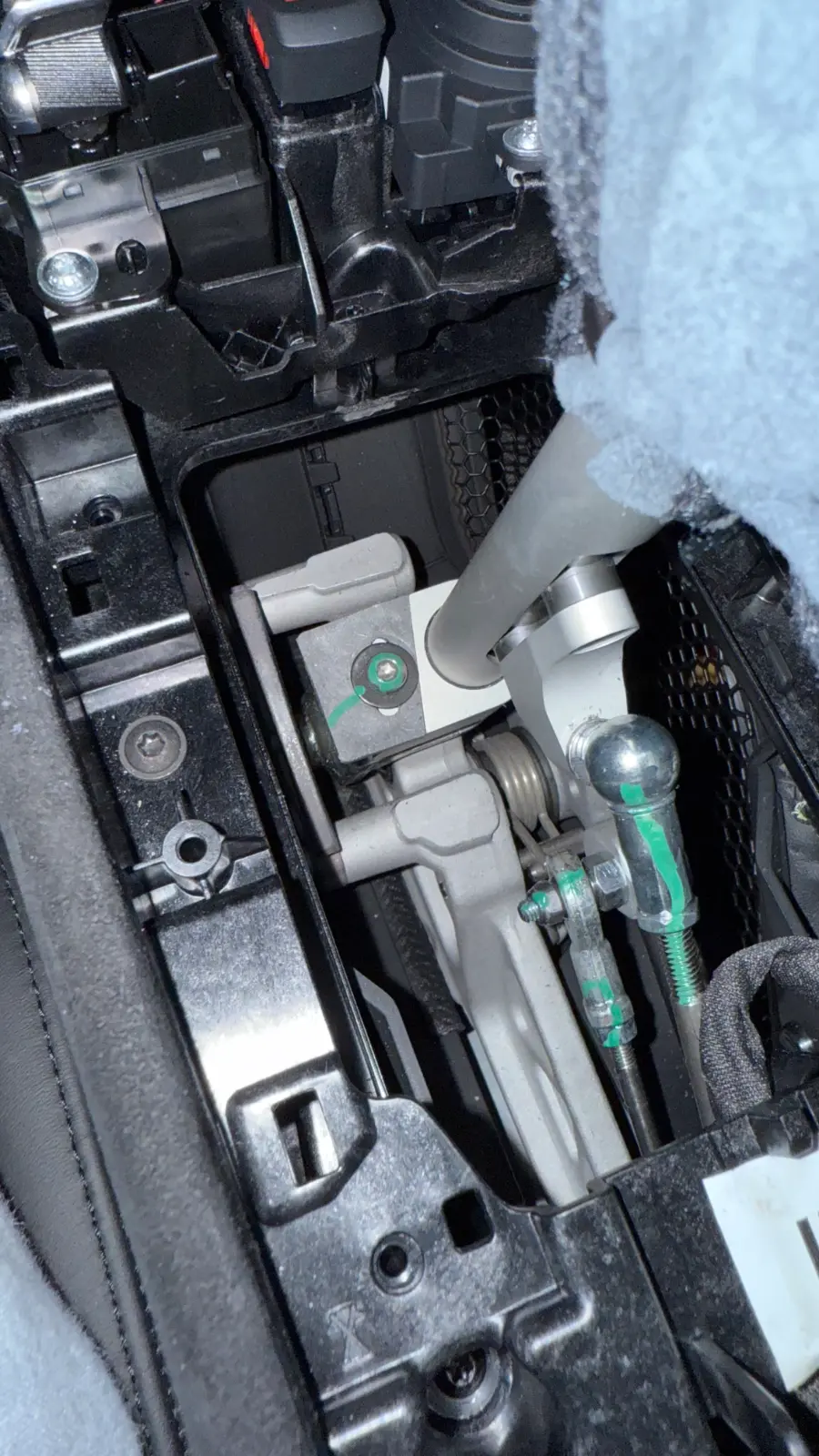

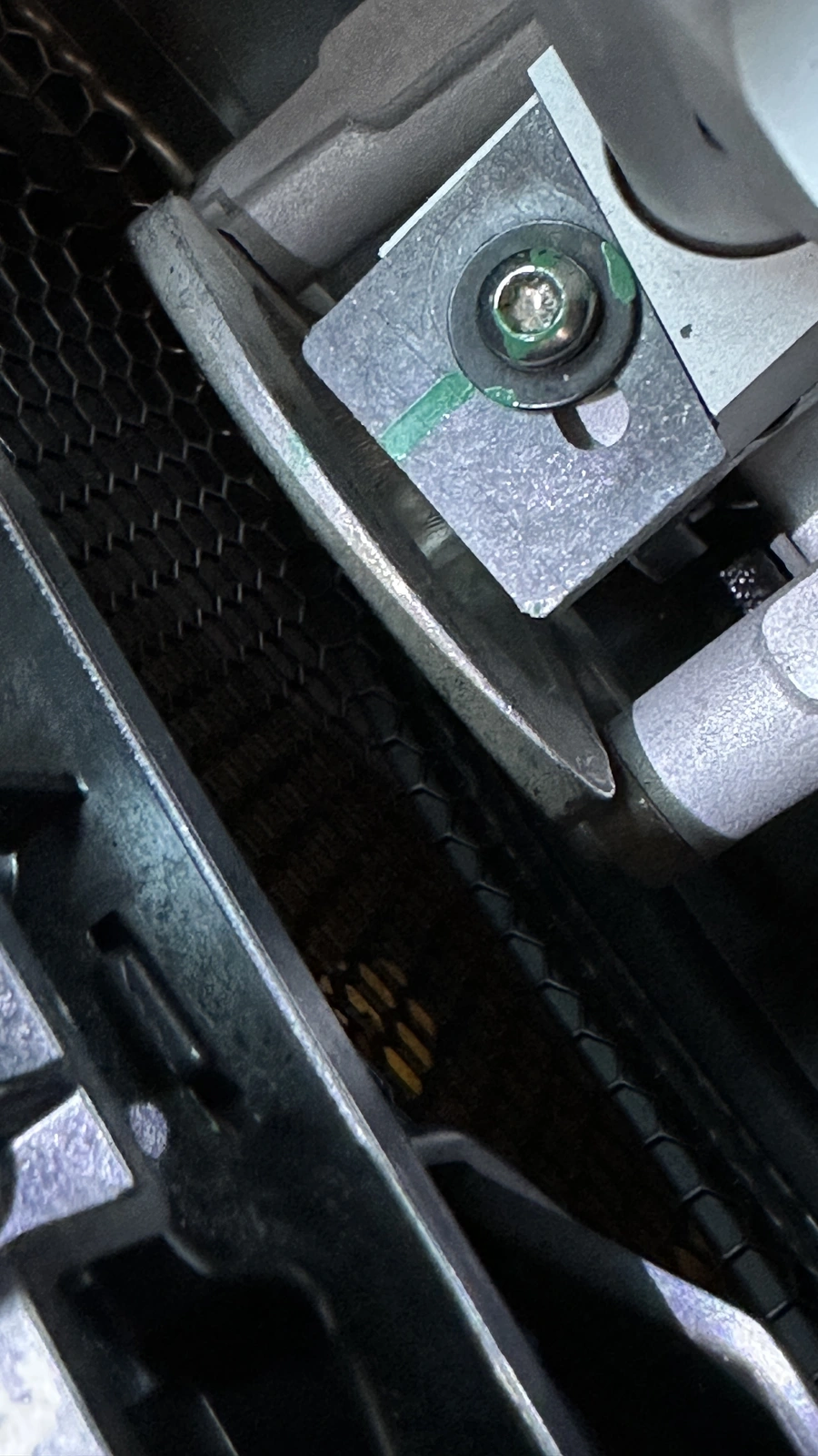

And here's where I've set it now using the super-helpful Lotus technical manual page instructions @Eagle7 inserted early on to the thread. As per the manual, this position when in first gear "shoves the stick slightly to the right":
The angles are different in these shots but you can see the mark of the washer in the second shot how I moved the plate forward 2-3mm.

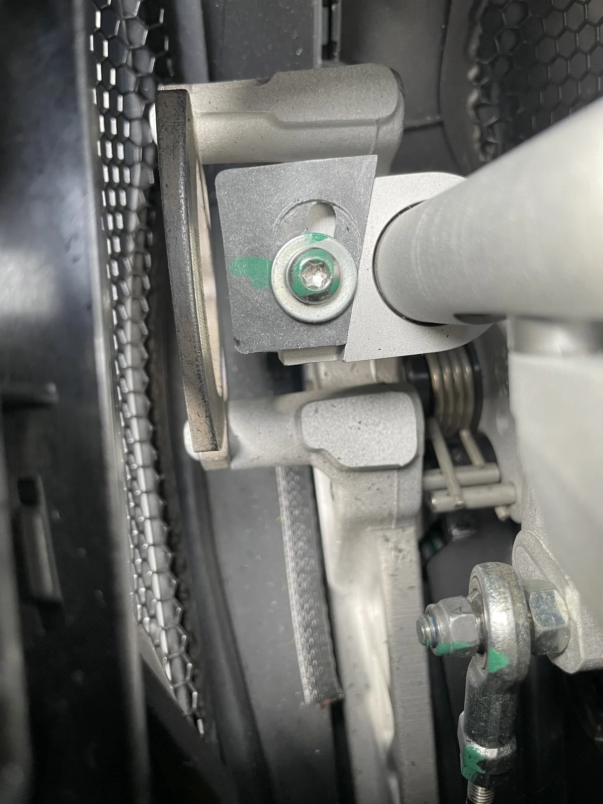

Went back in to the shifter adjustments, you can see from the marker strokes that the factory had it in different place and it drifted since.

Attached photos showing initial “as found” and then attempt 1. Attempt 2 looks just like kitkat’s. Was the best for me.

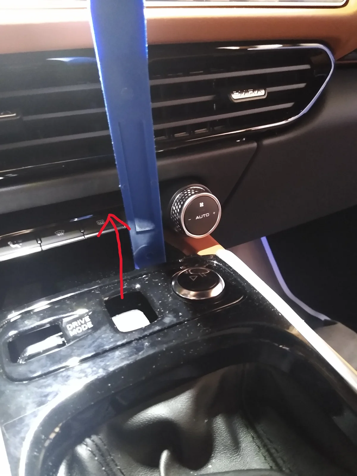

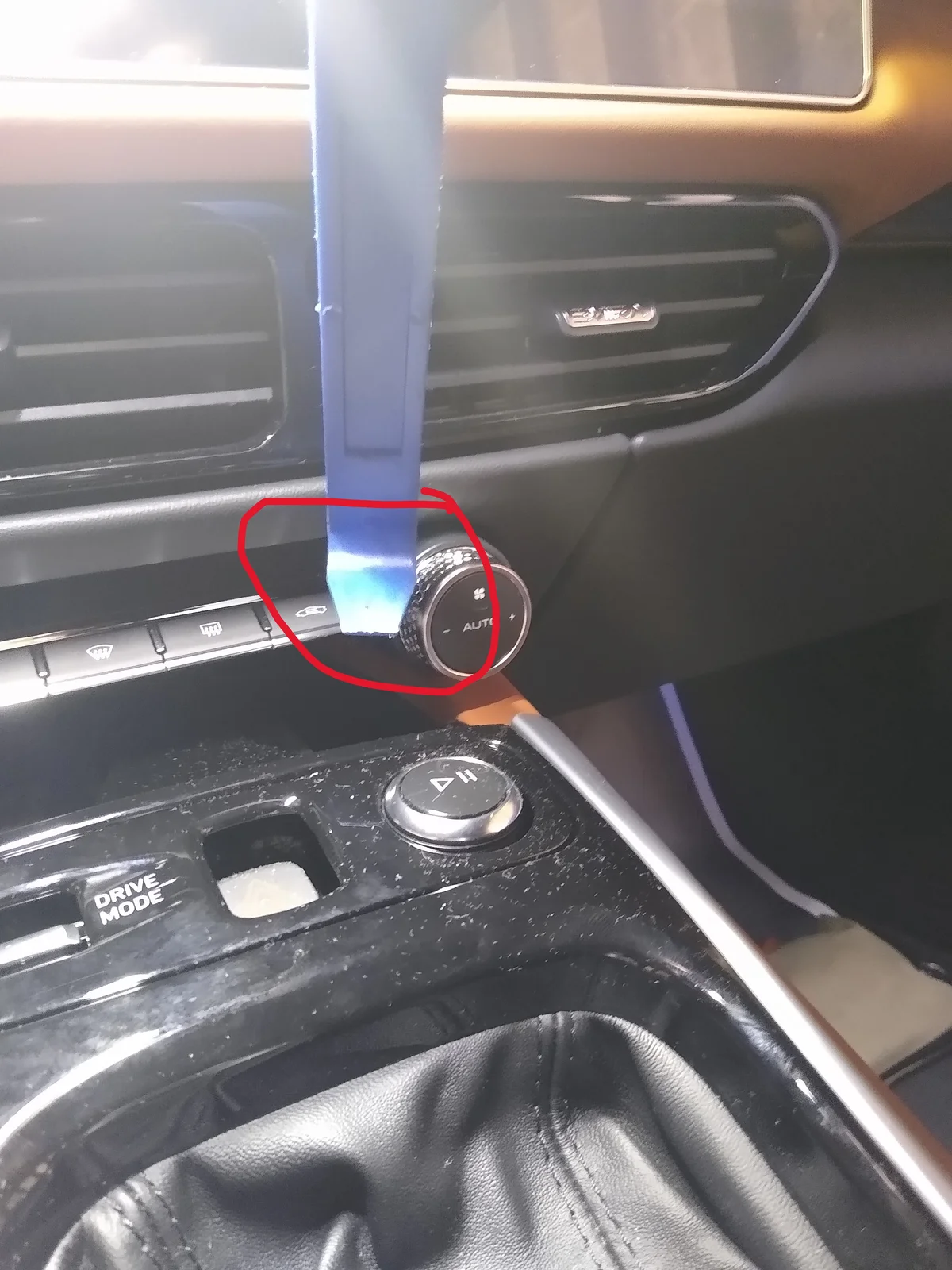

This was very helpful and fixed my 1st gear issues. Hardest part for me was getting the center console unclipped. I discovered that the easiest way to get the first clips undone was to use the short end of the trim tool as a hook and pull straight up on the console.
After the first clips were undone, you can just grab the sides and the rest pops out easy.

Just checking I’m doing this right for the symptoms, it feels like going into first gear itself is a two stage push to get in and then a little for 2nd. I adjusted 2mm but it didn’t do much, I am trying to solve the same issue as everyone else? 3/4/5 are smooth to go in, 1st and 2nd aren’t.
Ok I did the adjustment again and this feels better - picture for final positioning.

Is the left the before and the right the after? Is that where I want the final position, the image on the right (closer up image)?
It was on this adjustment. However, it’s not a one size fits all. You need to set it directly for your car. It may be in a different position to the picture. It’s best to follow the instructions in the text.
