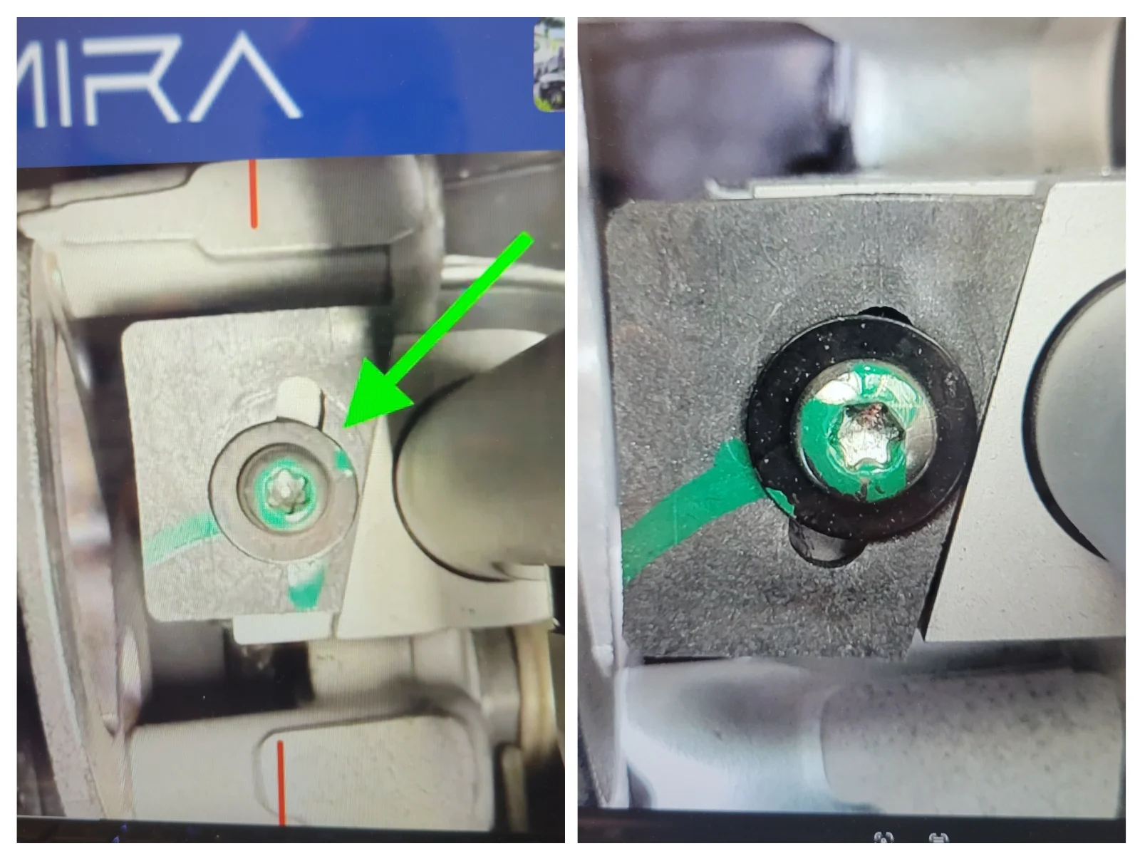

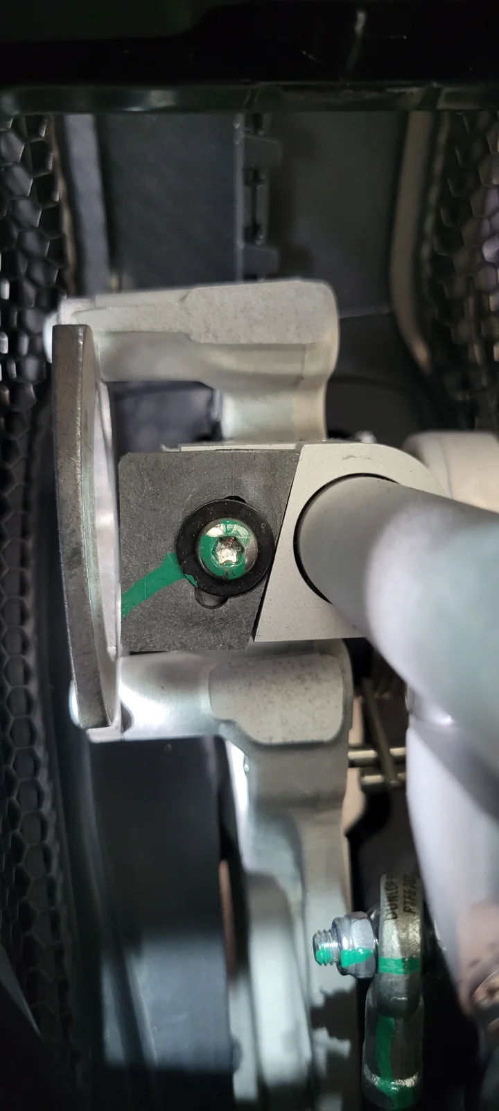

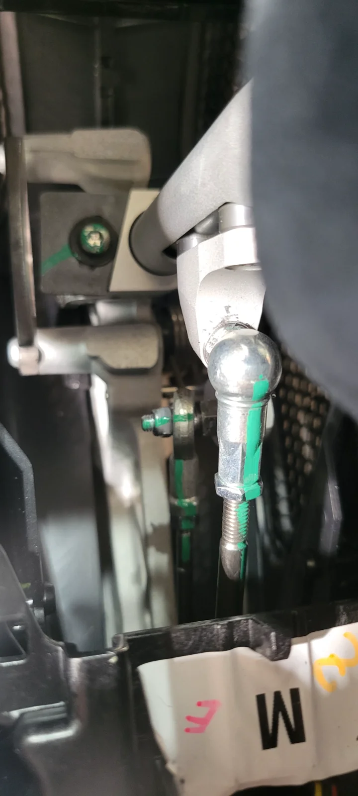

I cannot believe I waited 3500 miles -- the adjusting screw wasn't even hand tight -- although it really didn't look like it had moved from the paint marked spot -- until I moved it up,, wow wow wow what a difference. Reverse, 1st, and 2nd, much more like buttah now compared to the force required 10 mins ago! 1st to 2nd AMEN!, downshift 3rd to 2nd AMEN! WOO!
It doesn't look like you shifted it much at all. Almost looks like a shift down? Maybe some of the improvement is related to just screwing the damn thing down tightly. Mine was also not super tight and could explain why sometimes it was fine and sometimes a little crunchy. Now, just smooth all the time.
Just did this mod and it is probably one of the best most impactful mods I’ve ever done on any car.
I went from being ok with my gearshift lever to absolutely feeling like its almost as good as my Japanese shifters ( mazda, honda, toyota ). It was always decent and pretty good for a lotus ,especially compared to my GT which was good , but the Emira was a bit better.
My experience is rubbery BMWs, vague Toyotas, Porsche perfection and Honda s2000 slippery sexiness (sorry, but that's what it is). The Lotus shifter is now precise, smooth and by FAR the most mechanical feeling. It fits the open gear look and overall ethos of an old school supercar. It still leans a touch to the right of center, but it's a Lotus right? Very happy with it.

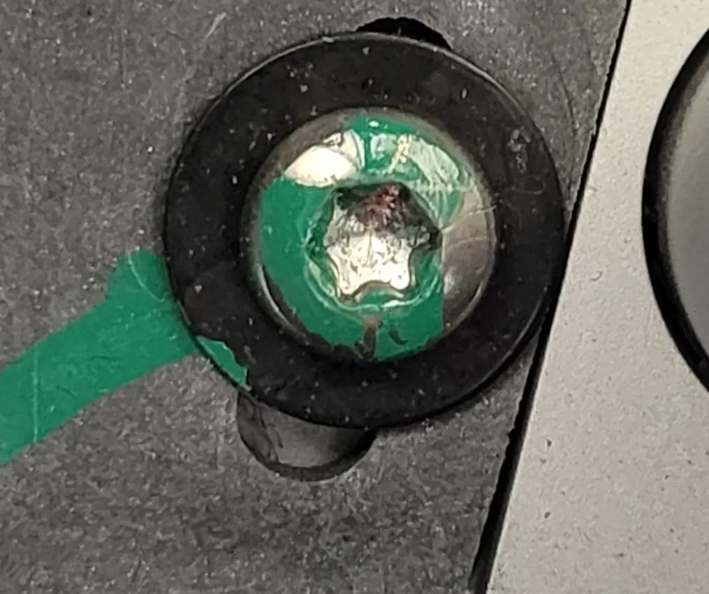

You can see the move better zoomed in on the original alignment mark -- I moved the plate forward
I looked at the original photo again and see the old washer marking (both the outline and the green mark). Wow! yours was setup from factory almost at the extreme bottom setting.
I didn't even notice the washer mark until you mentioned it -- I hope I made it tight enough when I put it back, doubt I cranked it tight enough to make a mark with the washer, we'll see.
WTF are they doing in the factory?!
Figuring out why they only have 18 minutes to install a whole ass dash and a shifter or something lol.

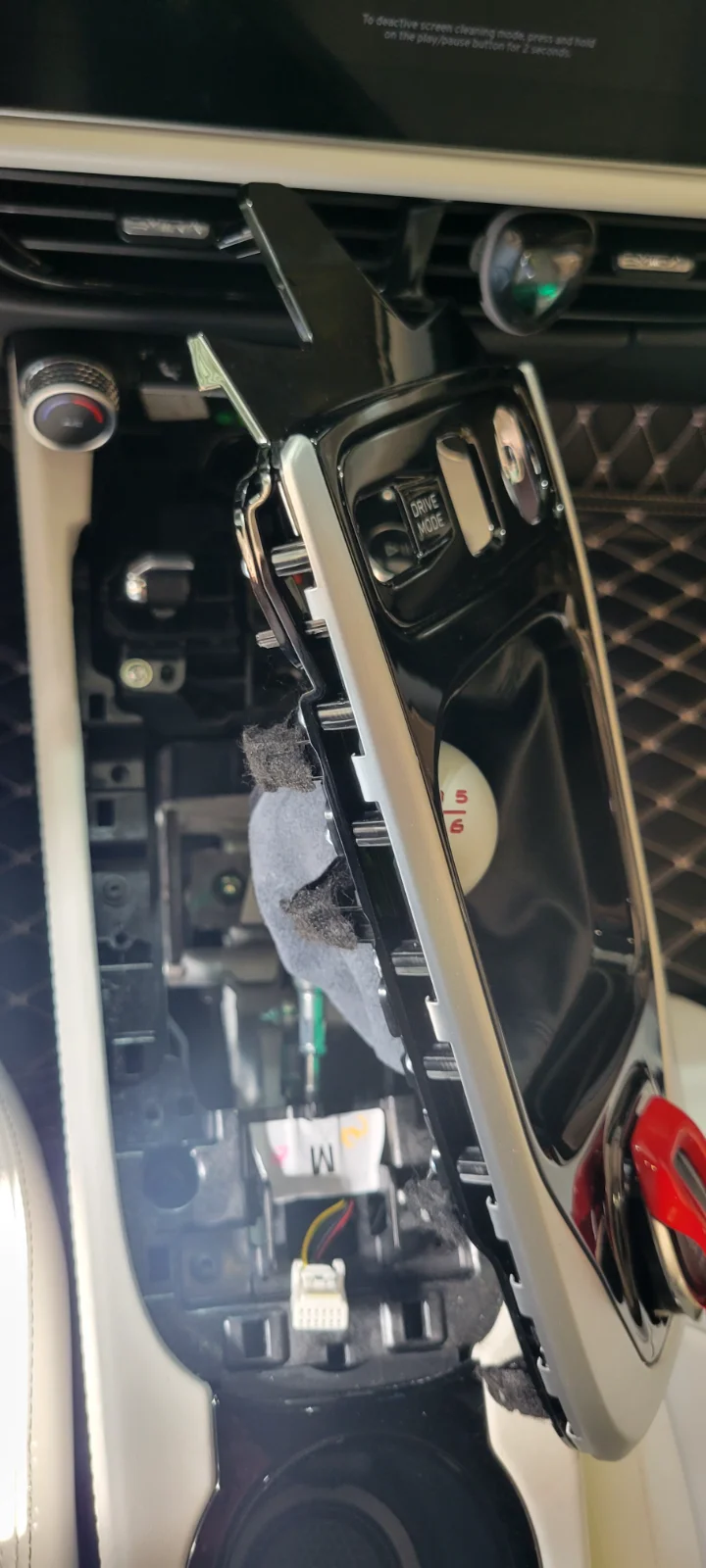

just did this. Having the shift boot delete really makes this a 5 minute job. My bolt was not even tight. Thought I would have to break it loose. not tight at all. Now have to find just the right spot to smooth out these shifts

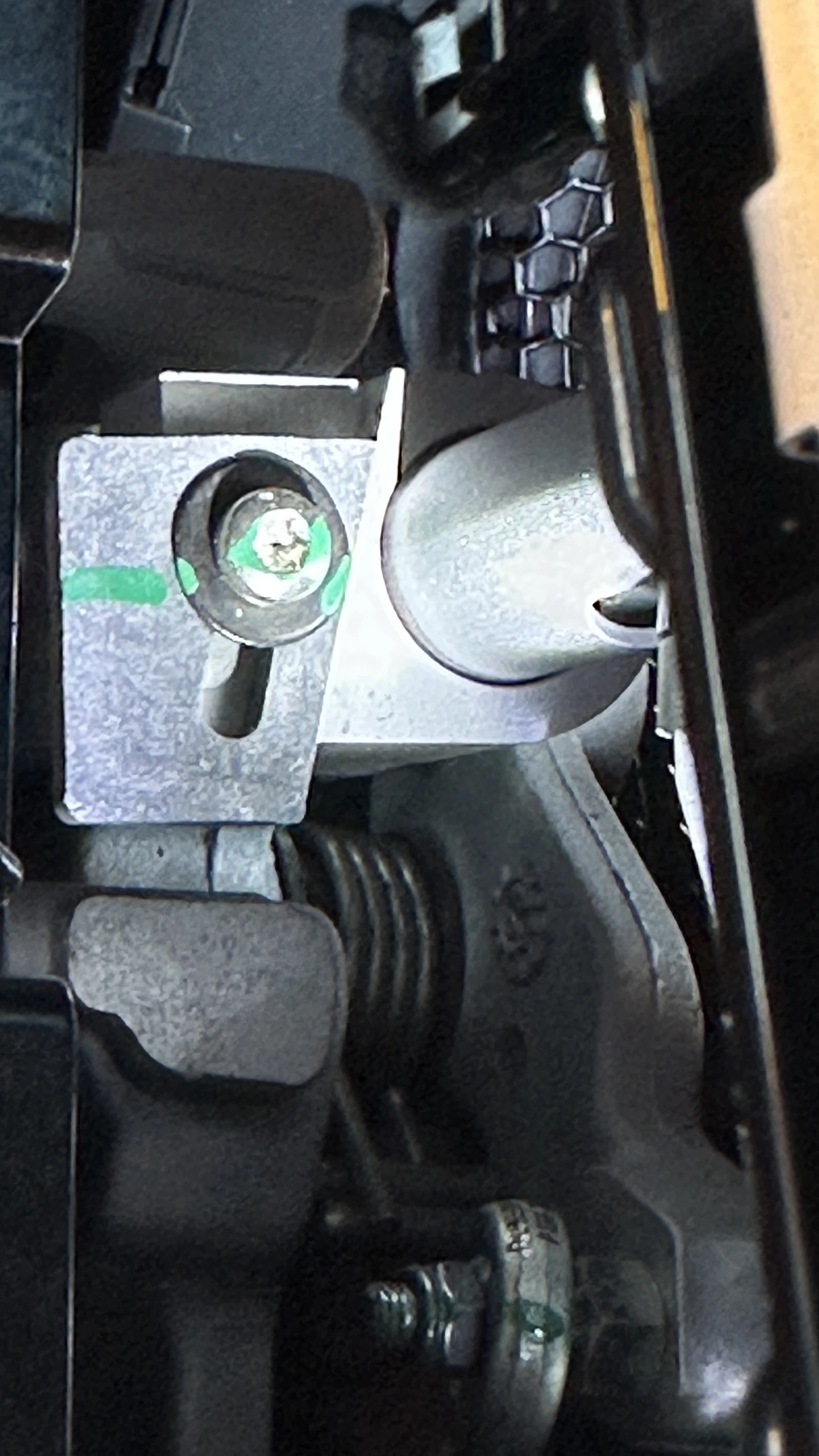

Obviously this factory-set plate position varies by car, and Lotus factory tech, and how rushed they were, but here's where mine was set from the factory:
Pretty much as far back as it could go!

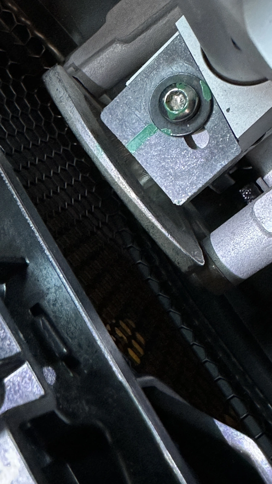

And here's where I've set it now using the super-helpful Lotus technical manual page instructions @Eagle7 inserted early on to the thread. As per the manual, this position when in first gear "shoves the stick slightly to the right":
The angles are different in these shots but you can see the mark of the washer in the second shot how I moved the plate forward 2-3mm.

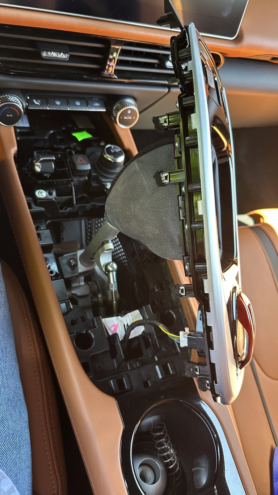

I did not need to clip the ziptie for the surround, or even unplug the starter button. Just pulled out the bit of extra wire stuffed down in the hole, and make sure you pull the console up all the way so the shift boot exposes the zip tie. No need to cut it, it just gives you plenty of room to work:
