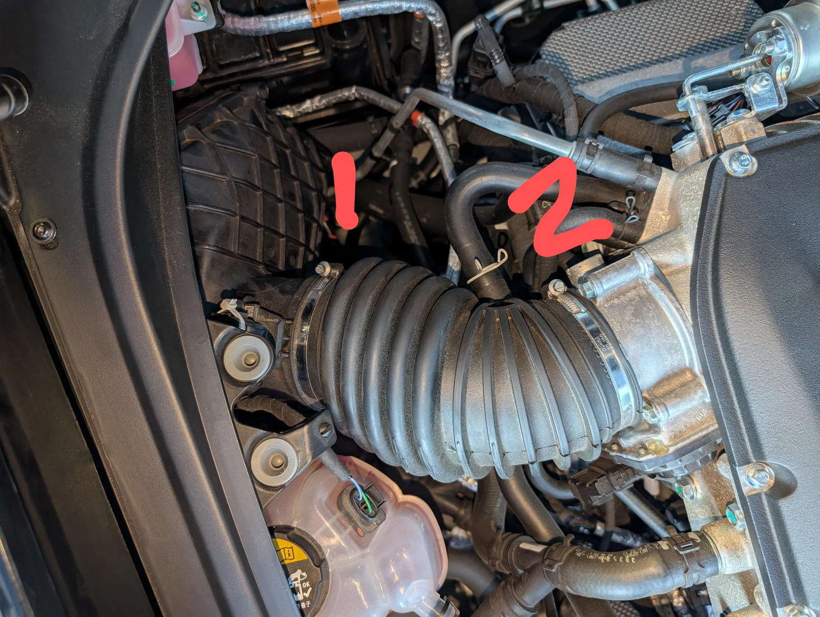

1) Undo the hose connecting the intake to the supercharger inlet by loosening hose clamps 1 and 2. Make sure if you loosen them ALL the way that they cannot drop down into the engine bay.

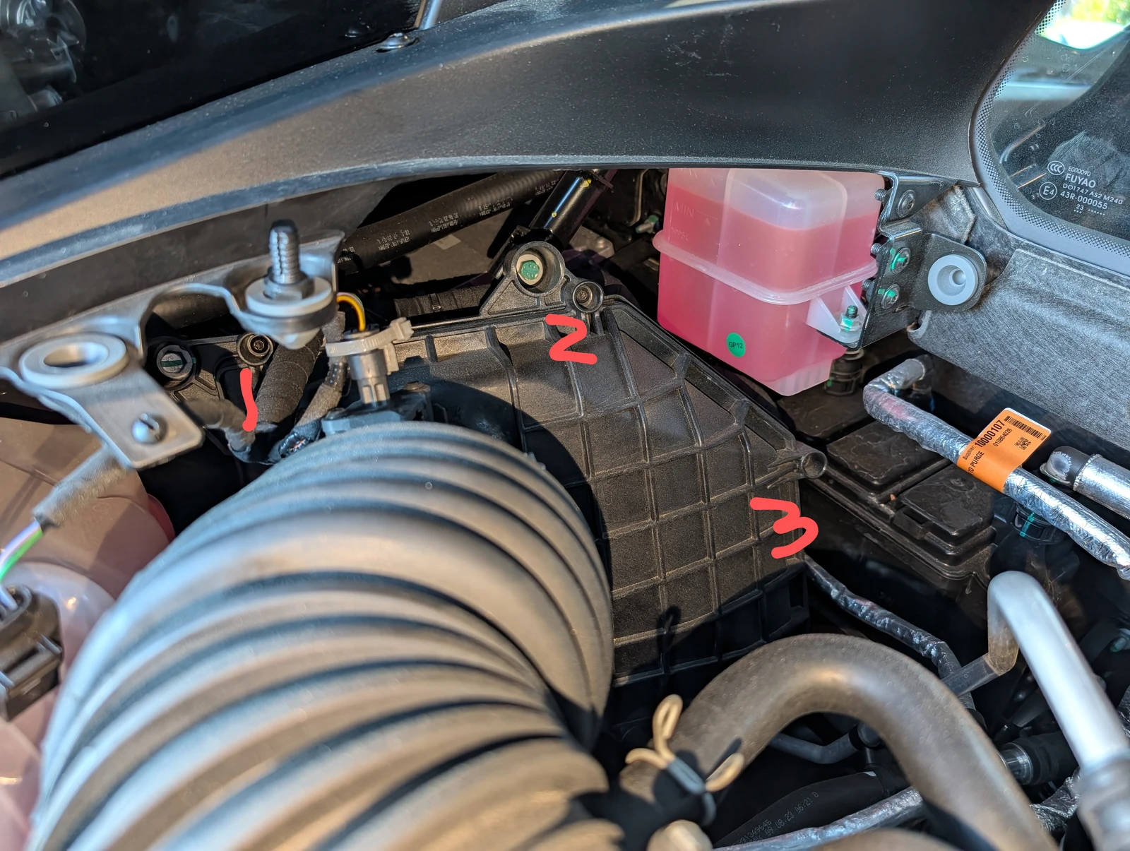

2) Undo 3 torx TR20 screws that fix the intake clam. Be VERY CAREFUL not to drop these torx screws in the bay. I had to use various sorts of extensions to reach them and used a strong magnetic extension to pull them out.

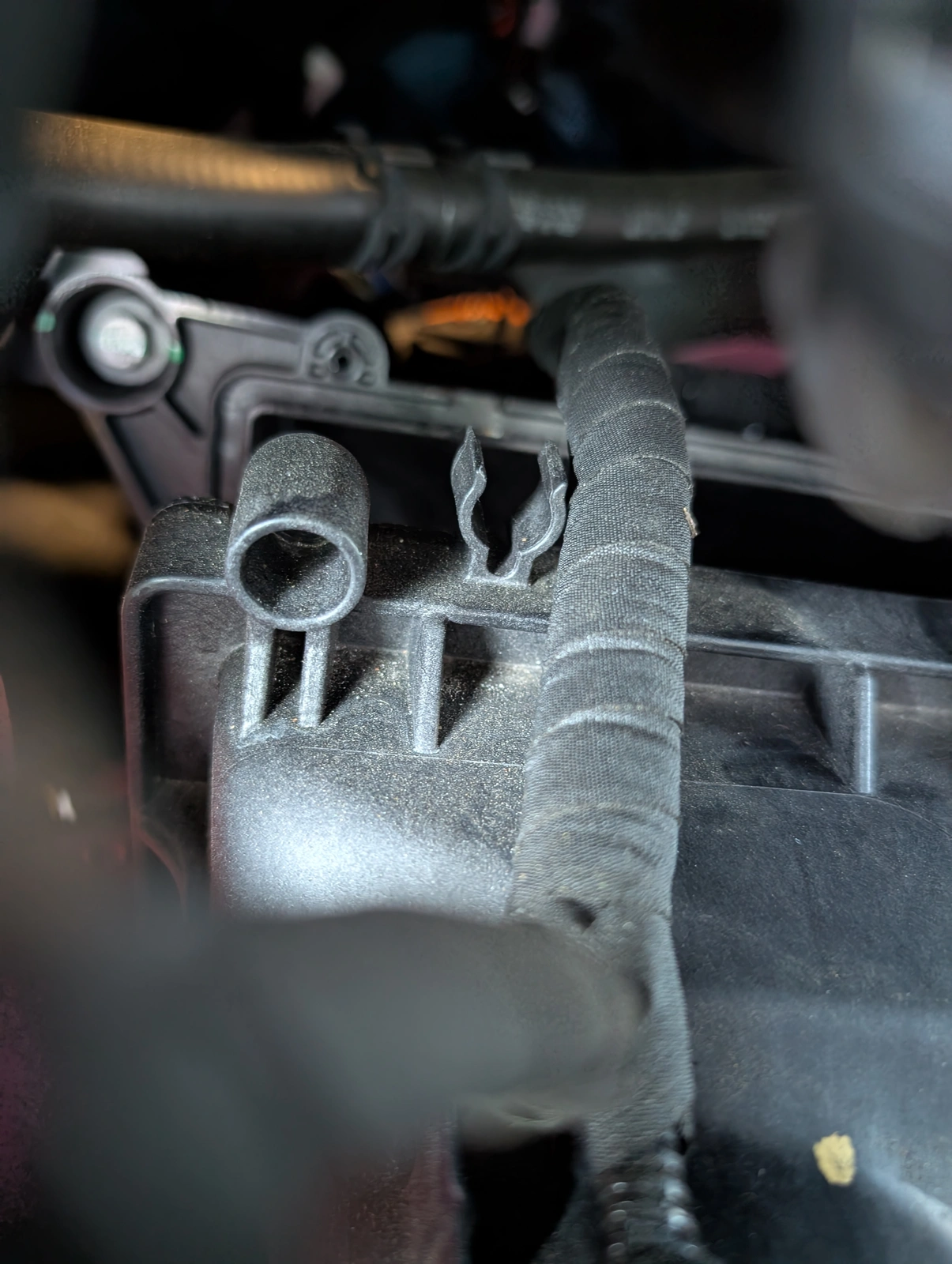

3) Start hinging open the clam. I found this very difficult because there is a wiring loom attached to the top of the clam. Pop the wiring loom out of the little slot on the clam.

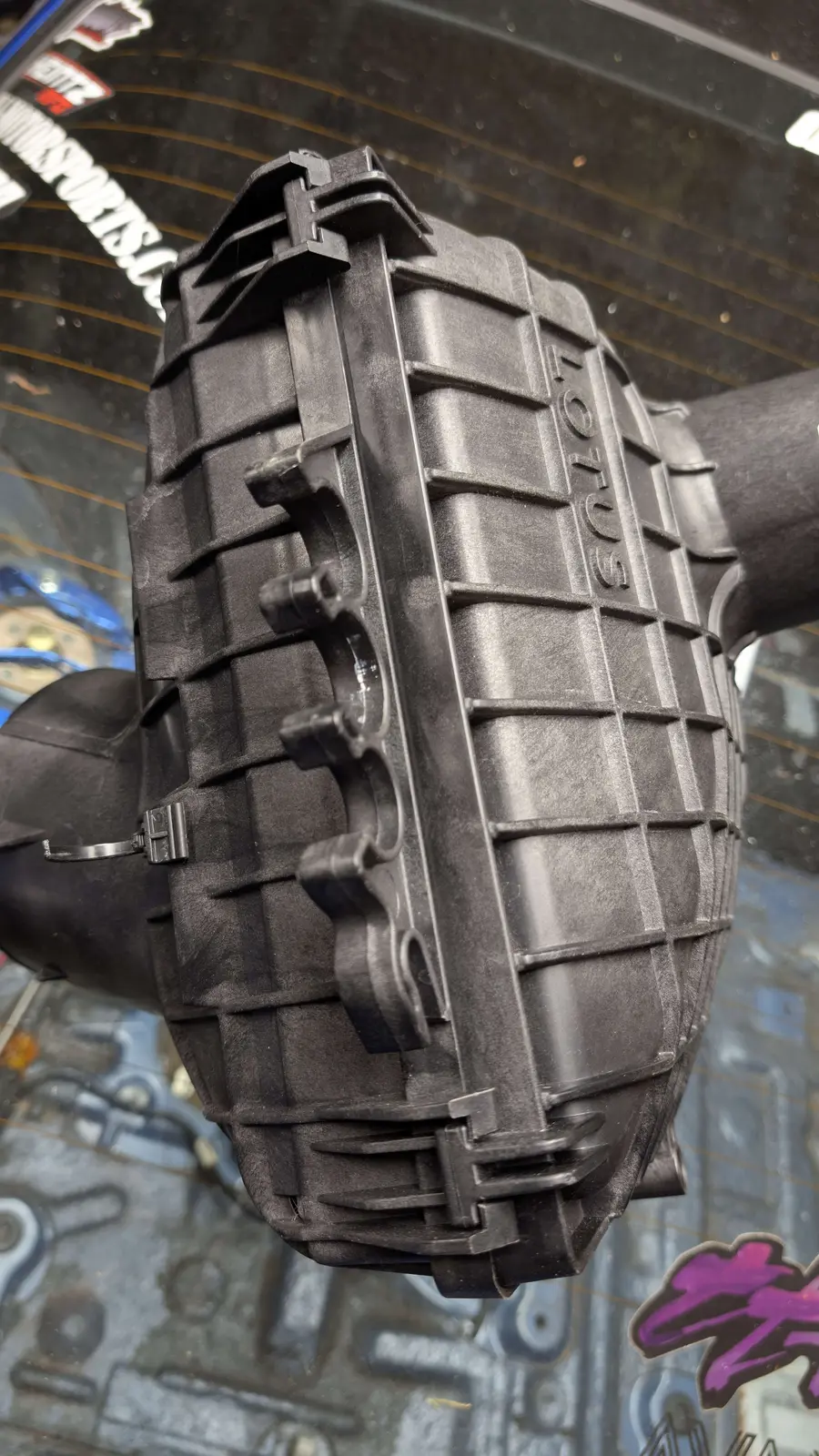

Oh yeah, to be clear I didn't remove the intake either. Just need to pry the clam open large enough. But doing that will probably split the bottom of the hinge which is the pain.
Picture is just to be able to visualize what the bottom of the hinge looks like.
