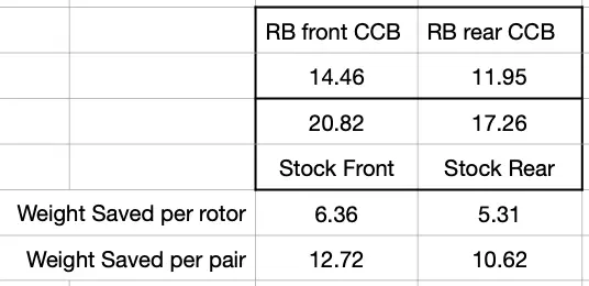

I may have missed this, but how much lighter are these rotors over stock?
In total for all 4 wheels they're 23.34 lbs lighter. Here are the individual weights.
