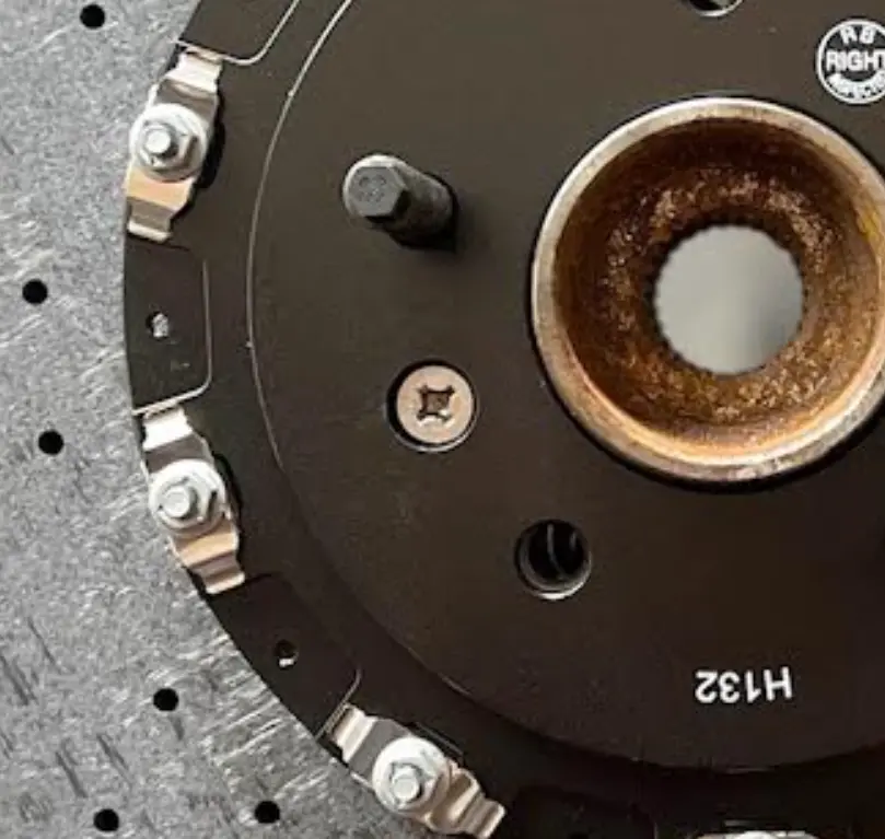

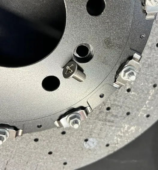

This retaining screw hole position requires a very minor correction - Need to enlarge the screw hole ~1mm (Inward).
Pics below showing after correction and installation to the hub.
From this shipment on the hats will be corrected.
4 ea M8x1.25 Stainless steel screws are to be included in the shipment.

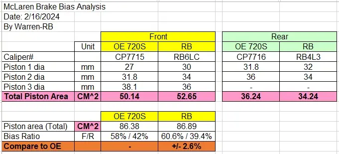

See how McLaren's 720/600LT brake bias was thoroughly analyzed when RB-CCB system kit was developed.

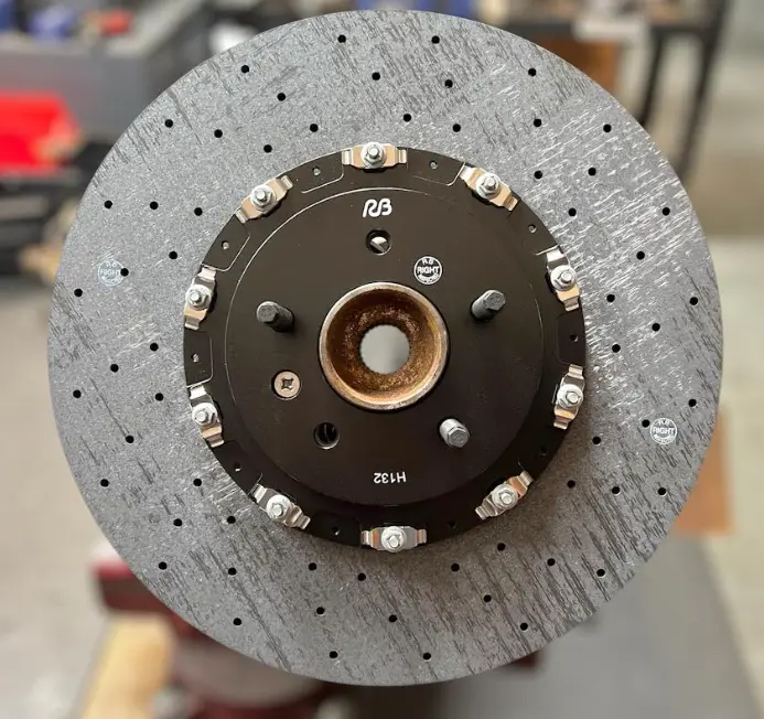

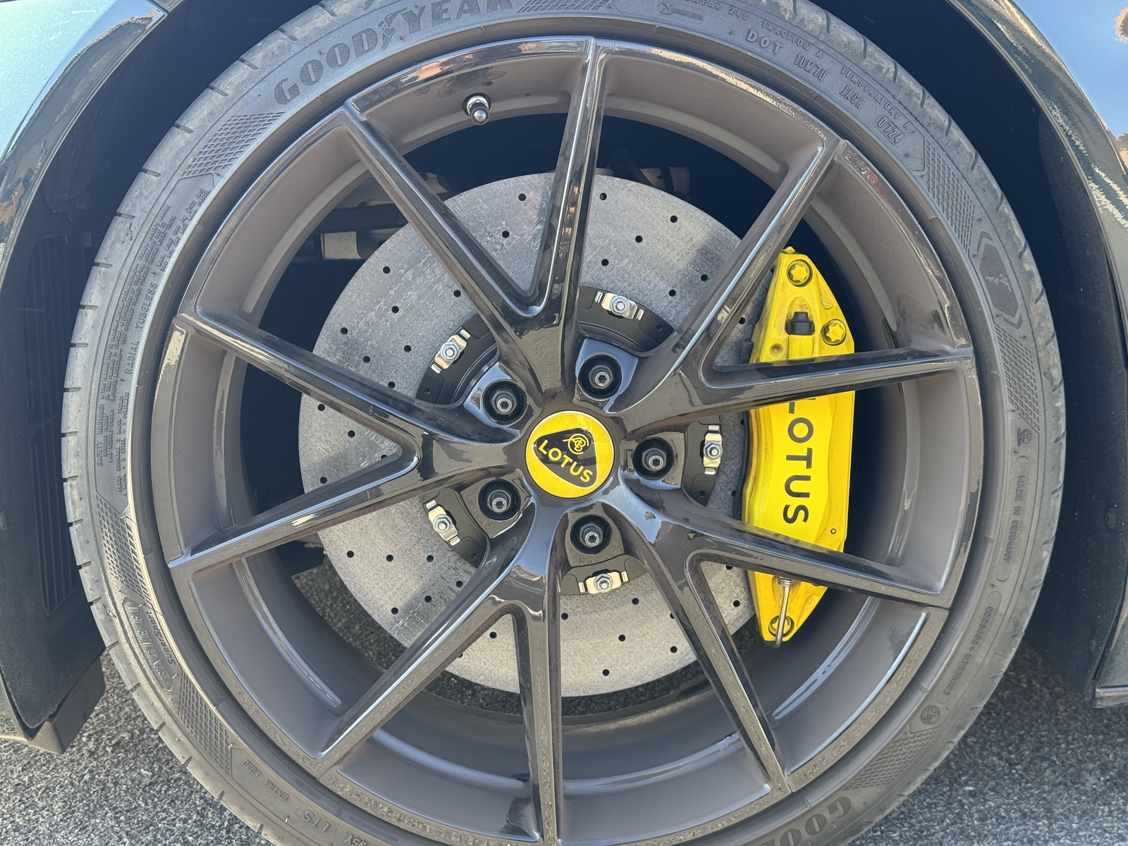

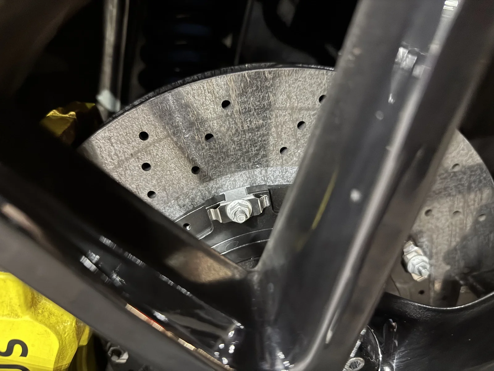

I'm still working on the bedding process but here it is doing half of it
Ignore the brake dust visible in the photos - that was from the OEM rotors, which I didn't clean before the installation.
I don't think it's fair to compare these to OEM brakes because these are clearly superior. With this upgrade, you're essentially running track-quality pads (but without the noise) versus the OEM street pads. As others have mentioned, the brake pedal feels more linear compared to the OEM setup, and the braking performance continues to improve as I progress through the bedding process.
The car feels noticeably more nimble, comparable to installing lighter rims or reducing overall weight. One significant advantage over steel rotors is consistency - steel rotors can warp over time, creating inconsistent brake feel, which isn't an issue with these.
Of course, for most people, it's difficult to justify the $10,000 cost. A more economical alternative would be purchasing lighter rims/rotors. (Personally, for dedicated track cars, I think it's better to use race pads and simply replace steel rotors as they wear out - these upgraded brakes are better suited for street use and occasional track days).
I won't be able to fully evaluate the difference in brake bias until I take the car to the canyons next weekend.

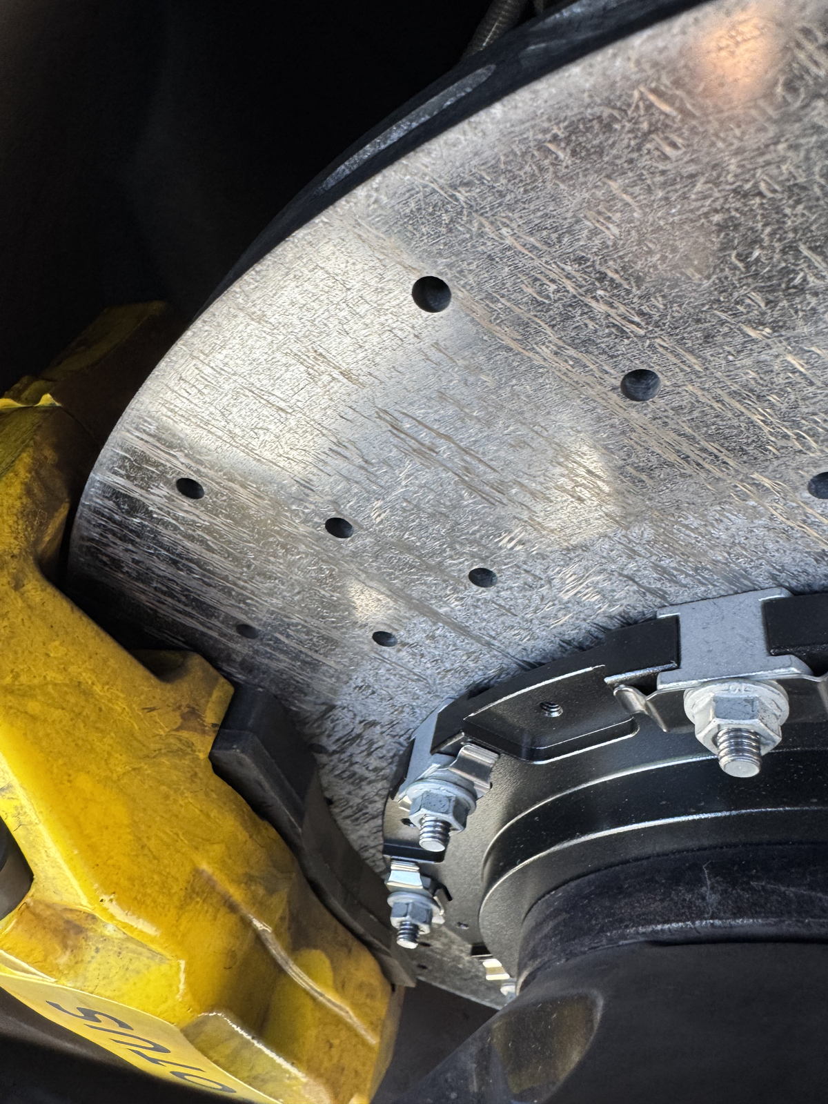

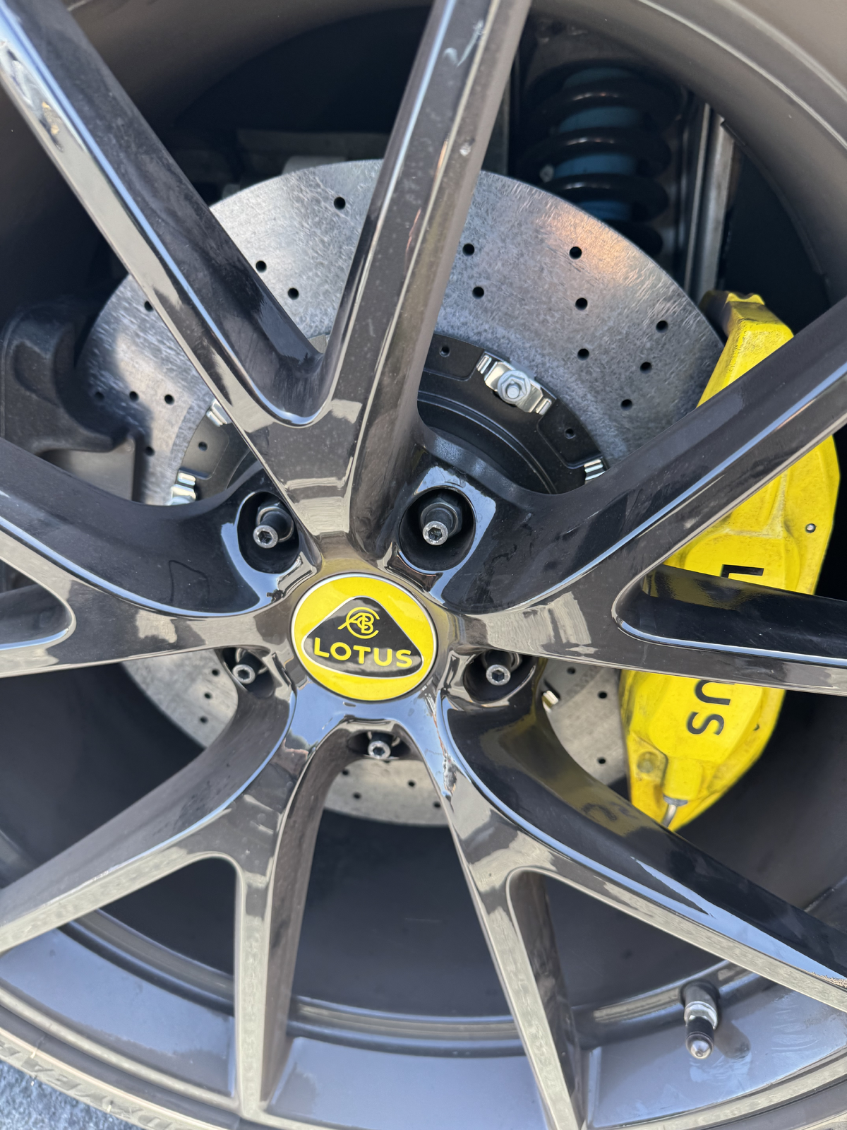

3,500-mile update after install & bedding
  • Usage: ~3,500 miles over the past 2 months. Mostly daily driving/errands with some spirited runs.
  • Braking performance: With near-full pedal (close to 100%), the car stops so hard (only on full stop) that the hazards kick on automatically. When that happens you need to remember to press the hazard button. Around town I stick to ~20–40% pedal for smoother stops.
  • Noise: Intermittent, depending on rotor temperature or any debris. I only hear it under ~10 mph braking, and with windows up it’s faint. It usually clears after a few hard stops from highway speeds or a wash. I don’t bother trying to fix the noise every time anymore—it’s minor enough to ignore.
  • Dust: Extremely minimal. What little there is doesn’t leave that rusty matte film you see with iron rotors just from braking aggressively once. Wheels just need a quick wipe once a week or so depending on driving style. If you’re easy on the brakes or rarely drive, you’ll barely notice any dust maybe for months and likely no noise.
  • Cleaning: Avoid high-pH wheel cleaners on the rotors. I only use mild soap and water. Wheels wipe clean easily; no harsh wheel acids or iron removers on the discs. (I still need to go back and clean my calipers from when I was on steel rotors.)
Overall: Very happy with the setup for street use—even on track pads. Strong initial bite, predictable performance, with the expected bit of low-speed noise.
here is an example of something on the rotor that you can clear up by cleaning or driving (bedding) also notice the rotors are a lot more reflective after bedding process.
