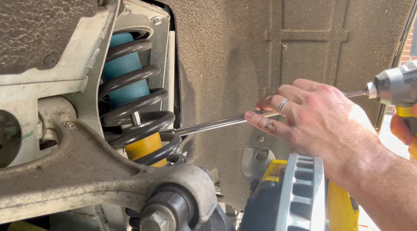

I just posted the video. I figured I would throw it in here for you and for anyone else that searches this in the future. I hope it helps!

yes and also also also please use an allen key to keep the sway link while you unbolt the nut. its there for you....

They usually either have the allen recess or there's a thin hex flange. You can use wrench or ratcheting wrench on the bolt or they make hollow ratchets that are perfect for that job. The hollow ratchets are also great for replacing struts.
