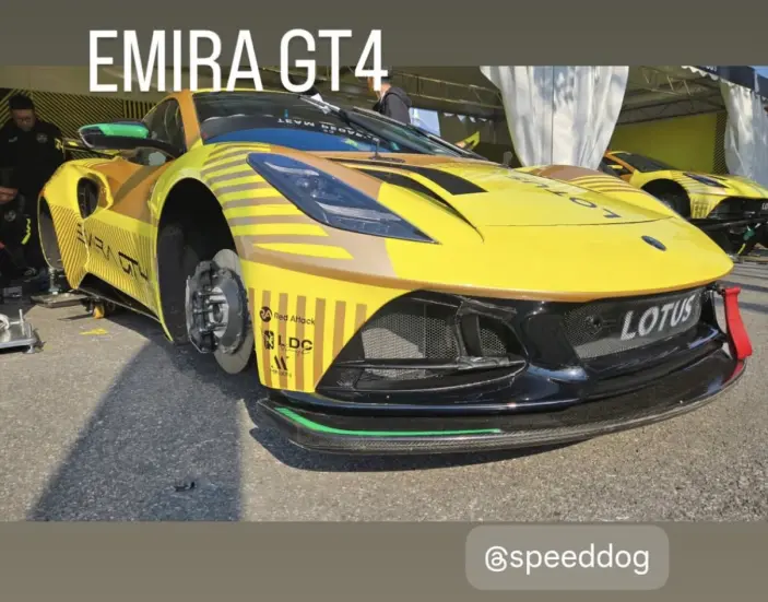

Looks like the GT4 racing teams are using steel rotors:
If you plan on tracking the car regularly, i would not go the ceramic route (unless cost doesn’t matter). My previous car was a 720s which i tracked regularly and most of the other owners i knew that did the same went steel to save on costs. Replacing ceramics every season or two isn’t fun.
Realistically ceramics are only worth it on these cars if you are doing 1-2 light track days / year.
