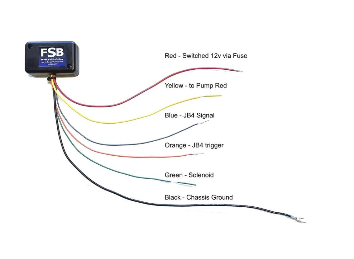

The strategy was to use the JB4 WMI controller as the brains as this plugs directly into the main JB4 module. The benefit here is that now the app on my phone can control the methanol system and besides having it fully integrated into the JB4, I can also select which maps the methanol sprays in or I can turn it completely off and run a stock map. This is super nice as now I can just do a long road trip and not worry about bringing extra methanol with me, I can just turn the system off. In reality you can always grab windshield wiper fluid at a gas station and use that, but it's nice to be able to run the car 100% stock with map 0 on the JB4.

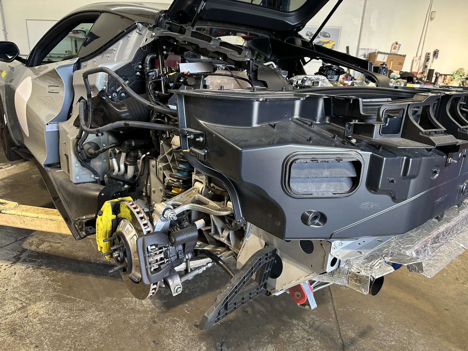

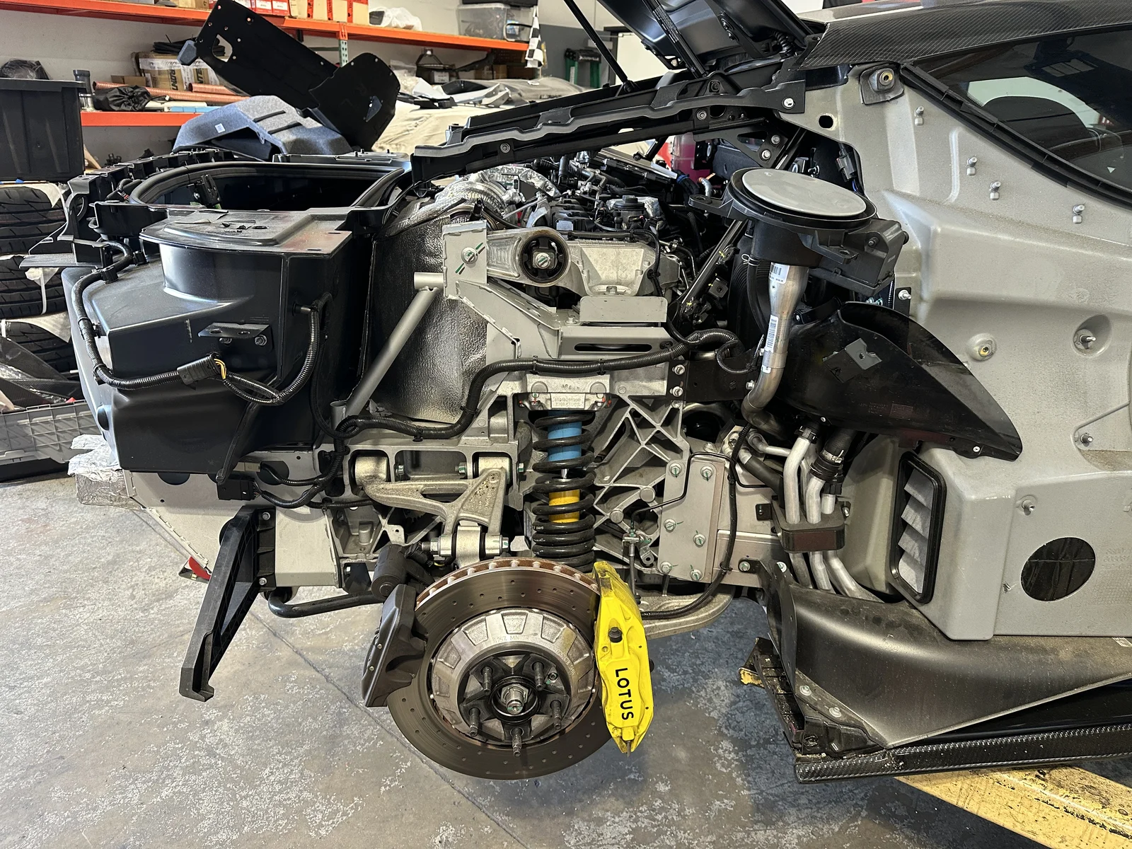

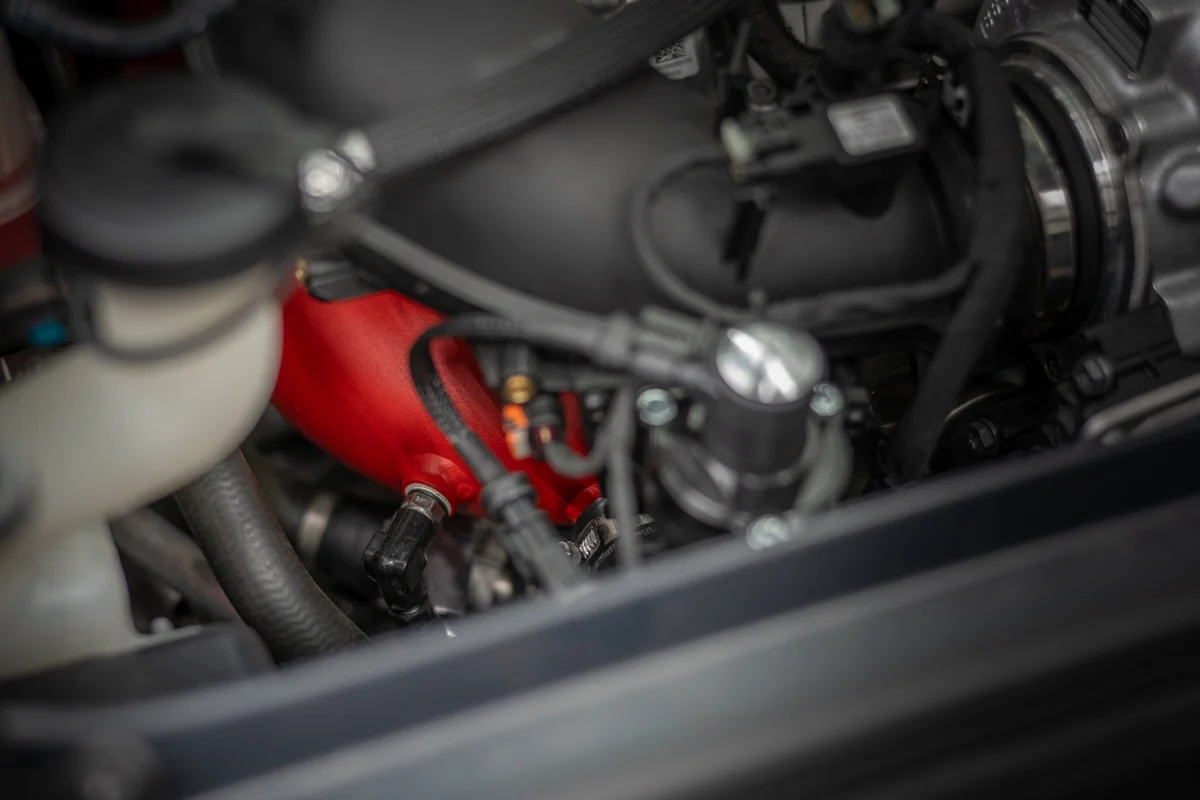

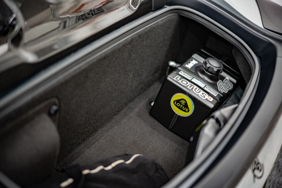

DRS in La Habra did the installation (as they also took care of my Elise and 4C) and as always did an amazing job. The goal is always for the system to be as invisible as possible. Besides the in progress photos there are only two things you can see. The tank which sits in the right corner of the trunk and the single injection nozzle. Everything else is not visible since it's all underneath the bodywork and out view, all done with easy to service connections. The methanol tank is a 2.5 gallon Snow Performance tank, Burger Motorsports also makes a really nice one too. The floor of the trunk is refinforced and the tank is securely bolted down, with the lines and wires going through the trunk wall to underneath the body panels.

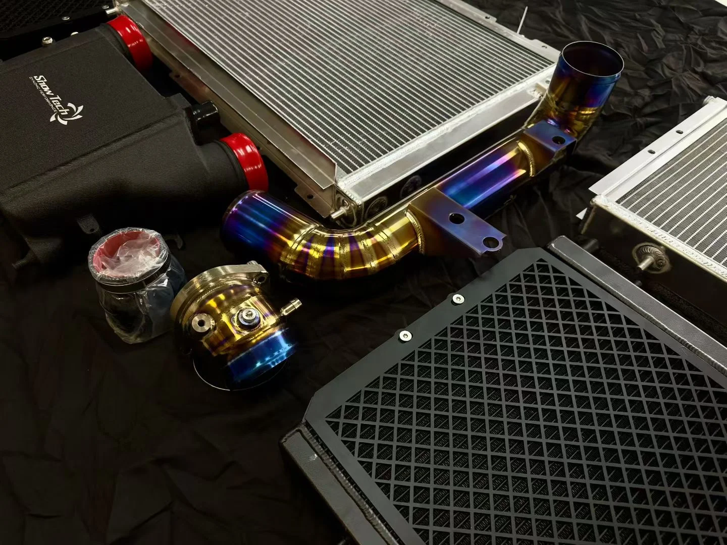

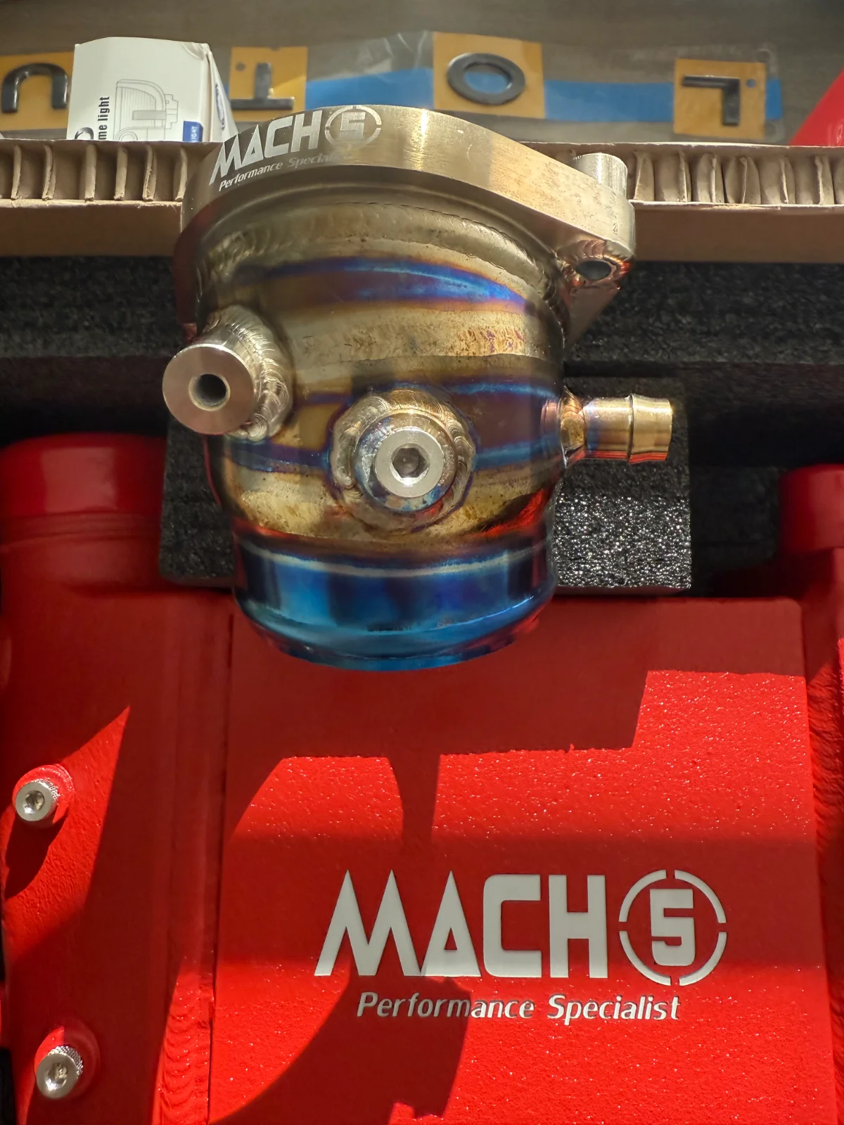

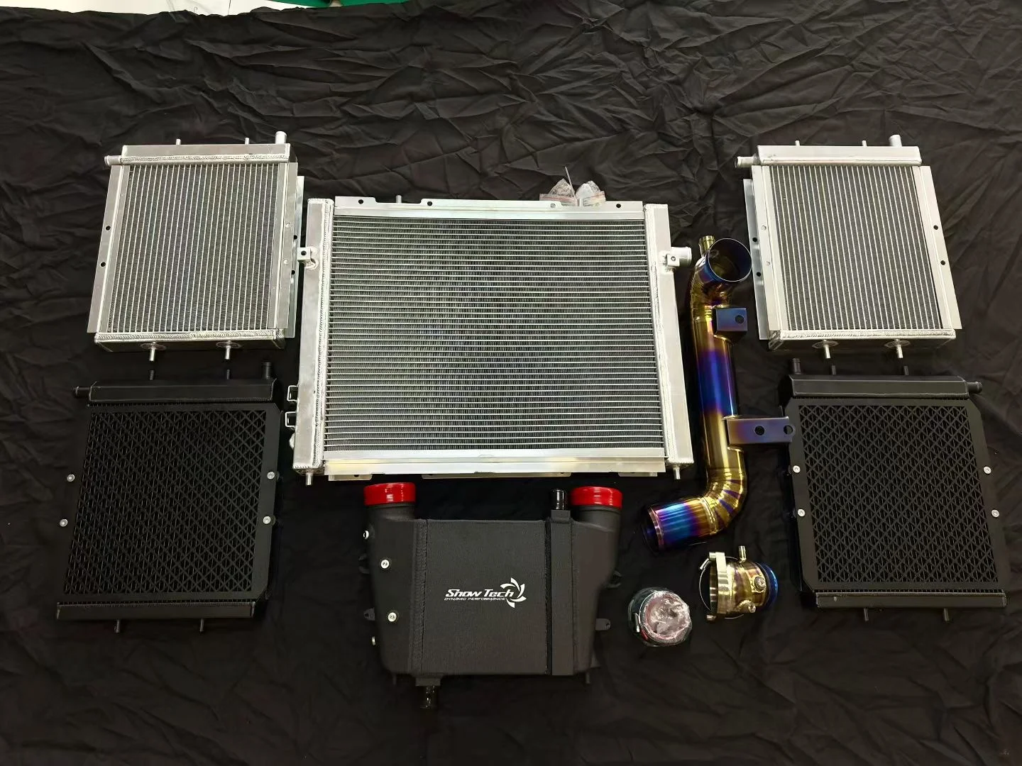

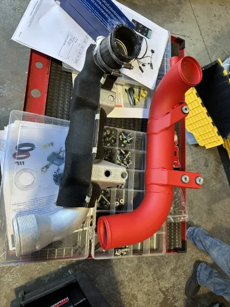

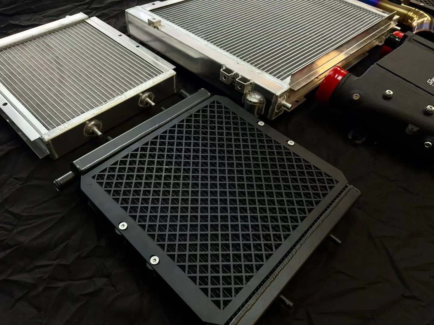

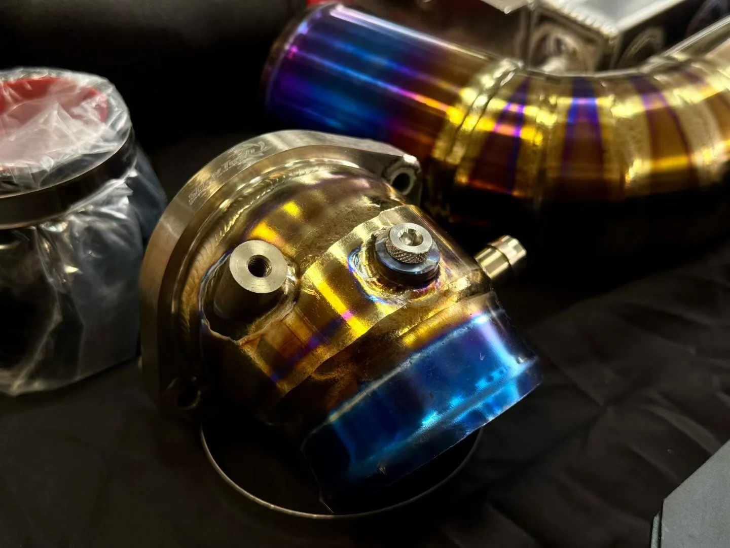

That note about cleaning the engine head, on this particular application there isn't a lot of room on the cool side of our air2water intercooler to place the nozzle which is where it usually would go. You can get some aftermarket pieces from Boomgear and the like that replaces the plastic stock parts with titanium, but I didn't want to wait. I am using a Weistec charge pipe that is bigger in diameter - so hot air is coming out of the turbocharger, gets immediately cooled by the methanol spray, this atomized spray now goes through the intercooler and then into the engine. When I called Weistec about the bung location they simply said there is no room on the other side of the intercooler and that this application will still work great.
Note: the Weistec charge pipe alone gave me overboost codes on the stock map, these resolved later after tuning with methanol.

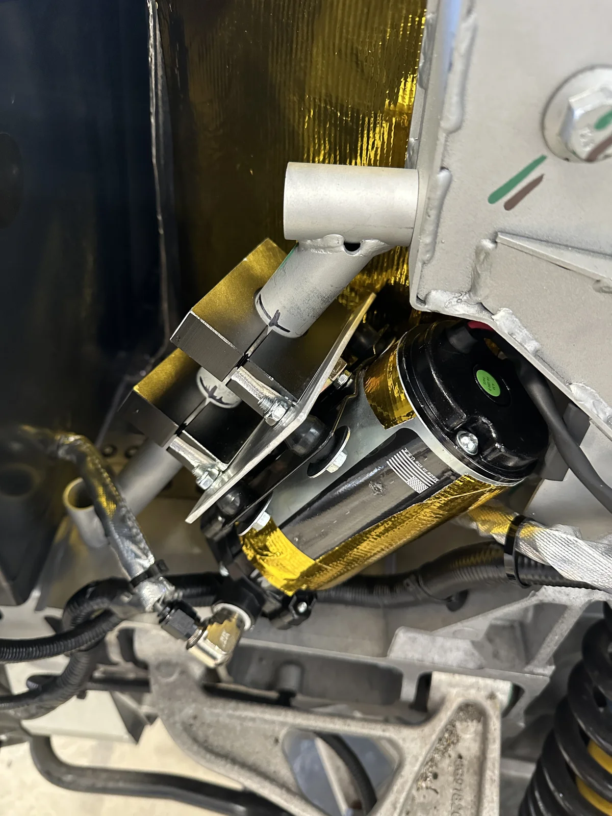

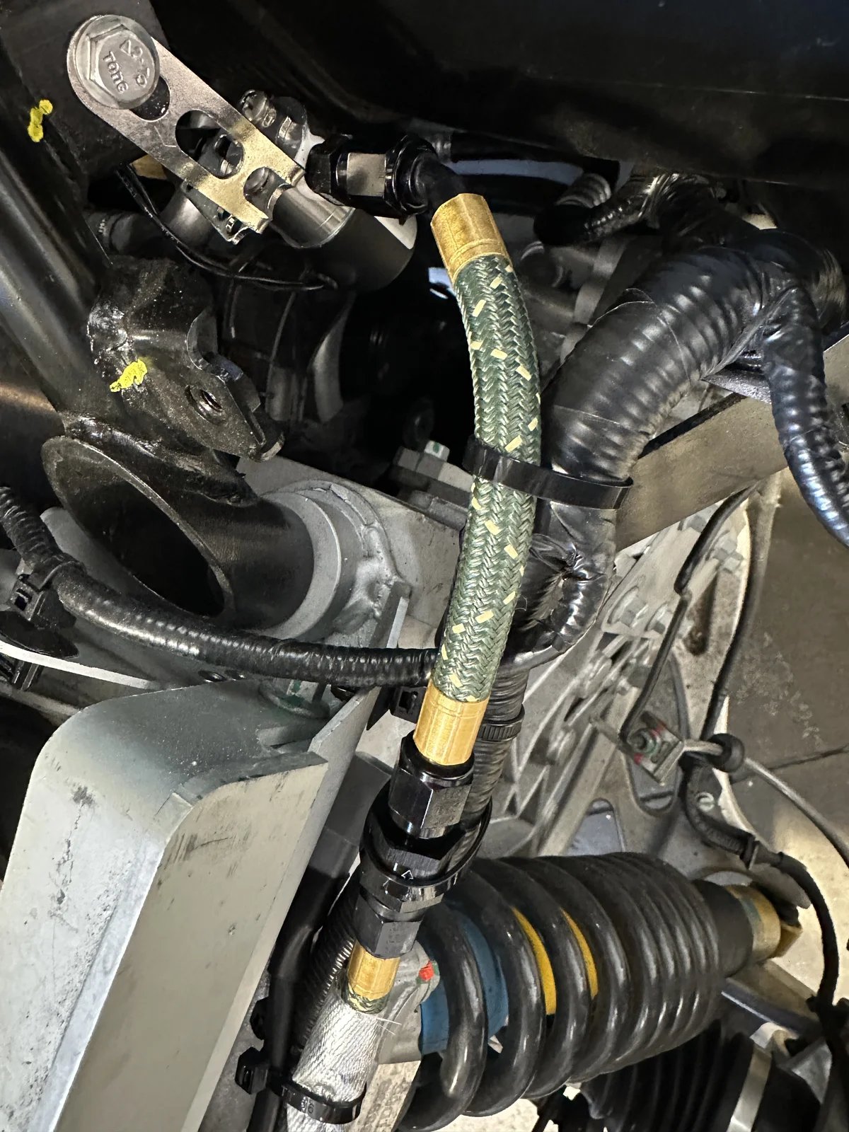

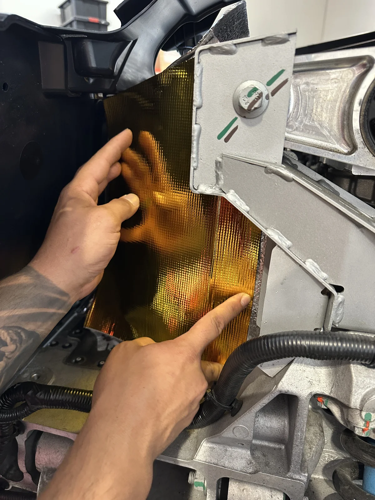

The pump is installed near the passenger side rear suspension with everything heat shielded and the lines protected.
