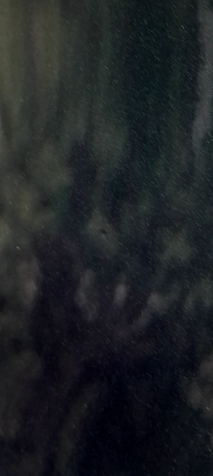

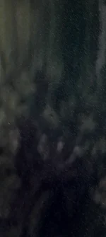

Brand new door (less than a month old) replacement, blistering again???
Microscopic but looks like it’s come back within a month or being replaced….

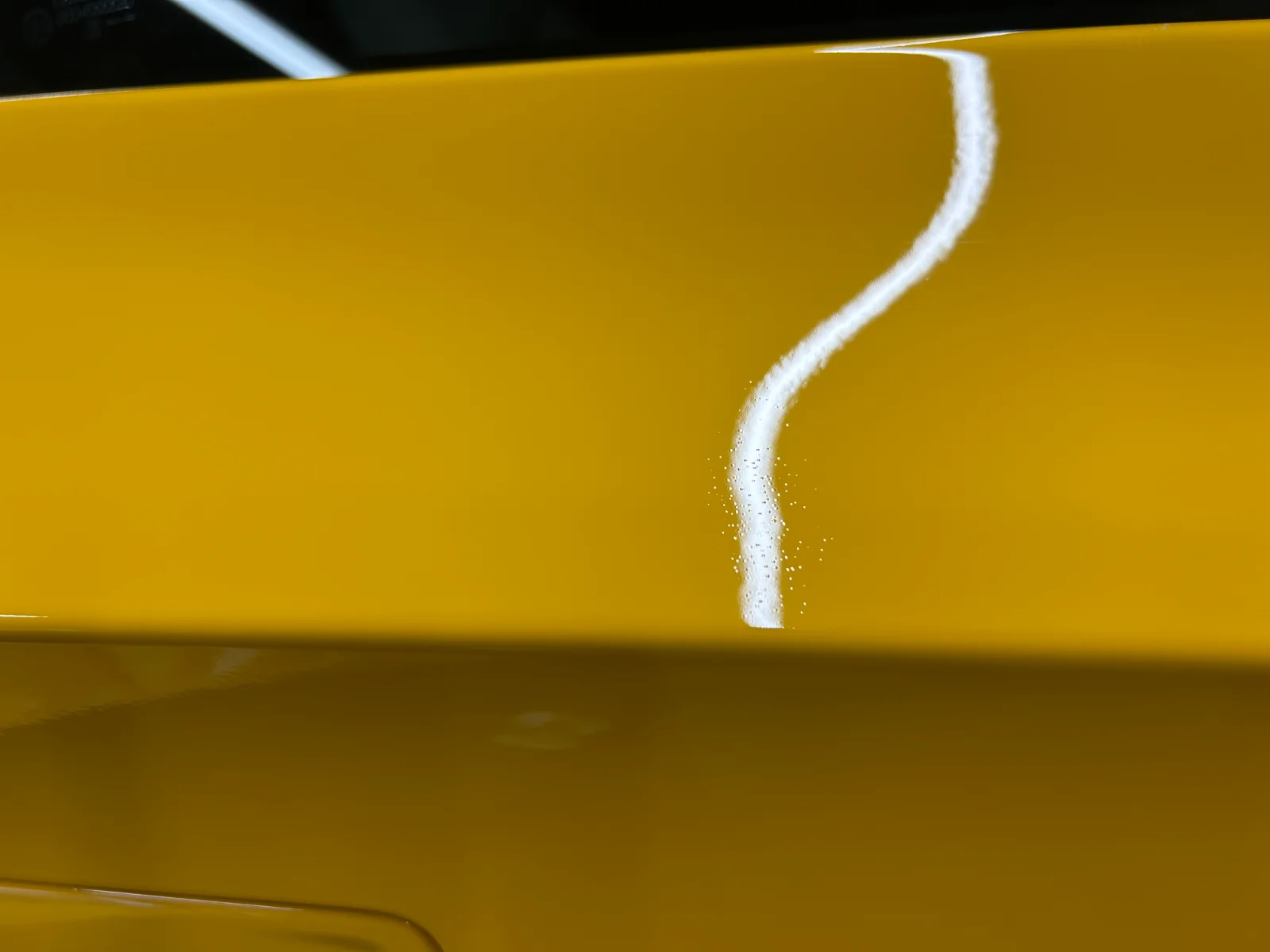

Noticed this today on the door they already replaced before sale.
I've still got nearly 3 years warranty left so I'm going to let them know but not book it in for repairs, doesn't seem worth it right now.
