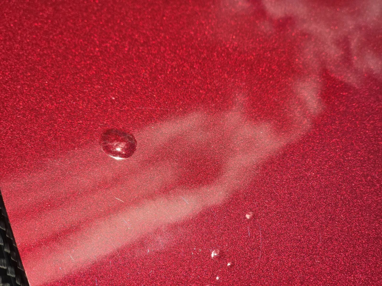

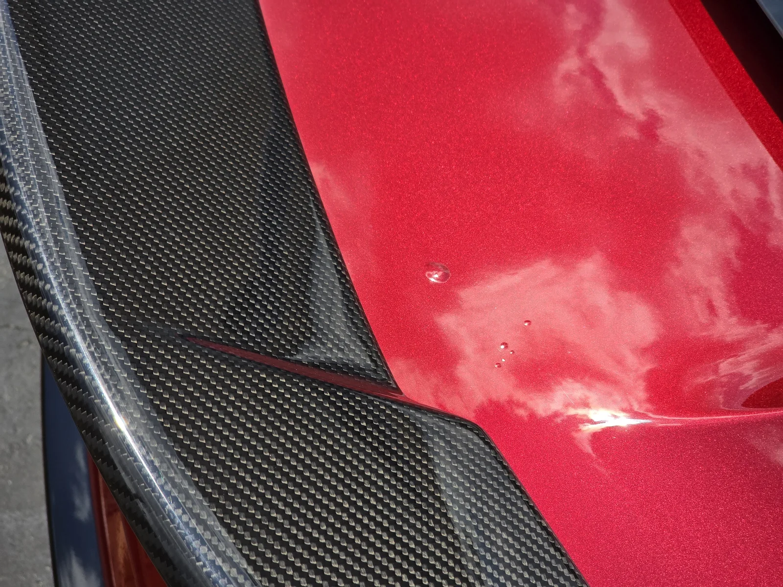

Here's the blistering on my trunk lid. V6 FE part of first wave of US Deliveries. They have since receded and are flush but you can still see where they are if you look closely. I dont have pics of that yet.

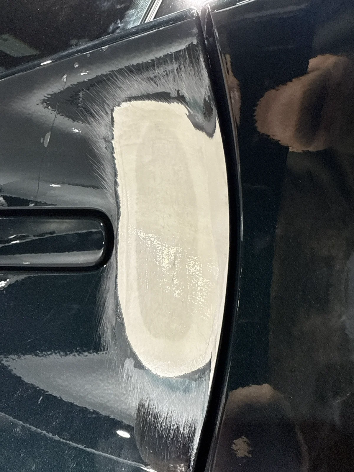

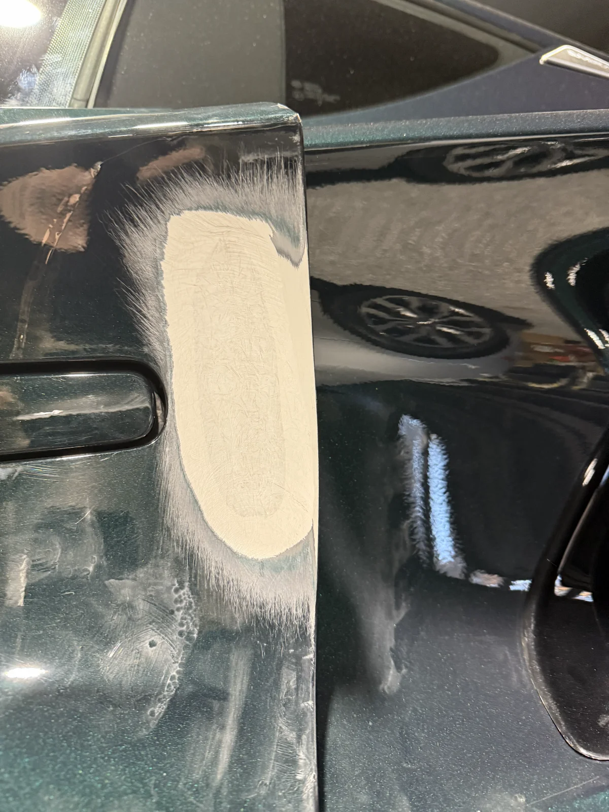

Here's an update

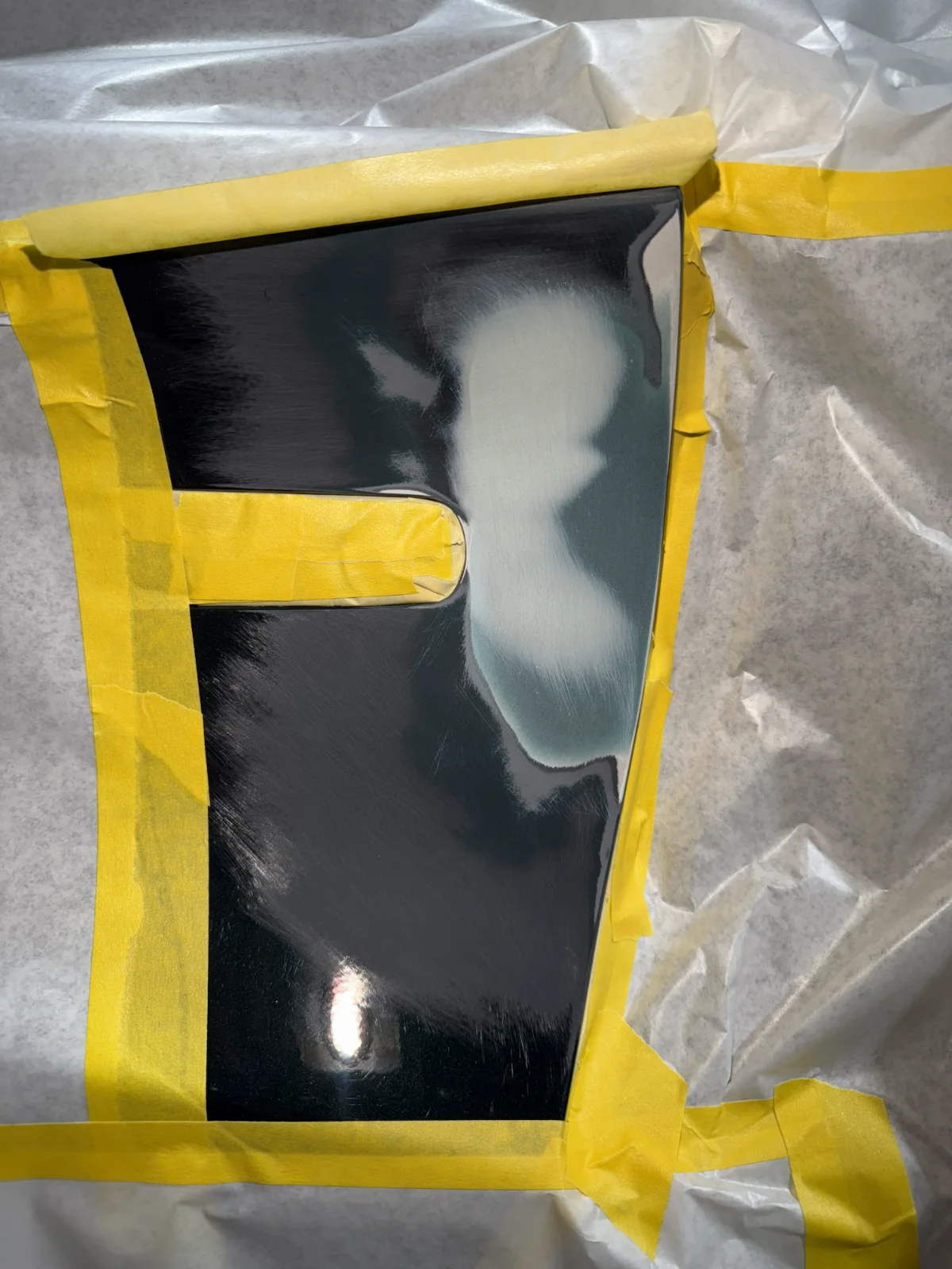

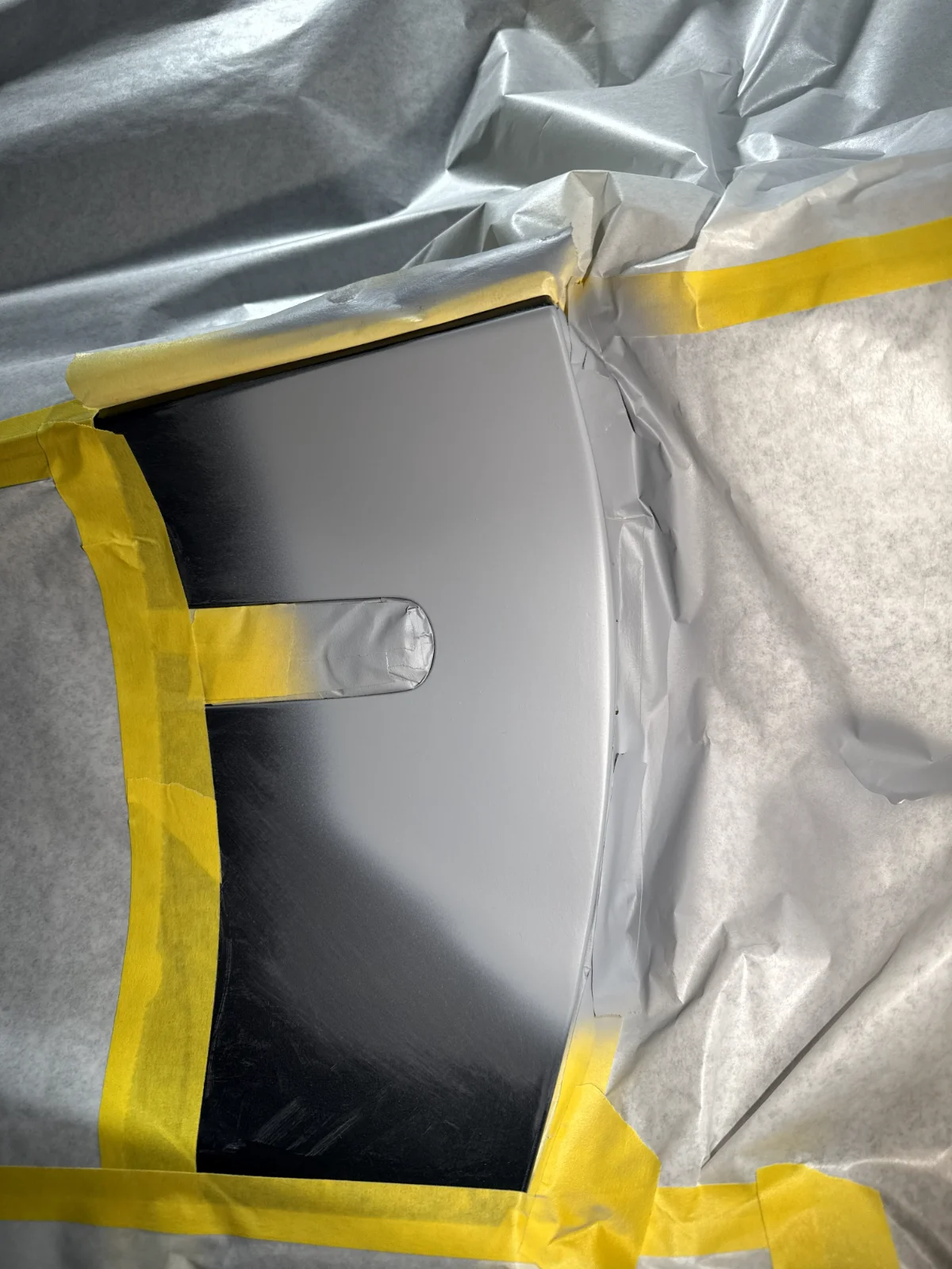

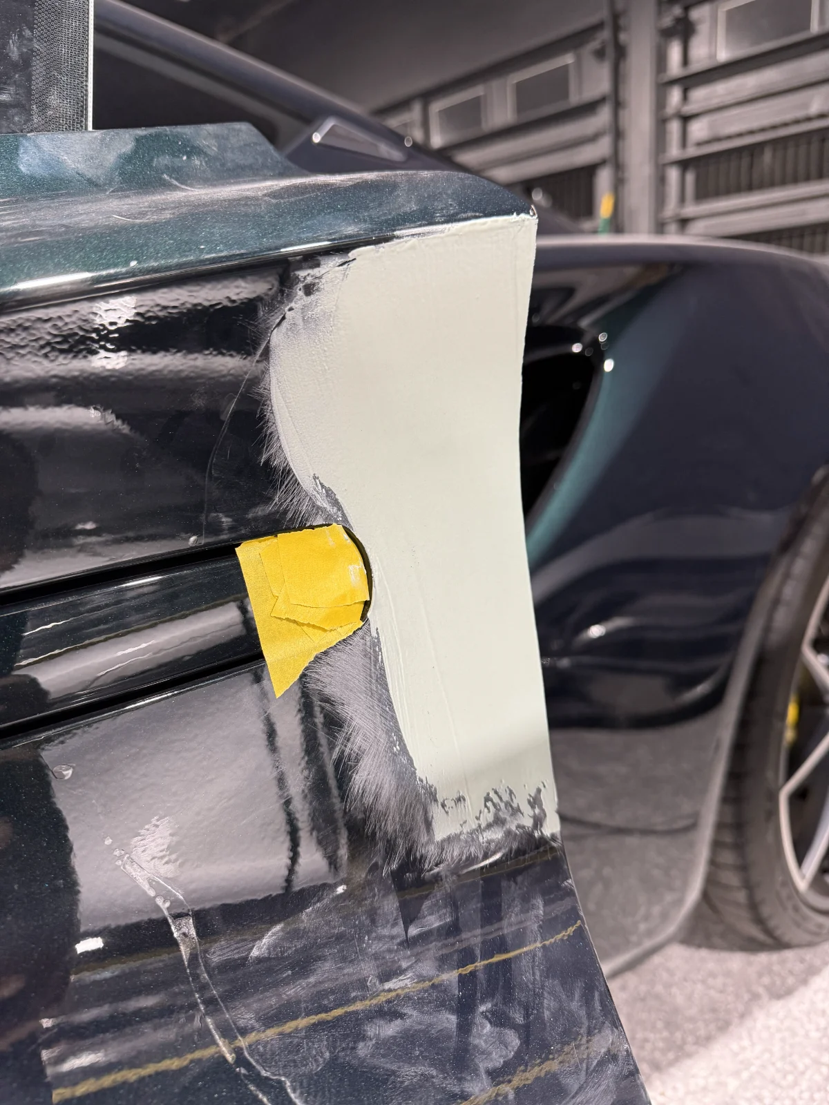

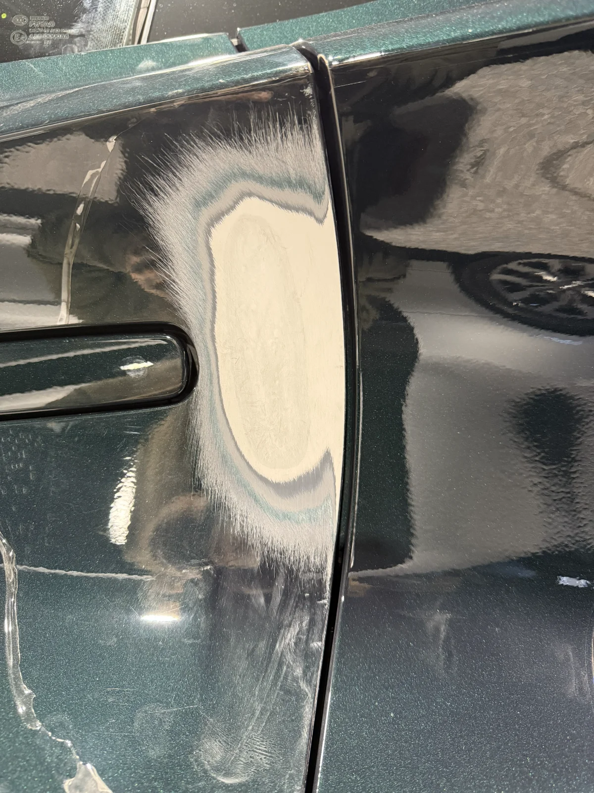

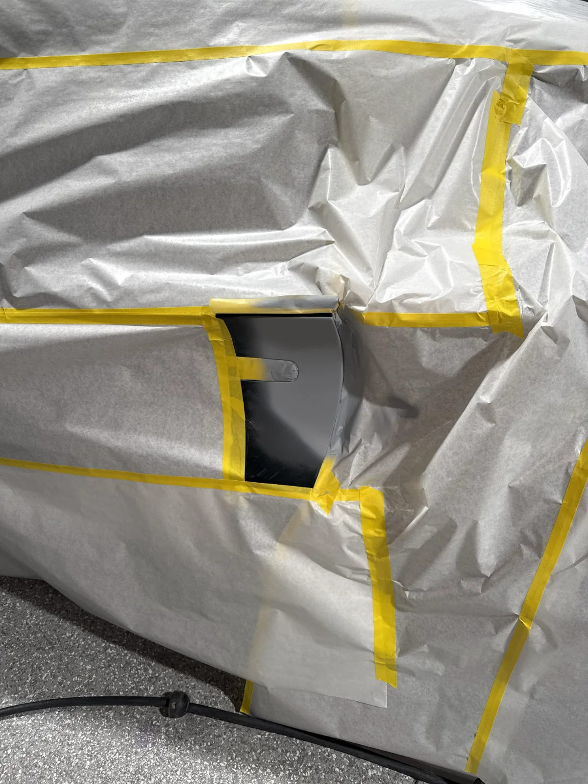

Here's an update --After approved quotes for paint and PPF replacement, Lotus sent me a new door and I scheduled with a quite reputable shop close to home. The shop investigated the blistering and found that the it was caused by a previous repair (the dark spot in the photos) -- after some testing on the area, shop quantified they could easily repair the area vs replacing the entire door......as of yesterday, the repairs are complete and cured -- paint should happen later this week.....PPF about a month or so later. Assuming all goes as planned, it appears I'll have an unopened Lotus OEM door sitting around.
I don't believe this is a paint/repair issue, It's a laminating panel issue related to moisture during manufacturing. It's possible that the issue reoccurs - the new door is a remanufactured panel.
I would hold onto the new door they sent you incase this reoccurs.
I wouldn’t pet that spare door go anywhere…….
maybe
My repair guy specializes in exotic cars -- he said the door clearly had a prior repair, which was not done correctly --- noted by the dark color in the earlier photos. He mentioned it appeared the repair area wasn't primed and cured properly. He went on to add thin layers of epoxy material, let cure, and check for reaction -- grind down, repeat. This process lasted 2 weeks --- he's now got it fully repaired, cured, sanded, and ready to prime / paint. As for the replacement door -- yeah, I'll surely hang onto it for a while, it's not a big deal to do so.
Do you believe this is the reason that all other Lotus panels are blistering as well? That all the panels with this issue are from a manufacturing repair?
