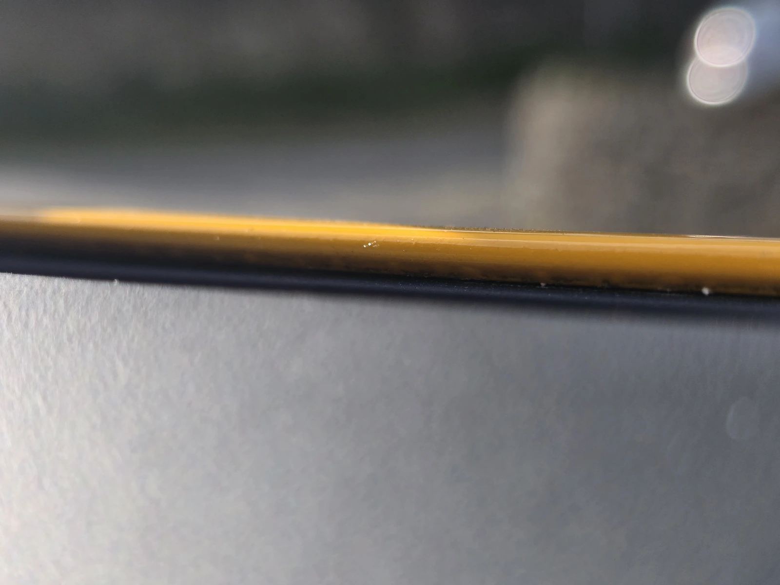

Mines currently in to have new doors, tailgate and a rear quarter replaced. For anyone worried I would just check every inch of the paint. My drivers door bubbled on the inside lip and was only visible if the windows were down. Outside looked completely fine.
I wouldn't be overly concerned about that. those bubbles are unlikely to migrate around the lip, and its probably just poor paint prep in that area. which..makes some sense.
True, mainly just because the warranty is coming to an end I was being a bit picky. Other panels were a lot worse off so the car was going in anyway
After having my doors replaced I had increased wind noise at high speed, a scratch across the leather on the door card and a new rattle from the door when playing music with the window not fully closed.
For an almost invisible paint bubble I would leave it well alone.
