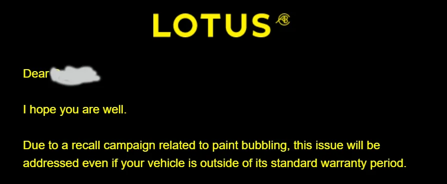

As the original poster on this issue my concern was about Lotus's position on paint blistering after the car's warranty period has ended. I have been in touch with their (European) customer services in the last couple of weeks to see what their position is.
Initial conversations were promising, and the customer advisor said that:
"Due to a recall campaign related to paint bubbling, this issue will be addressed even if your vehicle is outside of its standard warranty period"

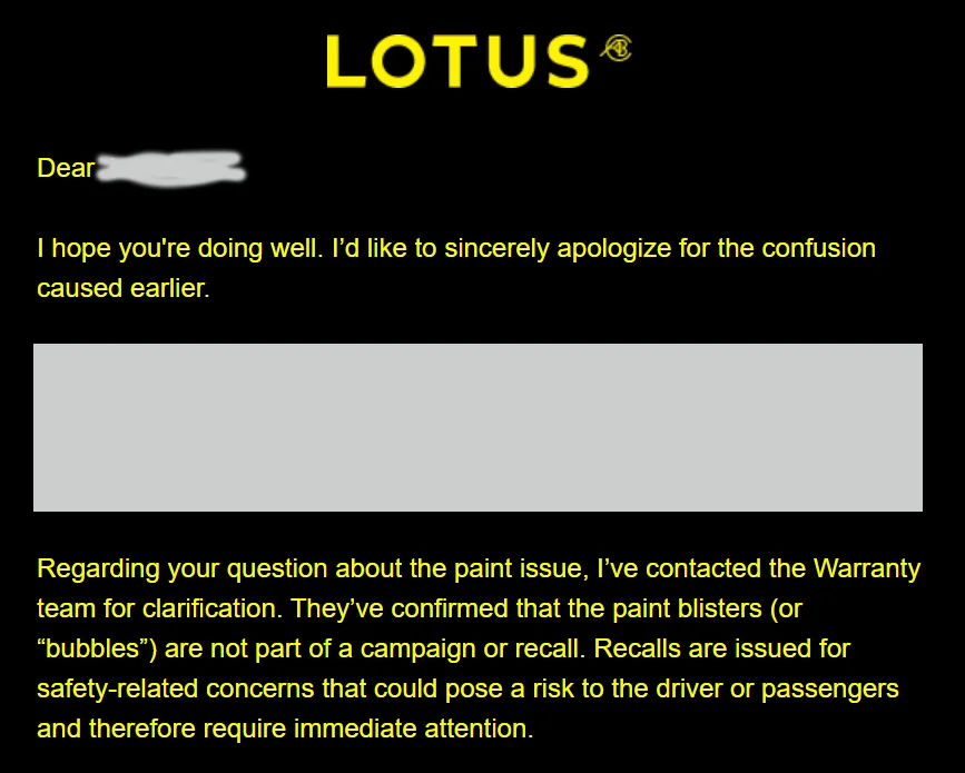

However, they later changed their position when I asked for it to be put into an official letter:
"Regarding your question about the paint issue, I’ve contacted the Warranty team for clarification. They’ve confirmed that the paint blisters (or “bubbles”) are not part of a campaign or recall. Recalls are issued for safety-related concerns that could pose a risk to the driver or passengers and therefore require immediate attention."

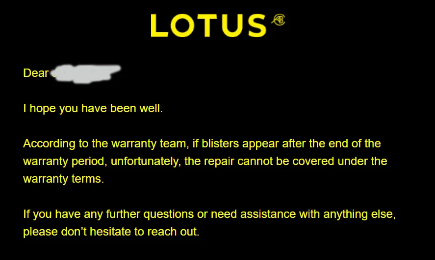

When pushed on what would happen on if I needed to make a claim outside the warranty they said:
"According to the warranty team, if blisters appear after the end of the warranty period, unfortunately, the repair cannot be covered under the warranty terms.
