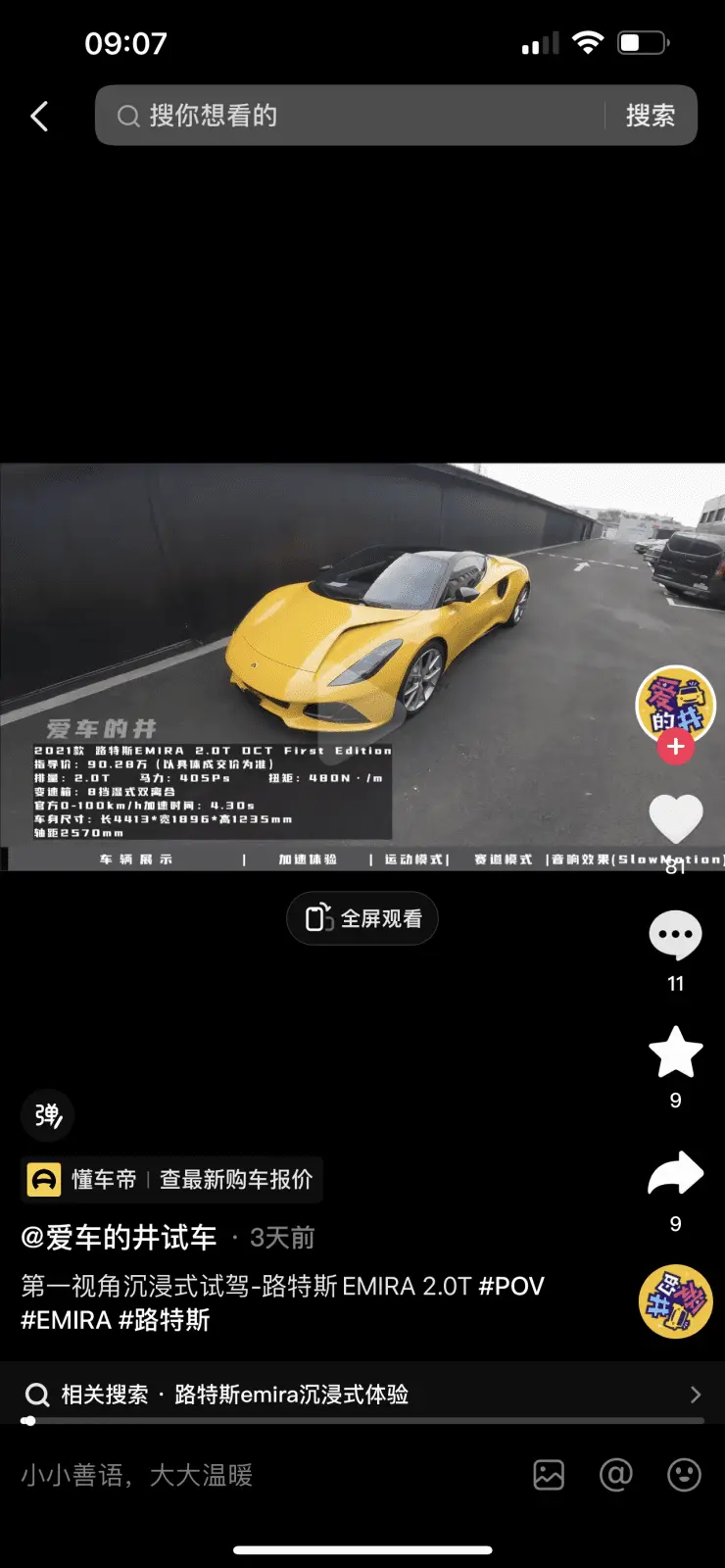

Another video, looks to be in China. Anyone knows why the i4 sounds like something is loose when he revs it? It's around the 30sec mark?

I see it is titles 366hp i4, so the China market 400hp i4 may be a myth
i4 may be a myth
The youtube vedio is not original uploader,the original vedio shows the 405ps in the first of vedio.
