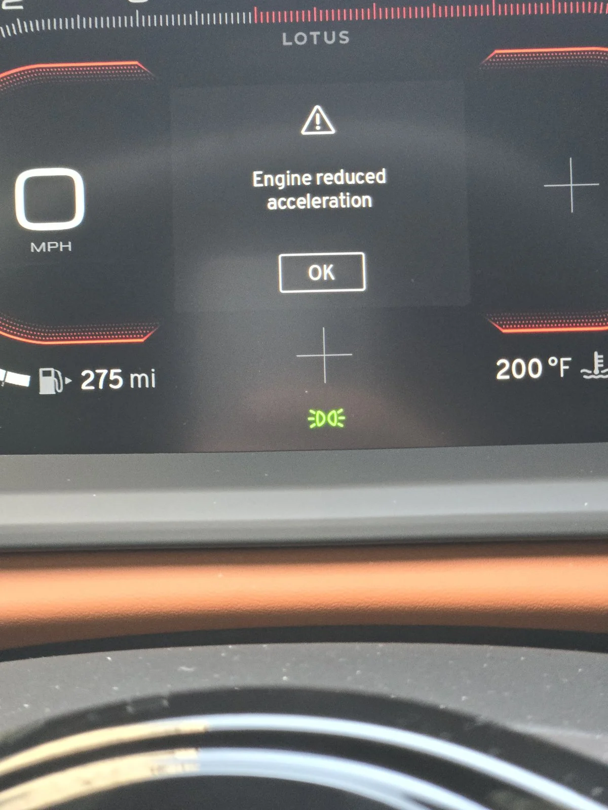

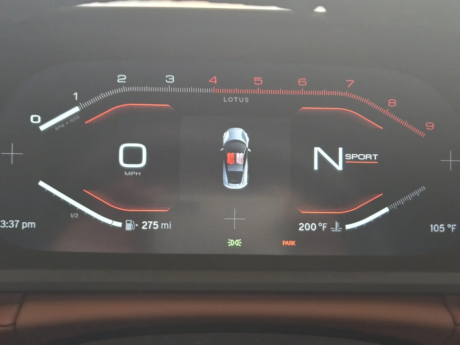

April 24 build car, I've had it since June and zero issues outside of some paint defects. Well unfortunately today I'm joining the "Engine reduced acceleration" club. No error codes or check engine lights, just a pop up warning followed by the redline reduction. It was 95 degrees in Chicago today and I was in terrible traffic for well over an hour (AC cranking of course), hopefully just a case of things getting too hot?
I'll keep people posted if this was a one time deal or if it continues to pop up.

That 200 degree coolant does seem hot but not too hot to flag a warning.
200°F coolant is the norm on a hot day - without traffic.

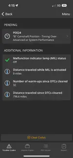

I was able to scan with the Veepeak Bluetooth scan tool. This is what came up. I have not researched this code here yet. I thought I would post straight away before the day gets busy. I am unsure if I am reading this right because this is my first time using an OBD-II scanner.
"Distance traveled since DTC cleared is 796.6 miles." That would have been well before I owned the car, which now has 848 miles, the last several hundred of which are mine.
The part where I did not get a CEL "Engine Malfunction," but I did go into limp mode, didn't make sense re-reading my own post, so I thought I was gaslighting myself, but this says the same thing.
It would have been about 5 miles from when I went into limp mode and turned the car off if the CEL was on.
Disclaimers. I am just a guy who loves this car and is trying to learn about this stuff. My terminology or understanding of what I am looking at has a high chance of being inaccurate.

Did the same route where I got this error. LA to LA Quinta and back again on the same day.
No issues. No limp mode. Similar ambient temps. It was a similar driving style, but maybe less aggressive

Do you have an OBD-II reader, and if so, can you plug it in? Since the same thing happened (no CEL) but a limp mode, I am curious if we have the same reported error code.
I apologize for digging up the past here. I found your post, which is precisely what happened to me, and I read through it and realized you and I are asking the same question, "WTF happened?" and I haven't seen an answer anywhere yet.
