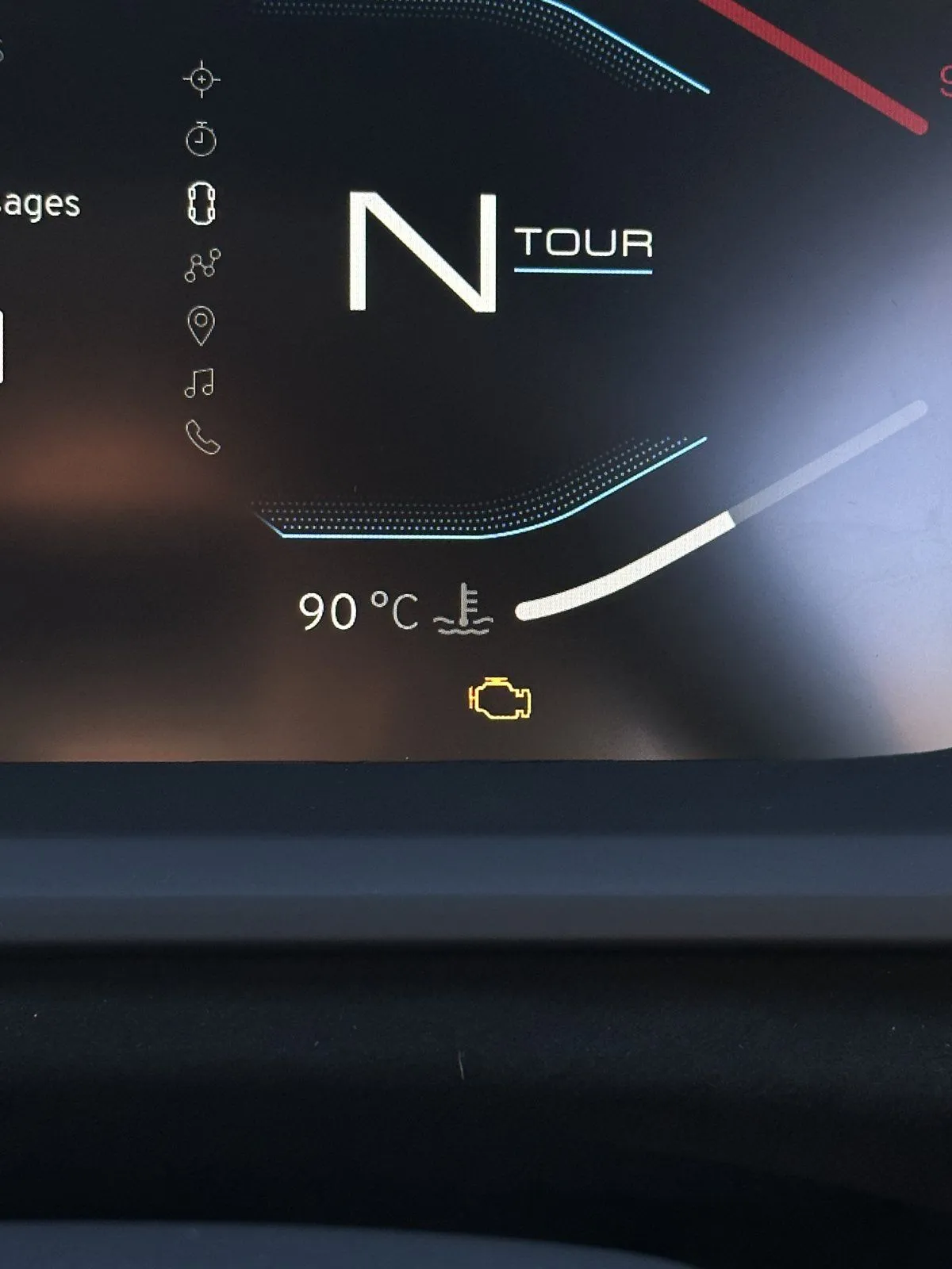

Received my Emira a couple of weeks ago, first proper drive and the Engine Light comes on….
“reduced acceleration” comes up if you try and put your foot down.
Lotus have said they know about an issue and the solution is a software update, which apparently is now ready… BUT, the software to get the update onto the car is broken, so they are hoping to have a fix in the next 7 days.

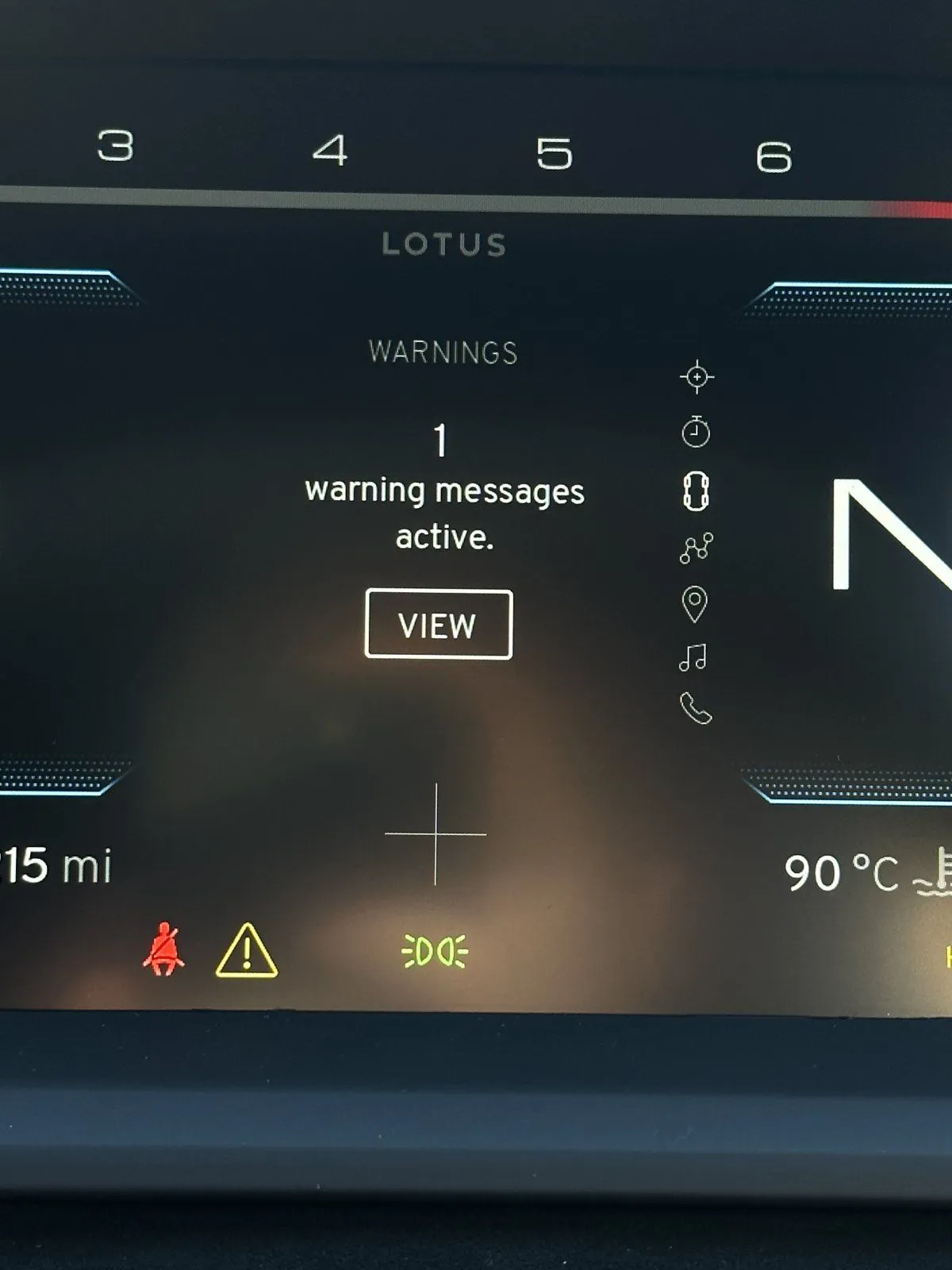

So, unfortunately a few software glitches has caused Lotus to recover the vehicle back to the nearest dealership to check it out and apply some updates to resolve.
Issues (that others have experienced too I can see)
1) Wipers when on auto mode sometimes don't go into full speed mode when needed - Harry mentions this in his video also.
2) Engine Management Light - it's come on randomly a few times with no errors at all the last few days - but car drives fine.
3) Engine Management Light - and car goes into 'Engine Reduced Acceleration' mode - effectively limp mode, max 3500rpm etc. Turning off and on sorted this, but why did it happen?
4) The car needed the battery disconnected and reconnected to do a full restart on the car's software because it wasn't starting, or fully turning off once, super weird, like it was stuck in diagnostics mode loop. Easily sorted, but could be related to software or battery issue?
5) Passenger seat belt is twisted, and keeps twisting even if you untwist it.
Hoping to have it back in next few days and I'll update on the fixes. Lotus, and Scott in particular, service has been decent, and as an early adopter I'm accepting this is just part of the experience, and can be quickly resolved with some updated software coded on.

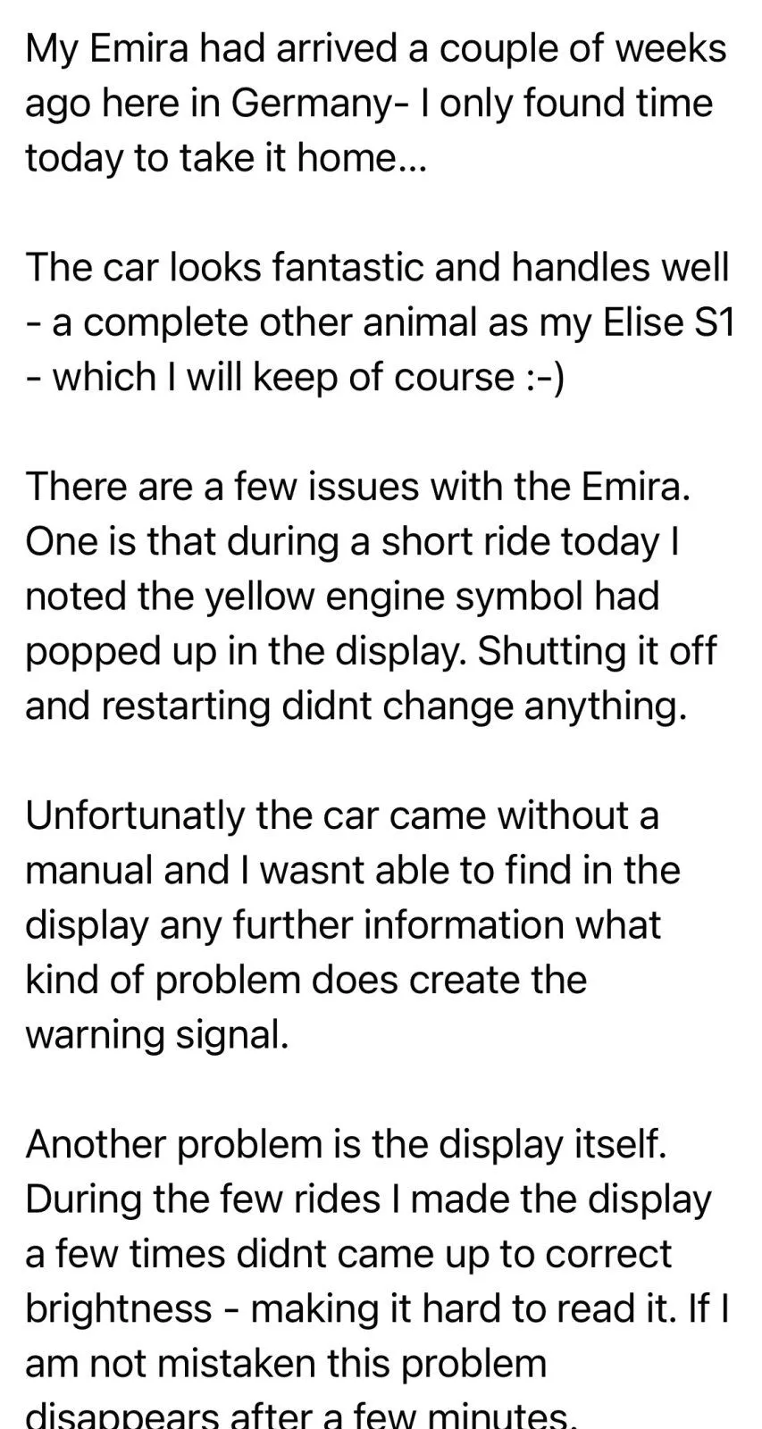

Sorry to hear about the glitches. All of those have been reported by a few other people too so hopefully Lotus already have fixes defined rather than needing to diagnose - random and intermittent issues are always a pain to trace out.
I've heard some of these may be caused by an earthing issue, which causes the ECU to get confused and switch into limp mode. Some of the dealer demo cars were affected. I also know there's a software update due sometime in January to address a few things, so maybe that's what you're getting.

@Lotustoronto often it's intermittent faults or issues that affect only some cars that are the most difficult to pinpoint. If all cars have the same version of software then it's unlikely to be the software itself that is broken, but it could be how the software handles some kind of out of tolerance situation that's the issue.
So it could be an intermittently faulty sensor confusing the ECU, or a partial bad joint in the wiring loom, or a weak earth bond, or the battery could have sat unused for weeks and lost capacity (Lotus electronics seem to be very sensitive to a slightly under-par battery) or a faulty key fob or immobiliser or any one of a hundred things. There's been some unfounded speculation it's linked to ABS sensors or the aircon, but nothing proven yet as far as I know. I imagine Lotus are tearing their hair out trying to diagnose it.
I do know of one car that exhibited very odd ECU-related behaviour (different to the current reported issues) and intermittent limp mode and failing to start, which was proven to be a poor earth connection. That's relatively easy to check and eliminate, so I assume that has been ruled out for the cars currently showing an ECU fault.
