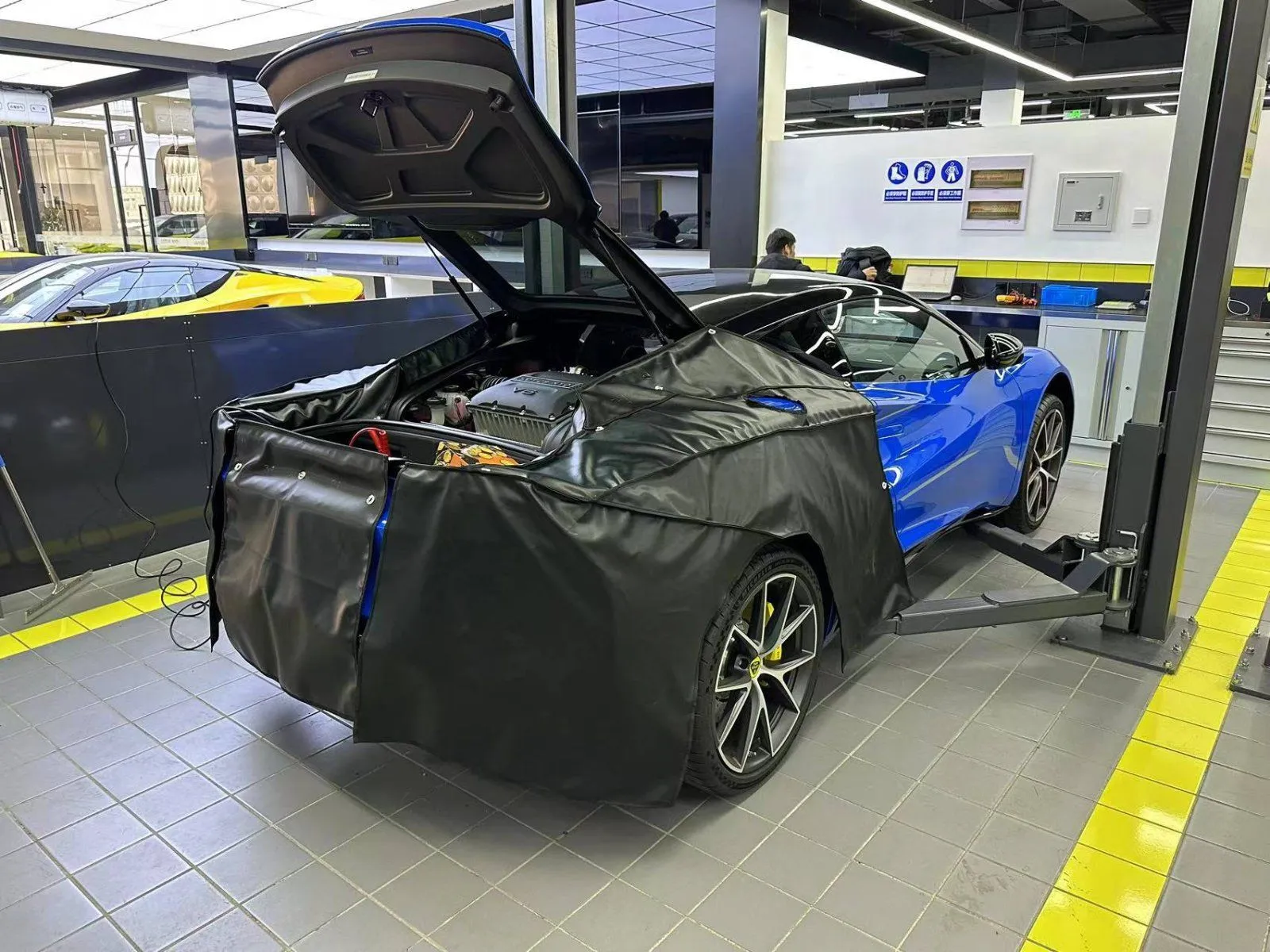

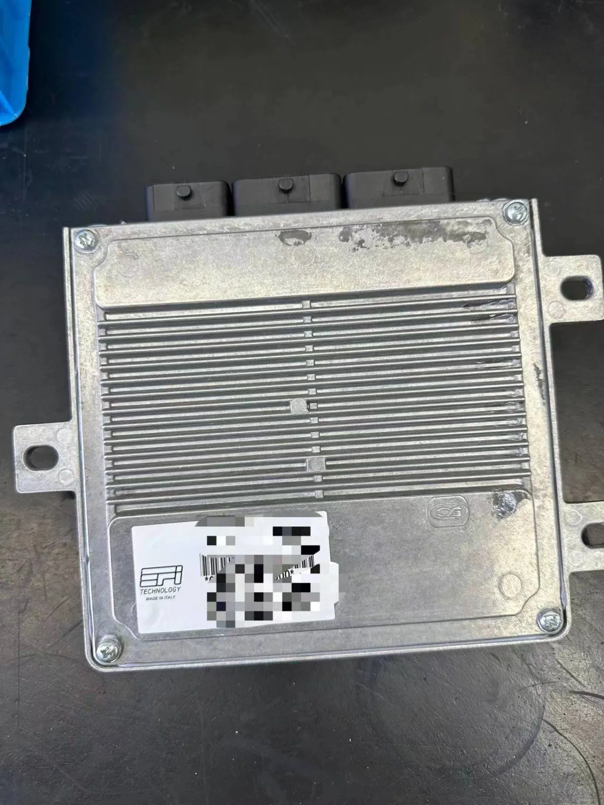

My Emira had the same issue after only 1500km of driving. Lotus Shanghai sent us a service vehicle to diagnose the problem and possibly found the faulty ECU. The vehicle was towed back to the Lotus flagship dealer to be further diagnosed. I would update this post once I hear more information from the service team. The vehicle could not start nor detected the keys a few days before the reduced engine power output warning message.
Faulty ECU confirmed. The dealer will update the software of my new ECU and install it. I'll keep you updated.

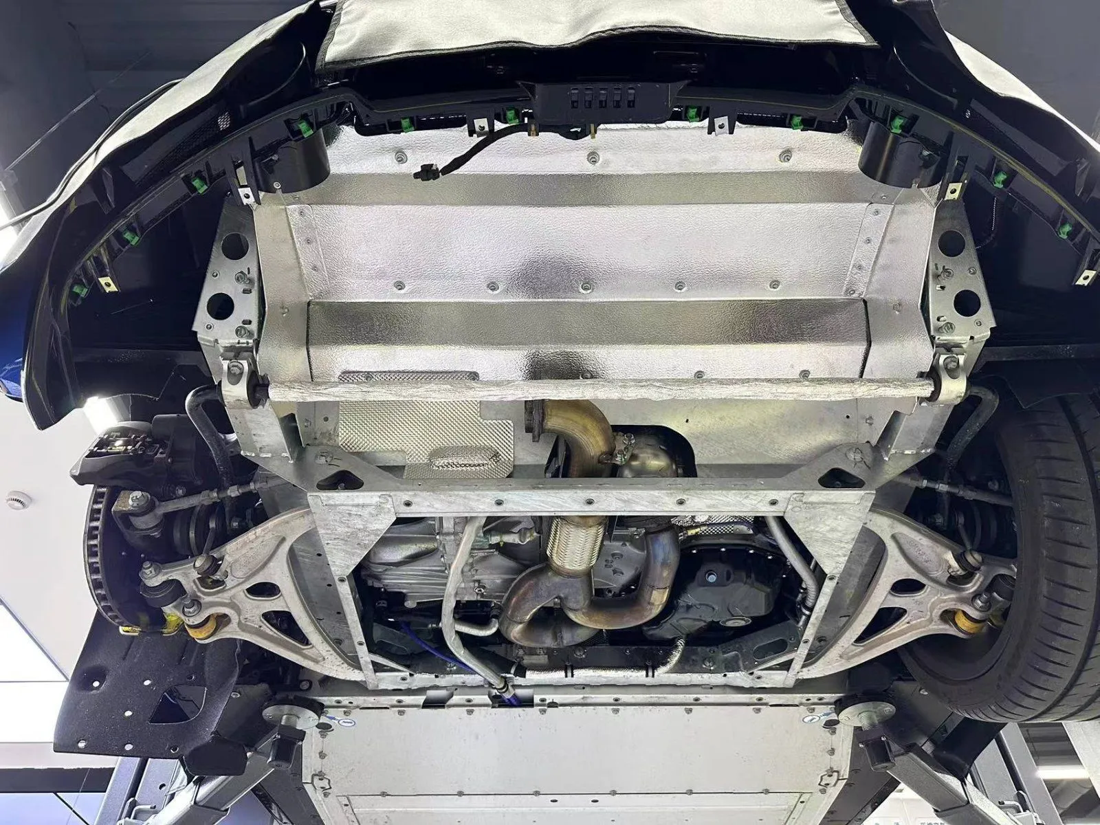

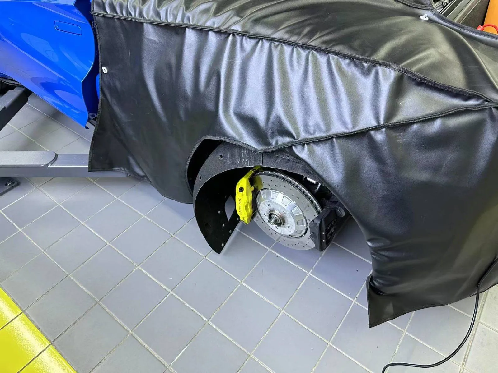

2/6 Updates regarding the faulty ECU: Lotus UK flew one of their tech guys in and helped Lotus Shanghai to diagnose the issue further. Kudos to their customer service. They also reimbursed any transportation cost up to 80 ish dollars per day which is fantastic. I pretty much had a Mercedes chauffeur drove me to anywhere in town free of charge. They found the faulty ECU, determined that there was an internal short circuit on the board, and decided to replace the entire thing. Reprogrammed the car with 1/23 Patch software and rebooted the entire system. (The entire reprogramming process took about 30 minutes to be completed) Seems like the problem has now been resolved. I am currently seeking a solution for 3rd cat delete to improve the overall sound and trying to fit an aftermarket exhaust system on it. Here is a picture of the chassis components. Enjoy!
I would have to start up a new thread if I touched anything on the exhaust system. Stay tuned~

Is that some kind of foil wrapped around the rear anti-roll bar?
