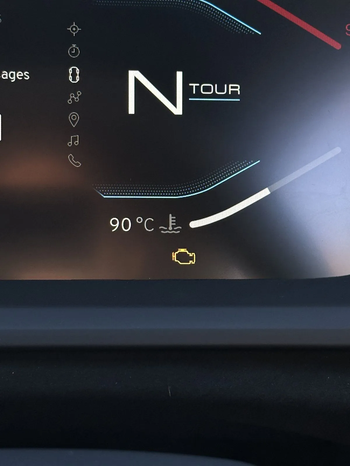

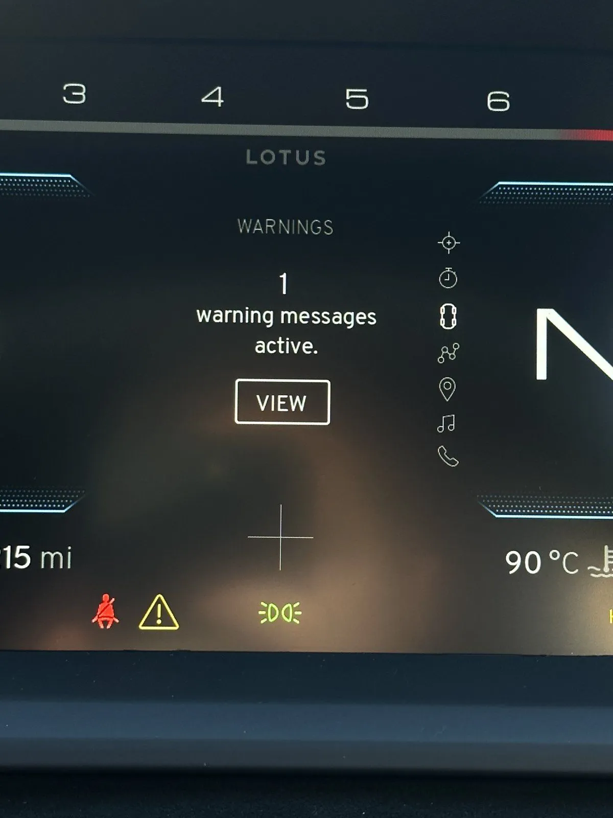

Received my Emira a couple of weeks ago, first proper drive and the Engine Light comes on….
“reduced acceleration” comes up if you try and put your foot down.
Lotus have said they know about an issue and the solution is a software update, which apparently is now ready… BUT, the software to get the update onto the car is broken, so they are hoping to have a fix in the next 7 days.

Three weeks old Emira, have got same issue!
