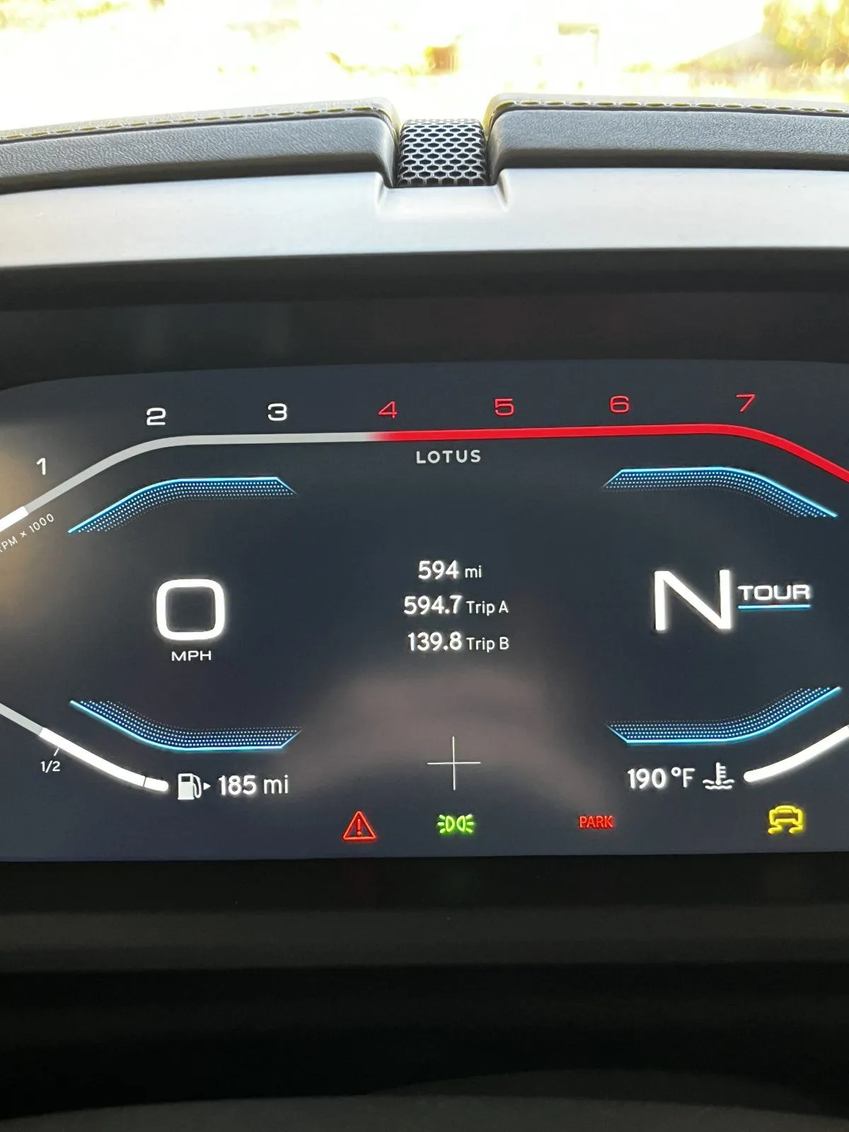

Day 5 with my new Emira, just shy of 600 miles and I experienced this. Not super excited since I’m 4 hours from my dealer, but I guess this is a risk I chose to take.
