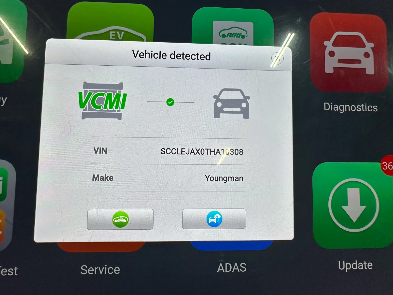

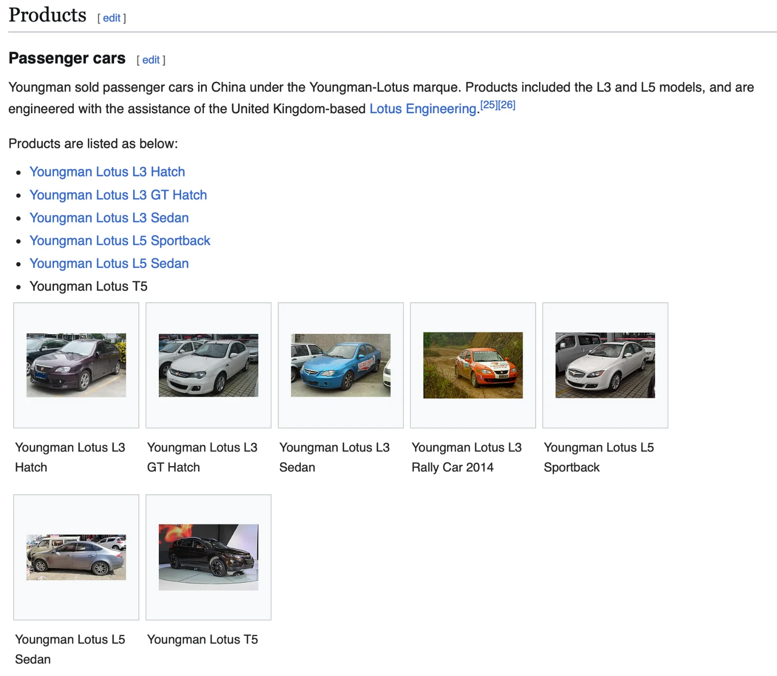

I will definitely be getting EmiraDS once I'm out of warranty. Other than that I am unaware of an OBD reader that can get juicy info from our cars. Even my friend's $4000 Autel MaxiSys Ultra doesn't have Lotus as an option. Doing a VIN auto scan it thinks it's a "Youngman" (Chinese company with some collab with Lotus) but will throw an error when trying to connect.
