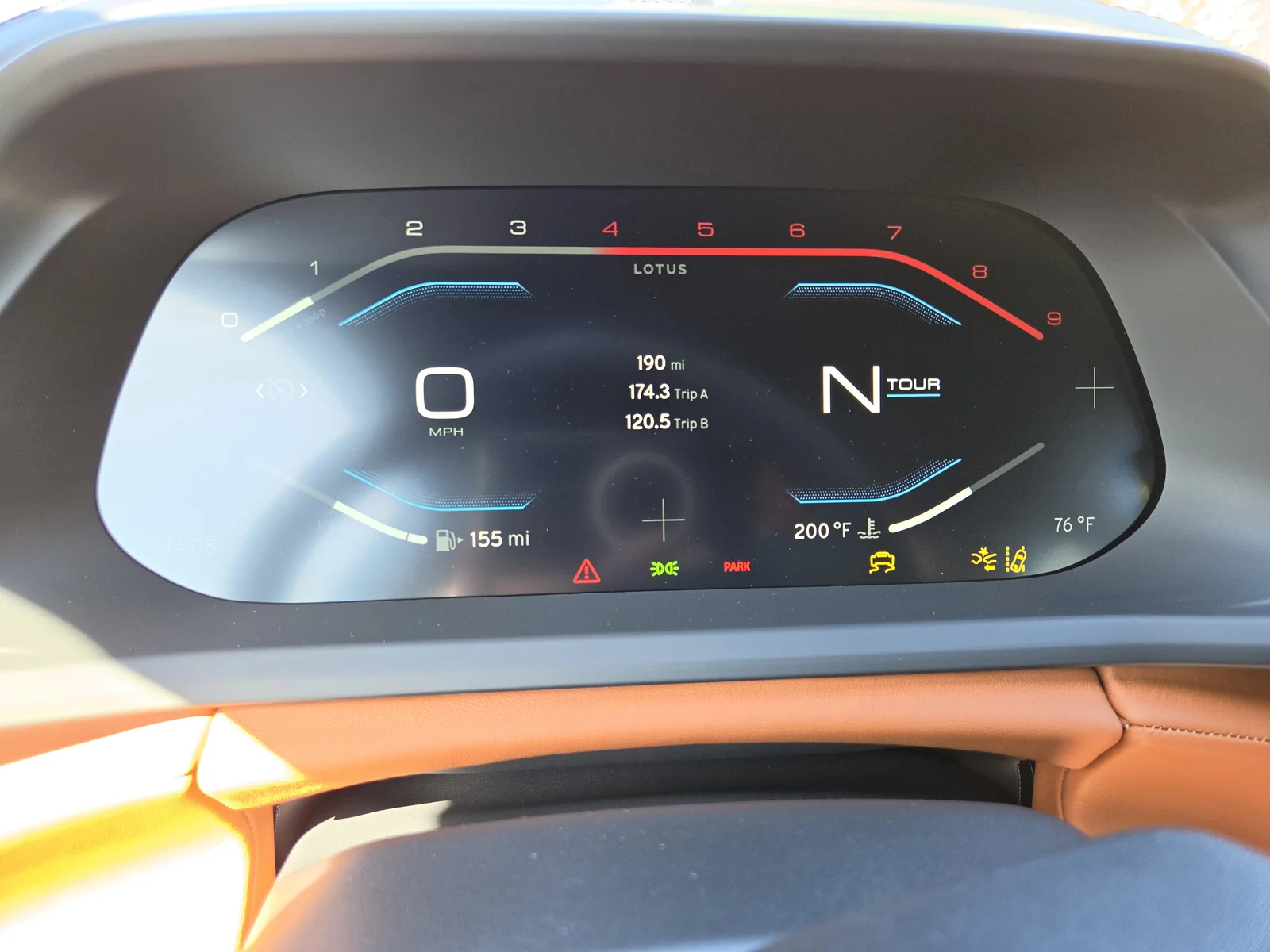

Reporting another of the same. And I'm not even through my first tank of fuel yet. No mods. 2026 V6.
Warm day, not hot, after 1hr of mix freeway and canyon roads. Pulling away from a lighted intersection up a relatively steep incline. All the black boxes started coming up and the collision warning bottom right (clear road, nobody in front or to the sides). Stopped and took this photo. Tach shows rpm limited to 4K. All went away after a 5 minute stop, cool, and restart.
