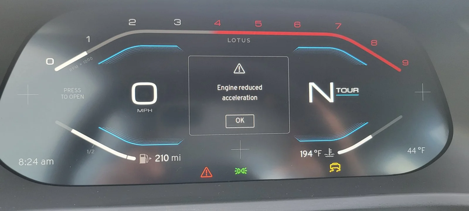

I experienced the reduced acceleration warning and ESC error on a drive on the weekend after driving 1,000 miles. No rain, no wash - car was totally dry. I have 3rd cat delete. It randomly turned on as I was driving slowly through a neighbourhood. Parked locked the car, went for lunch. When I returned, error message gone - drove home 7hour drive - no error again. I assume its something flaky. I guess I’ll wait if it comes up again.
April 24 build car, I've had it since June and zero issues outside of some paint defects. Well unfortunately today I'm joining the "Engine reduced acceleration" club. No error codes or check engine lights, just a pop up warning followed by the redline reduction. It was 95 degrees in Chicago today and I was in terrible traffic for well over an hour (AC cranking of course), hopefully just a case of things getting too hot?
I'll keep people posted if this was a one time deal or if it continues to pop up.

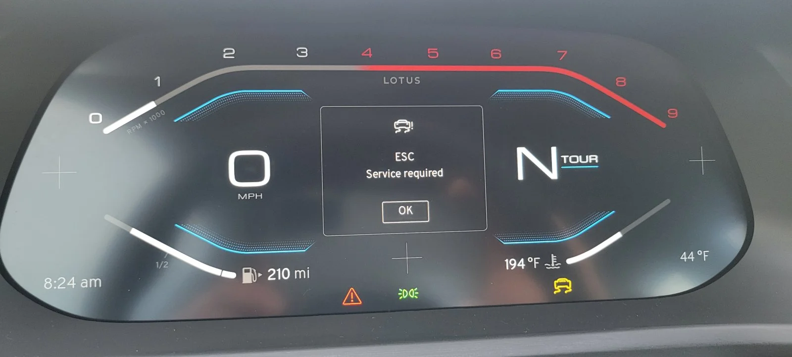

I feel like the ESC Service Required error is something different. I had it happen to me once about 300 miles ago. Like others, it went away after a restart.

Just had similar issue. 280 miles. Randomly flipped on, redline reduced for 4000 rpms. I’ve been babying it. Drive mode made no difference.
No check engine light for me though.
